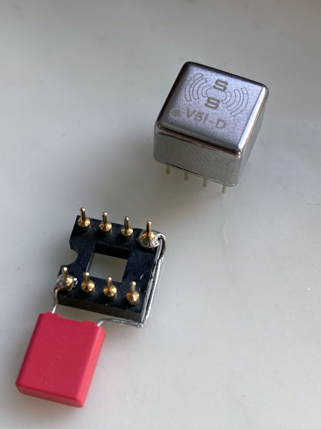

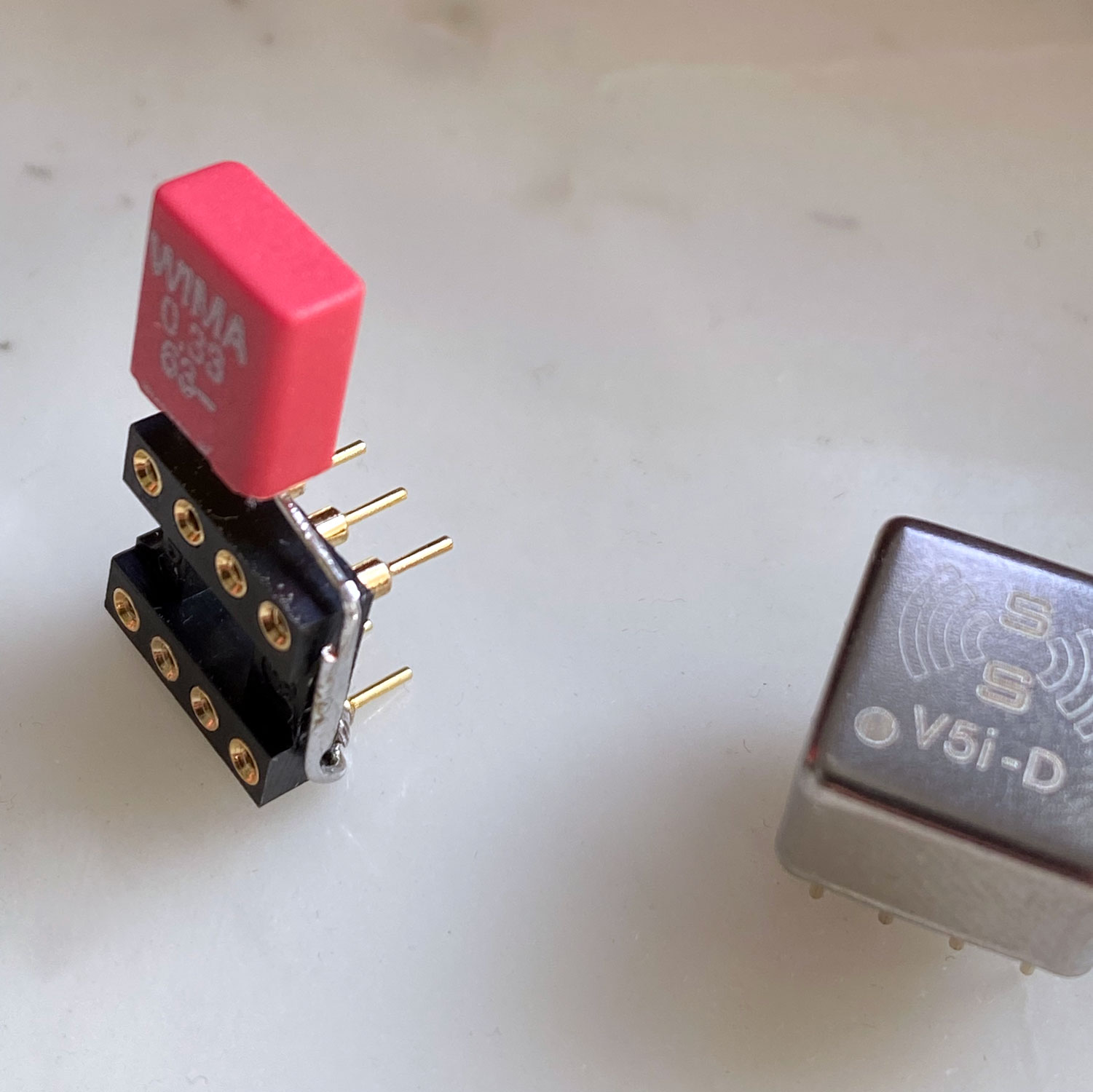

This mod? See pic. I did that to keep the voltages within the Burson spec per some of the previous posts in this awesome thread. The amp was quiet before though... so that's probably not helpful! My other amp—the one I'd send you—doesn't have that mod... it's ghostly—can't really use the term "noise floor" with it....post some interior pics of your build...
I assume you ran a wire under the op amp to the -V (terminal 4)?
See pics. I made a reusable part. You are talking about the cap mod? The details for this were in a guide on Burson's site if I recall. I don't hear a difference with or without it, and the V5i seems to run at the same temp with or with out it—my rails are the same as Jim's build guide ~17+/-. I have one set of cans that are around 100 ohm, I also happen to have a stack of IEMs, some very high end, here that were given to me—I will try with them to see about this noise floor.

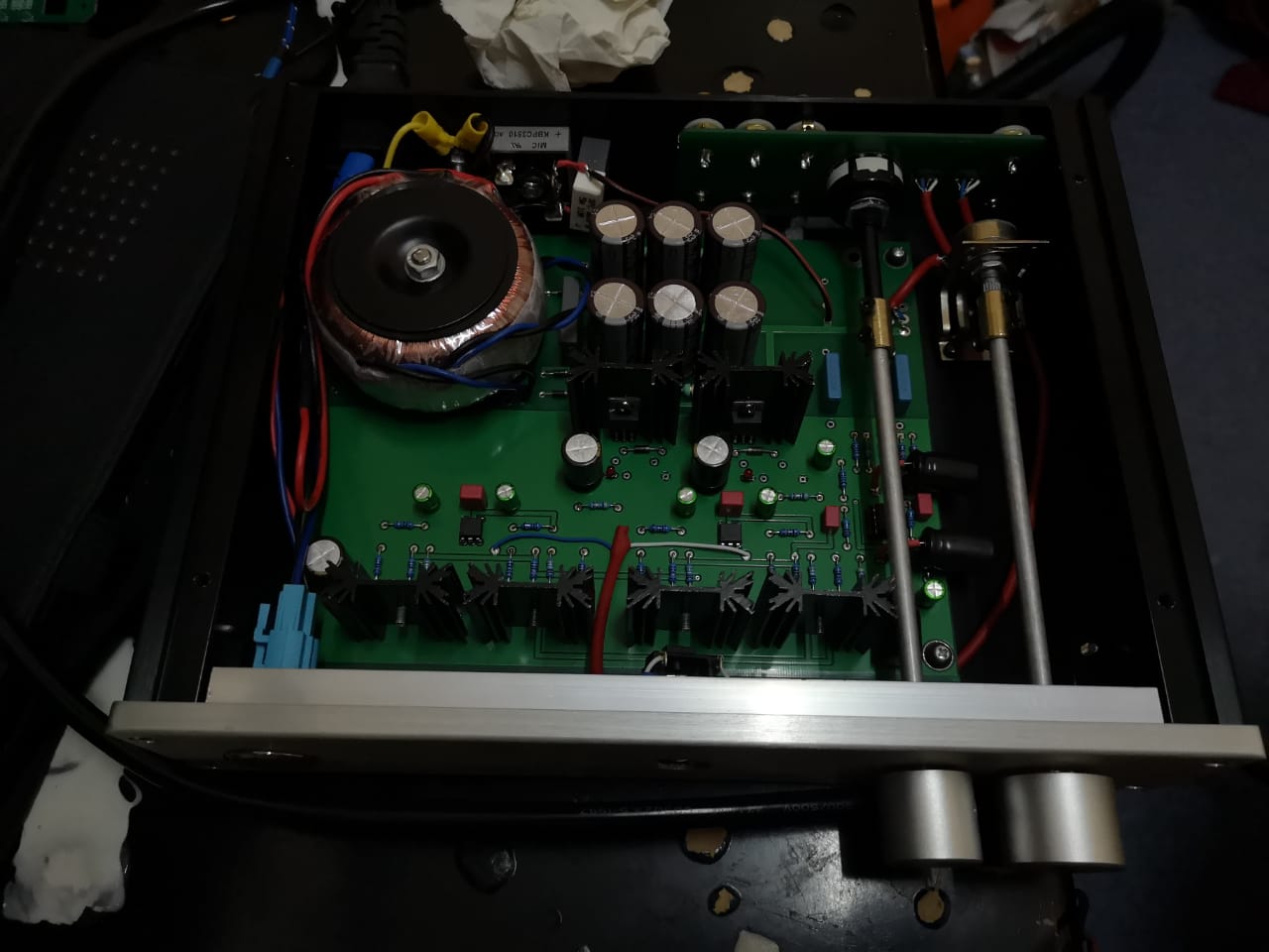

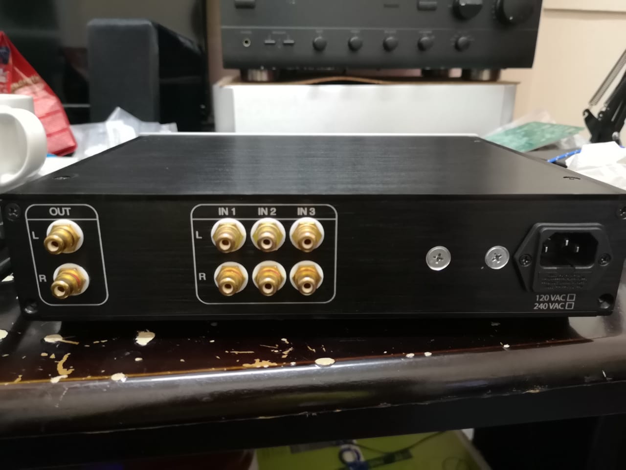

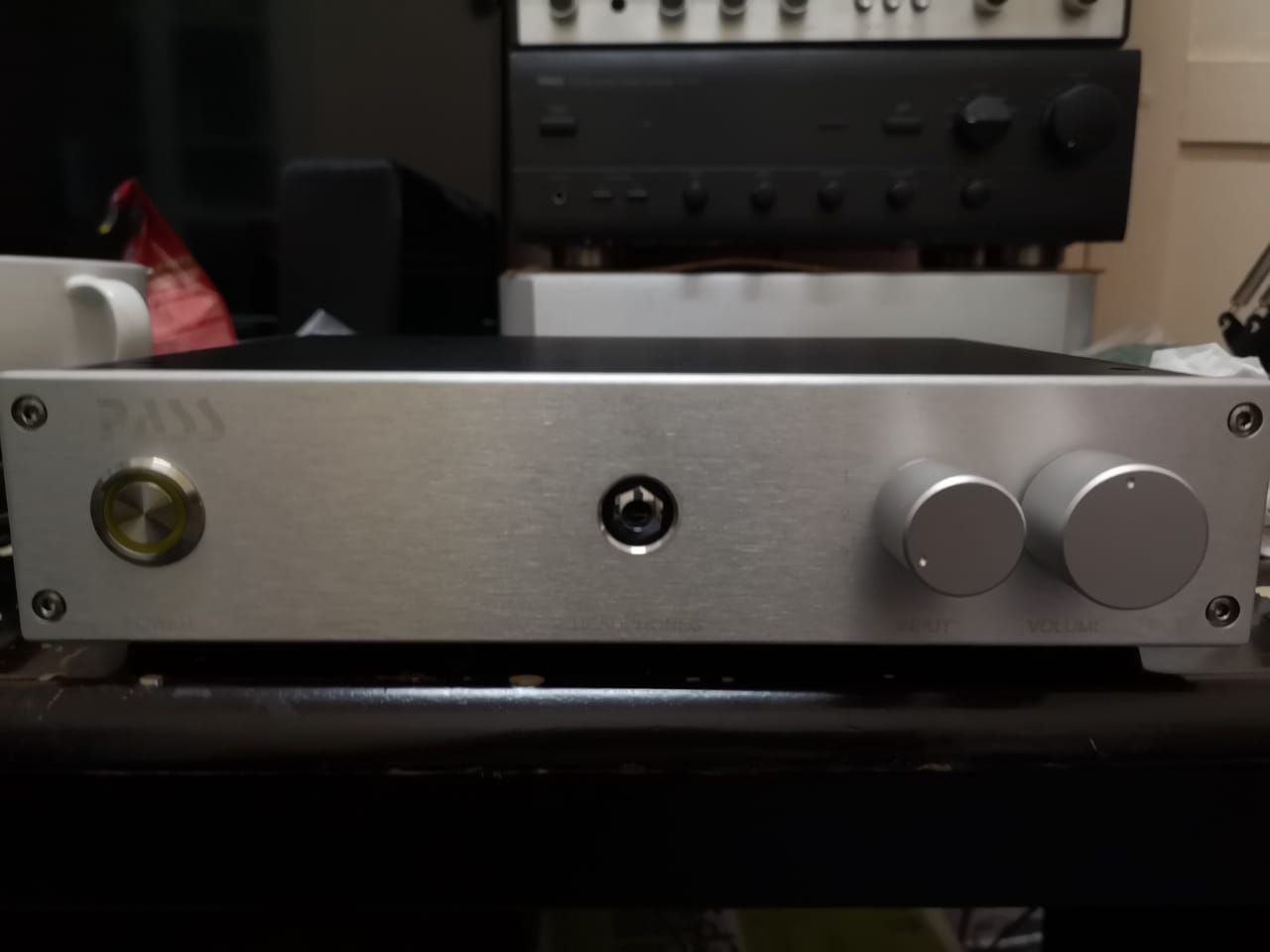

Was busy for more than a year after soldering the boards and never really got to fitting it to the chassis. Finally did it today and I must say the sound is clear and crisp and dead silent. Thanks Wayne and everyone who helped make this possible!
Some photos of my build.
