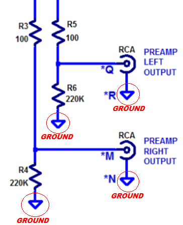

Can I ask some noob questions?

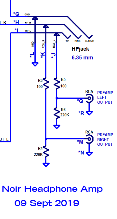

I can see that there is a 100Ohm resistor after the switching jack on left and right on the way to the power amp.
Where do the arrows indicate that is going?
Also, I am using microphone cable as rca. Is it right to split the shielding at the amp end for left and right?
If "arrows" means "triangles", those are schematic symbols which indicate "connected to ground". The triangle symbol is built-in to the schematic drawing piece of the LTSPICE software.

Or, if you were referring to the "arrows" pointing "upward" on the schematic, those simply show where the contact will be made with the circuit if the TRS male plug (your headphones) is not inserted. Inversely, it visually indicates by the little "nubs" on the end that when the male plug is inserted, that it will push the contacts in the switch up and away from the arrows, breaking the circuit to the RCA outputs.
See the datasheet for the Neutrik jack recommended in the "one-click" BoM / Cart for the Noir. You'll notice that there are 6 pins (TRS and their TN, RN, SN counterparts) vs. only 3 and that it is noted as a "switched" jack.
TRS would correspond to when the plug is inserted. TN, RN, SN would correspond to when the plug is not inserted.
As an addition to Mark's excellent explanation, I hope that covers all bases and that I've gotten it at least mostly correct. 🙂

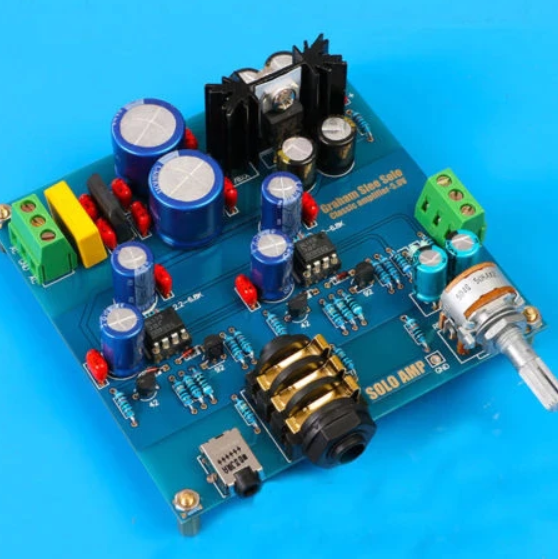

Does anyone have a good sharable LTSPICE file for the "WHAMMY" Pass DIY headphone amp? (Mark Johnson directed me here suggesting that a WHAMMY LTSPICE file might help.)
In particular I need a good simulation of stability.

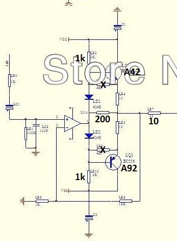

I ask since I am debugging a different but somewhat similar headphone amplifier (different output stage). This different headphone amplifier behaves well with the stock NE5534 but somehow has the ability to kill OPA1611A and OPA228 op-amps dead in just a couple seconds with no audible output. Put the NE5534 back in and it works just fine. (It is a clone of the "Diamond Edition" Graham Slee Solo HPA.) I have never killed an OPA1611A or OPA228 before and I am currently stumped. So I thought that perhaps an LTSPICE simulation of stability might tell me something. Perhaps it is a stability issue or I am not sure what else it could be. Maybe a strange startup problem? I was thinking of adding an input series resistor but I don't want to sacrifice another OPA1611A or OPA228.
And if by chance anyone has a Solo HPA clone please let me know what op-amps you have successfully used.

The board I am using is a somewhat similar (not identical) amplifier and uses single (NE5534/JRC5534) op-amps. (See the attached image.) I am hoping I can modify a good WHAMMY LTSPICE file to look at what is possibly going wrong with this similar but different HPA.
I just need a good LTSPICE simulation file setup for stability analysis of an op-amp plus booster type HPA. In another thread Mark Johnson suggested that I ask here for a WHAMMY LTSPICE file. From there I will modify the simulation file.

That output stage you have is not a follower, much different.
