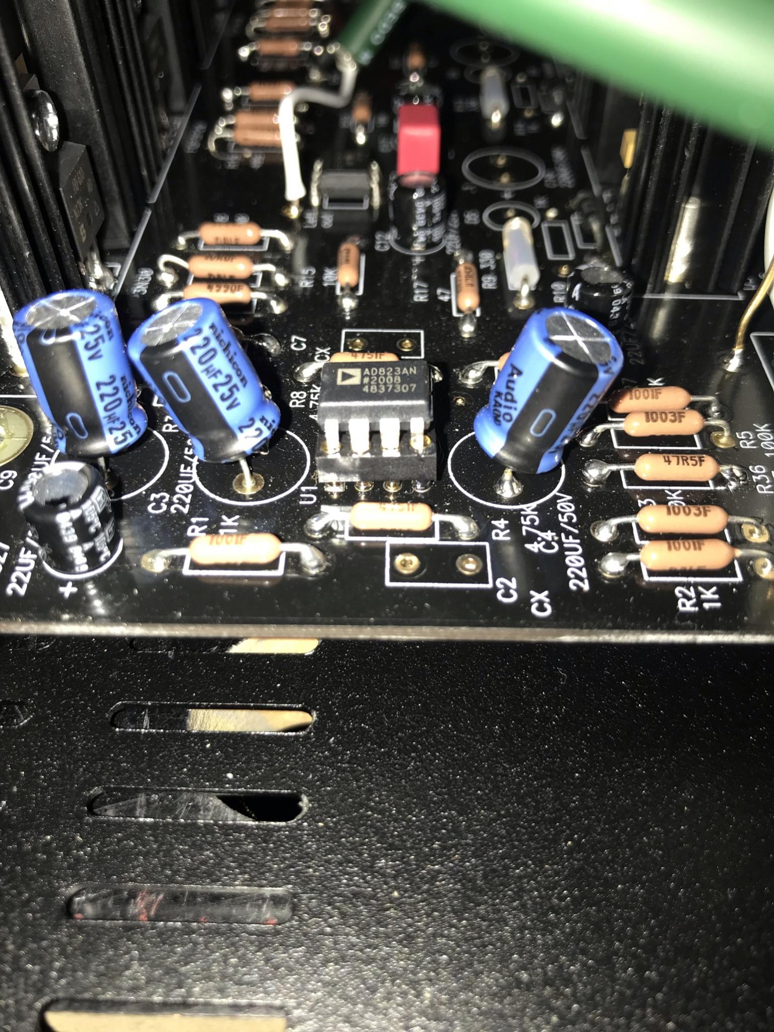

bad noise

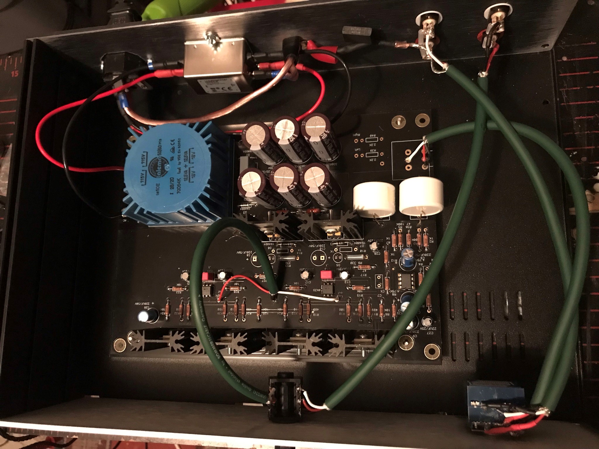

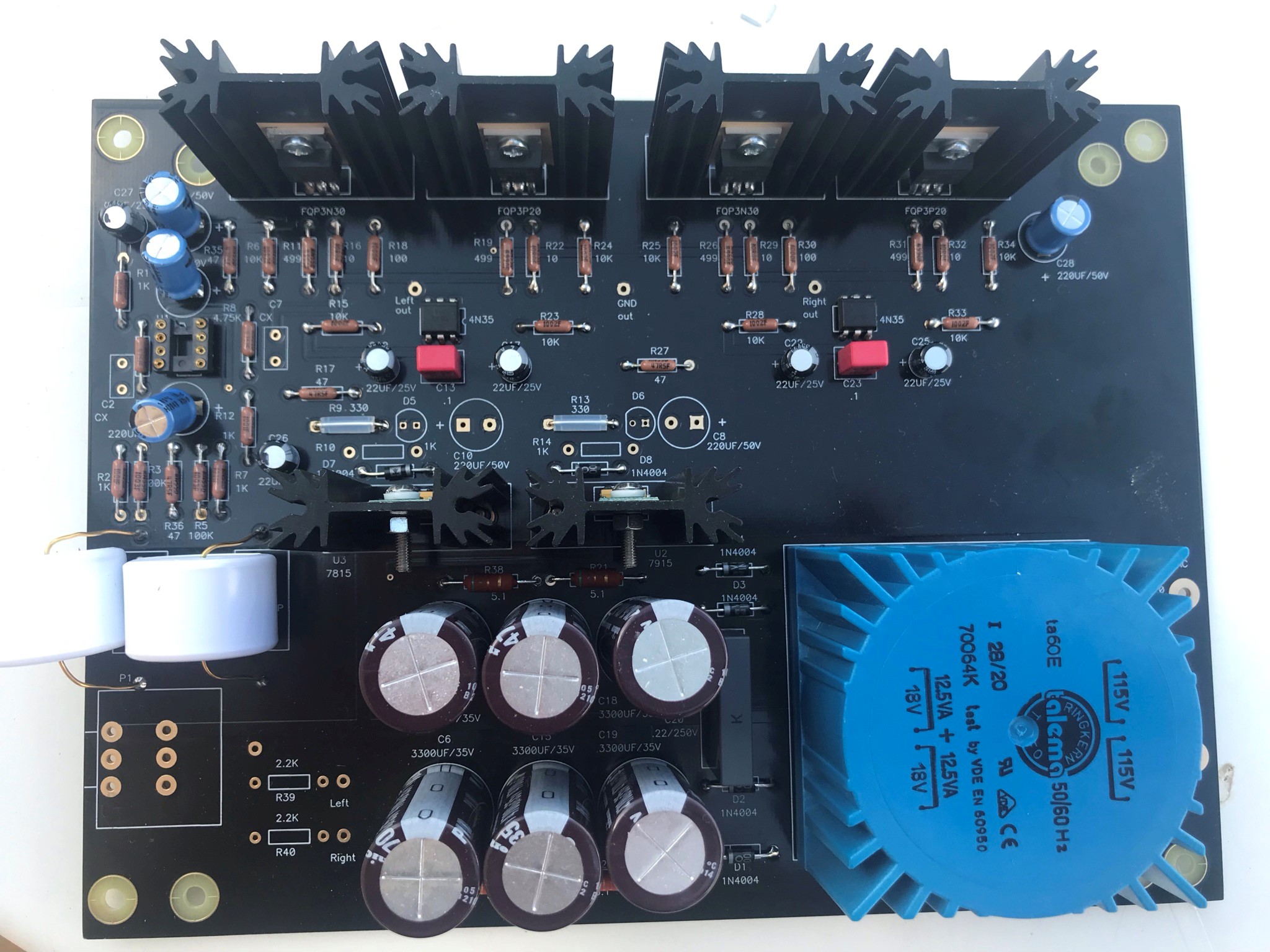

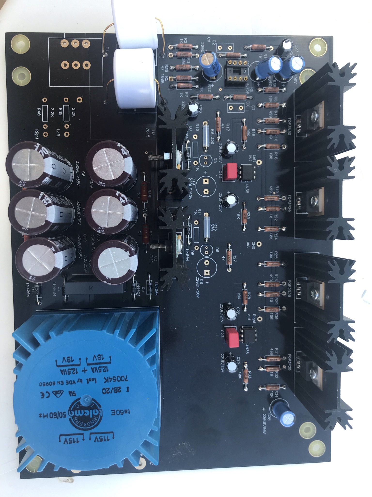

I just finished my whammy but there are bad noises in headphones like automatic weapon, is it ocsillation ?
Xformer is 18 v, mosfet IRF 610, naked reg, c26 and c27 in 35 v 22uf,opamp ad823anz the same result with lm833p (not electric voltage).
the box is not completely assembled and pot is not yet grounded.
electric voltage C6 +14.60
R14 R13 -15.41
R10 R9 +14.64
without charge
ask me other details but for electrical measurement guide me at this moment I'm at the maximum😱

Have you measured DC offset? Your soldering is a bit questionable. You shouldn't have "balls/blobs" of solder. They should be like smooth cones. This happens when you only get heat into the component lead but not on the circuitboard trace. If nobody notices anything more specific, perhaps reflow all the joints.

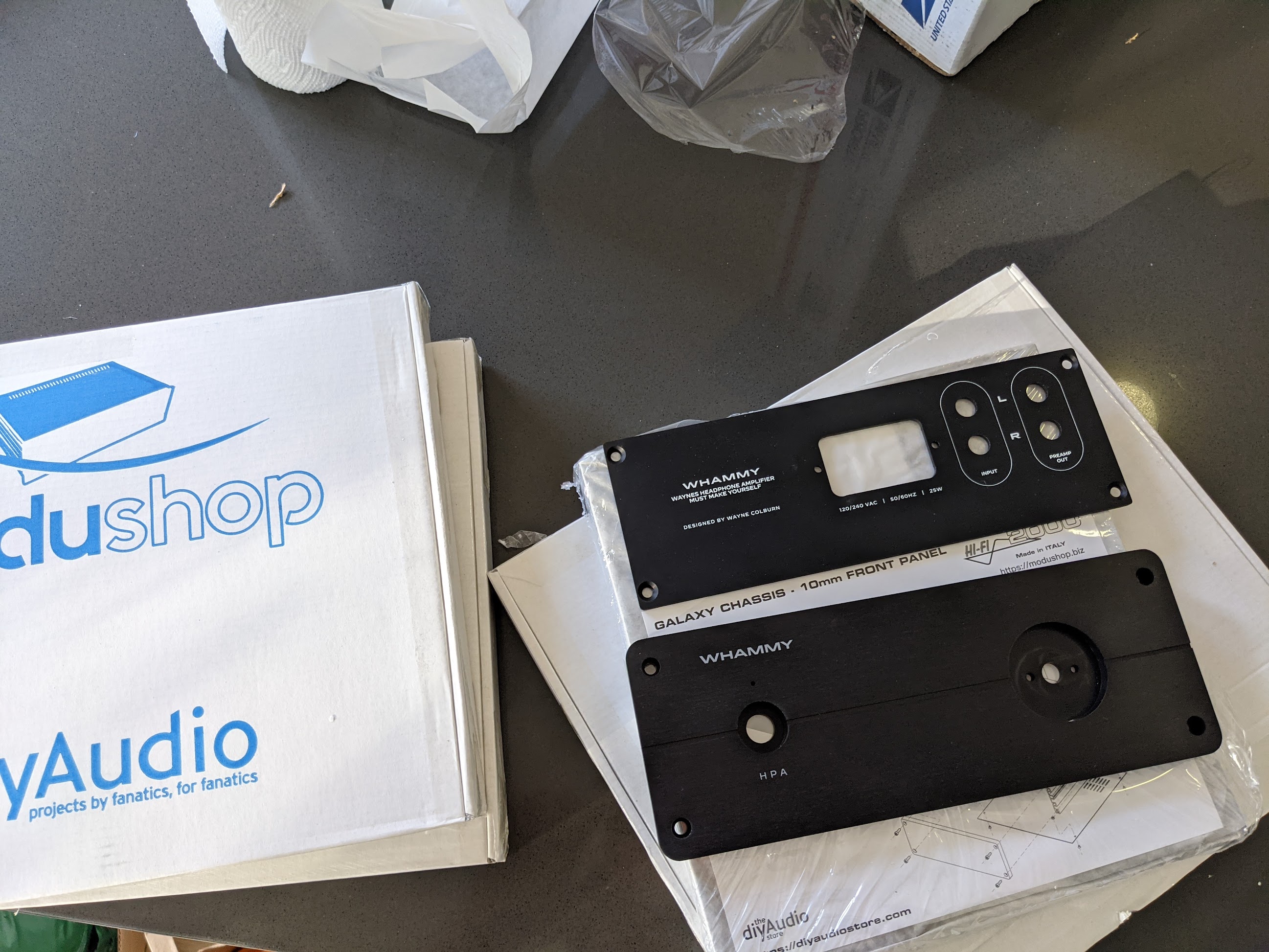

Just received my order 🙂
Tho, now I'm also realizing that the chassis does not include screw standoffs.
The only standoffs I have lying around are M3 x 6+6 (for computers).
The chassis appears to be a bit wider than the PCB, so I don't believe it's intended to be "floating" on the side panels like it might on the Hammond.
I'll need to find some spacers... Jason, do you know if the kit will use a particular part no. for the standoffs?

The parts kit pre-order has been delayed while I gather information from our supplier that the parts described in the text of the sales page are what's in this kit. The photo has been updated with a photo from the new batch, but the description of the parts is still from the last batch.
Regards availability, there should be plenty of kits to meet initial demand.
The standoff is Harwin R30-3002502, screw and nut is McMaster Carr 92000A114 and 90695A033.
The standoff dimension (25mm) is critical to get the board w/ mounted Alps and jack to align to the faceplate holes. And no, like a regular Galaxy chassis, standoffs are required.. side panels don’t interact with the PCB…
