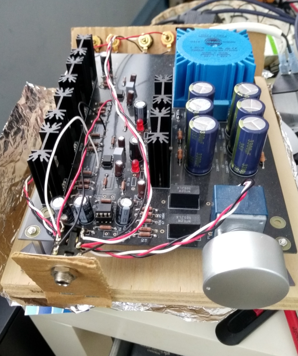

(What have you got fitted in the IC socket? It looks strange in a picture)
Now I can't work for the rest.
what do you mean by ic socket ? OPamp ? It's a chinese opamp (aliexpress)
Working from pictures is difficult tbh because I've never seen the real thing, I working of the circuit diagram alone 🙂

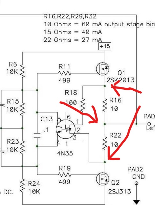

1/ Identify the end of R8 that connects directly to the two 10 ohm resistors. You now unsolder that end to fee it. Just heat the pad and pull the resistor up to isolate that end.
Do not over heat the resistor, be quick. You can also clip a croc clip to the leg to shunt the heat away.
2/ Now identify which end of R17 goes to the two resistors R15 and R23.
3/ Link the end of R17 which you have just identified to the now free end of R8.
Electrically the circuit should look like this. The voltage on R17 (either end) should be absolutely steady.

This is the socket. The opamp is that gold coloured thing you plugged into it. What is it?
Use your meter on a low ohms or diode range to identify continuity between the parts I mentioned. That will tell you what goes where.

therefore the voltage of R17 connected to the end of R8 is completely stable and the test has been done with the LM 833 🙂

That sounds promising. The voltage you read should be very low indeed, almost zero.
If so then this shows the problem is related to the output stage and not the front end circuitry. It was a quick test but intended to prove just that.
With circuit still connected in this test mode can you also now measure the voltage on the main output (junction of the two 10 ohm resistors). Measure from ground for this.
What voltage do you get?
Is it stable of not?
Also for interest, what voltage do you now see measuring between the 10 ohm resistors. In other words measure from FET to FET across both 10 ohm resistors. Put one meter lead on the FET end of R16 and put the other meter lead on the end of R22 that goes to the other FET.
What voltage do you see?
