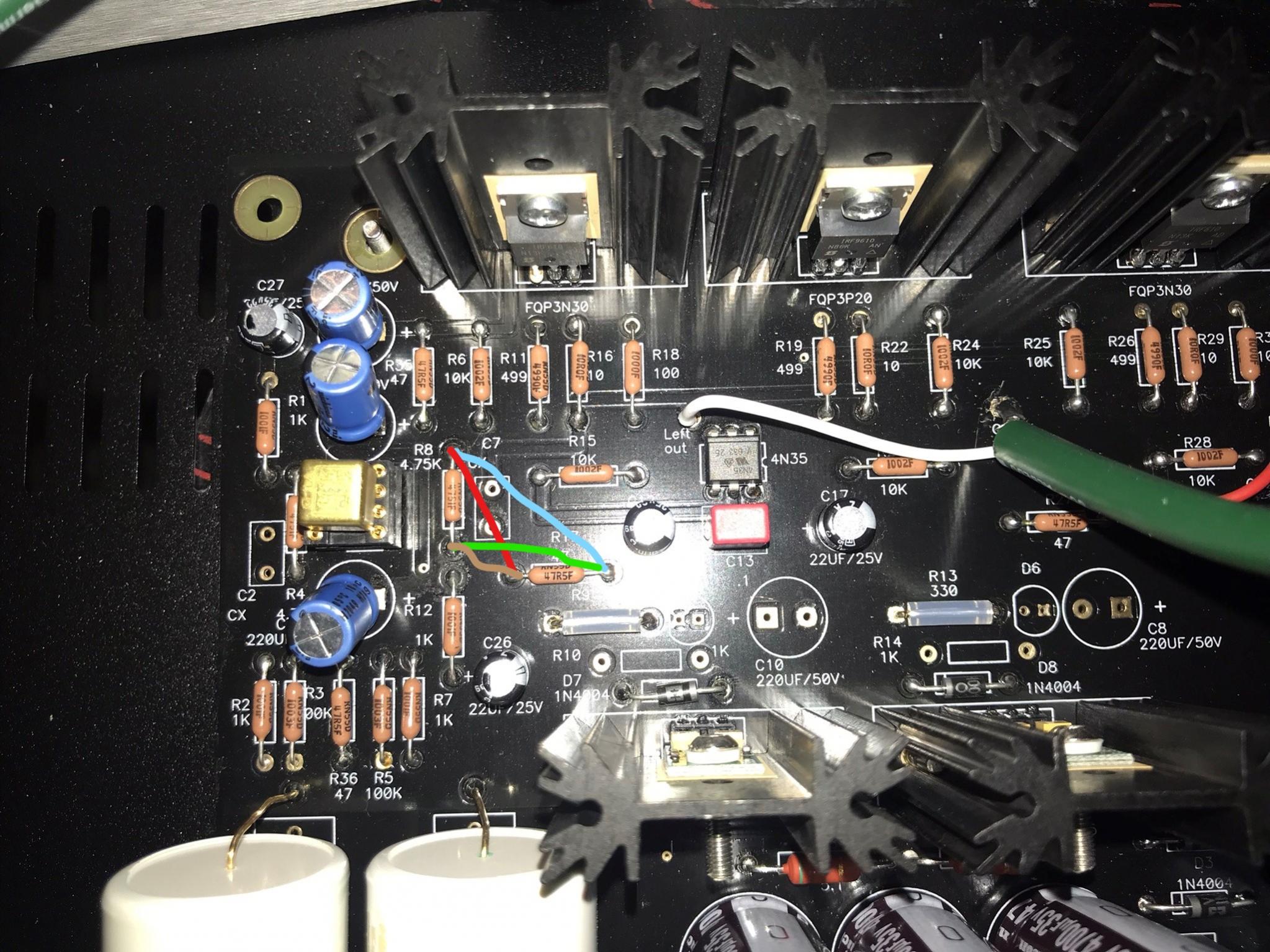

Have you measured DC offset? Your soldering is a bit questionable. You shouldn't have "balls/blobs" of solder. They should be like smooth cones. This happens when you only get heat into the component lead but not on the circuitboard trace. If nobody notices anything more specific, perhaps reflow all the joints.
Thanks for your reply A Jedi,
i'm sorry but you will have to guide me to take these measures. dc offset is voltage between the left and right terminals of the headphone output ? I reread the first page of the thread yesterday to try to find out how to measure but I did not understand everything.
in the meantime I will try to redo my welds.

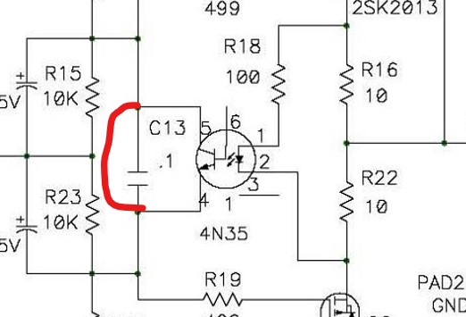

1/ you mean bypass C13, for example, with crocodile clip, from below. I connect + to - of C13 ?
Pin 4 should be negative 15v It must be correct if the other channel works because it is a dual opamp shared between channels.
So nothing obvious in those results beside the fact there is a small fluctuation.
Here is what I would do and ideally I would use a scope at this point to look what was happening.
1/ Add a link across C13 to link the bias generator out. Does the fluctuation still occur?
2/ If it was still fluctuating I would for elimination purposes try another opamp. Any common dual type should work to prove the point.
If you use croc clips then be sure they are secure and can not slip. Even easier if you are confident is to short the opto pins with metallic tool.

With bypass to c13 there is less fluctuations.

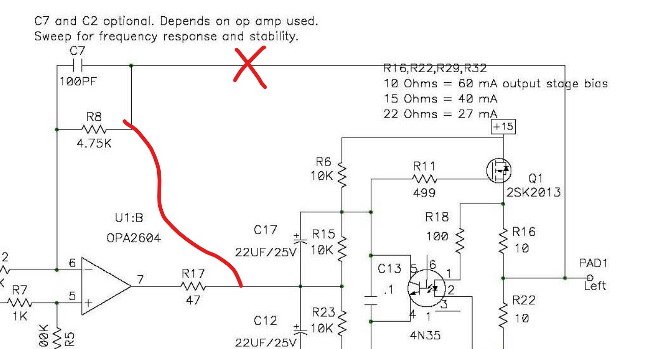

do I have to unsolder one of the sides of R8 and connect it to R17 and what side (like picture) if it's important ?!
I am really sorry for my total ignorance but this goes way beyond my comprehension, so I prefer that one explains me in detail.on the other hand if I am guided that does not scare me, and in addition it's interesting.
my dear mooly I thank you for your unfailing patience, because with me you did not come across the best
Working from pictures is difficult tbh because I've never seen the real thing, I working of the circuit diagram alone
1/ Identify the end of R8 that connects directly to the two 10 ohm resistors. You now unsolder that end to fee it. Just heat the pad and pull the resistor up to isolate that end.
Do not over heat the resistor, be quick. You can also clip a croc clip to the leg to shunt the heat away.
2/ Now identify which end of R17 goes to the two resistors R15 and R23.
3/ Link the end of R17 which you have just identified to the now free end of R8.
Electrically the circuit should look like this. The voltage on R17 (either end) should be absolutely steady.
(What have you got fitted in the IC socket? It looks strange in a picture)
