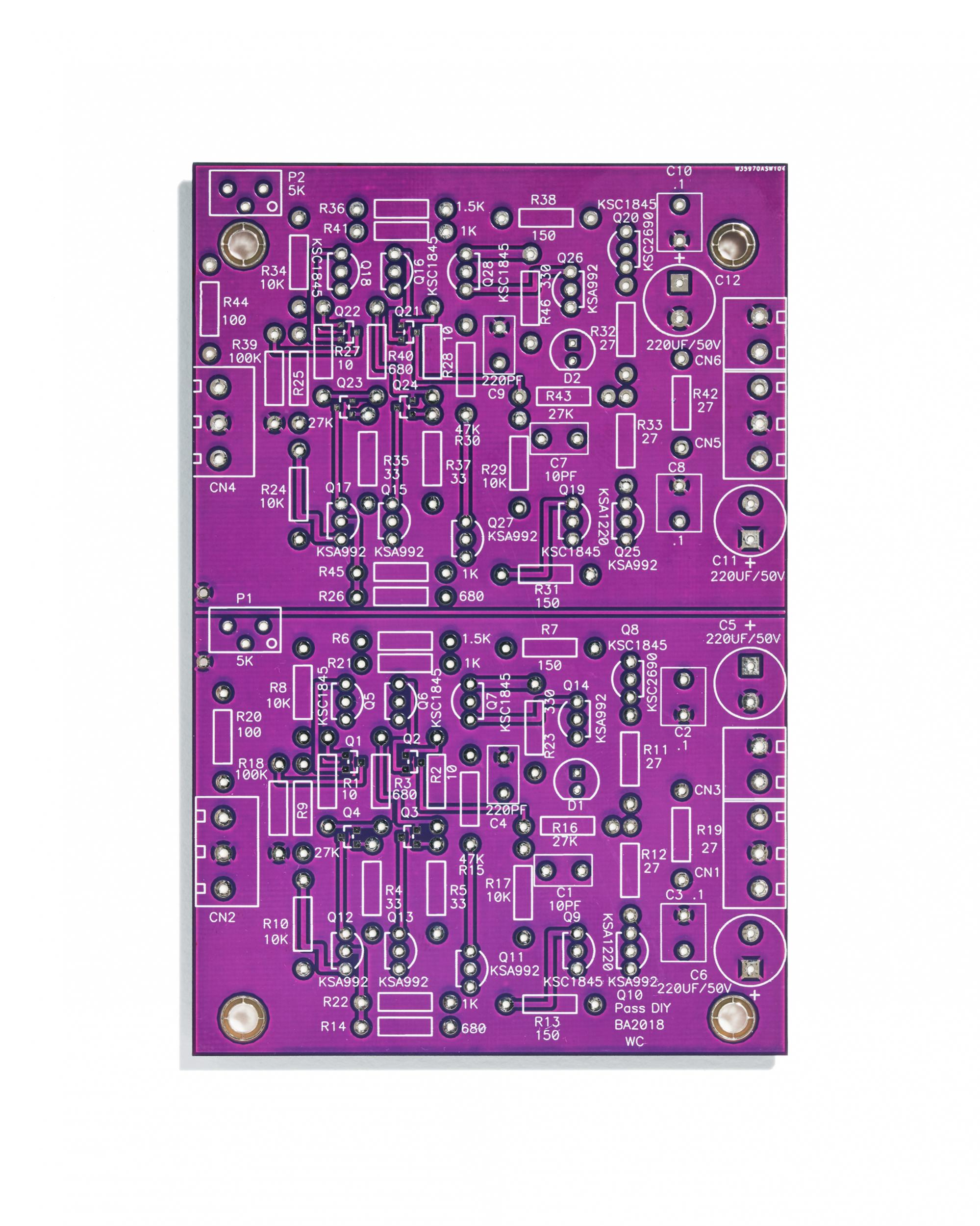

Hmm ok let me put down my wiring with the power amp and preamp in a single chassis and how I did the wiring to showcase if this works. As I think I get lot of hum which seems to be ground loop issue 🙂
Apart from checking the DC offset being closer to the 0mV on each of the mono boards outputs, what else should I check for the bias any other things on the preamp.
Any pointers guys, sorry I looked around in the thread but could not find instructions on the PDF document as well.

Twist the pot to make the dc offset at the output zero or as close as you can get it. That’s it. 🙂

The connections that you suggested work beautifully. There was hum initially then I connected one of the output grounds to the chassis and the hum disappeared completely and dead silent even on headphones 🙂

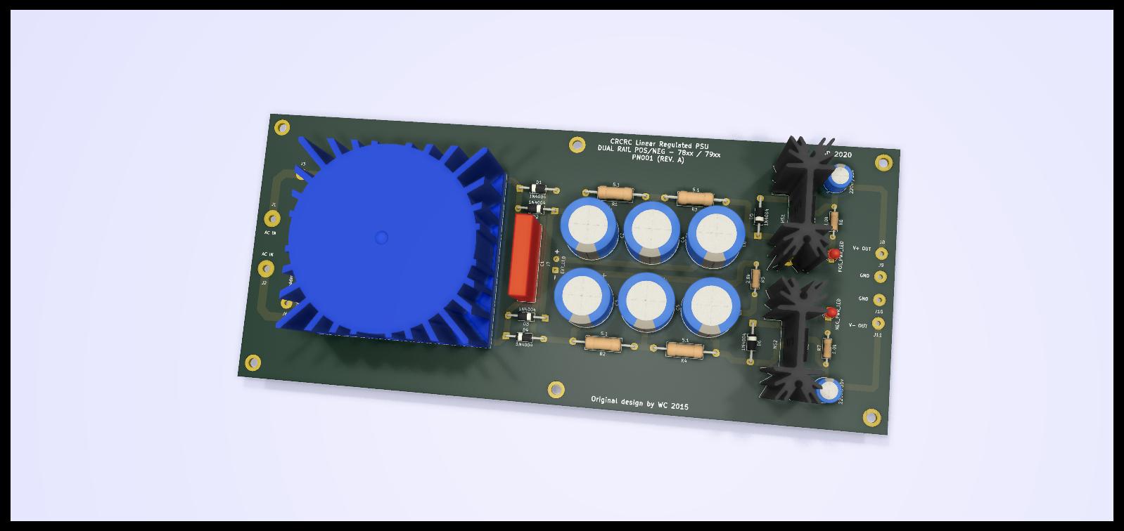

Is this a commercially available supply or of your own design?
It's basically a slightly tweaked version of the supply on the whammy differences being you can't lift the voltage on the output with the LEDs they are simply to provide an idle load and there's also provision for a power LED indicator. Wayne is credited for the original design.
I have made some of my own designs based off this for single rail and another dual rail but with two positive outputs for making PSU boxes for multiple projects.

It will be soon. I first need to get a small batch made for testing before planning on making them available. 🙂

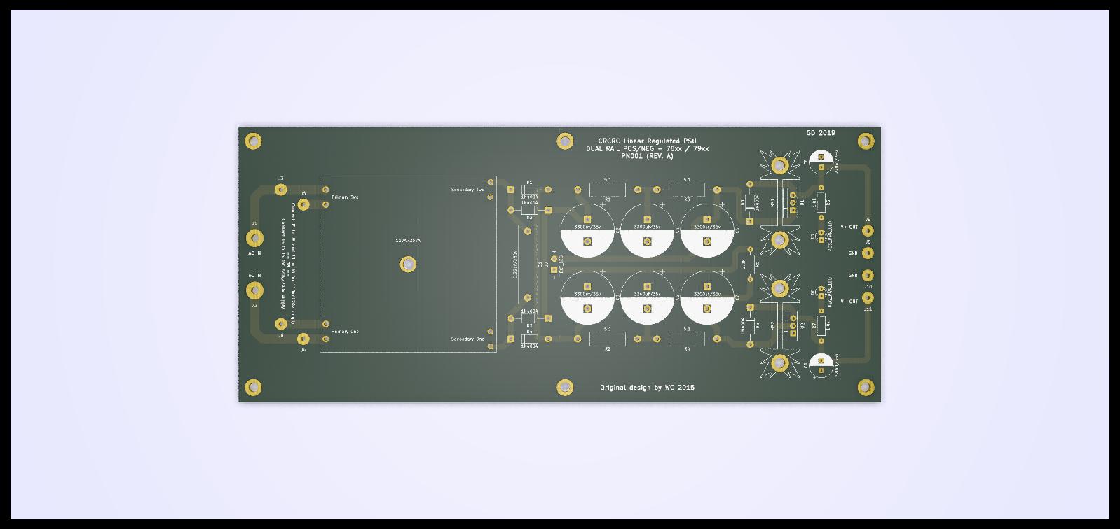

Stereo store PCB will look like this, in BLUE, with a couple revisions to the silkscreen to clarify connections.
I’ll post a photo of the PCB as soon as I have one.
New silkscreen -
New silkscreen -
