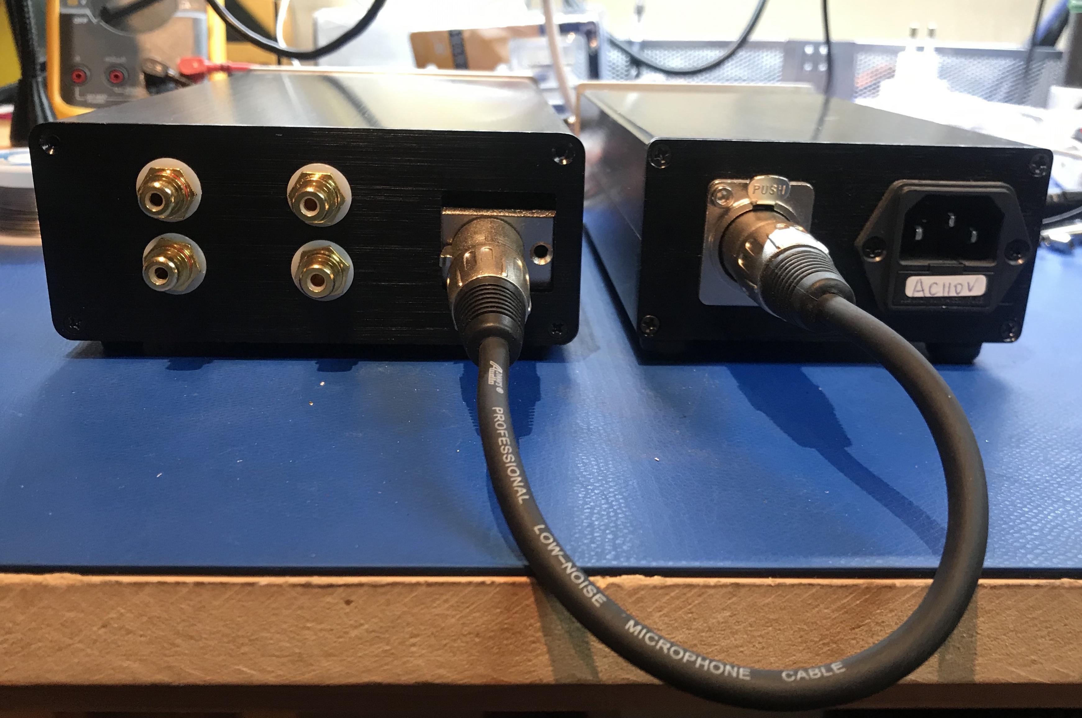

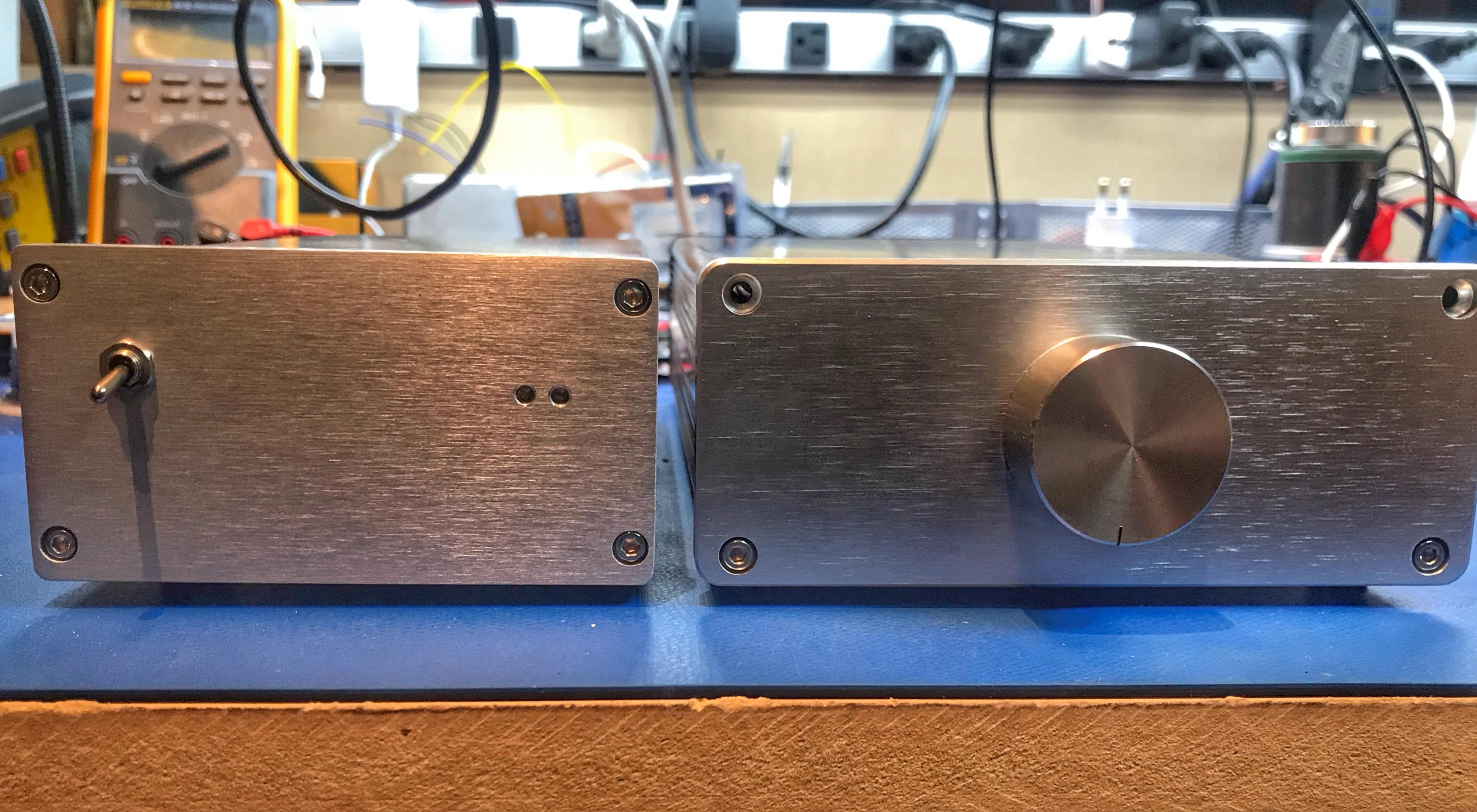

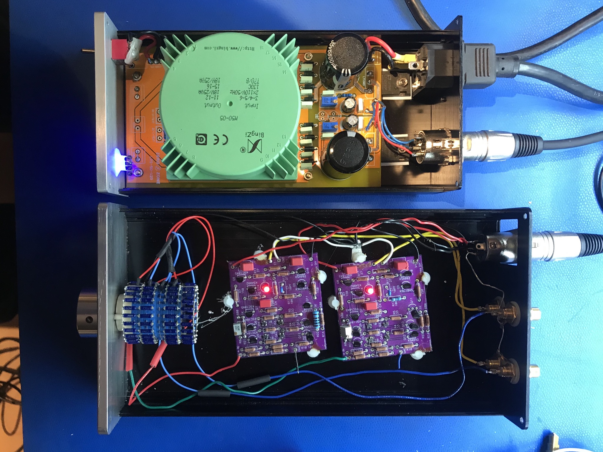

I started on this project a year ago and got about 70% done. I had all of the parts but only one of the two boards that I built worked. So somehow I forgot about it (or ignored it) for about 11 months. But I finally got back to it and a blast from a hot air rework station gun aimed at a suspicious looking SMD part got the second board working.
And finally, though it isn’t particularly attractive, it is done and it works.
I think you are being hard on yourself. It actually looks quite nice to me. What power supply are you using? I am looking for something like that for another application.
I agree! Looks great... give us some more details!

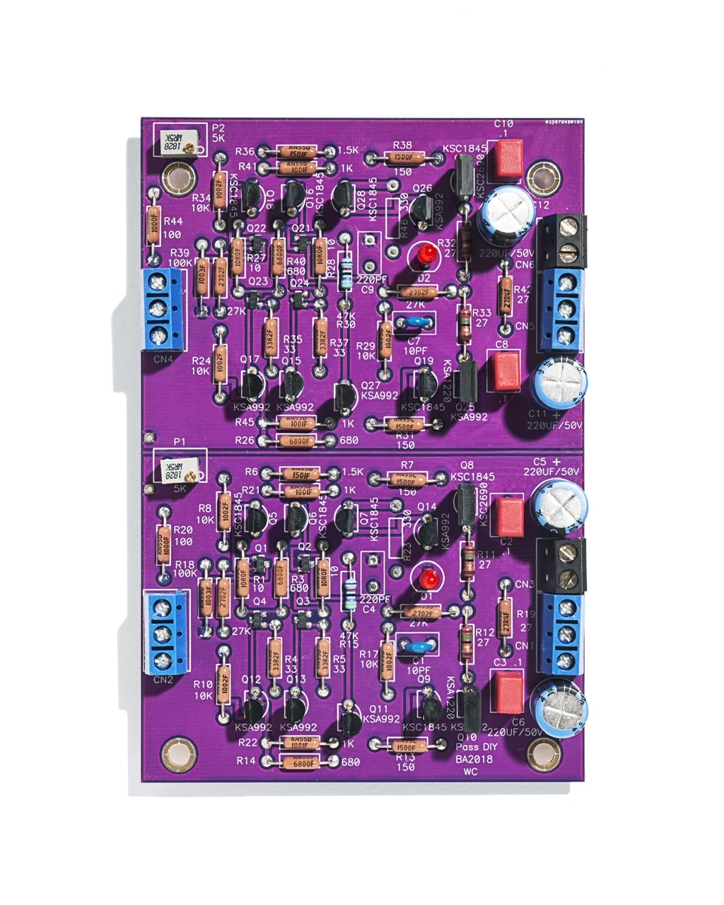

Is there a picture of the Stereo board, plus board size and connection positions?
I'm starting a case layout design, while waiting for availability of PCB's.
Looks quite nice to me. 🙂 Neat and compact. Well done!And finally, though it isn’t particularly attractive, it is done and it works.
Values of R3 and R6 on pcbs regard to schematics are different.
What are right values for R3(100 or 680 Oms) and R6(680 Oms or 1.5k )?
