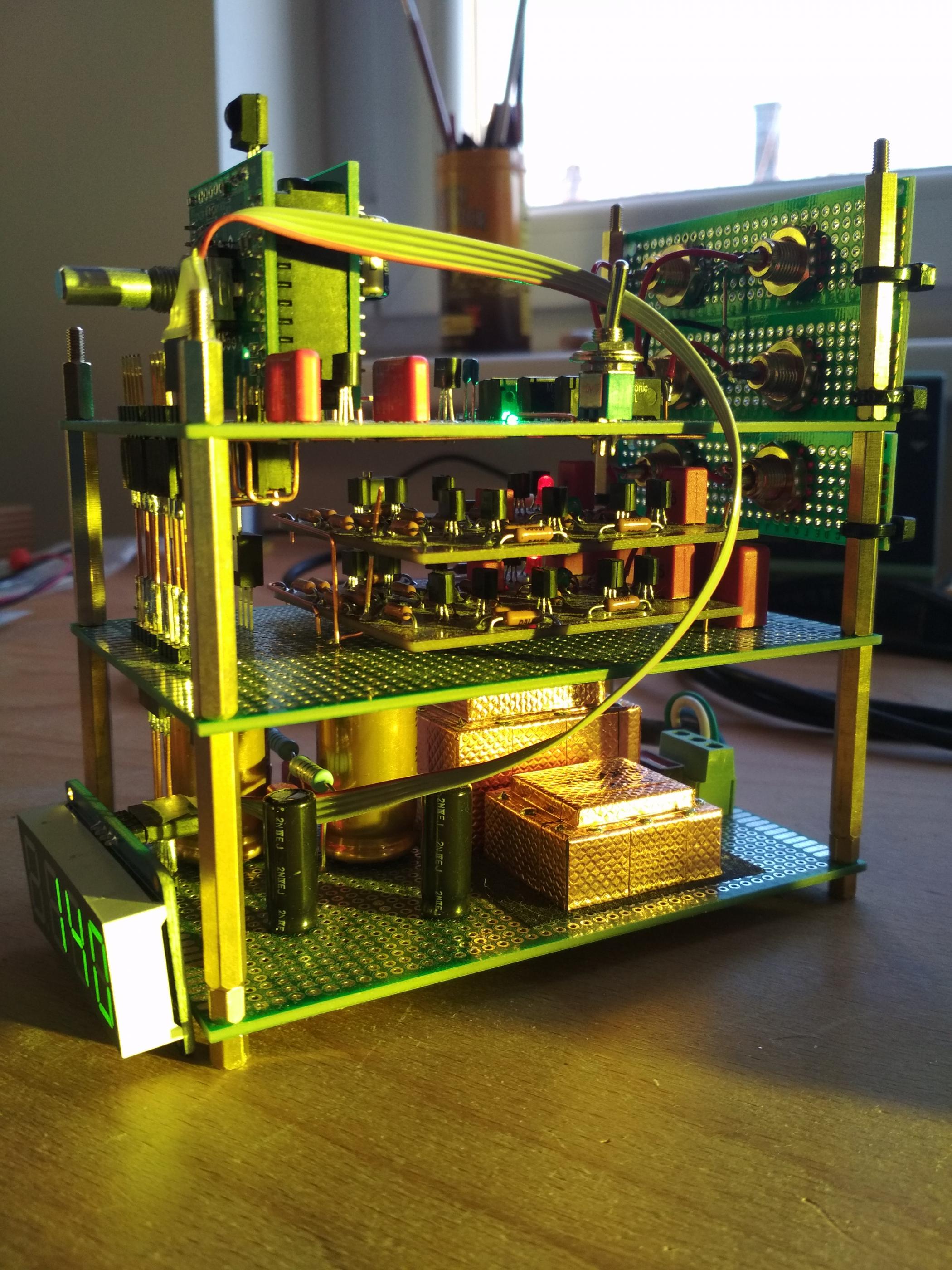

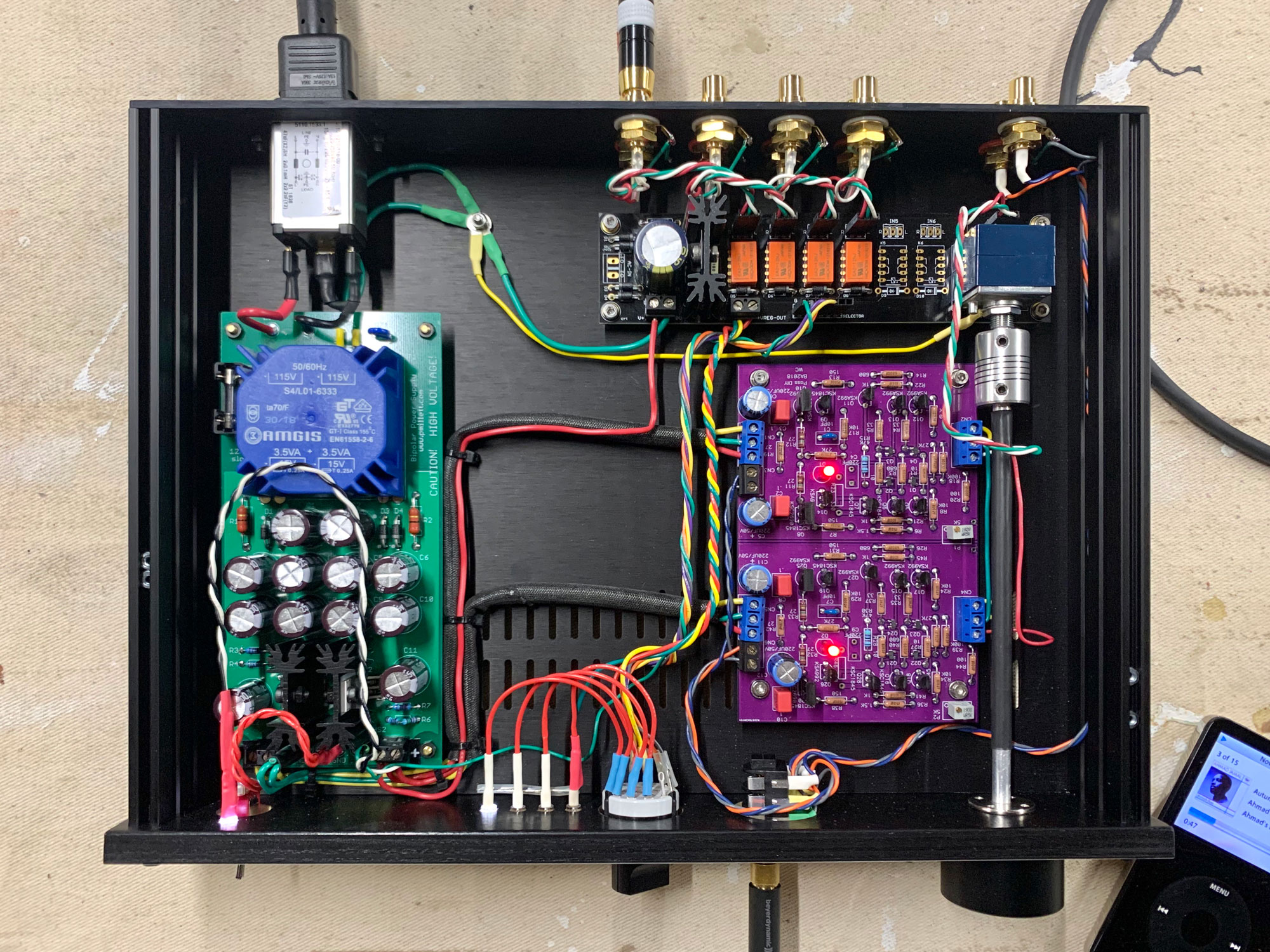

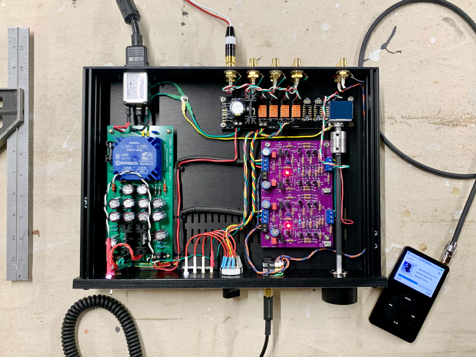

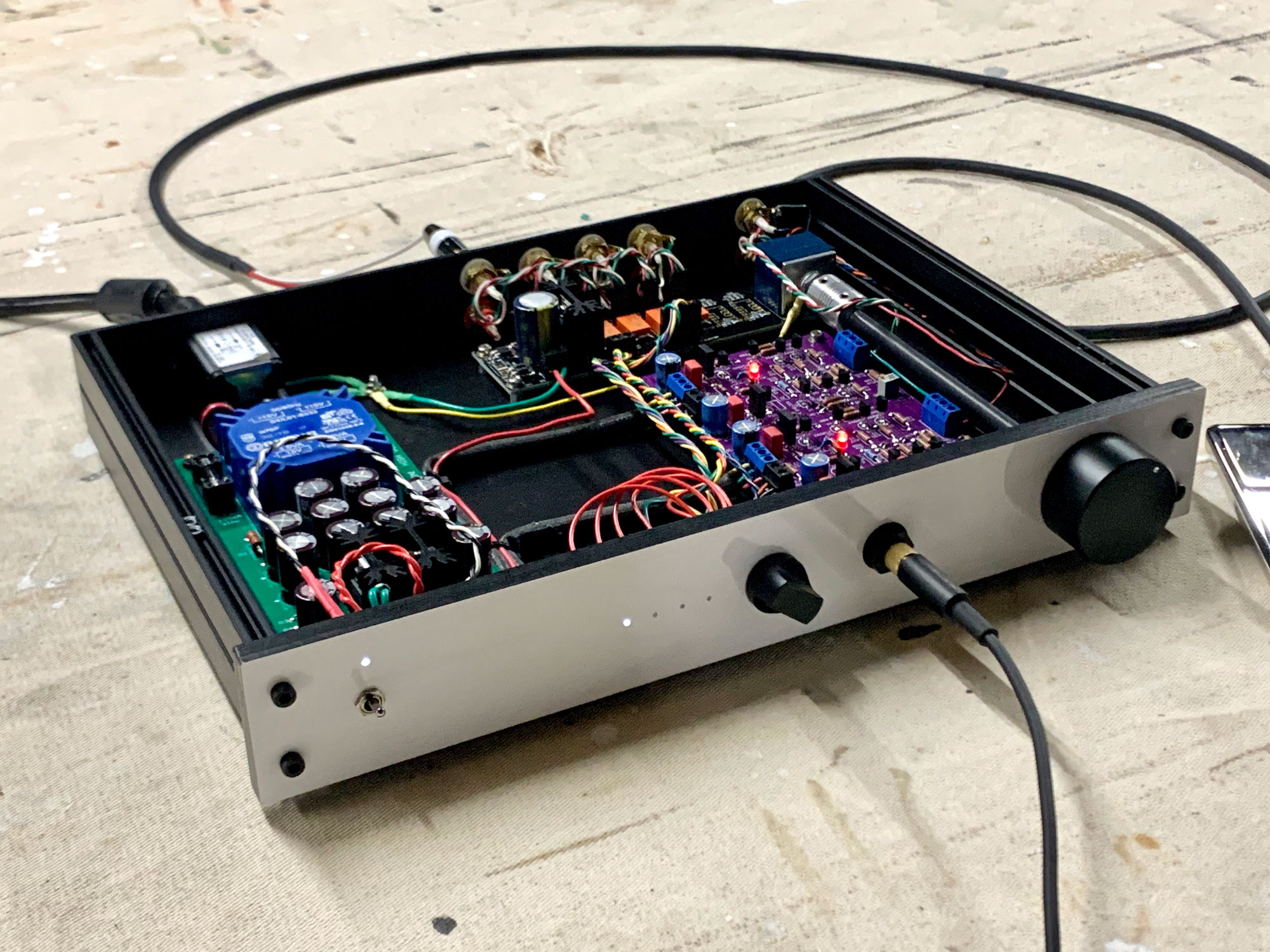

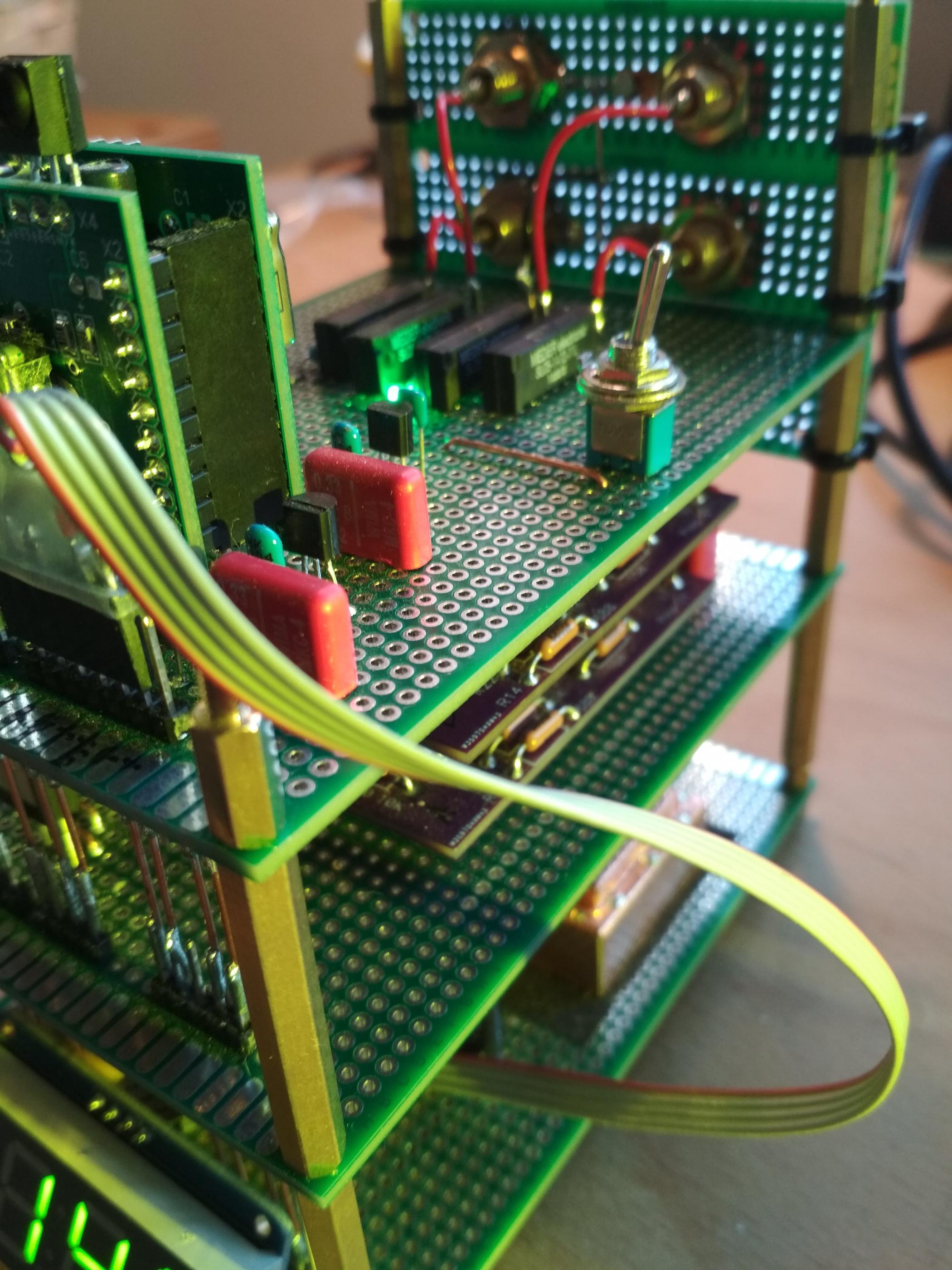

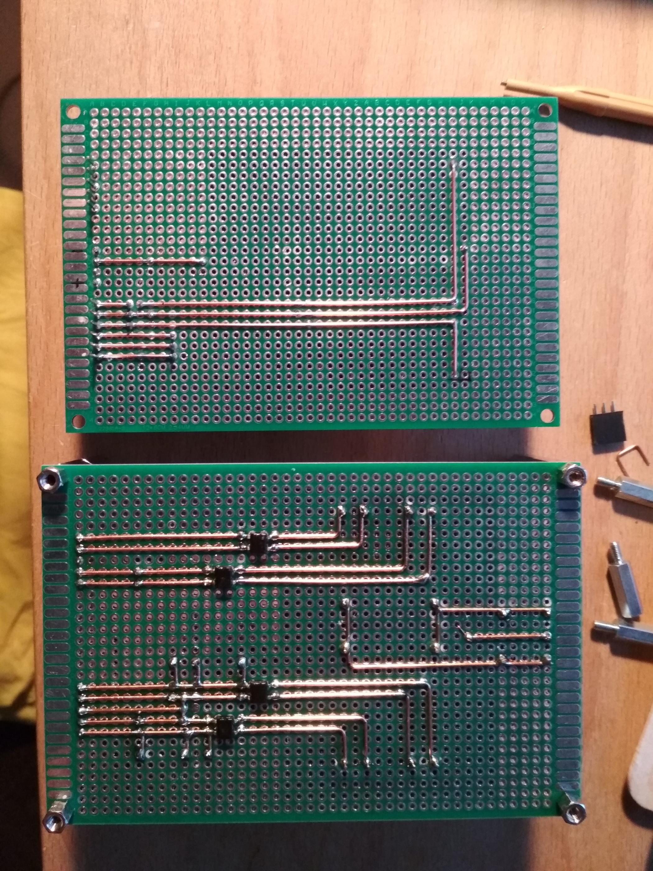

Here is my implementation of Wayne's pre.
I used Meladano's Muses volume.

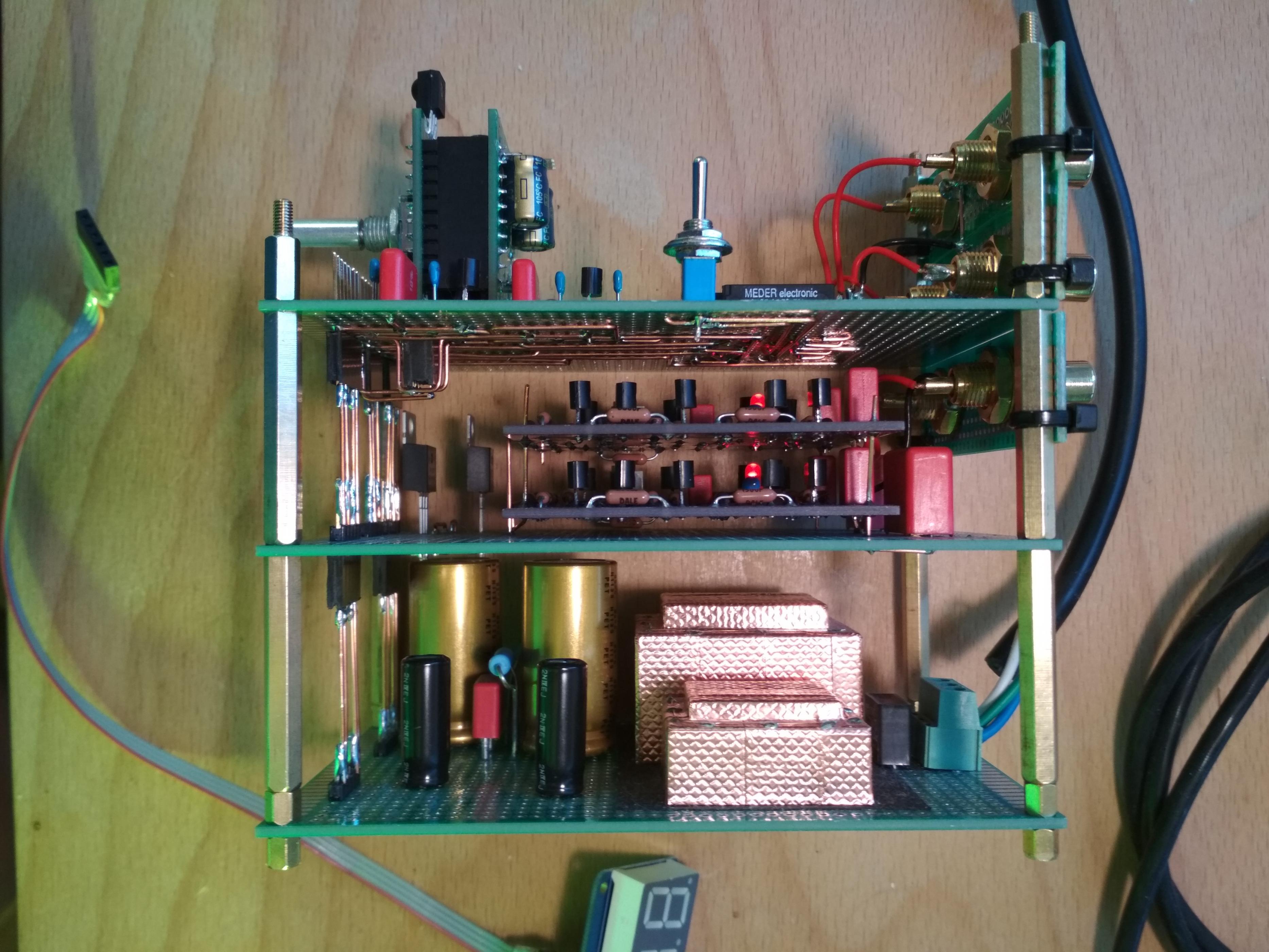

Different PSU for analog and digital section (78xx and 79xx with RC filters), display is very noisy.
I finished it last night. It was turned on for the whole night.
I wanted to set up the final offset on morning and I drilled a hole on the upper PCB to easy reach the trimmers.
I broke out both pots with the drill bit.
I don't have replacements in this form factor.
Jim, what is the part number of the trimmers?
Use a RC Filter in display power supply 😉
Beautiful implementation, I love the form!

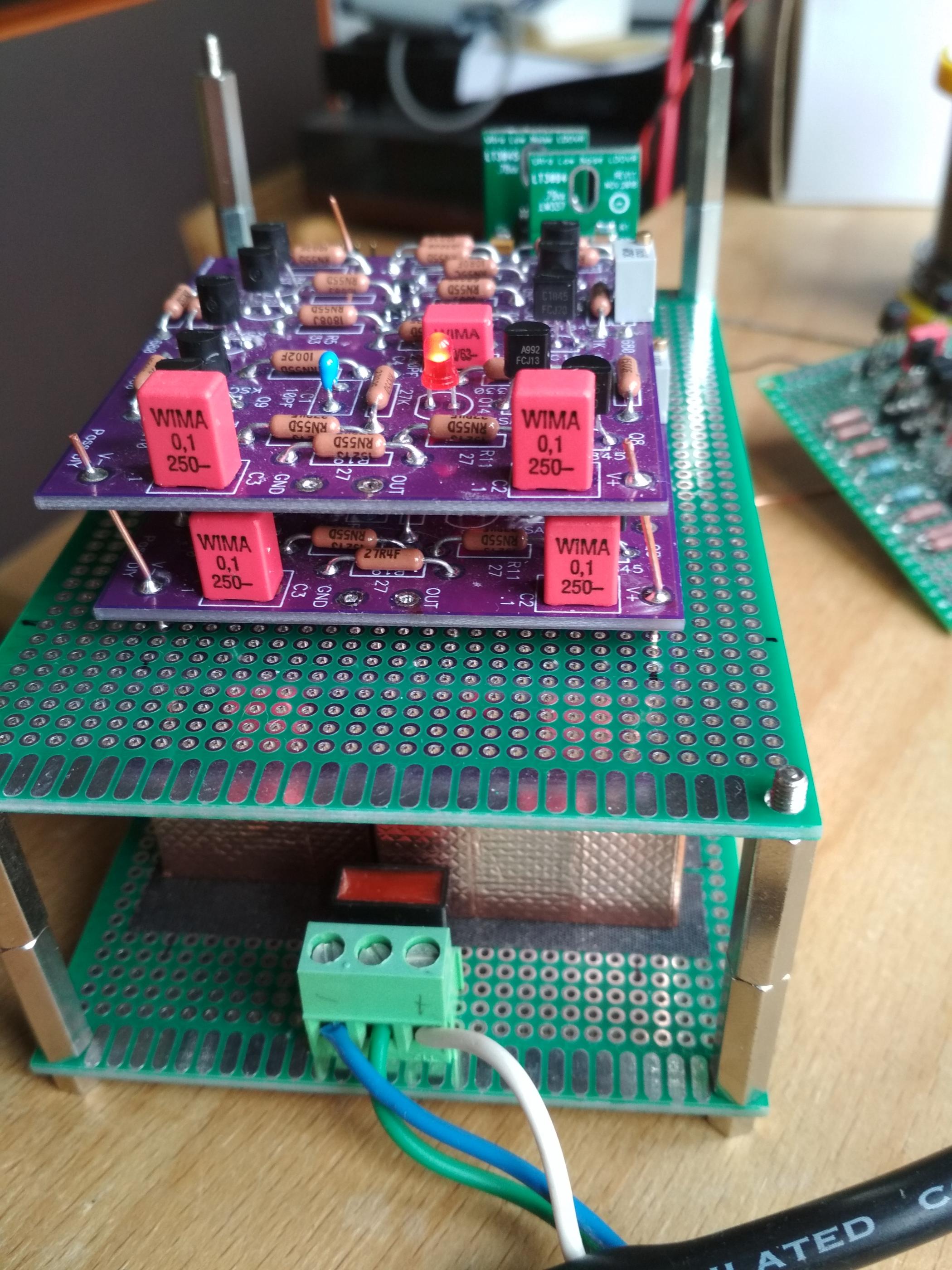

Brilliant build. Are the amp boards mounted by the power and ground solder pads and copper wire?

This is awesome, great build, great layout, and wonderfully short signal path. Very clean build!
Yes.

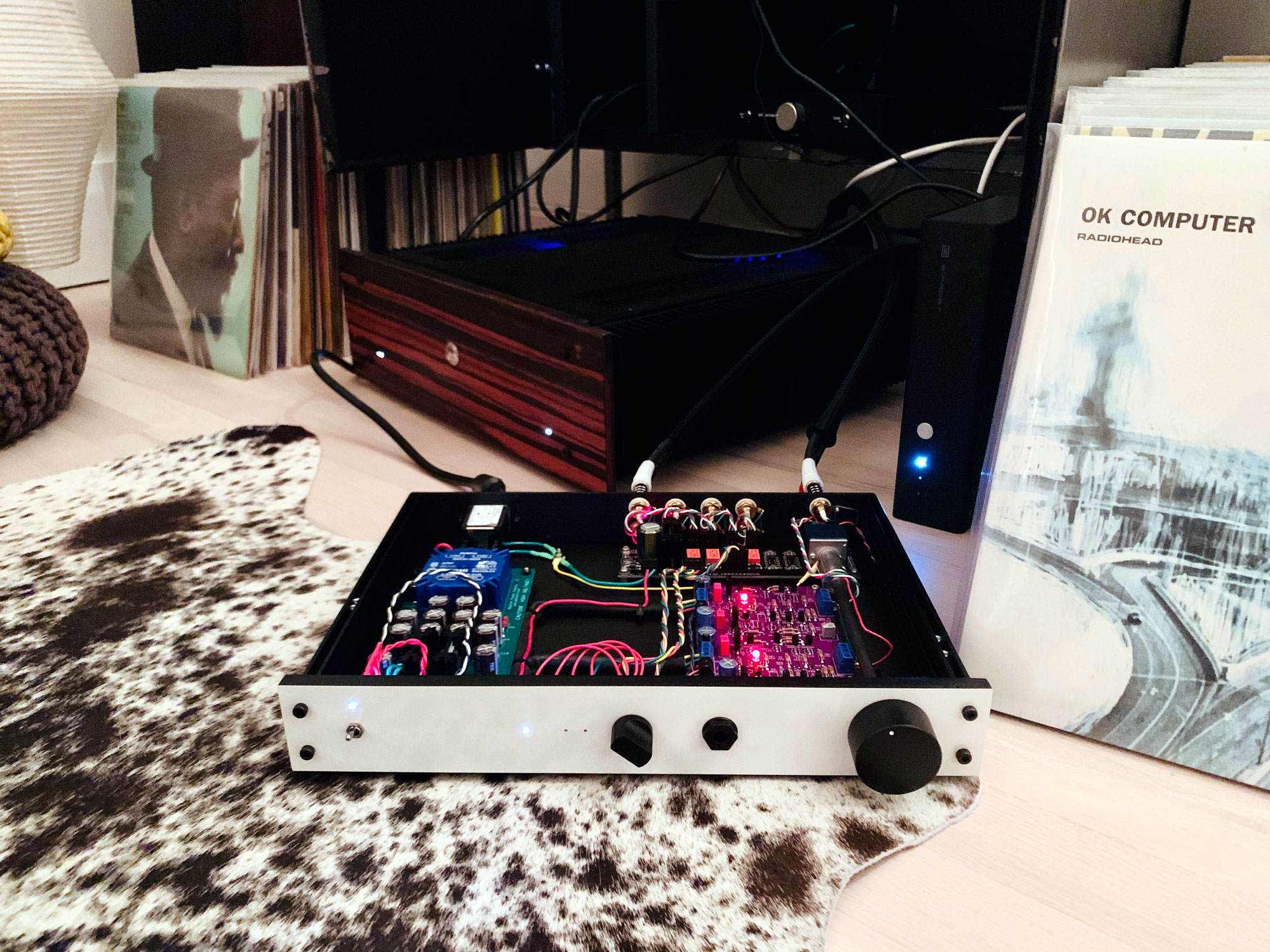

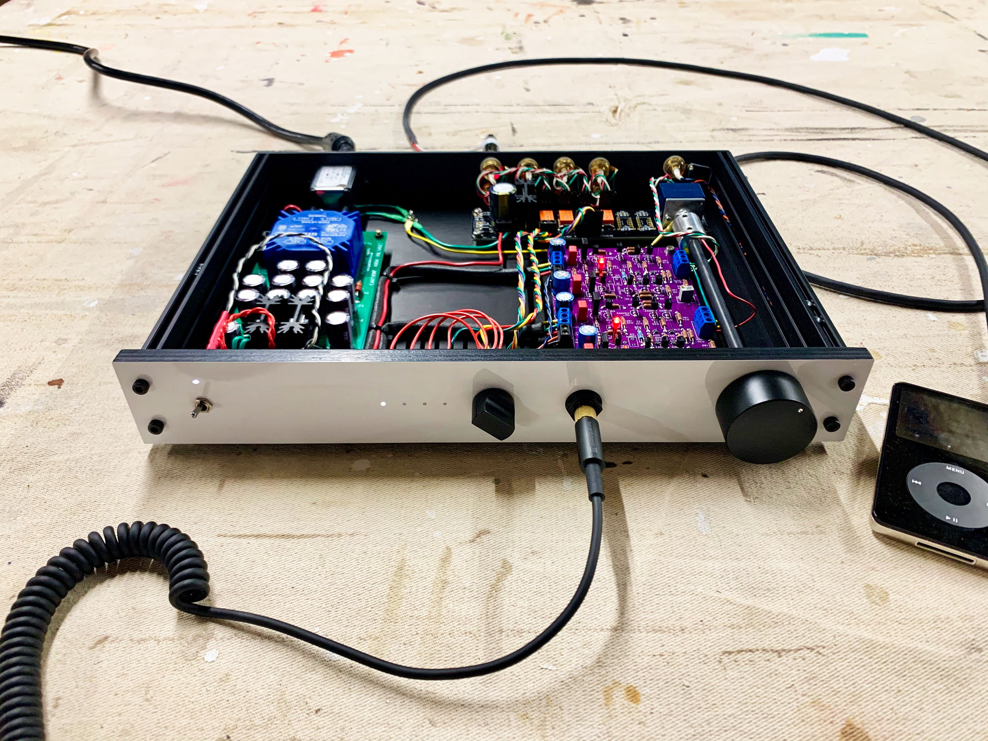

Okay—so my build is different from Rookakoma's—MAN, YOUR BUILD IS INCREDIBLE!... LOVE.
Took a bit to get it quiet (Wiring it up wrong at first didn't help—didn't follow my own wiring schematic! gah!)—but WOW. DEAD SILENT now. Really loving what it's doing through the phones... Can't wait until plugging it into AJ. And do some A/B action with Mark's Noir just for enlightenments.
Most of the issues I had were understanding how to wire up the selector from the Salas Mezmerize-style input selector.... And putting ground wires wherever I needed to to get it silent (Thanks 6L6!!!!!!)
And of course—thanks Wayne! This was an AWESOME build.
