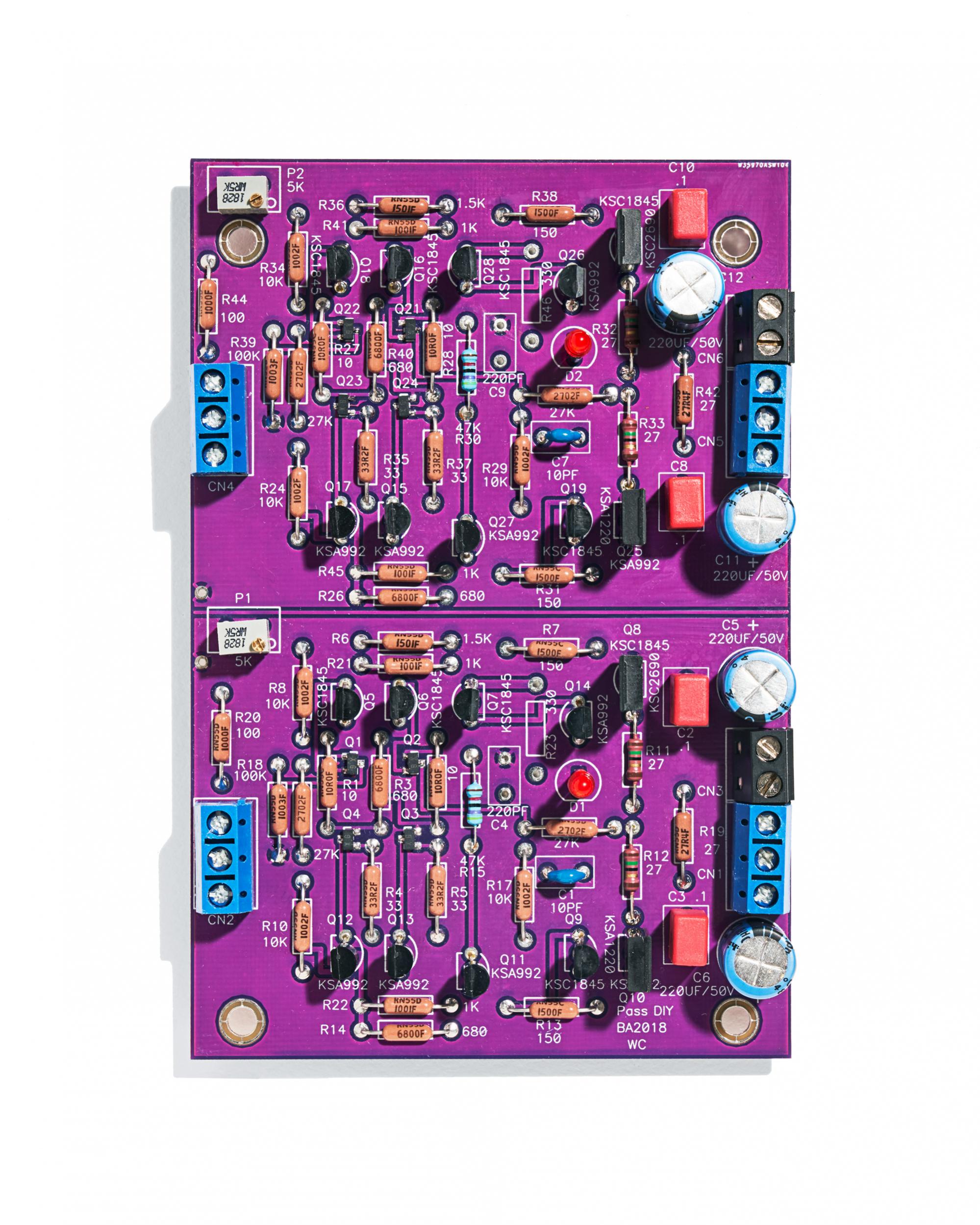

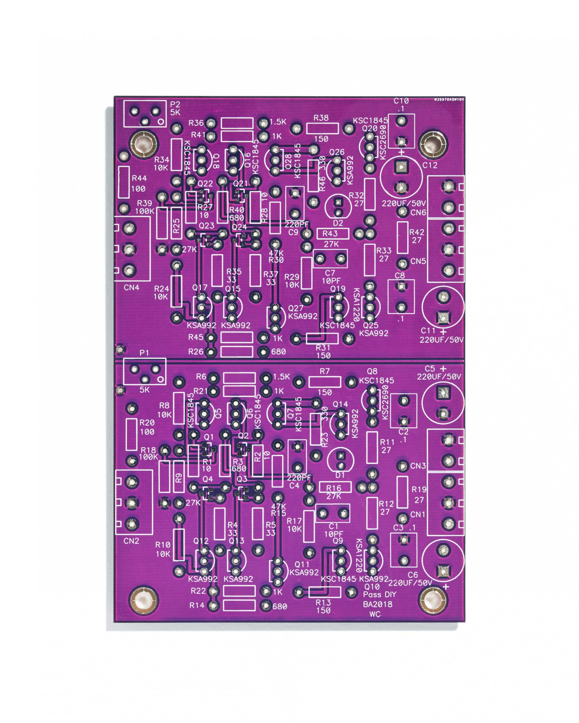

The stereo version of this board is done and the gerbers off to 6L6. It can be built SE stereo with one board and balanced stereo with two. The silk screen is a bit tight but has all the needed information.

Some pics of the Prototype Purple Pre board in the wild—stuffed and bare—I was fortunate enough to be a guinea pig (SMD parts!! F U N.)... The DIY Store version will be DIYAudio Blue, silkscreen a little different I understand.
Waiting on a chassis (enroute) and I'm ready to wire it up. Thanks Jim and Wayne!
I currently have the original 'mono' versions that Wayne had distributed a long while back so nice to see this new version hitting the diyAudio Store soon.
I see one nice application for it. Use a single board (with a balanced/differential source) and connect to a pair of MOFO boards (one attached to each heatsink, and biased to 2.5A each with a +24V DC supply) and then use it in a balanced input bridged output configuration. Output impedance will double (damping factor will be 20), so about 0.4 ohms output impedance. Should get you loads of power in class A (~nearly 100 watts) as long as Wayne's linestage can swing enough volts to clip the MOFO's. 2nd harmonic will be nearly cancelled which may be something you do or do not want. Similar to an ACA balanced input bridged output monoblock but much better measurements most likely.
