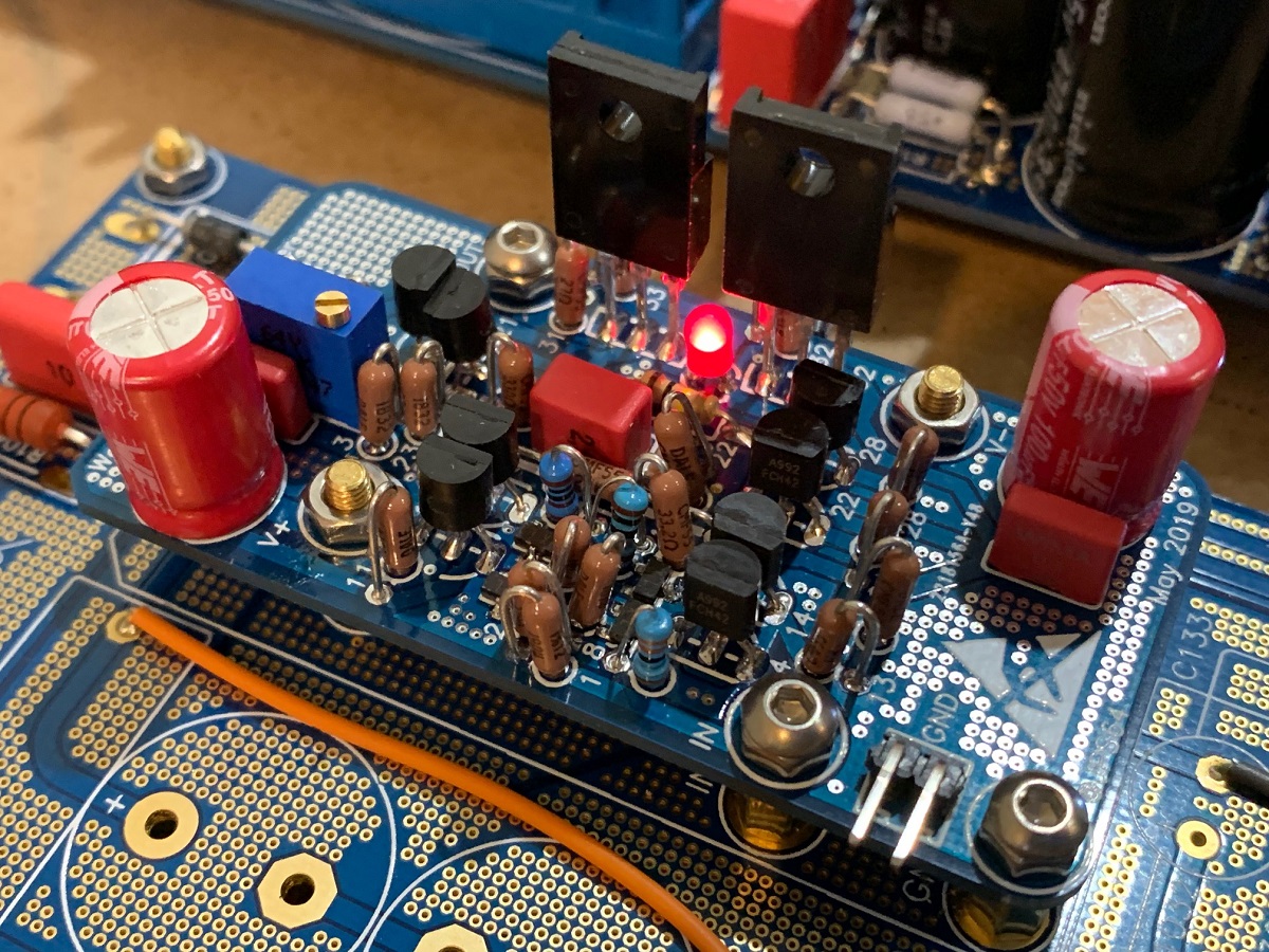

Two channels on one board with isolated grounds and mounting holes and then the board edge connectors. There is a jumper to connect grounds if you want and use one board for balanced.

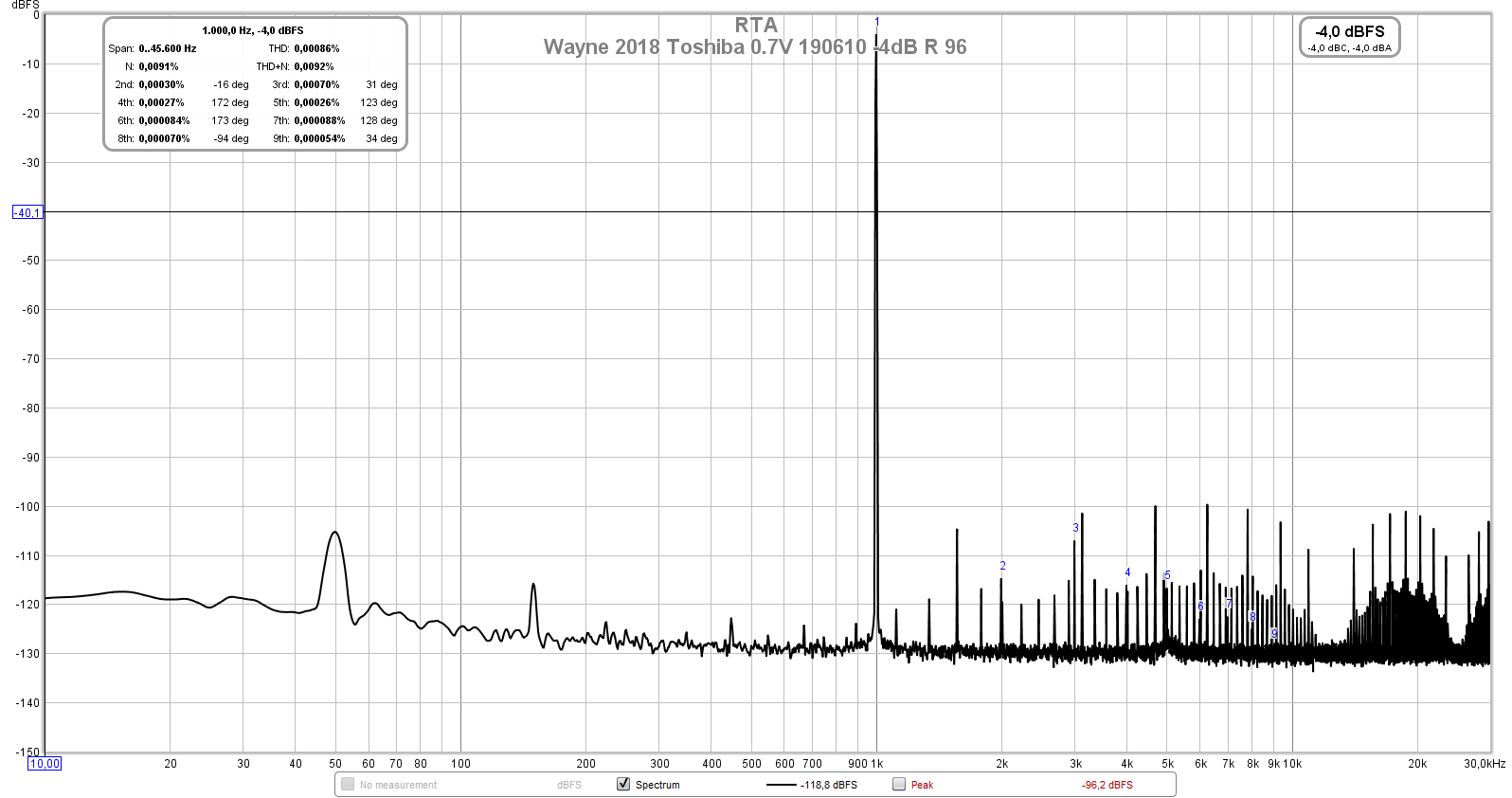

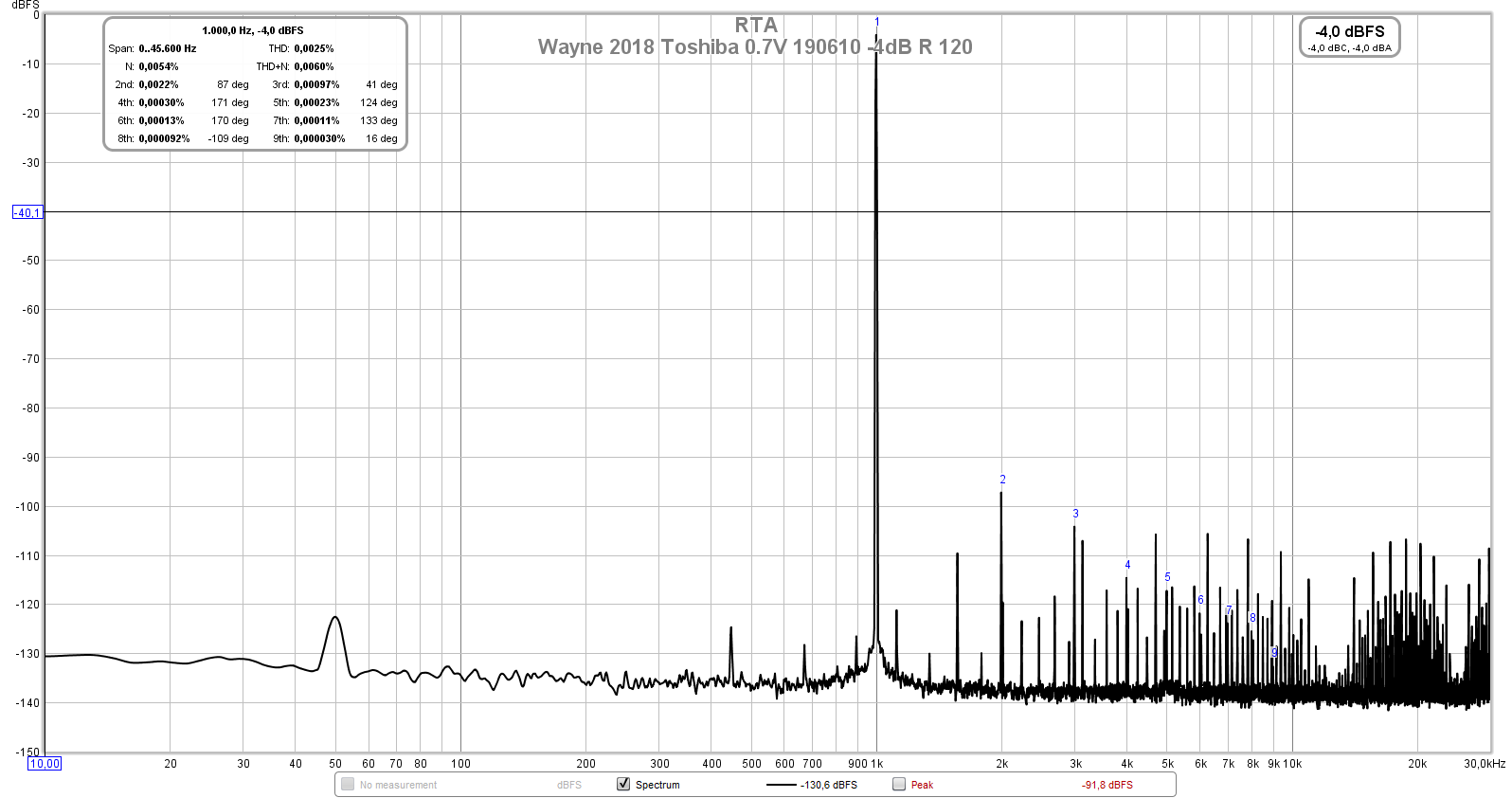

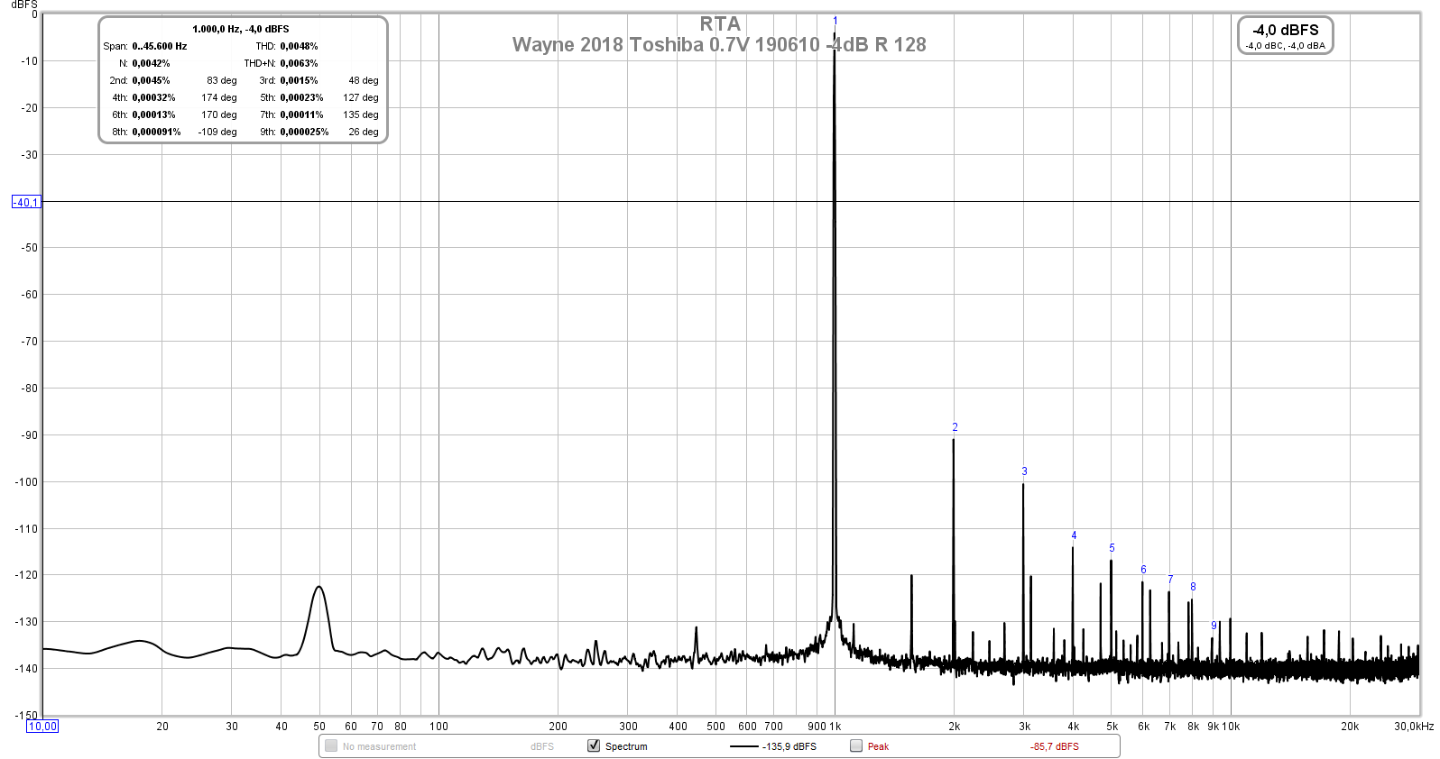

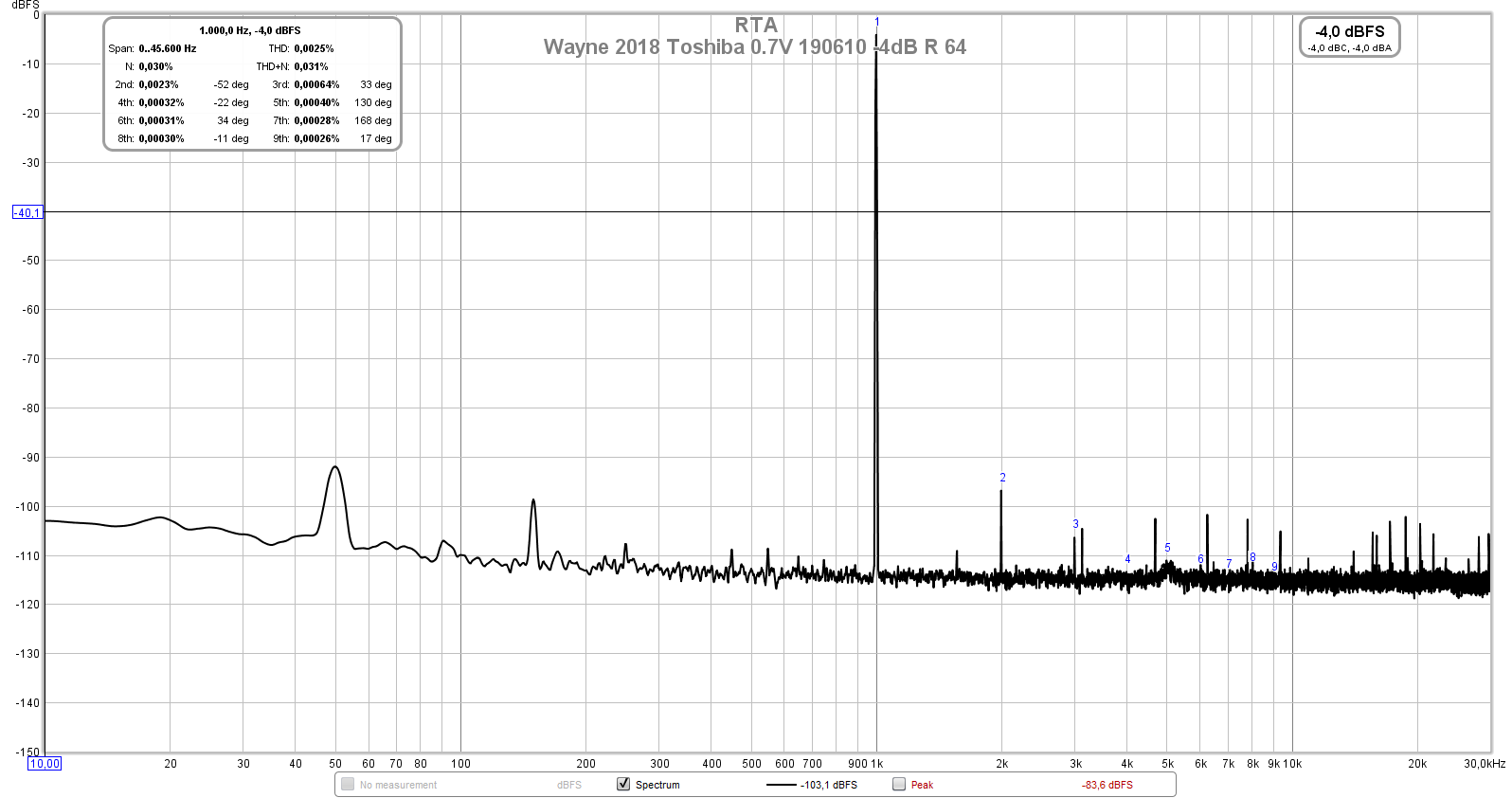

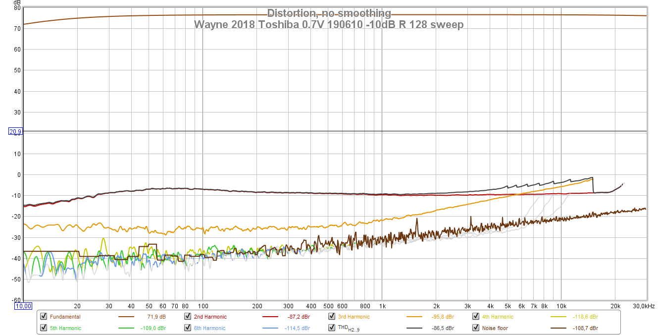

I dug out the pictures from my own measurements, done with a Focusrite 2i2 and REW. My BAF 2018 linestage (see my earlier posts in this thread) was built with Toshiba TTA004B and TTC004B as output transitors, 15R emitter resistors for the outputs, and a WIMA MKP10 1uF cap at the output.
All measurements are with 0.7V RMS input signal, attenuated by the preamp resistive divider circuitry the line stage is built.
So here it goes, 64 mV RMS output:
The next is 390 mV RMS output. Please ignore the hash to the right of the 1kHz fundamental, that's spuriae from the relay-based attenuator's control logic that is feeding through into the signal:
Now, 1.49 V RMS output voltage:
And, 2.63 V RMS output (no attenuation):

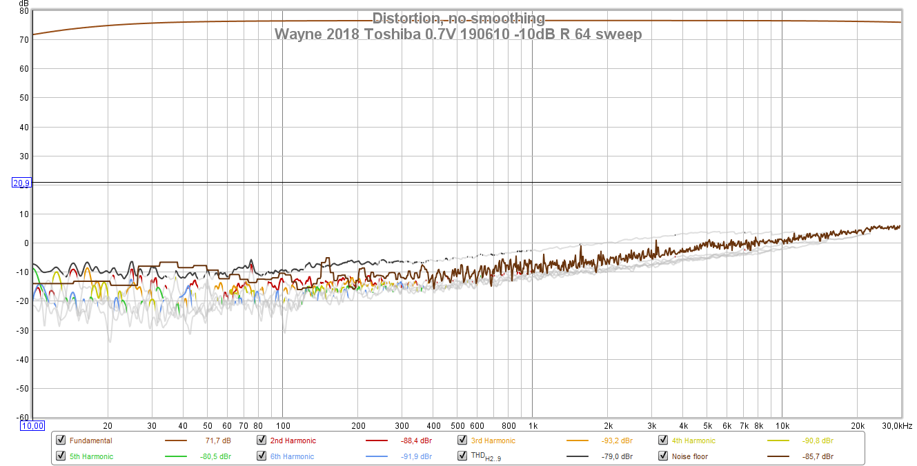

Finally, I got some stepped frequency sweeps to show distortion vs. frequency.
First, at 64 mV RMS ouput voltage:
And the second one at 2.63 V RMS output voltage:
For my build of the linestage in the configuration I had at the time, the lower -3dB point was at around 1.5 Hz (due to the output DC blocking / coupling capacitor), and the upper -3dB point was higher than 2.2 MHz (the upper limit of my frequency generator 😛).
Hope you find this interesting,
best regards,
Claas

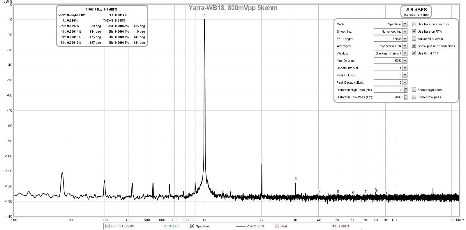

Thanks for the measurements Chede. I was also using TTA004 and TTC004 outputs during tests presented here. My THD and profiles were similar to your as measured but I had some +/30v rails.
Here was 2Vpp into 52kOhm load with 0.0017% THD and second harmonic dominant signature - nice sounding preamp:
Was your load impedance 64ohm? That's headphone amp terrritory more so than line-level preanmp.
Hi xrk971,
no, load impedance in my case was 100k Ohms. Sorry, had not included all info in my previous thread ... the last number in the naming of my measurements just was the setting of my volume control 😉, which sits before the input to the line stage ... it has a constant 50k input impedance, but it's output impedance (what the line stage sees as input impedance varies from about 1k at low volume settings to about 25k at max. volume setting.
Resulting output voltage of the line stage for a signal input of 0.7V RMS into the volume control is noted before each pic.
Rail voltage in my case is +/- 18V dc.
Best regards, Claas
Best regards, Claas
