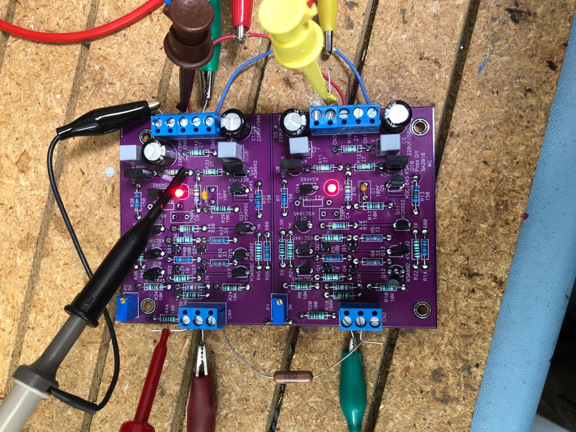

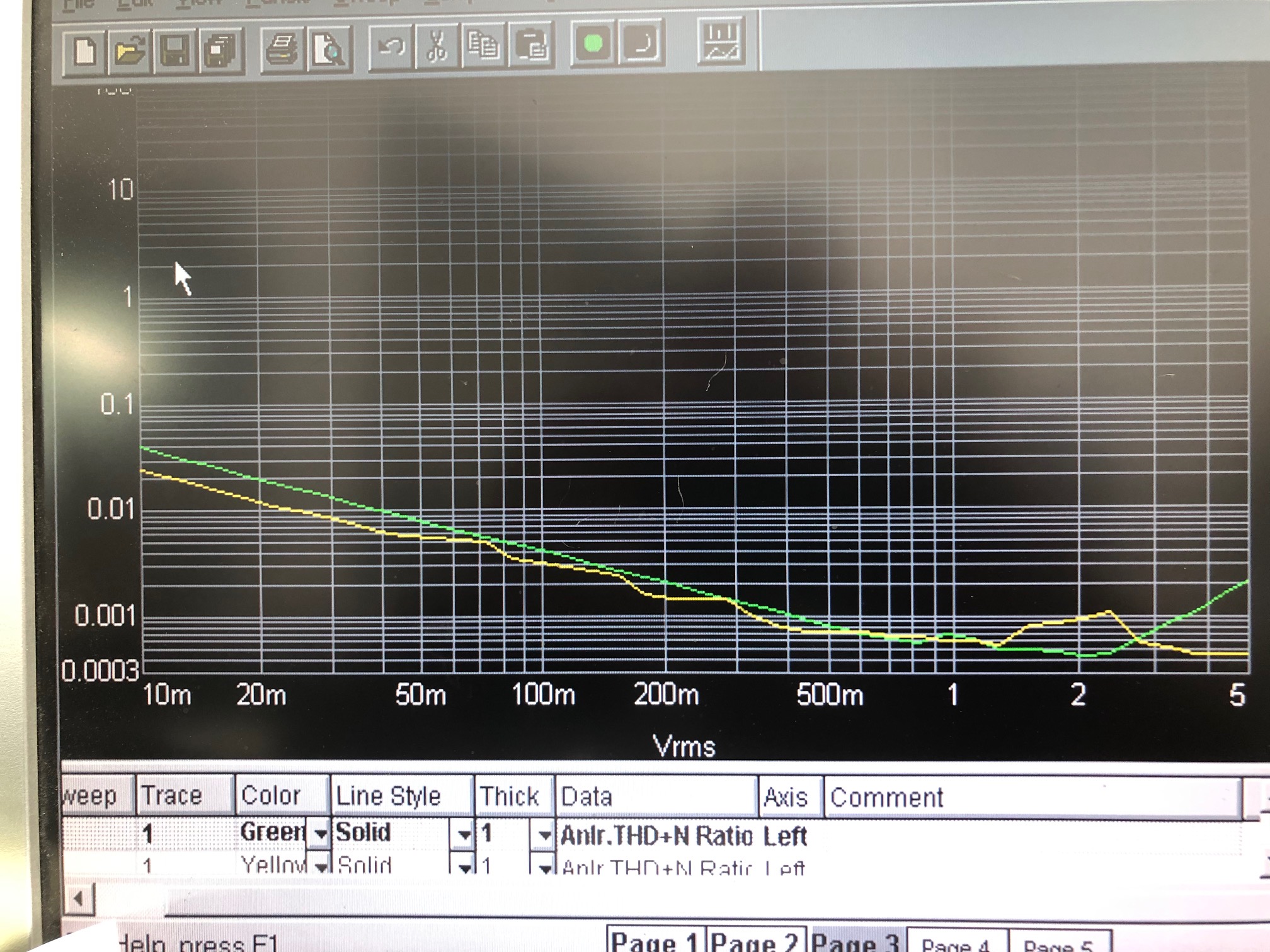

I have built and tested the version of this for the store. It is a stereo board that can also be built as balanced by adding a jumper. The distortion comes close to the AP limits. It will mount in the store chassis on MM spacing.
Thanks Wayne. Barring form factor and mounting holes were there changes from the ones you handed out at Burning Amp last year?
