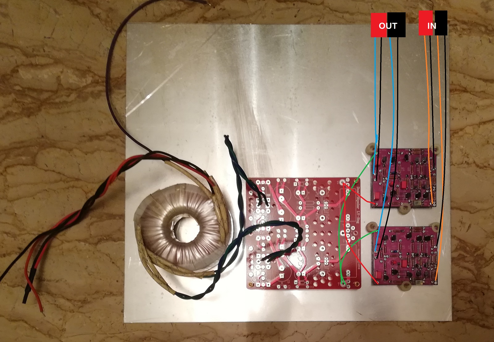

Some progress on my Wayne BA 2018 linestage build (finally!).
Any comments on the planned layout (attached)?
Power supply board is from GlassWare Audio Design (bare PCB in picture, not populated yet), transformer from Antek 2 x 18V.
Drawn the wiring using Paint.
The bottom plate is aluminium 13" x 12". I can possibly reduce the depth of the case by 3"-4", resulting in sorter input/output wires.... but that means more work. 🙂

Hi Zman,
What is your plan for volume control and source selection?
Probably something I have in my parts drawer - a 50K Alpha Taiwan pot or one of the DACT clone pots from Ebay. Did not draw the pot connection in the layout pic.
Nothing for source selection.

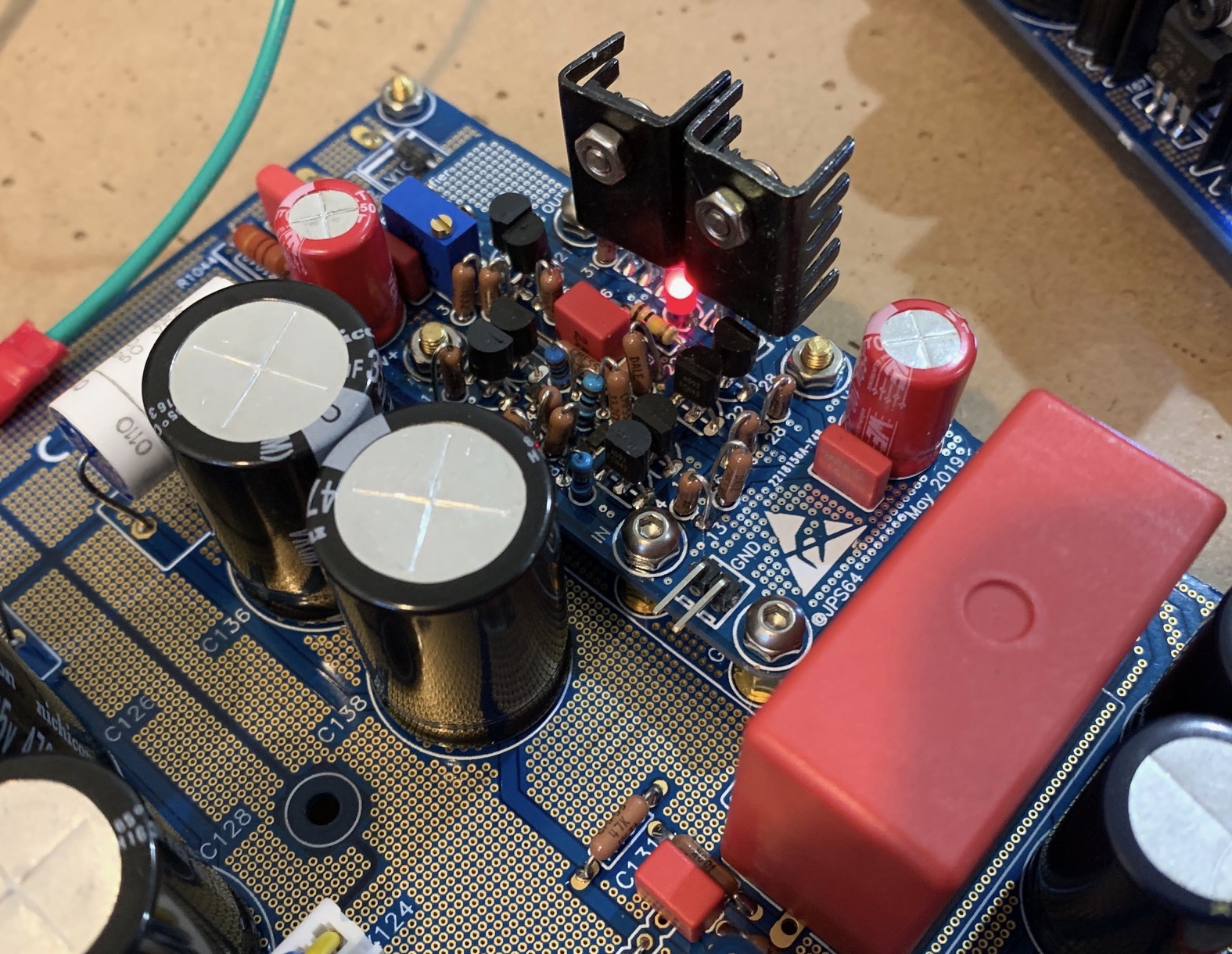

Listening to it now. Sounds very nice. The cap coupling was key to getting rid of all that DC drift on this circuit.

Yes, the Yarra/M2X format boards. But I am using on Yarra - more info here:
The YARRA Preamplifier/HPA for Melbourne DB Group Buy
Basically the BOM specified huge input Wima 10uF MKP input cap and the dual 4700uF 35v back to back Nichicon output caps bypassed with a 5uF 50v metallized polycarbonate cap - although any 2.2uF to 4.7uF film cap could be used here.

Thanks. Going through the group buy thread, I see That I did in fact get those boards. Are the coupling caps you added in the bom or do I need to add them?
Time to assemble these boards and try them out!
PS:
Whoops, I see you state above that they are in the BOM. Thanks again!
