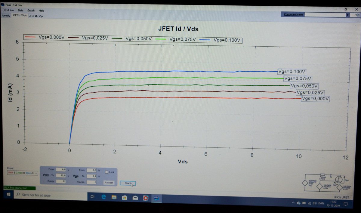

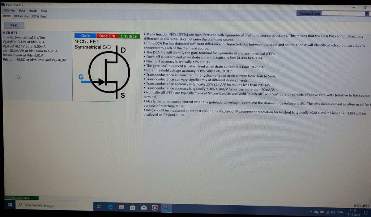

I used some time yesterday on 2SK209 (GR) measurement using a Peak DCR75 pro. I only have 10 2SK209 and I will use 8 so it was only to group them and also the see how close they are and also good to know they work. What is strange is that I don't agree with Peak DCR. What I think I have learned from this forum is that JFETs are depletion mode and Idss is the highest possible Ids at Vgs = 0V. So I think in the attached curve trace Idss = 4.2 mA and not 2.8 mA as indicated.
They write that if JFET is symmetrical it is not possible to detect D and S. But knowing that it is depletion mode and Ids declines when Vgs goes negative it should be possible to detect?
But anyway it is OK just the indicate the numerical Vgs value but I think the Vgs indication should be in "reversed order" in curve trace?
If not I am very confused 🙂

One thing more I think I have learned is that FETs are "square law" devices. Relation between Vgs and Ids is not linear (in saturation region)?
But looking at curve trace above it looks quite linear and not at all "square law"?
Why?
Why?

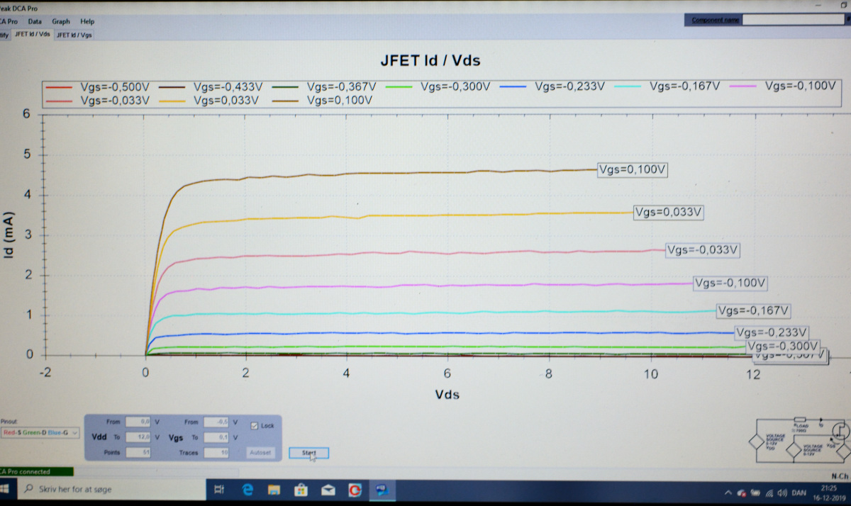

I found my error using the DCR Pro as curve tracer.
Now it looks as expected and shows "square law" between Vgs and Ids.
On data sheets they never show Ids when Vgs goes positive. Ids continues to increase when Vgs goes positive. Should probably keep it below 0.7 V.
Idss was about 2.9 mA on all devices which is in the low end for a GR.

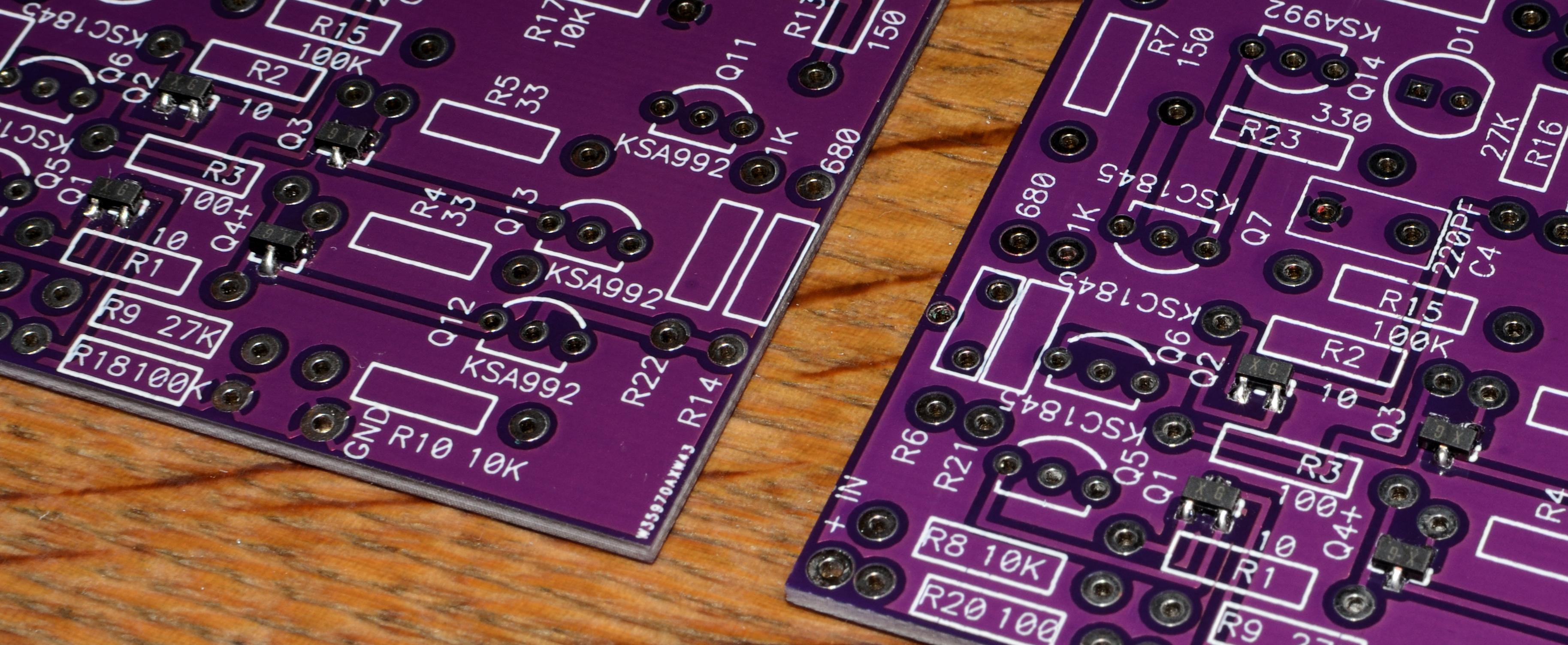

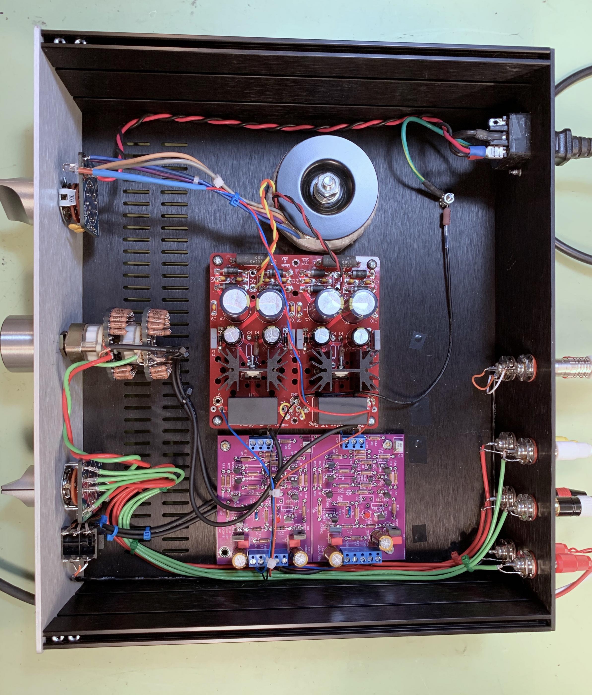

It was actually a week ago but I'm finally getting around to posting the photos... Here's the stereo PCB installed and working beautifully.
The were a few silkscreen changes done, but nothing to the layout, they work perfectly. They will be sent for production and be in the store in however much time that takes. 😀

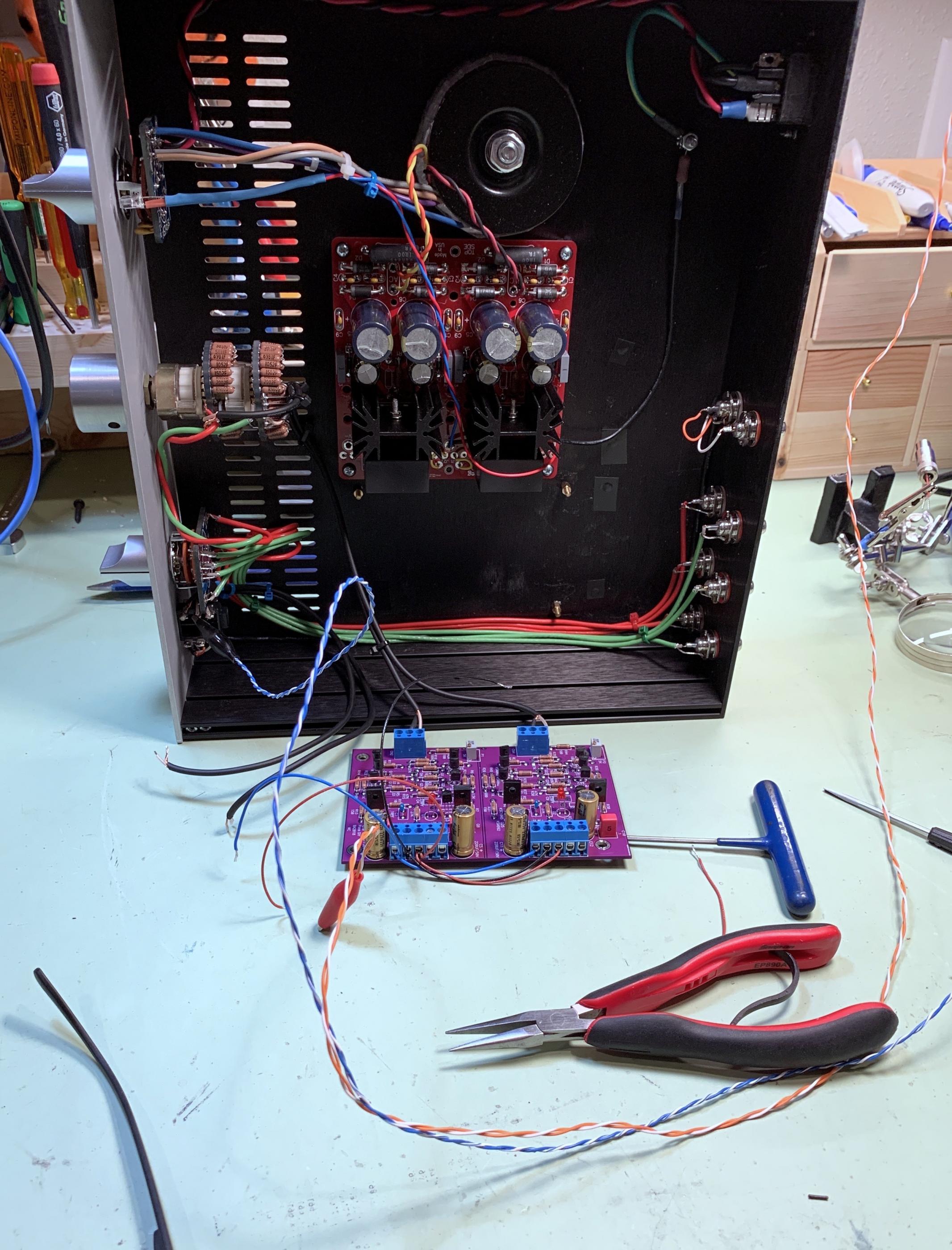

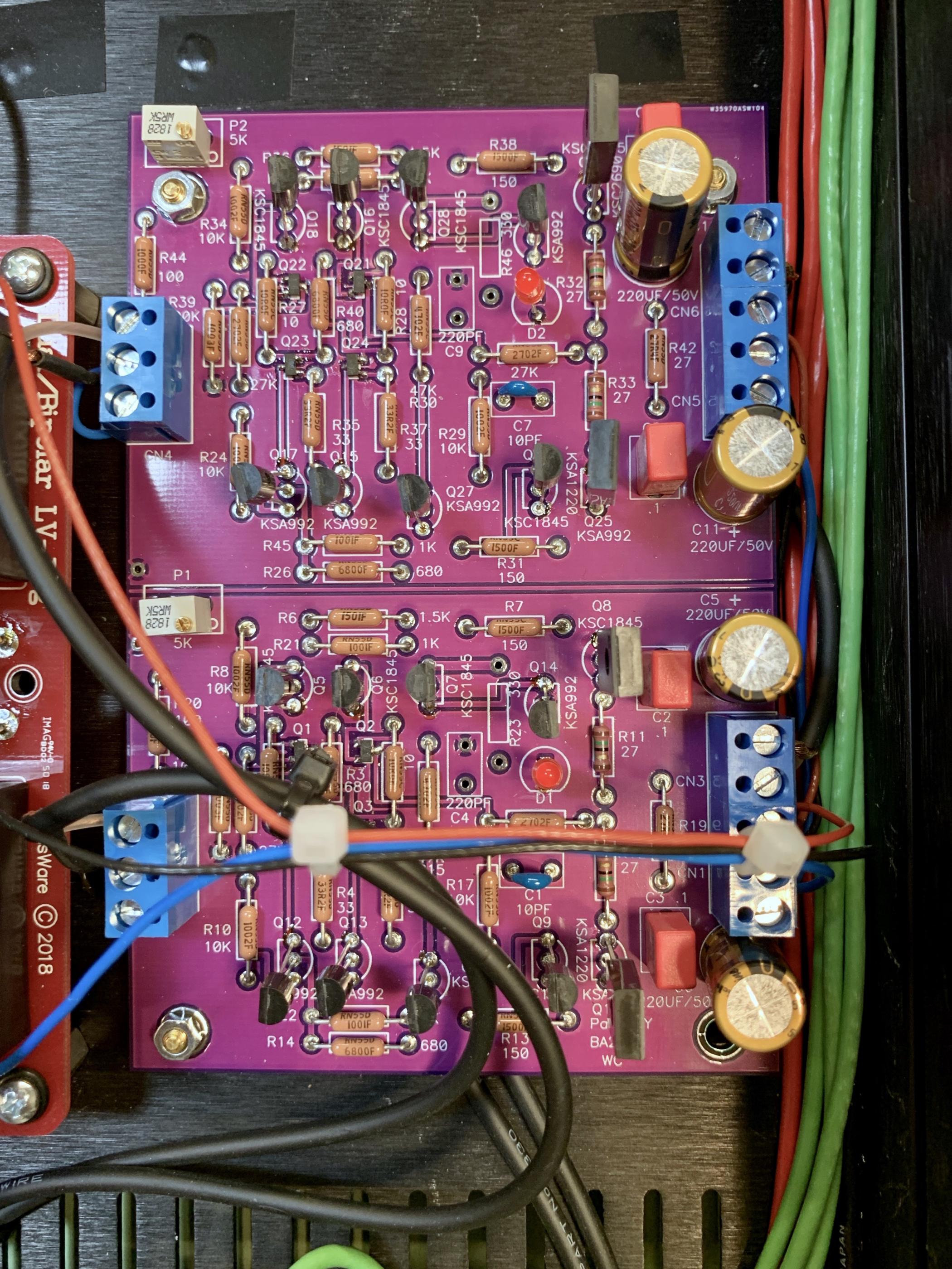

Here’s an in process, powered up, pic sans face plate (making my own), in a 1U store chassis.
Learned(ing) a ton of course... can’t wait to give it a listen!
Setting offset was very predictable, no floating around, zeroed easily. Especially after fixing a bad SMD connection on one side (thanks 6L6!).
@6L6: will this qualify me for Iron Pre adventure? 🙂🙂🙂 more more more! haha.
@pfarrell
Nice build! Can you give a link to the psu board your using?
I have the same screwdriver, super handy multi-bit tool

@pfarrell
Thanks!
LR Phono Preamp (Millett designed it for his phono pre (which looks interesting in and of itself), 6L6 brought it to my attention.)
He sells on ebay:
DIY PCB - Bipolar (opamp) power supply | eBay
I’m getting just under 20vdc +/- from it—could easily tweak it lower or higher. It’s nicely compact. I speced shorter sinks than what’s in the BOM, to fit 1U height.
Thanks 6L6. I agree it responds easily and well but takes a very small amount of pot turning to move the output voltage a lot. It’s all good, maybe I am being too picky. Can’t wait for the store stereo version, they will go fast because it is an excellent line stage and I am sure that everyone that has built one would highly recommend it. Thanks Wayne.
