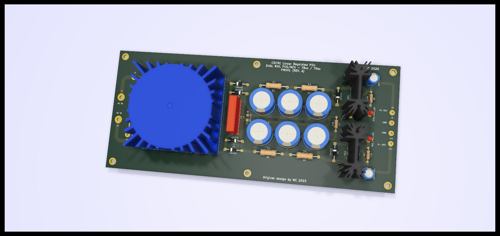

I see R15 has been reduced from 100K to 47K on the new boards. Any reason for the change. Doubles the current in the first follower stage. Did it change the sound, or performance in some way?
It does double the current but the distortion stays about the same. The current was a bit low compared to the input stage and that may be unusual but it works fine anyway. Mark Johnson noticed this before my presentation at BA 2018 and this seems like a good compromise. Feel free to play around with the value if you want just watch the power dissipation.

Is your power supply designed for both 115 and 230 VAC, and will you be offering a group buy? Oh, and what's the size of the pcb?
Scott

Hi Scott yes the board supports both voltage inputs but you must configure it for the required voltage using jumper wires just like on the whammy. The board size is 218mm x 94mm.
I can organise a group buy once numbers are known as I will put an order in for more boards to be made.
Regards
Gareth
How much load did you have ?I already have the PSUs on the way. 🙂 And based on my own scope measurements on the single rail PSU. It will be just as quiet. 😀
You don't need a load to measure the ripple. The measurements are taken before the regulator to demonstrate the smoothing effect of each cap.
You should try and do the same measurements..You don't need a load to measure the ripple. The measurements are taken before the regulator to demonstrate the smoothing effect of each cap.
