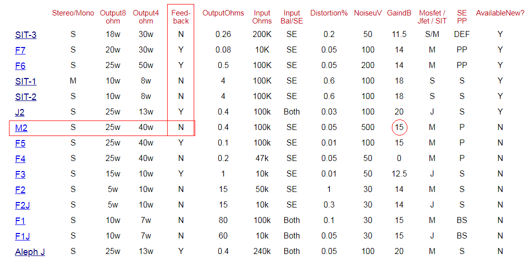

Howdy, here's a quick reminder from the First Watt table of their products, that M2 and M2x have no feedback. So "closed loop" gain isn't quite right, there's no loop to close.
M2's input to output gain is (IPSgain) x (autotransformer gain) x (OPSgain)
which, numerically, equals (0.99) x (6.0) x (0.95) = 5.64X = +15.0 dB

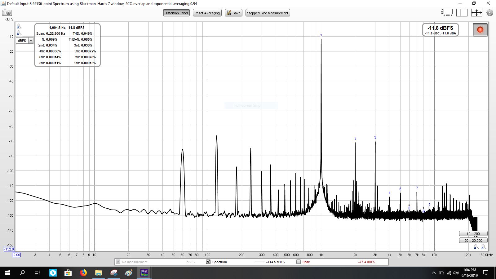

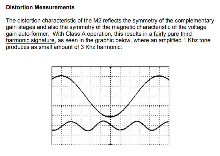

Regarding M2 distortion: the actual measurements that I have made plus several others that I have seen now show a significant amount of 2nd order and 3rd order. Not purely 3rd order - despite the the differential O-scope image from the manual.
For example, member Elwood625’s recent measurement with Ishikawa input stage with M2X driving 1w into 4ohm load:
763399d1560710675-diyaudio-watt-m2x-m2x-ishikawa-1-watt-4-ohms-rv1-adjustment-jpg
Joined 2011
You could try different input stage boards to find out how large or small their effect is, upon the graphs which interest you. One possibly revealing input stage board to try is: none at all, i.e., completely remove the board and directly connect a bare copper wire from the input bolt to the output bolt. Four wraps around the input bolt, three or four figure eights between the two bolts, and four more wraps around the output bolt, ought to do it.
