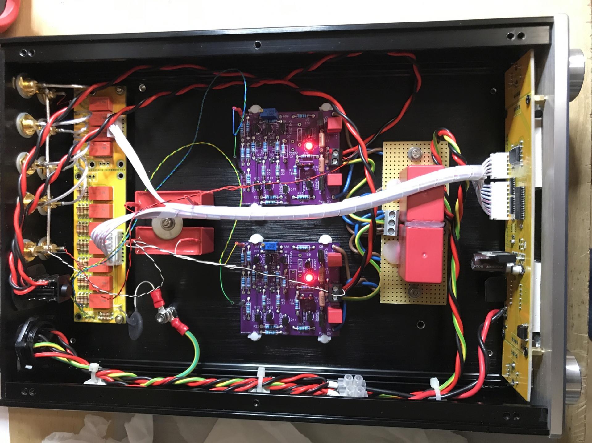

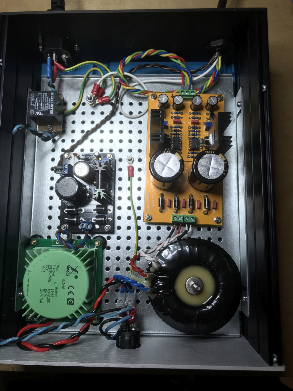

This is the follow-on to posts #619 https://www.diyaudio.com/forums/pass-labs/329240-waynes-ba-2018-linestage-62.html#post5763554 and #681 https://www.diyaudio.com/forums/pass-labs/329240-waynes-ba-2018-linestage-69.html#post5777341.
After my transformer had arrived from Toroidy, I could go and finish the PSU.
I have built a separate PSU, connected with an umbilical to the preamp case.
For the PSU, I used a Modushop Galaxy 2H case.
attachment.php
As discussed, I put the boards for Wayne's linestage into a "passive preamp" case I bought via eBay, complete with relay volume control and remote control for volume and inputs, The transformer I had removed from that case and put into the PSU (front left), together with a generic regulated PSU to bring something like +15V to the preamp for powering the relays and control circuitry.
Top left in the PSU case in the photo is a Schurter line filter – the 0.6A version, as that has better performance with low mains current draw then the higher-current versions.

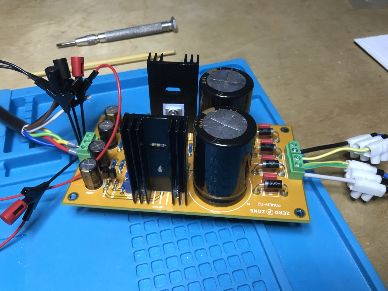

For the main PSU to power the boards, I bought a kit from eBay that uses a pass MOSFET and error amplifier per rail. This is powered from a 2x24V transformer.
attachment.php
The preamp itself has a headphone output in parallel - no need for a switched headphone jack, as I could simply leave the power amp switched off.
attachment.php
After adjusting voltages I could get the voltage offset down to a couple mV. (preamp has to be completely warmed up for that, as usual). AC on the outputs below 0.1 mV (my DMM stated 0.07-0.08 mV, but I think that is too close to the limits of the DMM to be accurate).

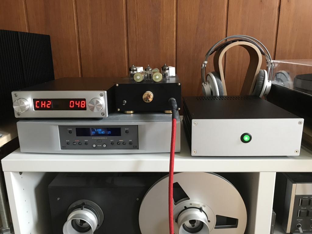

This is how the preamp looks in the system:
attachment.php
So, how does it sound ?
First, it has a turn-on thump (capacitor-coupled outputs), but no switch-off noise. In use, it is complety silent over my 100 db/W loudspeakers - no hum, no noise.
It sounds very good to me - lots of information, good staging, very transparent, balanced, but also engaging. Voices have this quality to stop you in your tracks and make you drop everything else just to listen.
What's interesting is that when I compare the sound, my Aikido linestage (E80CC / 6N6P) has a bit more high-frequency detail / content.
When measured on my oscilloscope, Wayne's linestage is clean and flat out into the MHz range (my signal generator stops at 2 MHz, and there the linestage still has not reached its -3dB point).So I don't really know what's responsible for this.
Can't decide if I like my Aikido more or this linestage - need to listen way more ... 😀
What will be next: I plan to do distortion measurements with the current set-up, and then exchange the output transistors (2SA1220 / 2SC2690 from Inchange Semi) for Toshiba TTA004C and TTB004C (as per the tip from Patrick / EUVL).
Best regards, Claas

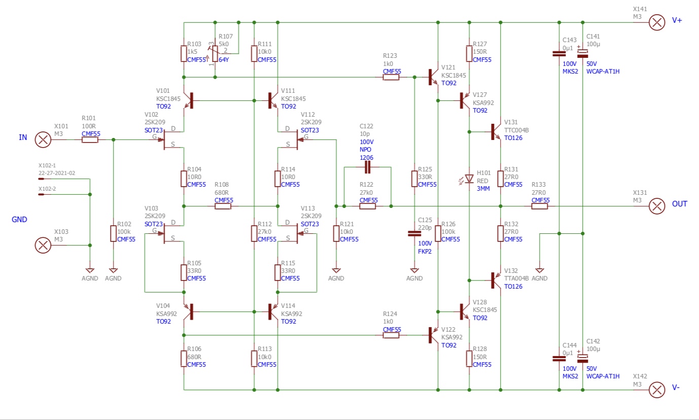

... is the Mouser cart BOM of this build posted on this thread sometime back, for a single board or stereo boards?
I don't know the answer. But I have an idea which might help you figure out the answer yourself.
The schematic attached to post #1 of this thread, includes resistor "R23" whose value is 330 ohms. There is no other 330 ohm resistor on the schematic. Only R23.
You might be able to look at the Mouser cart BOM of this thread, and count up how many 330 ohm resistors it includes. If the answer is one, you know it's for a single board. If the answer is two, you know it's for a pair of boards (stereo). If the answer is more than two, something very weird is going on!

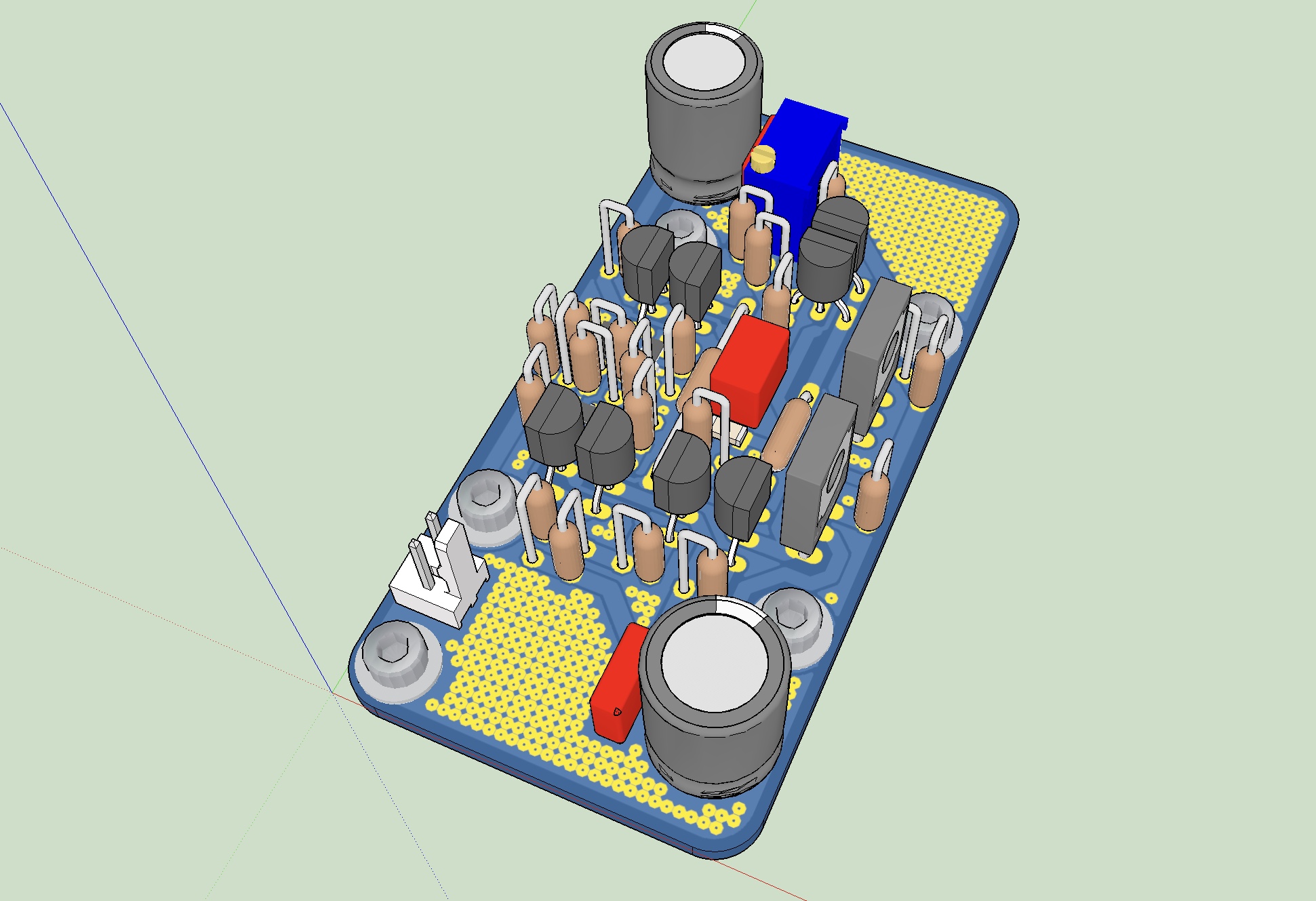

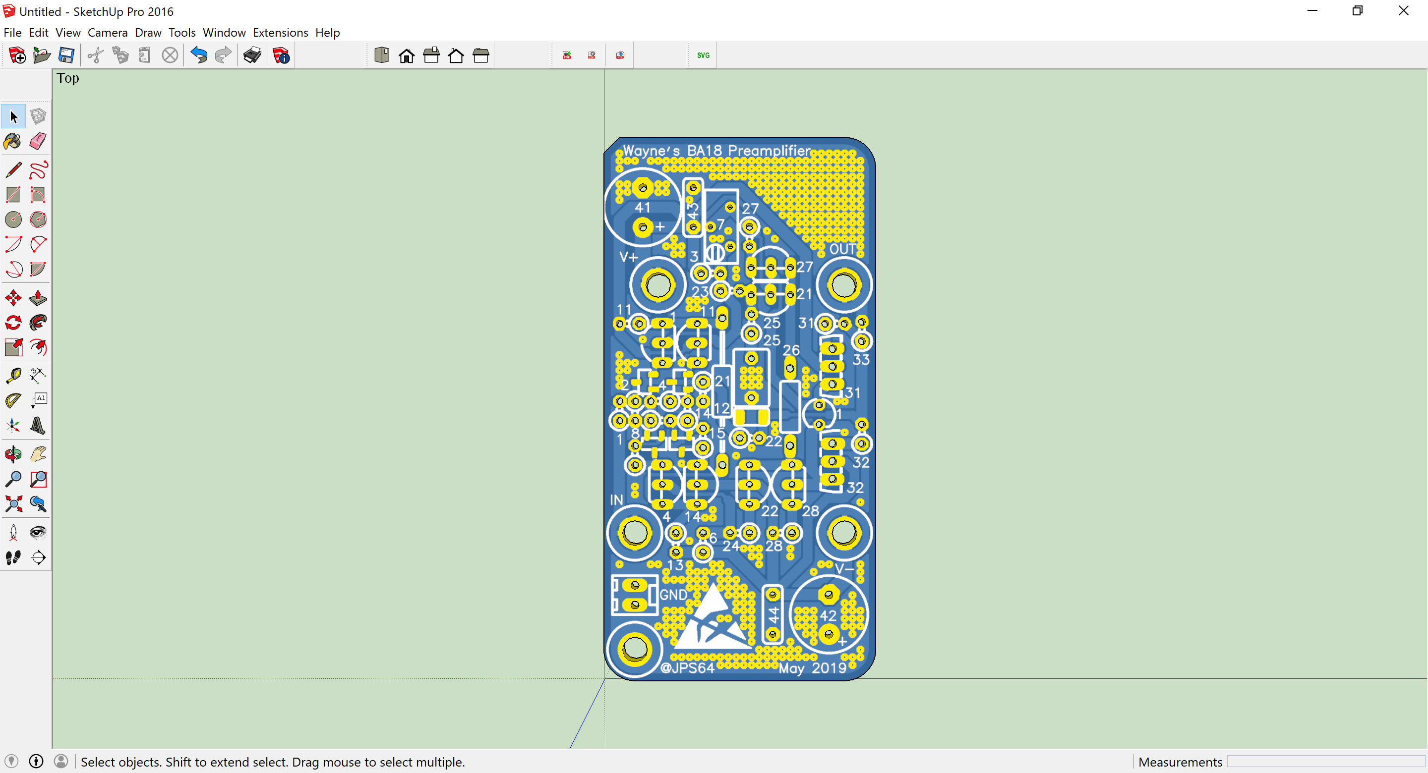

For those who may be interested in having a nice state of the art PSU, motherboard, and case for Wayne’s 2017 BA linestage preamp, JPS64 has developed a nice implementation in mostly TH as a small Yarra-compatible daughterboard. We are just gauging interest at this point, but the Yarra is a full featured system with modular preamp cores that are swappable. The default core is the superb Aksa-Lender based Melbourne. However, we are considering other topologies as they come up and the motherboard provides a nice easy to use swappable environment for “preamp rolling”. More info here:
The YARRA Preamplifier/HPA for Melbourne DB Group Buy
This is Wayne’s 2017 BA Linestage in Yarra compatible format:
attachment.php
These would fit on the Yarra motherboard and PSU system:

Btw, Yarra is nicely fitted with lots of pads for input and output caps of all sizes, including huge boutique caps. These can be jumpered for DC coupled operation of course. Plus a 4 way rotary input selector switch.

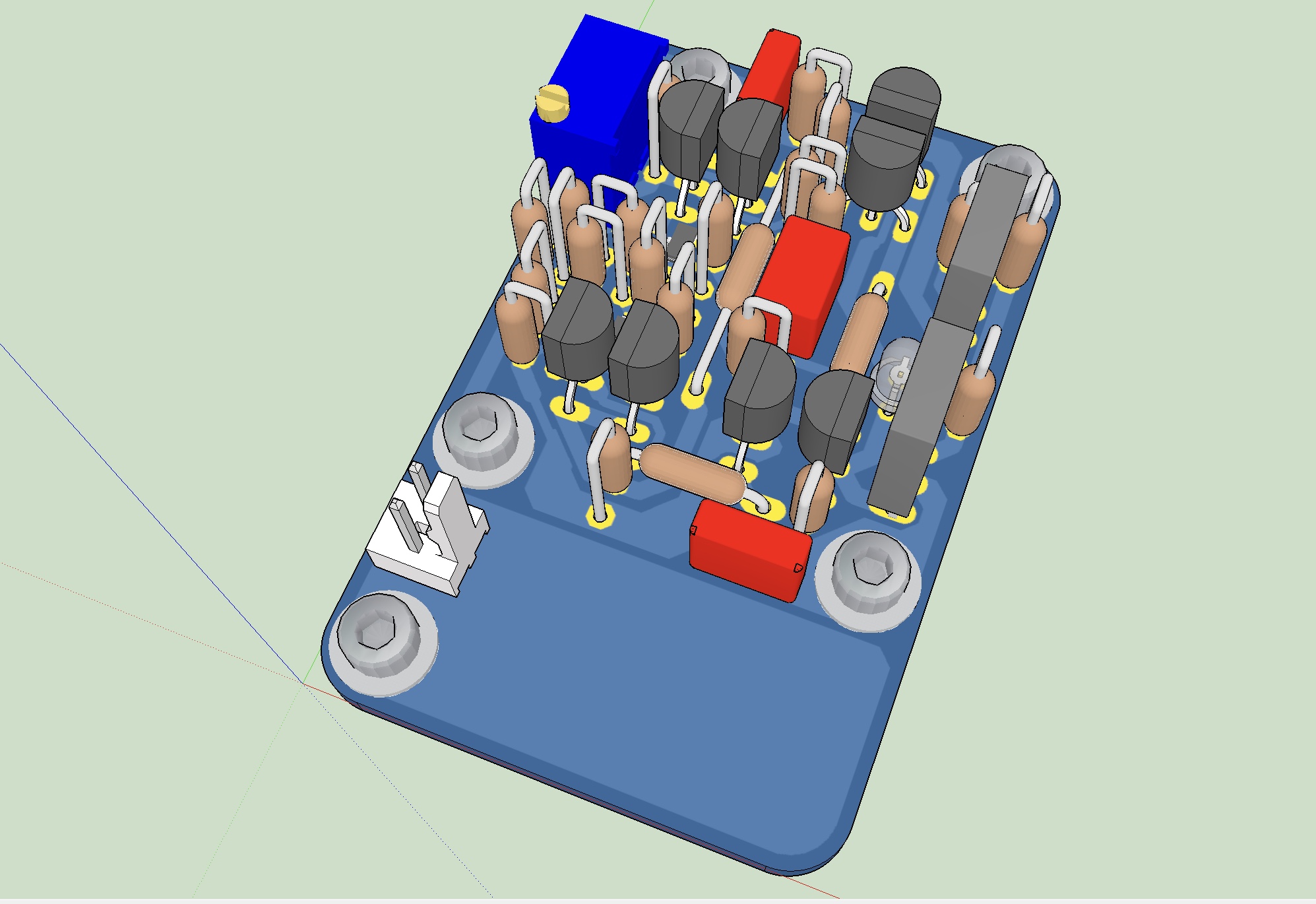

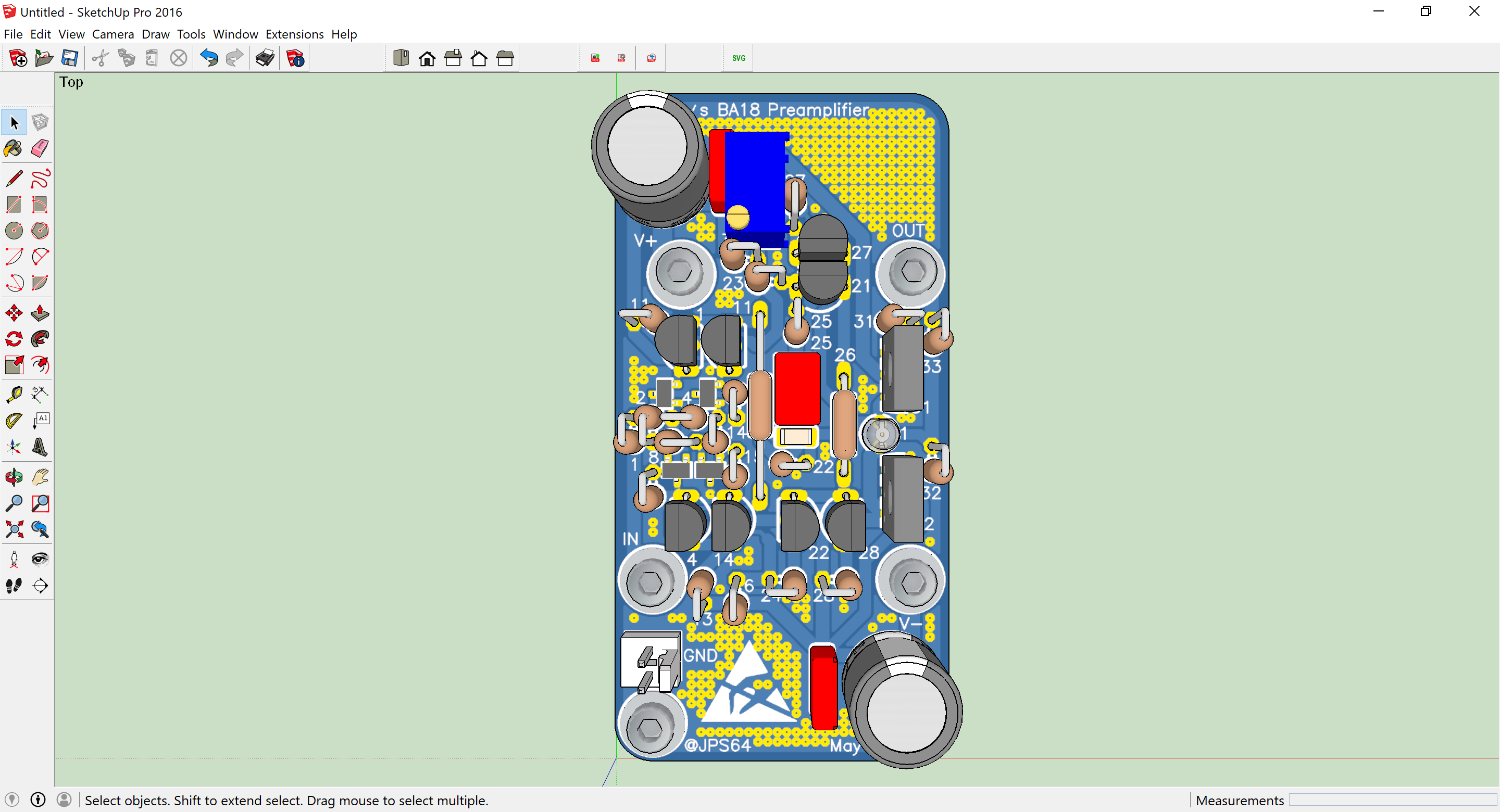

Slight update to Wayne’s BA module for Yarra, now with some more local rail smoothing caps.
attachment.php
Also attached is updated schematic.
attachment.php
Note that this might be useful/interesting/fun to try inside the M2X as well.

To use Wayne´s BA18 preaamplifier you need a power supply so I´ve found cool to use the YARRA one then already tested. And why not using YARRA mainboard, perhaps someone would use the design in the M2X?
So I´ve started faisability doing successfully SMD layout. Why not, then a lot of guys prefer THT, the THT version? Fits, cool (all explained modifications included).
Next, then work is achieved, proposing this to the DIY community?
No Owner approval, no PCB GB and I´ll build one for my own "plaisir".
