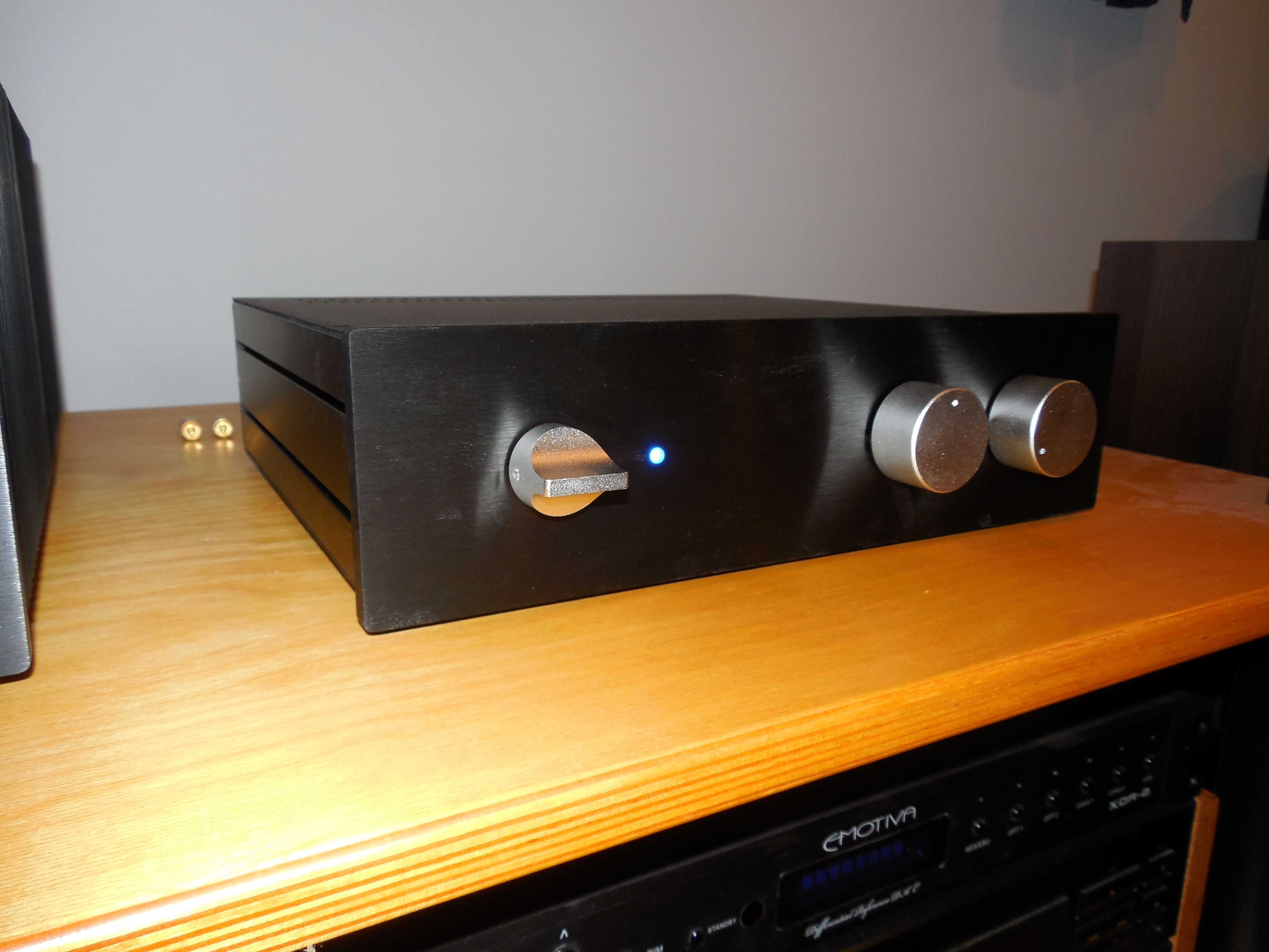

Yesterday, the case arrived that I intend to house Wayne's BA 2018 linestage in:
(image))
That case already comes as a passive preamp, with 128 step relay-based volume control and 4-way input switching, also remote-controlled via a supplied infrared remote:
((image))

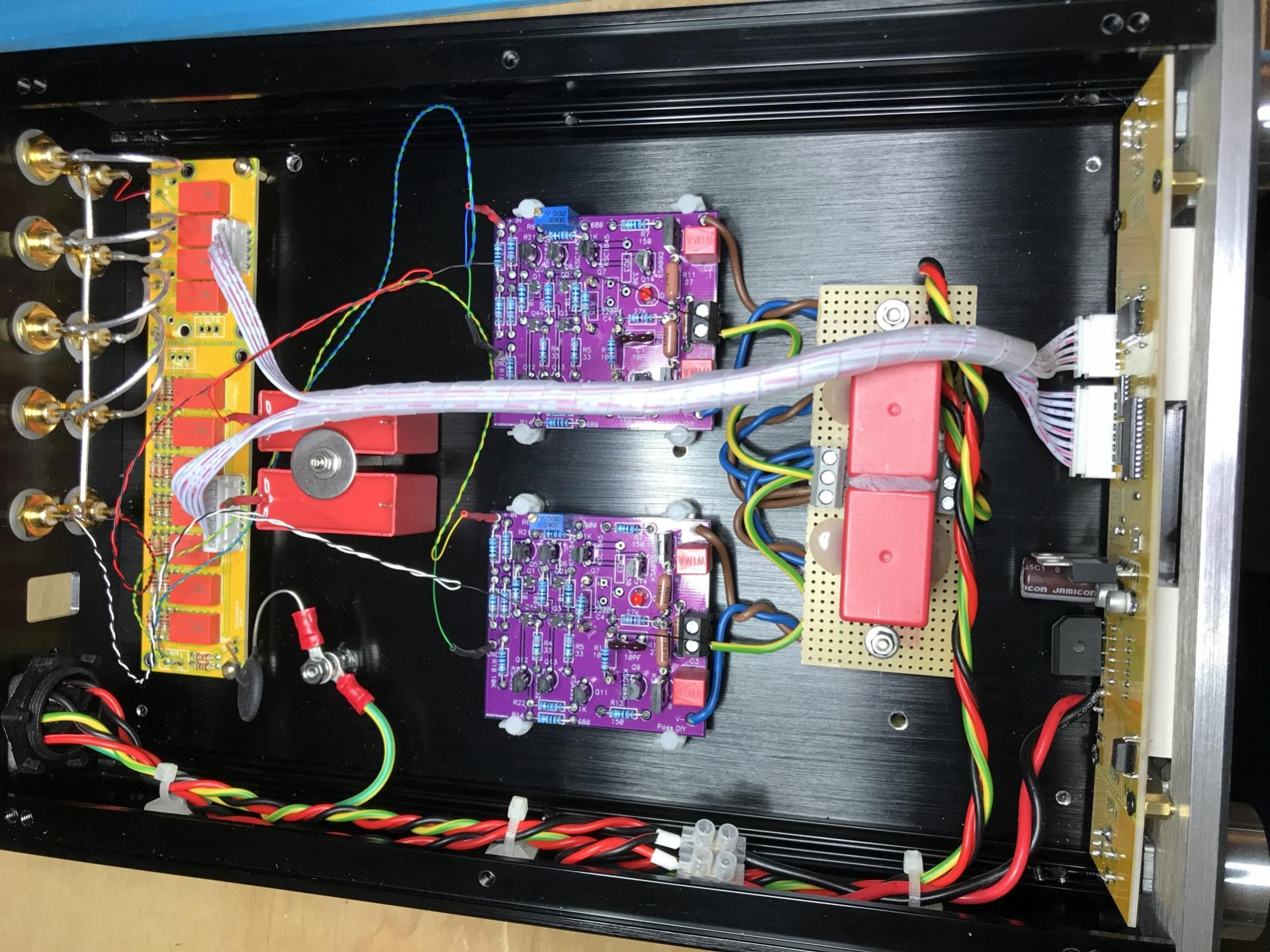

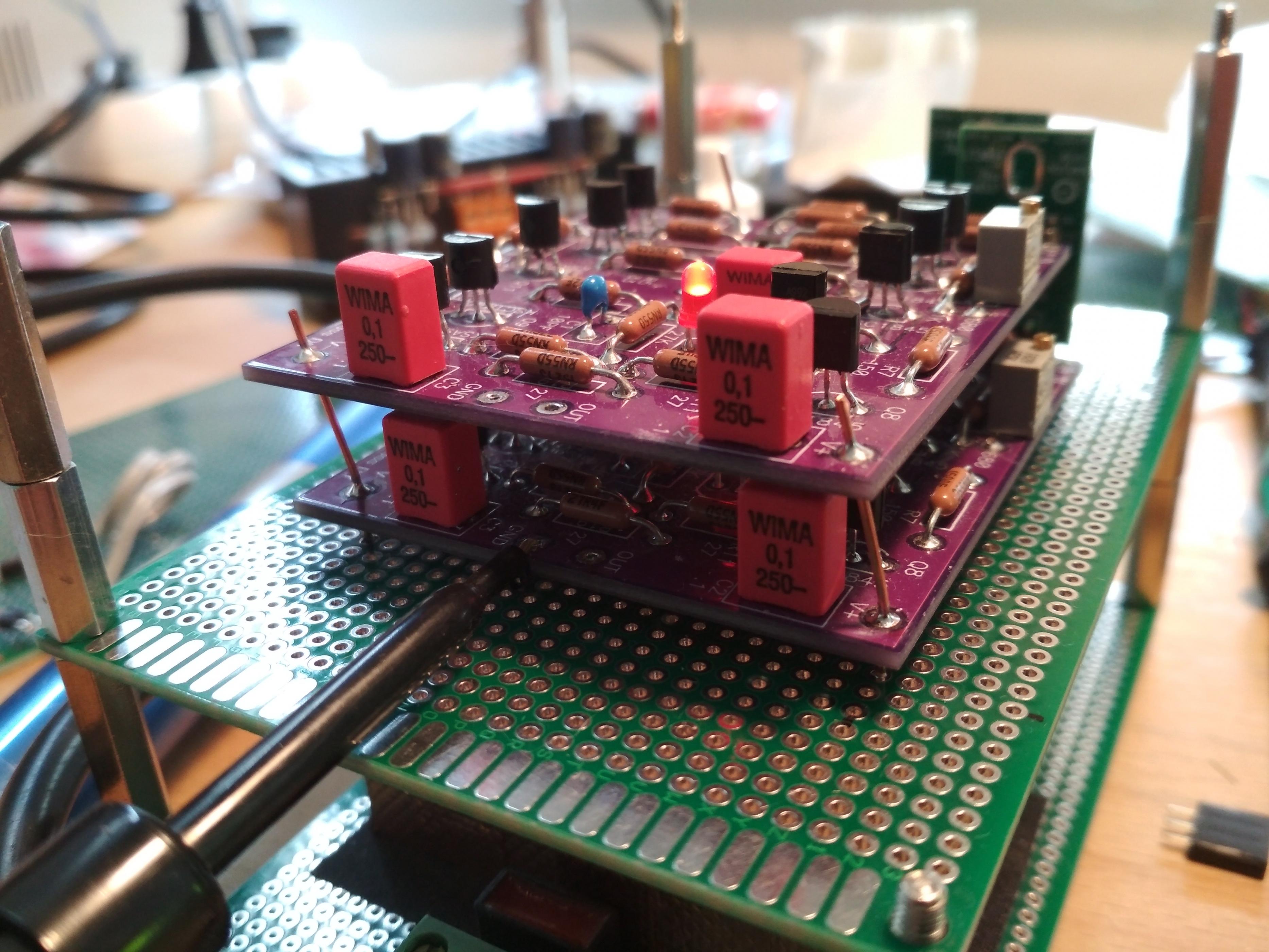

I will use a separate PSU for this preamp. That will be configurable to also serve other future preamps. So, making room for the gain stage boards (relay board will also be moved closer to the back panel):

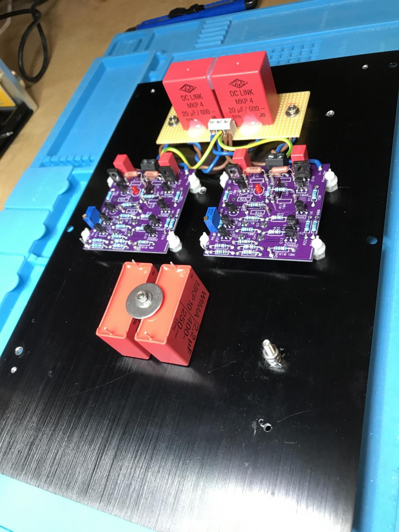

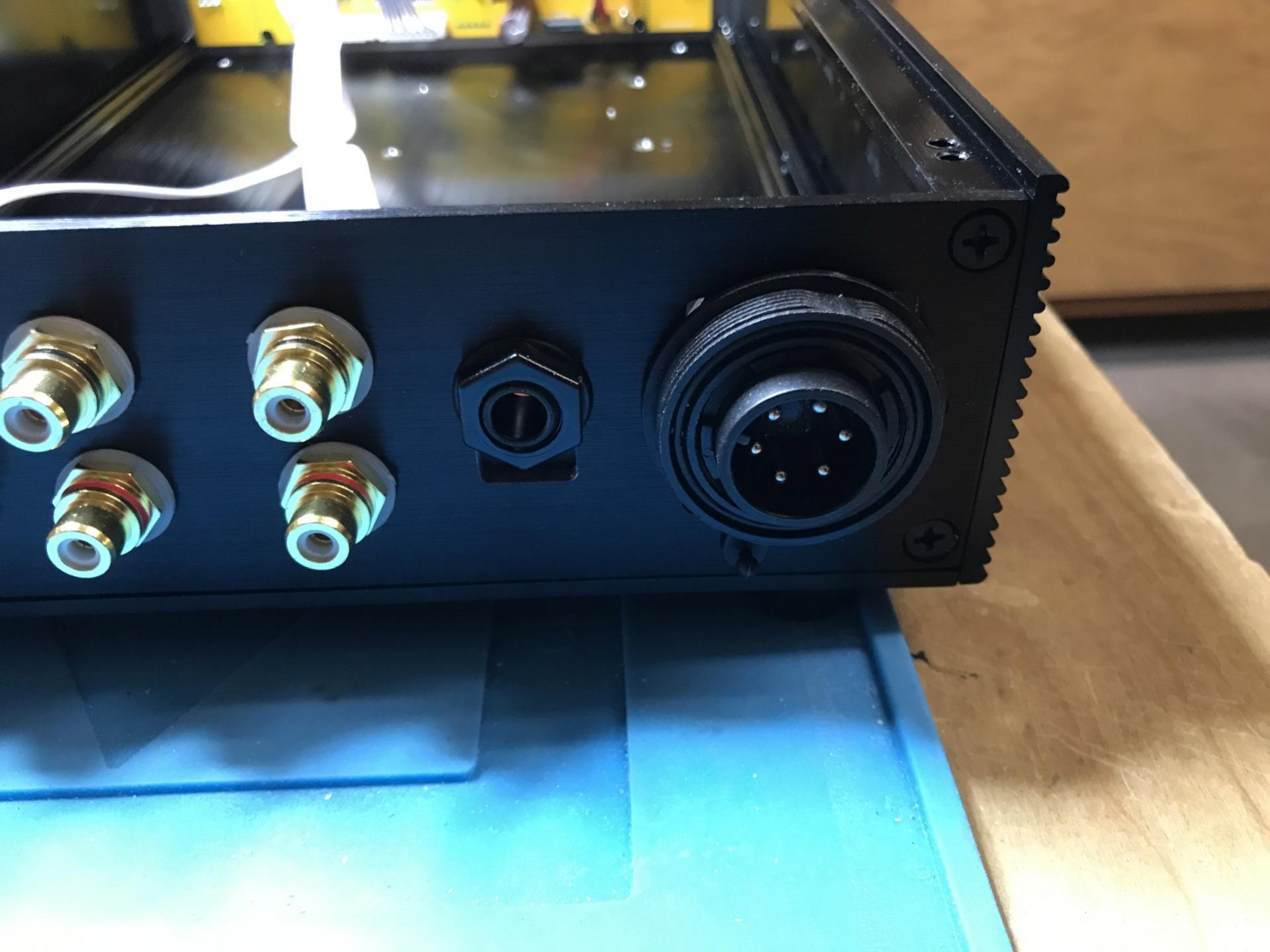

So, last thing that had happened was that I removed the transformer and the IEC inlet & switch from the passive preamp I bought. Now fitting connectors for the umbilical to the external PSU (+/- 18V or so for the boards, and +12-15V for the relays and control, plus PE) and for connecting a headphone. I chose the connectors so that they fit the existing opening, and I don't have to drill or file so much:

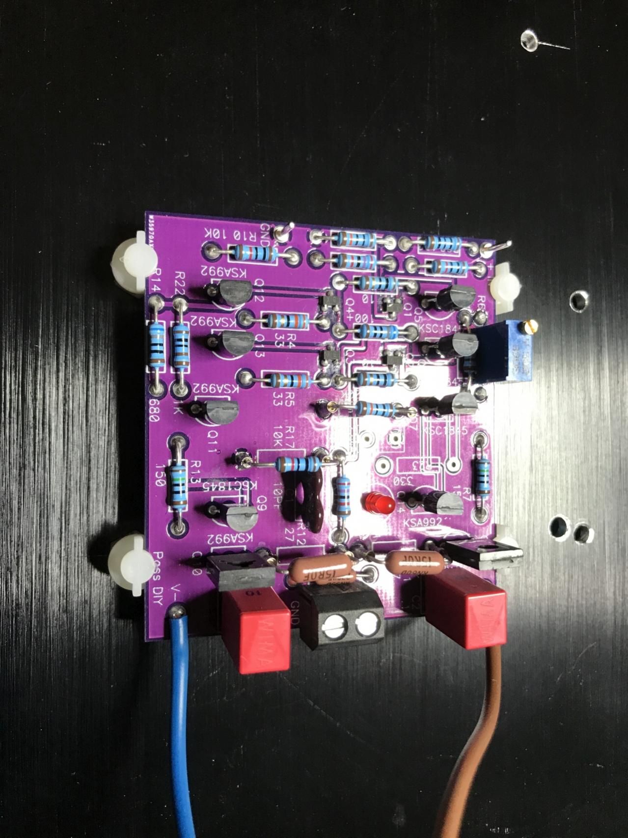

The boards I mounted on the bottom plate using the Adafruit Edge Connector Kit 6L6 mentioned (Mouser):

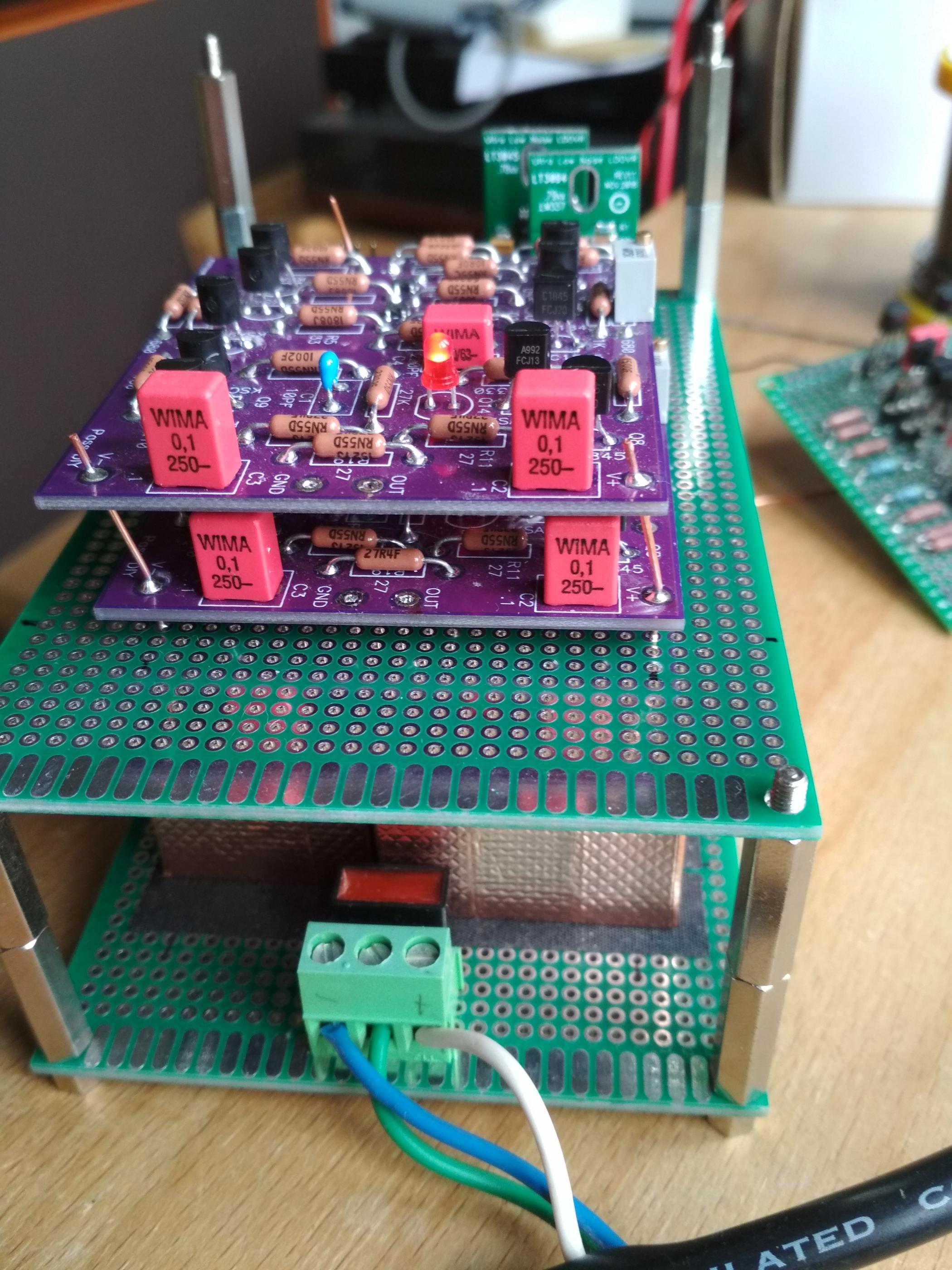

Pre-assembling the boards together with some rail buffer capacitors, the output caps and a case ground post on the bottom plate:
Preamp wired up with power and signal connections:
The PSU will take a bit more time, though. The case from Modushop is on its way, but Toroidy apparently haven't wound my transfomer yet, and now they have national holidays until next Monday ...

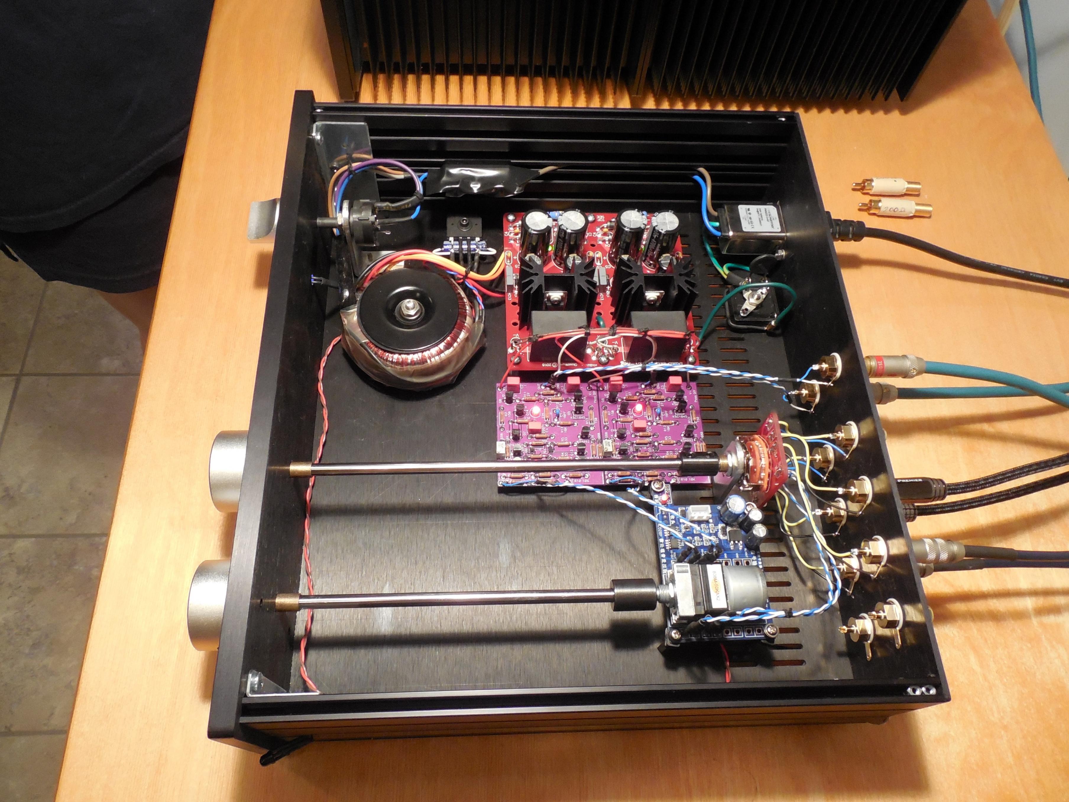

Measurements are on Wayne’s presentation from BAF 2018. Linear Systems
Listening impression- I put it into my system once competed and haven’t replaced it since. (Even having built two other preamps in the time being) I really, really like it.
