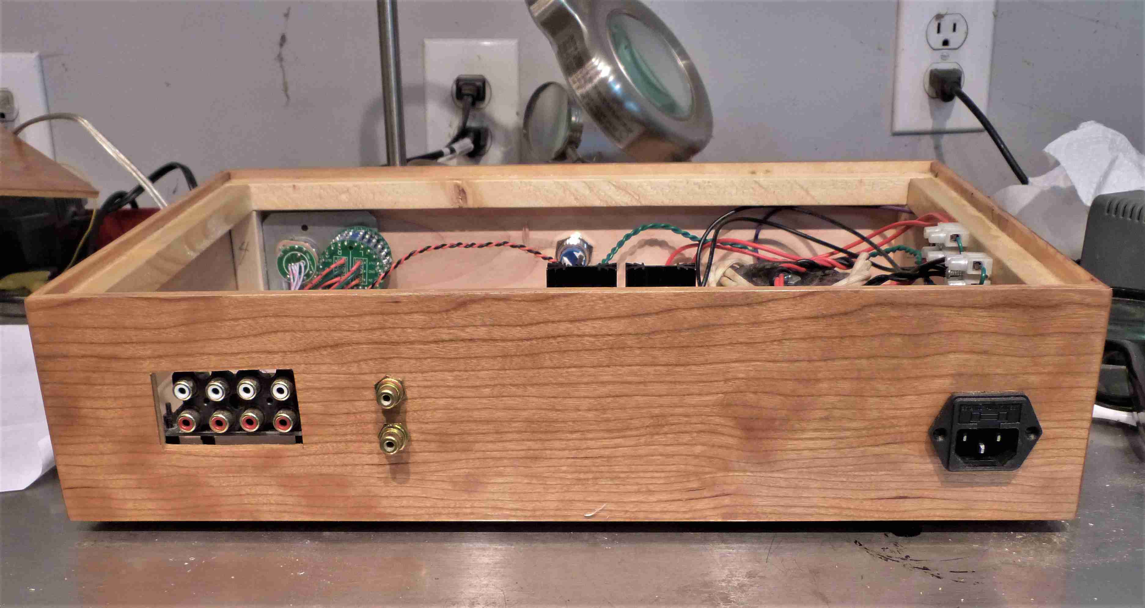

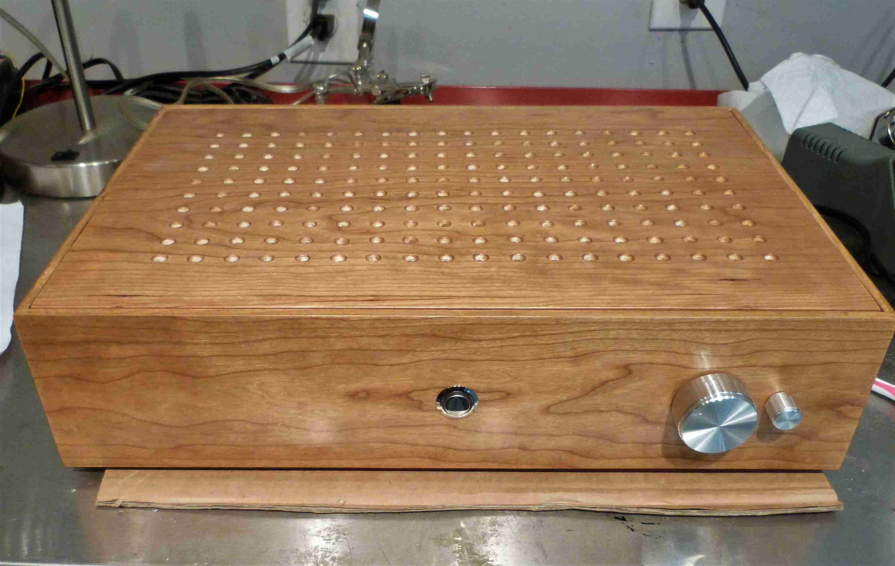

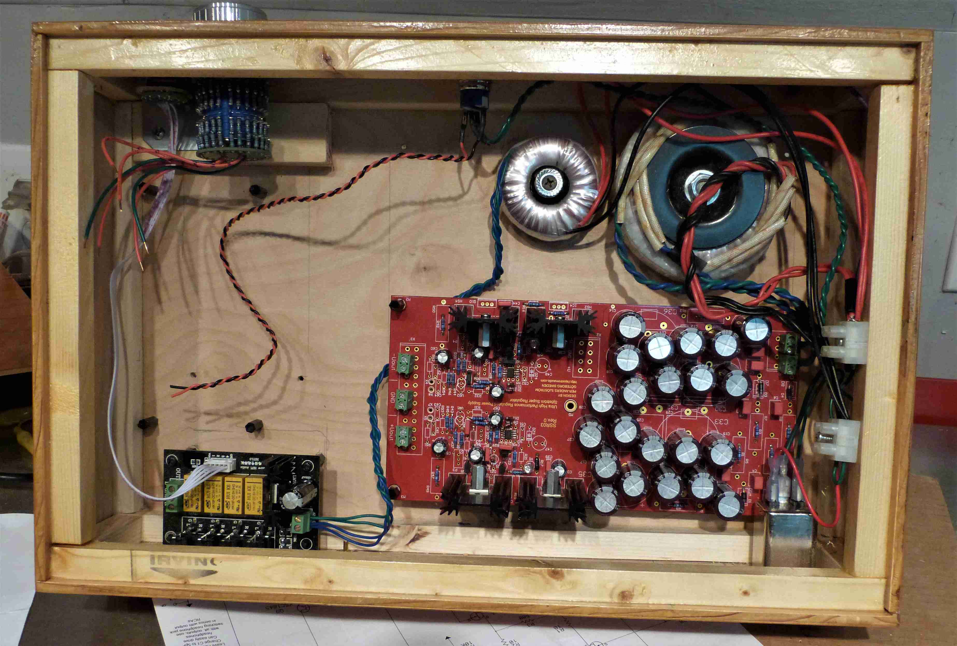

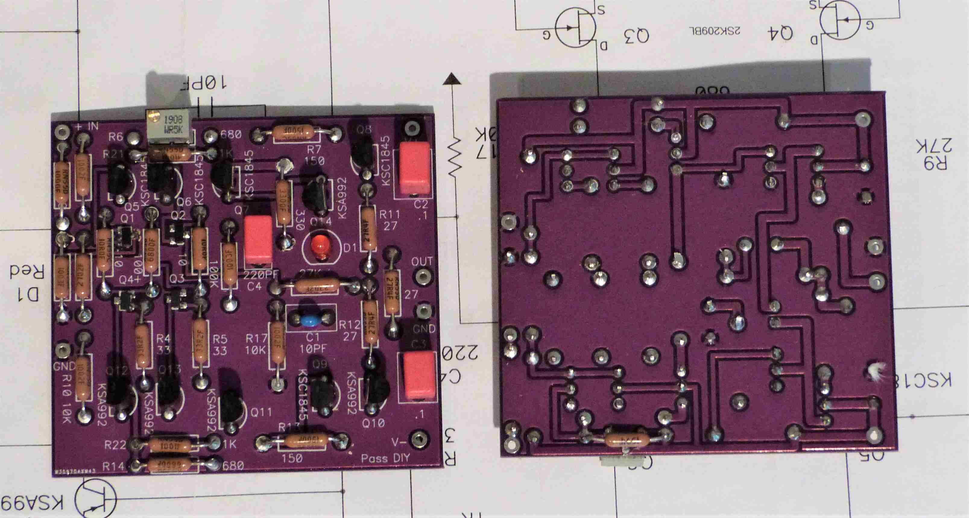

Well I finally started my build of the purple boards that Jim was so gracious to make available. Had a rainy day this weekend so I was able to populate both boards, and what busy little boards they are. I haven't finished hooking them up yet though, hopefully later this week. I made up a case out of some left over 1/4" plywood and scrounged around in my parts bin for the other stuff I needed. Here are a few pics of where things stand so far. The mouser BOM was perfect, many thanks to Jim and Wayne for everything they do for the community. The only thing that I'm nervous about is the PSU voltage, it's 29 vdc instead of 24 vdc, I think I'll contact Peranders to see why this build is higher than the BOM for the 24 vdc build should make it. Hopefully I'll get is singing soon.

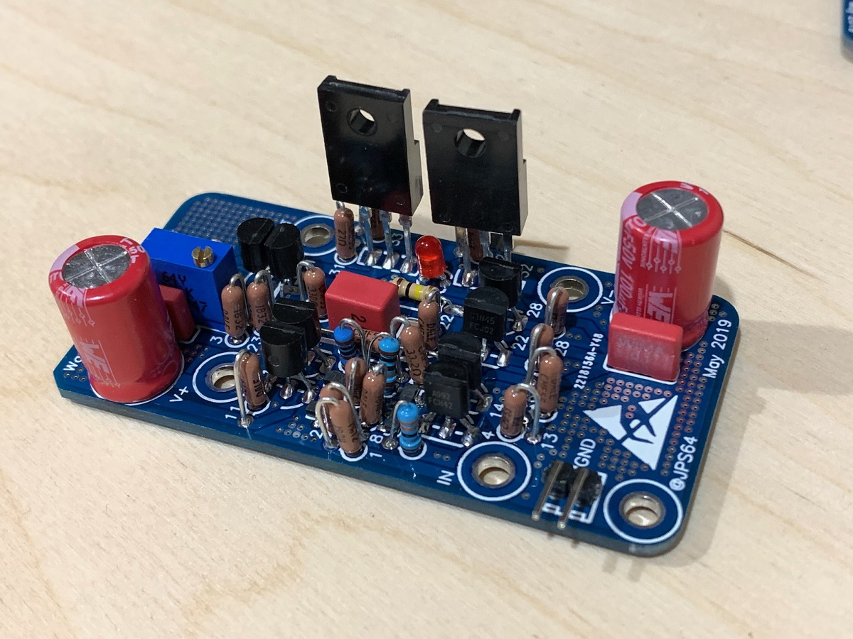

You can use the Yarra to run the WBA18 amp core modules. I just tested them last night for bias current and DC offset. I was getting 13mA bias and the revised pot is given g pretty good adjustment range and resolution to get circa 10mV output offset. The temperature sensitivity of the offset is rather high. Just breathing on the circuit makes it drift by tens of mV. I wonder if the transistor pairs should be thermally bonded and covered with a shrink tube?
I am testing them at +/-15v rails. Does anyone know if this preamp can safely run from +/-30v rails? I have an extra high rail voltage on my Yarra in order to drive a 50w 0dB gain Class A power amp.
The Yarra GB2 is now starting up again and pre-orders are now being taken.
+/-24v is as much as I've used on the circuit, and it works fine.
The KSA1845 and KSA992 are 120v parts, and the TTA004 outputs are 160v, I can't imagine there would be much issue with 30v unless one is carrying too much bias and dissipation becomes the limit...
I’m actually using 2SA1837 and 2SC4795 (flipped around). They don’t feel too warm. At 30v and 0.013A each they will be 400mW - well within their operating safe limit. Might need a small flag heatsink? Will give it a try quickly and hope magic smoke doesn’t fly out.
