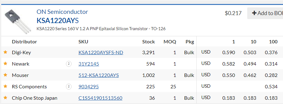

FYI, Mouser finally shipped me the KSA1220AYS parts today, which I ordered back in December. (It is the PNP transistor in the higher power TO126 package, that Wayne suggests for driving difficult loads). Let's hope this means they will now be in stock and on the shelf at Mouser.
The TTA004B is in stock at Digikey. 1500 available.
TTA004B,Q Toshiba Semiconductor and Storage | Discrete Semiconductor Products | DigiKey
You must be lucky Mark, just checked and Mouser still shows zero stock on them.
Maybe they shipped the whole contingent to Mark ? 😛😀
P.S.: +1 for the Toshiba TTA004B / TTC004B

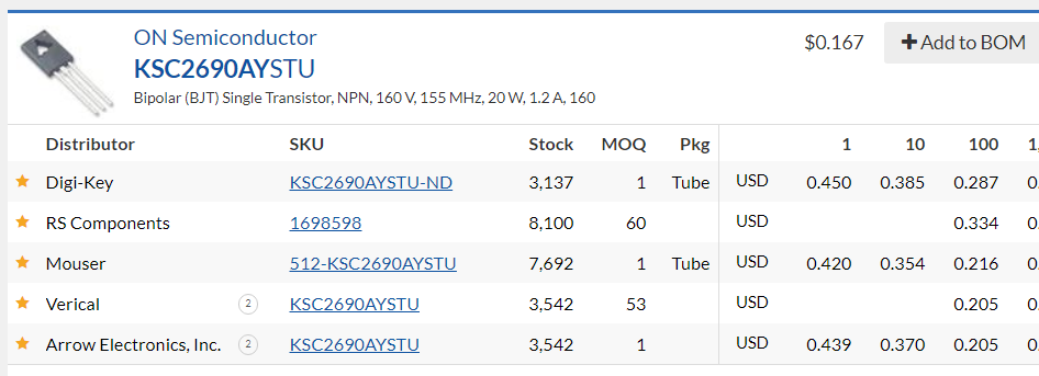

I'm actually very happy now with the alternatives Toshiba TTA004B and TTC004B ... 🙂
