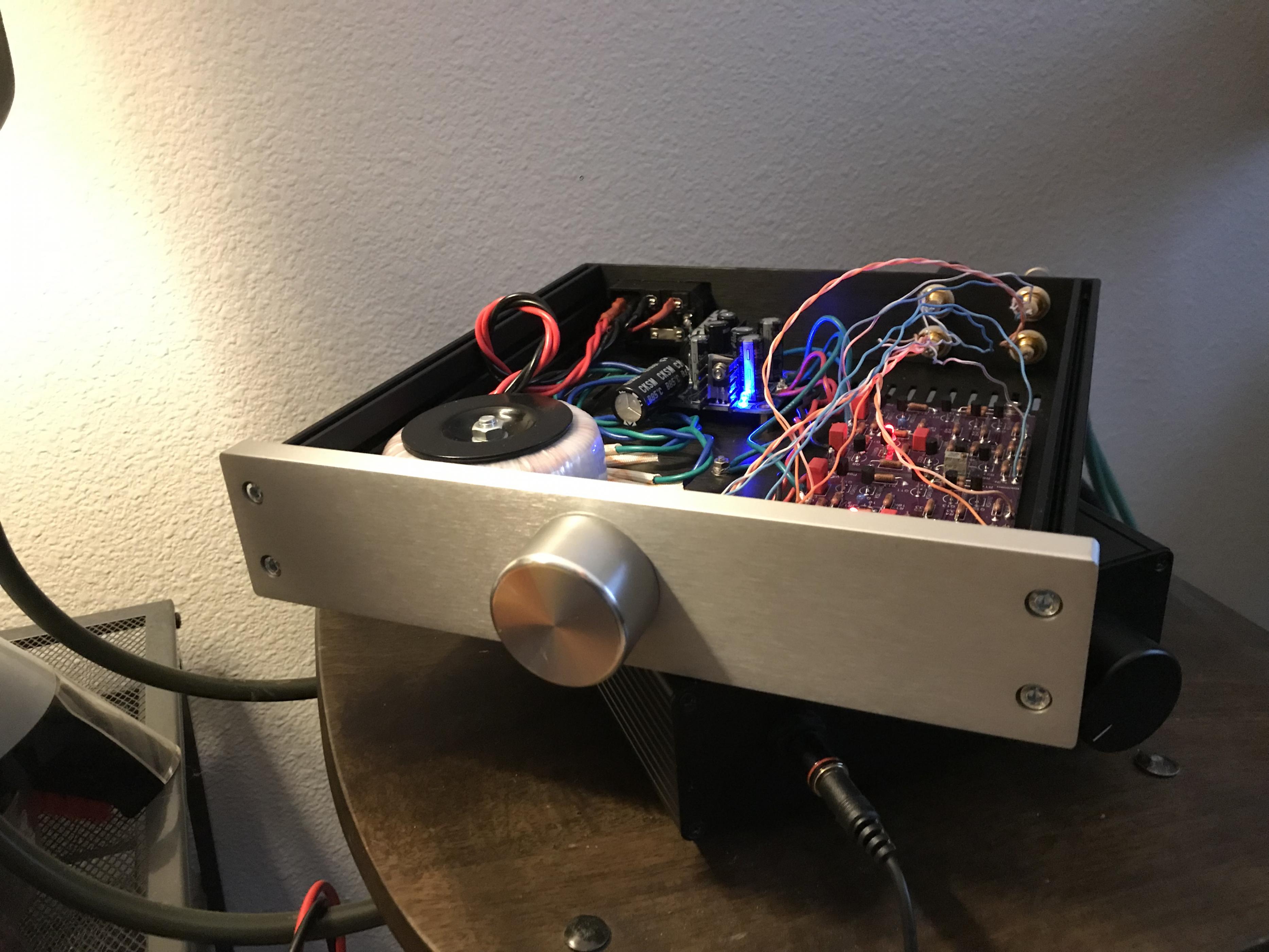

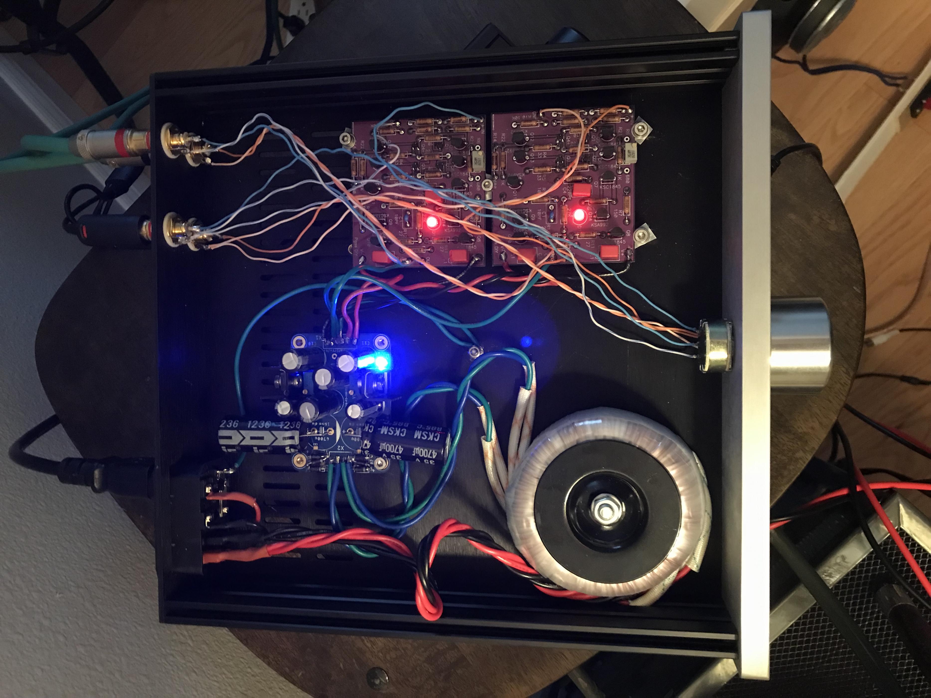

Made really good progress with my build yesterday. Casework is basically done. Using a 1U 230x230 Galaxy with aluminum covers and 10mm faceplate from the store. Using an Antek AN-0215 25Va, 15V dual secondaries and a mini-CapMx board from a Mark Johnson/Prasi colaboration (thanks guys!). The CapMx gives a pretty steady and clean 18V +/- supply. I'm also using some stripped down CAT5 cable for my signal connections and an ebay, el cheapo, DACT stepped attenuator.
A note about my construction, I smoked a BD139 on one rail of my CapMx. I tracked it back to the purple boards and the standoffs I am using to try and secure the board to the chassis. I found that the standoffs scraped through the solder mask and shorted the V+ rail to the chassis. So don't rush things like I did and skip the plastic corner board mounts for the purple boards. OR, make sure you have a way to mount them that avoids potential shorts. I quickly made some plastic "washers" from the Burger King fountain drink top I had for lunch! Did the trick. No more shorts!
I haven't had a lot of time to listen yet but so far this linestage sounds very nice indeed. I'm switching from a WHAMMY on my ALPHA 20W amp. Compared to the WHAMMY, Wayne's Linestage sounds more detailed but maybe a touch thinner on bass. Will try to get more listening in tonight.

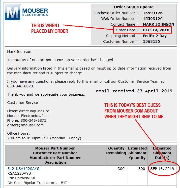

Can anyone recommend a reliable supplier for a pair of KSA1220s. Mouser, Digikey and Allied have none in stock.
Take a look at TTA004B & TTC004B from Toshiba.
Very good hfe linearity up to 100mA (unlike KSC2690).
Very complementary.
Available at Mouser.

A couple months after seeing Wayne's presentation at Burning Amp 2018, I placed an order for 300 pieces of the NPN and 300 of the PNP "Big Boy" output transistors in TO-126 medium power packages. The NPNs arrived quickly but the PNPs are on backorder. Here is the latest information from Mouser.com (screen capture image below); they won't ship until September at the earliest. Cowabunga!

Hey, thanks for the foresight and the effort! I was originally going to build mine with the headphone option, but decided against it for this very reason. Hopefully others didn't do what I did: order everything but the LEDs and trim pots. D'Oh!!!
I guess you didn't use 6l6's pre done Mouser cart?

Nah, placed my order just before that post. No big deal, as I needed parts for (yet) another project...

I was able to successfully power up and test the preamp. Now I need to put them in the enclosure and was wondering if there are any suggestions on how to mount the boards?
Yes, earlier in the thread 6l6 posted some parts for that. Mine are currently floating in air, held up by wiring with a sheet of thick cardboard underneath.
My idea is to either get the parts 6l6 shows, or mount two standoffs to chassis floor, and pinch the boards between a third on opposite side. Be careful to place them where screws don't interfere, and I will use nylon non conductive stand offs to prevent shorting anything to chassis.

Board Edge Mounting Kit - Pack of 4 ID: 1116 - $2.95 : Adafruit Industries, Unique & fun DIY electronics and kits
