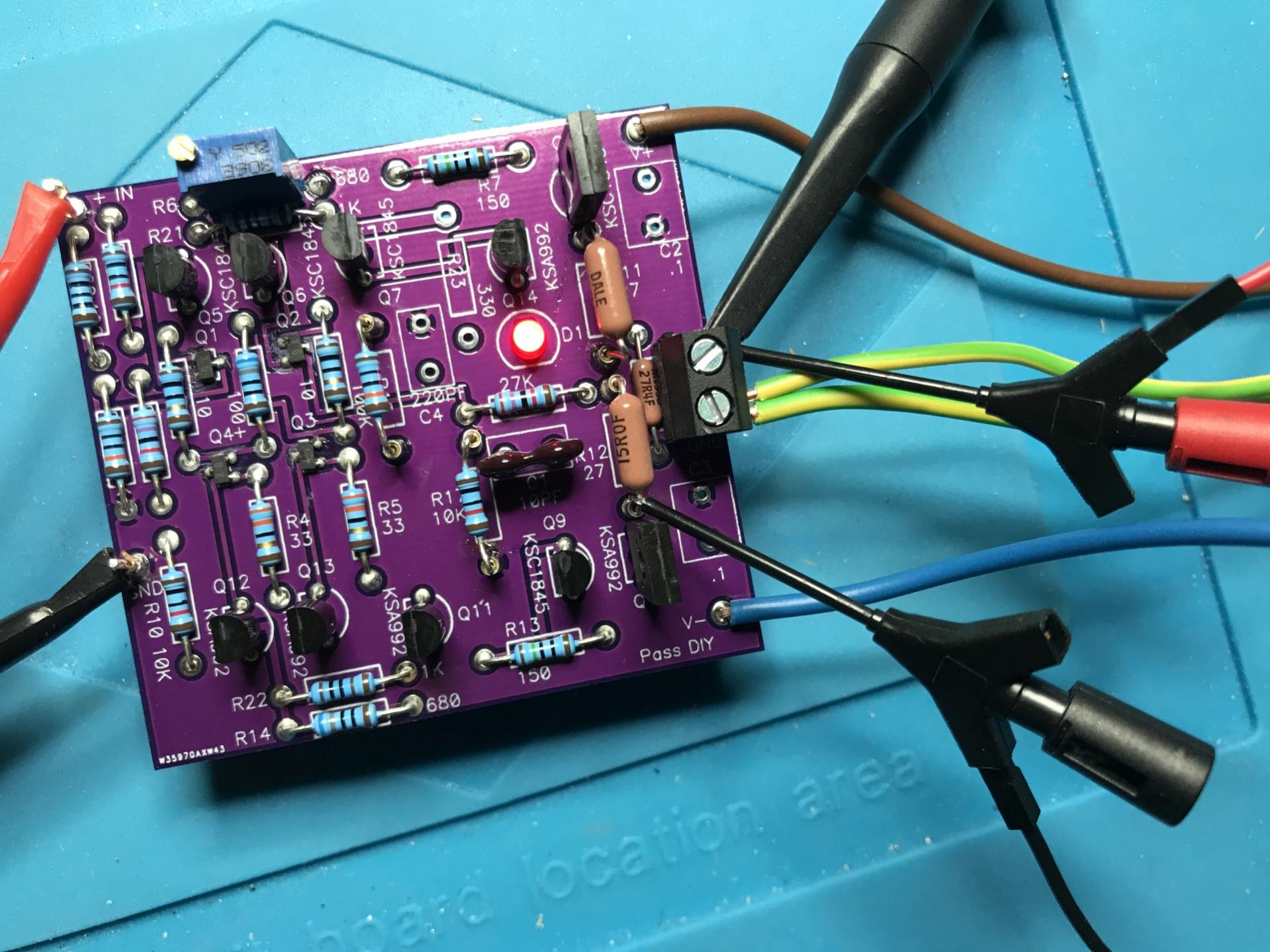

First board built, so far only bench tested, works fine. Bandwidth from below 2Hz to over 2 MHz (my signal generator doesn’t go higher). Will assess square wave after I have a proper PSU, my lab supplies do cause ringing.
Have built it with the large outputs, mostly Beyschlag resistors (now also part of Vishay), and a 5 pF Silver Mica cap. The bias resistors for the outputs, for Q7 / Q11, and R17 are socketed to experiment with different values.
Q9 and Q14 do get warmer than Q8 and Q10. Offset and also bias current through the outputs varies little with rails between 18 and 24 V. Offset very sensitive to P1 here, as well.
Waiting for more parts and PSU. Build will probably continue after Easter Holiday ...
When going through the thread while I was searching for something, I noticed that in my earlier post from my mobile phone the picture never made it through ... so here it is again:
There is also an addendum now: When testing the second board, I buffered the outputs of my lab supply with a WIMA MKP4 DC-LINK 20 uF capacitor on each rail. This took care of the ringing on the square waves - square waves look almost perfect now.
Also: gain continues to stay the same all the way to DC, so no falling back to unity gain at DC. Will provide caps at the output of the line stage in order to protect the inputs / transformers of my M2 and SissySIT.

What are you considering putting on the output, brand, uF, voltage?I have similar concerns for my M2 and soon to be SissySit, regarding DC.
Thanks,
Russellc
Hi Russellc,
my budget favourite are the WIMA MKP10. This is what I normally use as coupling caps.
My M2 and SissySIT have 100 kOhms input impedance, so 0.68 uF or even 0.47 uF would be sufficient. In order to make the preamp more universal without having to think about adapting the value of the output caps, I will probably go with a higher value.
On the other hand, in my opinion, the value of the cap has to be balanced against transient behaviour at turn-on and turn-off. I know from my tube amps that large caps do cause a large voltage transient at turn-on/turn-off. This would point to a cap value as small as is reasonable without bass roll-off. Have to test if this is an issue here as well. In first lab test, I have seen transients using a 6.8 uF cap, but this has not been the final set-up, and was with just the DMM and the scope probe at the output.
I have a number of MKP10s in my drawers - 0.47, 0.68, 1.0, 2.2, 3.3, 6.8 uF ... They are mostly rated to 400V DC, but don't think the voltage rating matters much. I will go with the 2.2 uF as a start, as this would work well with amps having an input impedance down to 22 kOhms.
Once I have built up everything, I will try to get a handle at transient behaviour with a 100 kOhm ballast resistor across the output. If I don't see voltage spikes more than a few mV at turn-on or turn-off, I probably just leave it at that.
