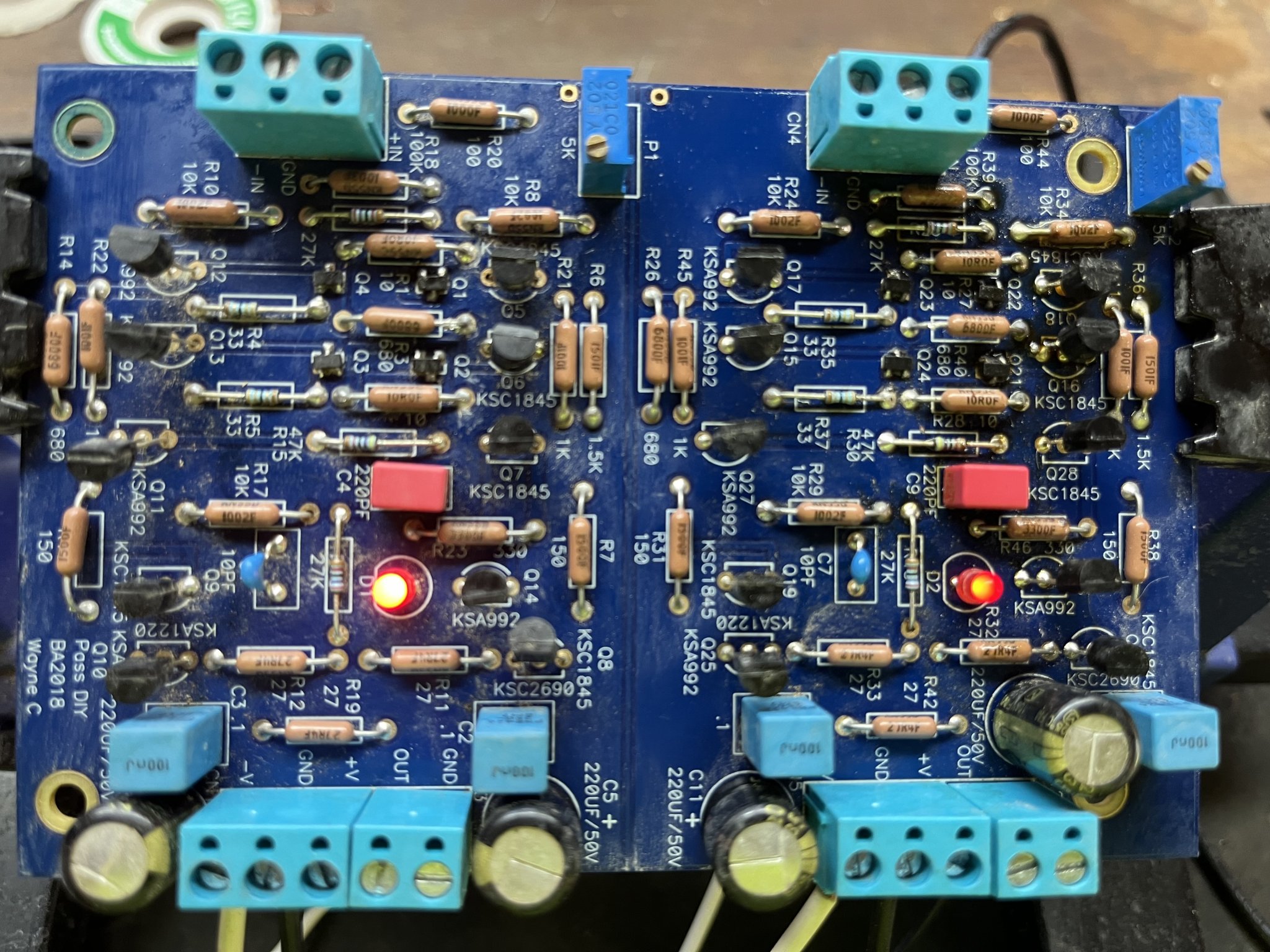

Thanks for the offers to help with my bad board. Here is a photo of my board As suggested. As you can see, the right channel LED is dimmer than the left, which happened while I was taking measurements. No pops or smoke or anything, just the sudden dimming. They were equally bright previously. Both channels get right at 18v + and - from a VRDN ps drawing on an Antek toroidal with 21v secondaries.
i don’t know where important points in the circuit are, so I focused on the SMDs, which I sm new to, and a few other transistors. Feel free to suggest other points.

@jfuquay: Just had a build where the right LED was less bright than the left and the problem was the SMDs were insecurely soldered. Yours look the same. Use a fine tip iron and make sure each of the legs is securely fastened. In my case the problem was shown by the DC offset trimmer -- it was uncertain and after the SMD fix, it became solid and correct,
BTW, this board sat a year in my stash supply and got pretty dirty. I scrubbed with alcohol, but yeah, not real clean.😗
Thanks for the tip on the SMDs. I’ve been pretty nervous about overheating them.

Q21 looks solder bridged but it could just be the photo. Use your DMM to ping each leg of the JFET to the next component(Resistor I think) Use the schematic. I have also had really cheap LED's from Newark have different brightness. Easy enough to try another LED.
Although there is a possibility that the LED is of different brightness, being that it is used as a forward-bias reference voltage and not just a light bulb, it is a selected and specific component, the Liteon LTL-1CHE.
That the potentiometer isn't having any effect on the DC operating point of the circuit makes me think that something else is wrong, and the LED is operating properly.

Following advice to check the SMDs, I hit them again with solder and got the right led up to the brightness of the left. But DC offset remained at 14.4v and still unaffected by the pot. When I made another pass at suspect joints, the led went back to its dim state and DC offset remained 14.4v. I previously got discouraged with this project and let it sit in my workshop, where it got pretty grungy, until I decided to give it another go. I’ve got a chassis that fits my Pete Millett balanced Nutube pre, so I was thinking I’d have a pretty simple swap of the boards and power supply.. Hasn’t worked out that way. But I’ll stick with it.
@jfuquy: From your description it sounds like multiple solder joints to me. Have built 6 of these boards so far (it really is that good) and have only had one problem with SMDs and another with a misplaced capacitor (6L6 helped identify that one). So its worth doing the trouble shooting and I would start by identifying the next continuity point for each SMD leg and make sure they connect. I do this when first building the board and they work that way. The lack of the DC trimmer moving away from 14.4 vdc is troubling and have not had anything like that -- perhaps Jim can help.

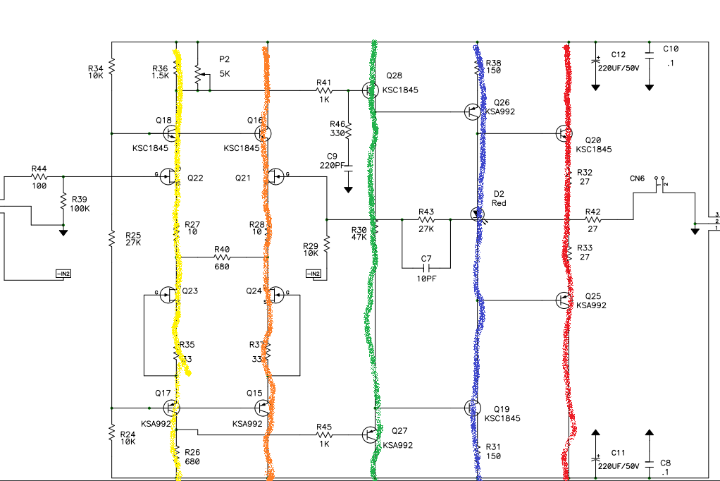

Ya probably a soldering and/or contamination issue. And probably at the SMD parts. Those always kick everyone in the cojones. If I was handed this project I would want to know what the current through each of these legs are.
current through yellow=measure voltage across R35 and calculate current using ohm's law... should be ~2mA
current through orange=measure voltage across R37 and calculate current using ohm's law... should be ~2mA
current through green=measure voltage across R30 and calculate current using ohm's law... should be ~700uA
current through blue=measure voltage across R38 (or R31) and calculate current using ohm's law... should be ~10mA
current through red=measure voltage across R32 (or R33) and calculate current using ohm's law... should be ~12mA
I believe Wayne said each channel of the std. version draws ~25mA, so my numbers should be reasonably close.
DC current flows from one supply voltage rail to the other supply voltage rail in each of these legs when things are working properly. Hopefully I've stressed the importance of using ohm's law to figure out if current is flowing, and if it's the proper and expected amount.

You're welcome. The whole shebang really relies on the input stage, also called the "IPS" (yellow and orange legs) to function properly to get everything else going. So the focus should be there first.Great info, thanks.
More good advice, thanks again. Let me ask about “pinging” the SMD legs — for continuity, I take it. I follow the schematic for the right trace and place my probe on a leg and a resistor leg? And that’s done with power off, I assume, while I do the current measures with power on?
@jfuquay: Yes that is correct. Do this first to ensure that the connections are being made. The first points are usually resistors but in some cases "Q" values. Is somewhat complicated for the right side of the board as only the left side is reflected by the schematic opposite the parts BoM. You can find this right side in early posts or extrapolate the connections by carryover from the left side (positions are inverted, sort of).

you guys are the most awesomest! Success on both channels. I didn’t think I’d ever get the SMDs right, but they fell into line. Seriously, I had all but abandoned this project. Thanks again.
