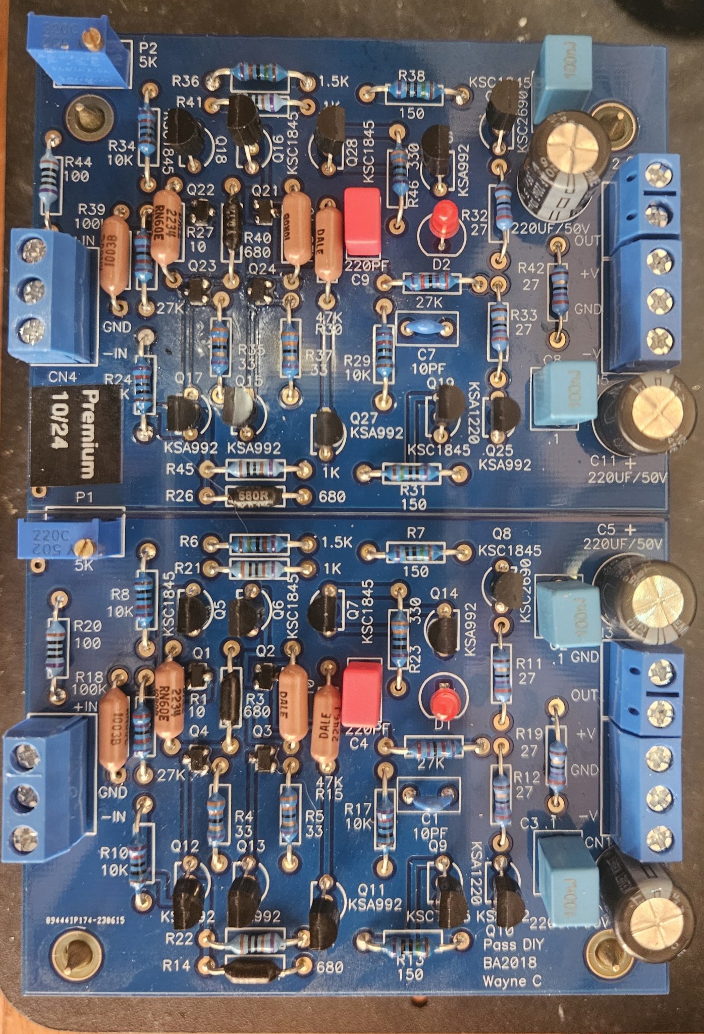

Round Two: Resistors
Have tested and installed the BA2018 resistors. Vishay/Dale, TE Connectivity, and Yageo supplied 0.1% parts (from DigiKey) and they were checked carefully as installed. See the attached spreadsheet for the specific values.
Seven of the 13 resistor classes were spot on. The remaining parts were within spec except for three lower values: 10, 27, and 33. I attribute the discrepancy here to the Fluke 115 MM being used. It has always been less accurate for low resistance values and extremely low ones require special measuring techniques.
The Premium PCB is now complete and will be tested and installed in the next day (see Jpeg below of the board). Will describe the audio setup and the media sources used for listening in the next post.
Stay tuned for Round Three later this week. I am most interested in whether there will be an audible difference and, if so, what that difference is.

Will you be experimenting with the caps, internal hook-up wiring, volume pot and power supplies? I would say these will all have a bearing on the performance of the pre-amp.

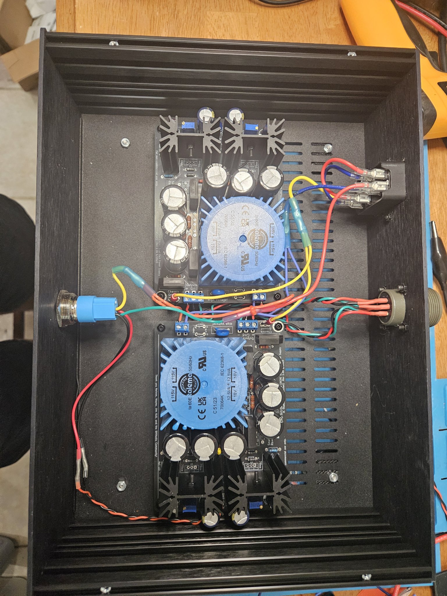

I intentionally compromised on the power supply, opting for 2x Meanwell +/- 15V dual output SMPS boards (PD-2515) for a dual-mono configuration all housed in a Nu-Tube galaxy Chassis (with AC in).
I am very happy with the performance of this system, the SMPS are very quiet and take up little room compared to transformer based supplies. I would be very interested to see the difference vs a Linear supply.

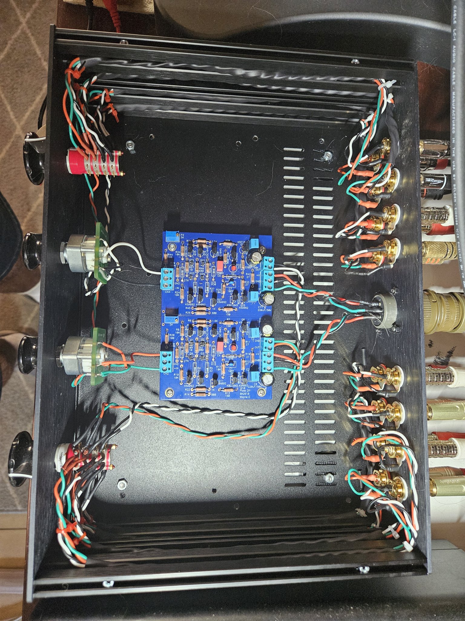

@jonboylaw: My preamp build has been based upon dual linear power supplies in a separate enclosure, point-to-point wiring, Goldpoint attenuators (that rival ladder designs), and Grayhill selector switches. Transistor matching and high-res resistors should be the last refinements. 6L6 (=Jim) has assured me that the caps are not in the signal path and will not benefit greatly from upgrades. See the two attached JPegs.
Recommend you ditch the SMPS PSUs ASAP. Linear supplies are significantly better. Randy Thatcher (this forum) makes several boards available that will handle polar and bipolar requirements; he is, like Jim, a particularly fine professional.

Round Three: Audio Analysis
Have now been able to compare a number of recordings in CD, vinyl, and reel-to-reel media and can report that the BA2018 Premium build with matched transistors and .1% resistors does, in fact, sound different than the stock version. Interestingly, you might find either version preferable based upon their characteristics. See the system being used in the JPeg below; it places emphasis on power supplies and conditioning with a PSU for each PCB in the stereo chain.
The first recording tested was Spyro Gyra's “Alternating Currents.” After hearing this with the stock BA2018, a second listen with the Premium PCB showed less noise and a markedly “smoother” quality. Presence and attacks were superb with both but the Premium version exhibited a controlled response that could be described as “natural realism.” Timbral accuracy was slightly better with the Premium PCB.

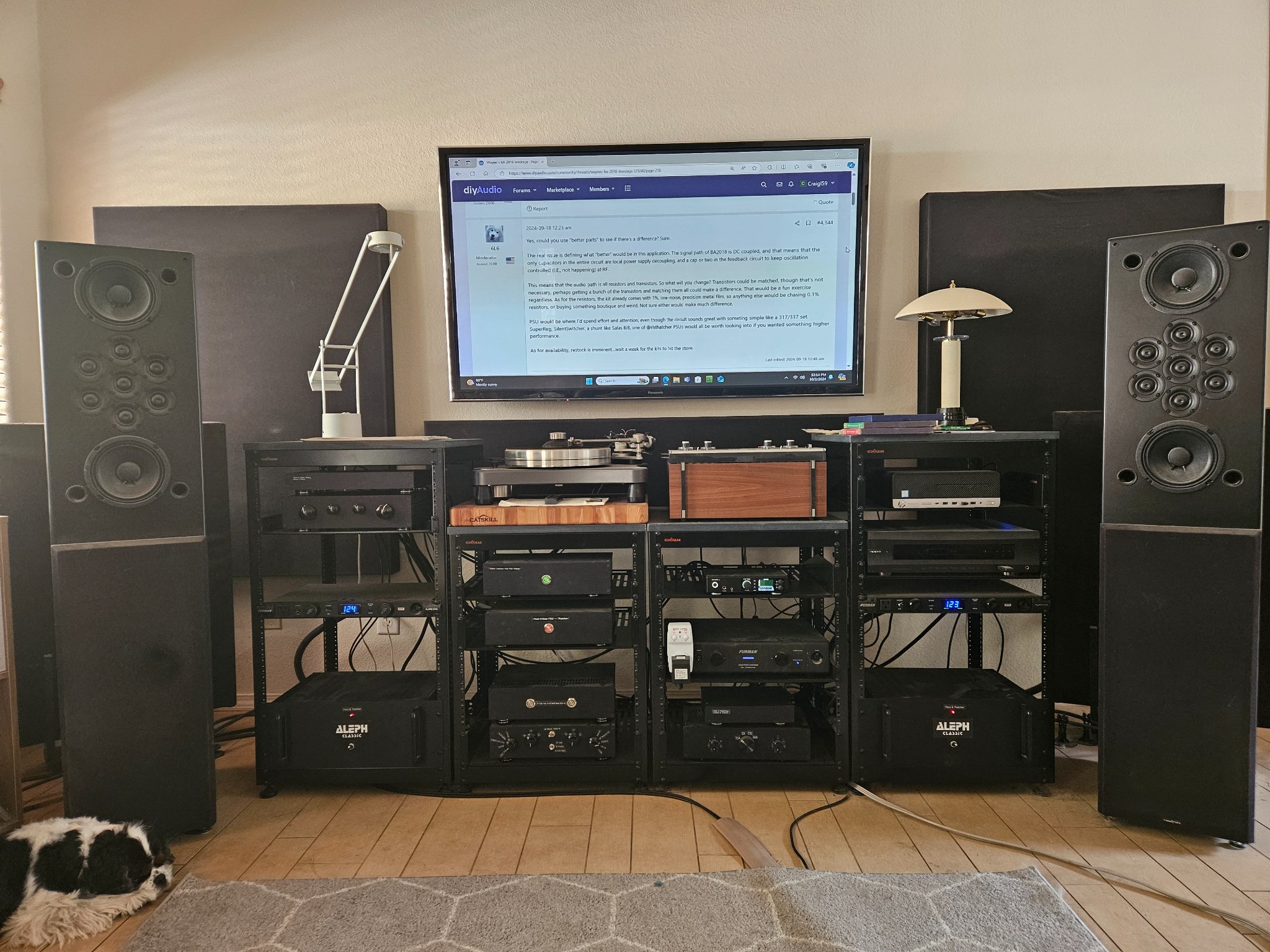

Much more importantly, you can see the audio doggy in the photo! 😊♥️
and these on pics are looking damn close to Eminence Alpha 6
one of rare Gems
kiss for Doggie!
