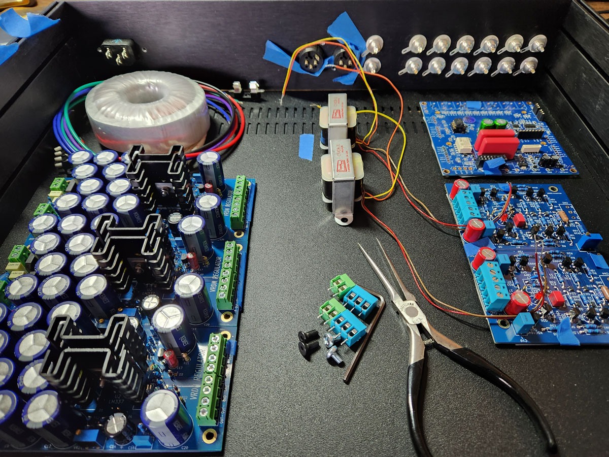

I'm finally getting down to the point where I can start drilling out screw holes to mount parts for my BA2018. But I have questions regarding ground connections.
1) I believe the BA2018 and Muses board get their ground from the power supply, so I don't think I would connect either to a star ground (like the transformer shield would) inside the chassis. Correct?
2) I have Cinemag output transformers for balanced output. Should these be mounted directly to the chassis, or should they be isolated from the star ground/chassis? I think these would also be isolated from the chassis ground.
3) Bonus question: Does the ground to the balanced output connector come from the ground on the BA2018 board.

1) Transformer shields connect to, and should be considered as, chassis. Re: the starground part of that question, I don't understand.
2) See above. Connections to the jacks and BA2018 should float.
3) 'Ground on the balanced connector' meaning the lug? Or pin 1..?
Yes, I meant pin 1. But yes: what about the ground lug? I'd think it would be connected to star ground since it it mounted to the chassis (or not at all.)
Thanks, Jim!

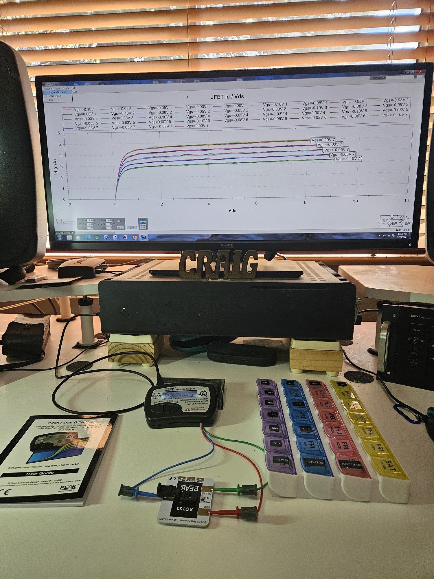

Want to build the best BA2018 for my purposes and 6L6 suggested above possible improvements from transistor matching and 0.1% resistor selection. Will report progress in three posts: matching, resistors, and audio analysis.
Here's the first on transistor matching.
Knew nothing about transistor matching before starting this project and Jim told me that the Peak SOT23 would be necessary for measuring the 2SK209 SMDs. Saw that this connected to Peak's DCA75 component analyzer so also ordered this.
The Peak analyzer is a great device and is way, way cool. It provides a ton of info on any part and connects to your computer for curve tracing. Easy to learn; cf. 'Peak Setup' below.
Ordered 100 of each of the 2SK209, KSA992F, KSC1845F and LTL-1CHE parts from DigiKey. Upon testing found variance to be huge. Decided to match eight parts for each class so that both channels were completely matched and therefore the soundstage would benefit. The KSA992Fs came loose and were the most variant – over 75 had to be measured before a set of eight could be assembled. KSC1845Fs were on cut tape and had less variance for match, about 40. And the 2SK209s came on reel tape and required 35 checks for final selection. Decided in the future to always order on cut tape for measuring/marking ease.
Use a 4-week pill organizer to organize parts into plastic bins.
The 2SK209s were matched by Idss values at 4.75mA. This would be impossible without the SOT23Test Adapter. Note in the 2SK209 JPeg below the 4 curve tracings. Each line merges 8 individual traces at 4 voltage levels. The small variances that occurs within each line are subtle and different than the PnP transistors. This Jpeg illustrates Peak's matching capabilities that are impressive.
The KSA992Fs are PNP silicon BJTs and were matched by the hFE value. All other values (e.g. VBE) follow suit. See the KSA992F Jpeg below. The curve matching is especially tight here at 505hFE.
KSC1845Fs, also PNP silicon BJTs, are also matched with hFE values (395). See the KSC1845F Jpeg below. Again, nice and tight overlapping among the seven traces for each Ic level.
The LEDs were measured just as a curiosity; it turns out their variance is low and a value of 1.921 volts covered many in the package.
Now have all of the transistors matched and ready for insertion into the PCB. Will be getting the high precision resistors this coming week and will report again once they are installed. Finally, will provide an audio comparison with the boards already being used to see what changes take place in the premium build.
