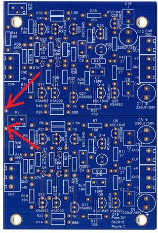

Well...I reflowed all the connections on the SMD devices, and have checked the connectivity. Unfortunately, it did not help. In fact, Q22 on the other side seemed to have a poor connection, so I redid it and now have +17DCV on the outputs on that side! I must have damaged it in the process---which makes me think I've got a damaged part on the other side, as well.
I'm not quite ready to give up on this board, but I think the next step must be to replace the JFETs. This part
https://www.mouser.com/ProductDetail/Toshiba/2SK209-BLTE85LF
is correct, yes? Anything else obvious to try first?
To confirm or rule out the JFETs being fried, you can measure the voltage drop over the associated resistors (I believe 10R ones? But can’t remember the exact value). Divided by 10 it should equate to approx 3mA for working JFETs.
Edit: please measure voltage drops across R1, R2, R4 and R5 for both channels and post here. Perhaps we can avoid a total rebuild.
And to state the obvious, don’t forget to triplecheck that your PSU is providing both negative and positive voltages into the circuit (confirm connected wires) just to avoid a blunder there.
Yes, check voltage drop across resistors: https://www.diyaudio.com/community/threads/waynes-ba-2018-linestage.329240/post-7747995

I have a dead board (new version, not the purples). Is there a schematic with target voltage ranges at various points in the circuit somewhere in this forum? Or, in the interest of continuing my education, is there a productive method for using a DMM to hunt for circuit problems? Thanks.
