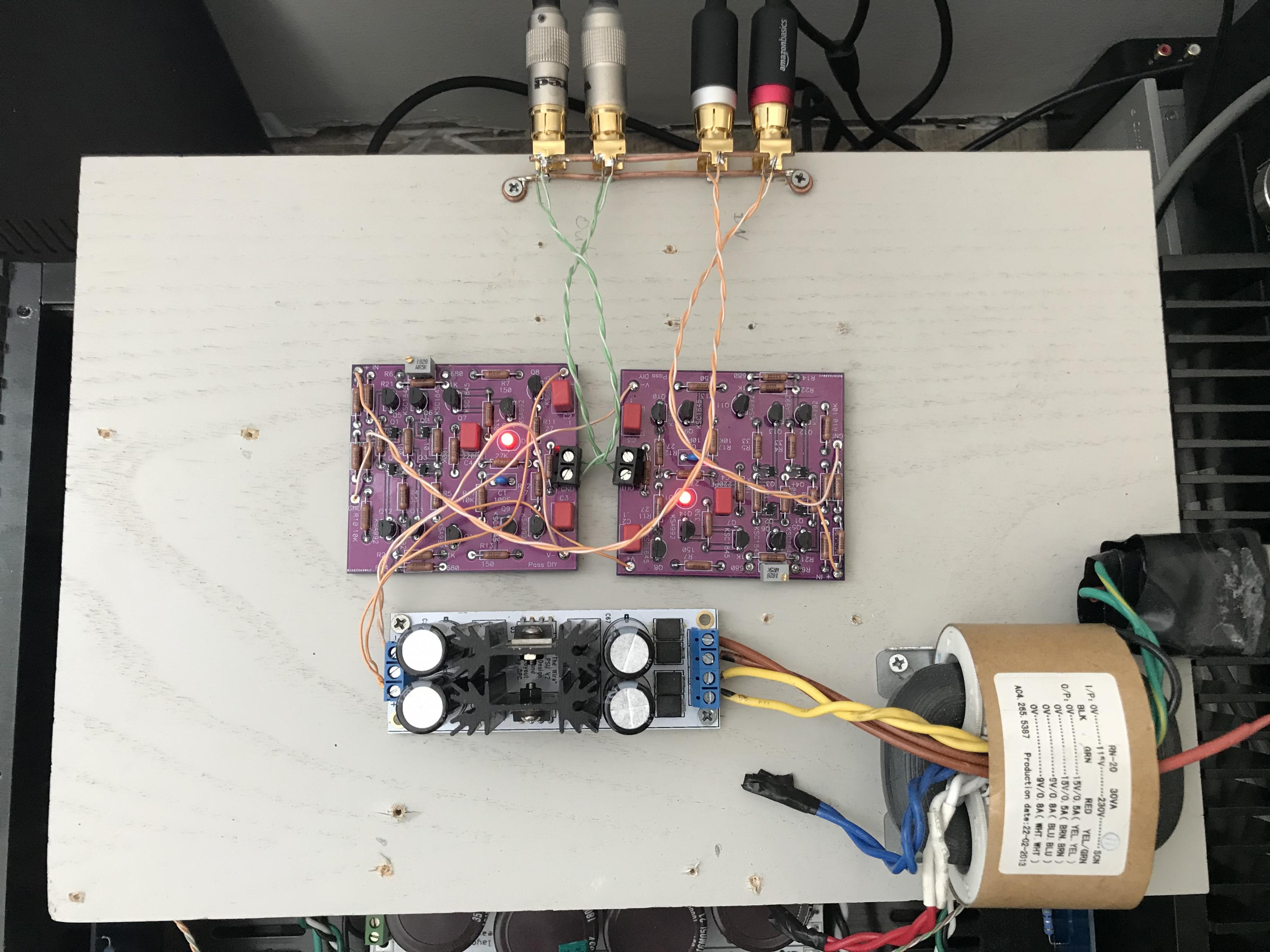

I just through together a supply that I had laying around. It’s very compact and sounds pretty nice. It’s based on dual TPS7A3301.

Damuffin - Looks fantastic!! Breadboarding a project is a great idea, simple to try, simple to work on if you're needing to tweak it.
PSU - Yours from The Wire is perfect. It's a quiet supply and small, the Burning Opamp is quite tolerant of supplies, I've tried 3 so far all with great results. Find a cool chassis and box it up!
Might want to add a potentiometer... 😀
