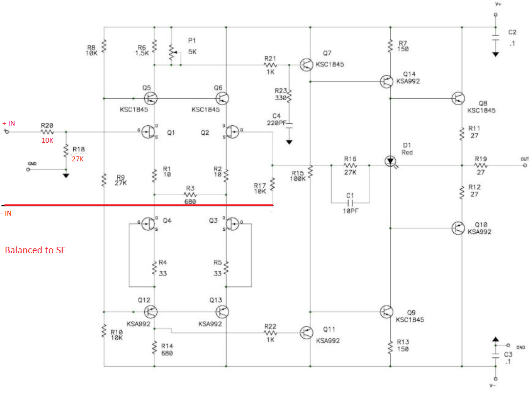

Wayne's BA 2018 linestage
That's all it takes to make the 'WABA 18' Balanced to single ended?
Cool
Thanks for taking the time!

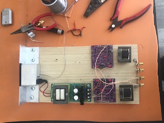

First, I like to thank Wayne for creating this design and sharing it
with us greedy boyz, and Jim for putting together the kits to help
us build this preamp.
Aside from the PCB and kit parts, the rest were recycled from old projects.
Unfortunately my transformer has some mechanical noise, which I find a bit
surprising given the relatively low current draw. Also one channel had a problem at
initial power up, which was traced to some flux residual at Q4. Cleaning that
fixed the issue. The rail voltages are +/-20V, coming from simple LM317/LM337
regulars.
The sound is very good and so far I don't feel anything is amiss when listening through
it. I may rebuild this in a new case in the future, with a switch to allow for
more inputs and a new transformer to avoid the mechnical noise. But for now,
I will enjoy it as is.

Great to hear Dennis!
A friend came over yesterday and he brought his new SIT-3 to listen to. (Wow, fantastic amp... :D ) Had to try the Wayne's Burning OpAmp project with it, and the general consensus was that it was a very, very nice match! The SIT needs a bit more voltage on it's inputs for full power, my Wayne BAF Linestage is running on 18v rails and outputs a beautiful 3.1vRMS (9vPk-Pk) which was enough to drive it to as loud as we wanted to hear it.

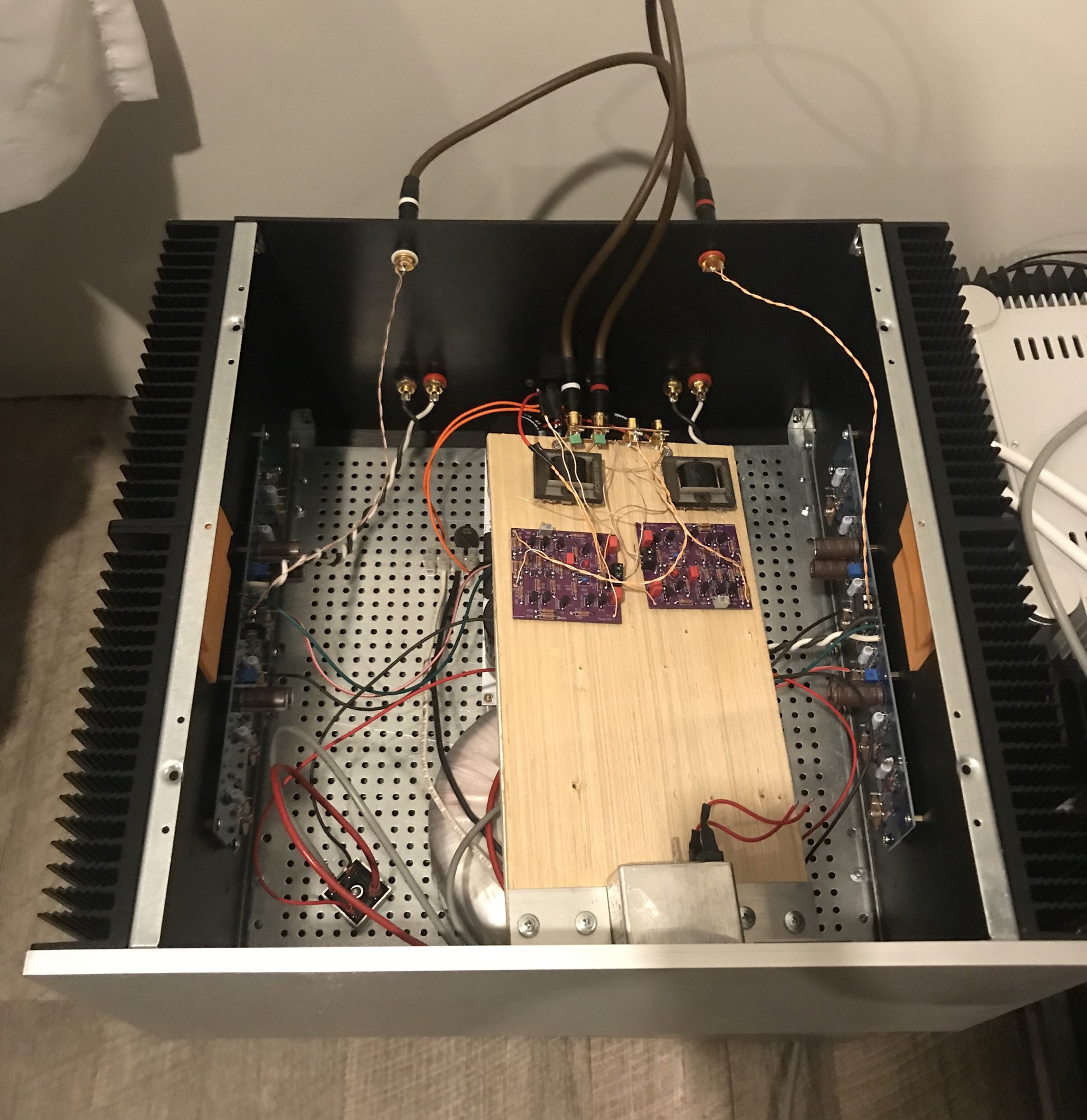

So sissy outputs failed to bring the details out in the music when pushing through the edcors. The midrange was very nice but that’s about it. My wimpy supply had to go. It’s designed for 18V but put out +/- 12V. So I tied it into the F4 supply, it had no choice but to make music now. At 3V Input it started to distort. I think the cause is my tiny supply wires. When I order and replace the output devices I’ll test it again and then we’ll see if we can create “Wayne’s M4.”
Photo from spy cam instead of Satellite. :rofl:
