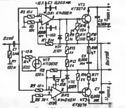

separate B+ supply line just for the VAS stages , but that separate B+ line can be derived from OPS B+/B+`lines, via two resistors and one smoothing electrolytic capacitor connected to ground ,it is somethig like this :
Good idee but why not the input ?
x
by inserting positive fbck(bootstrap) on input JFET`s drains you got max. gain with minimum thd , I think that if you supply input JFET stages from separate B+ line than cascode can help very much perfomance wise , but maybe bootstrapped cascode input stage is even better performer ?

The main purpose of the cascode is to establish a low drain-source voltage, while the voltage amplification is being carried out by a common-base amplifier. The thermal situation of Q3, Q4 can be worrisome. I would connect R19 and R25 to ground.
I am having difficulty suggesting appropriate bias currents at 35 V supply voltage.
