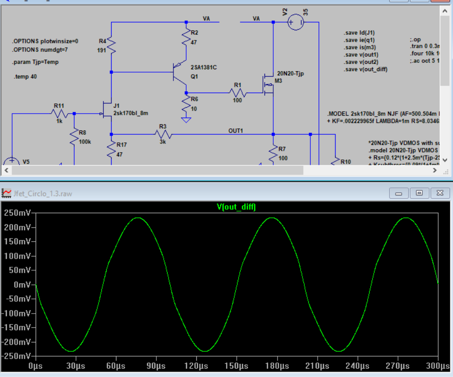

VSSA Circlotron
I used my application to realize 16 187 040 simulations 🙂
Results:
1) increase the 100ohm R to ground increases the distortion, I vary from 100 to 1000 in steps of 100
2) decrease the quiescent current of the input stage decreases the distortion, I vary from 2 to 2.6 in steps of 0.2
3) the distortion is lower when the VAS has a very low current OR very high (2ma vs 15mA)
4) Generally distortion decreases with the increase of mosfet current, at 1w as at 100W, except at mid power ...
0.03% THD 10khz 100W 4ohm
0.0005% THD 10Khz 1w 8ohm
Distortion highly depends on loading. You cannot simulate dynamic loading, but it needs to be taken into account in determining currents. You can, however, calculate valid voltage, current and resistor values for the whole circuit. Would you do that, please?

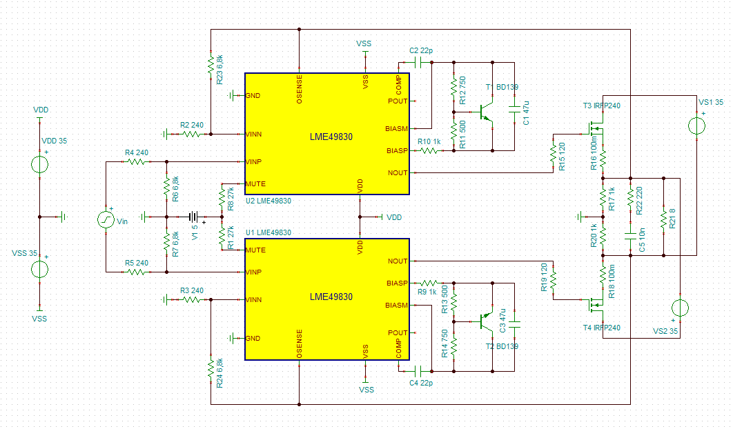

four CFA version
