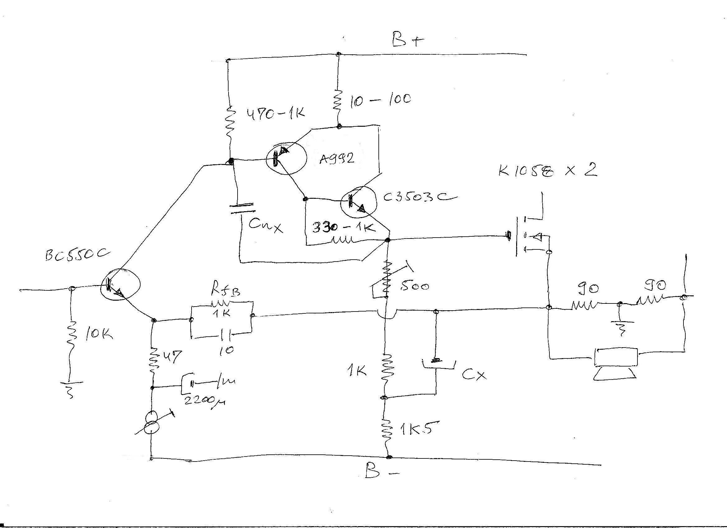

I want use this amplifier for 4ohm so yes multiple pairs

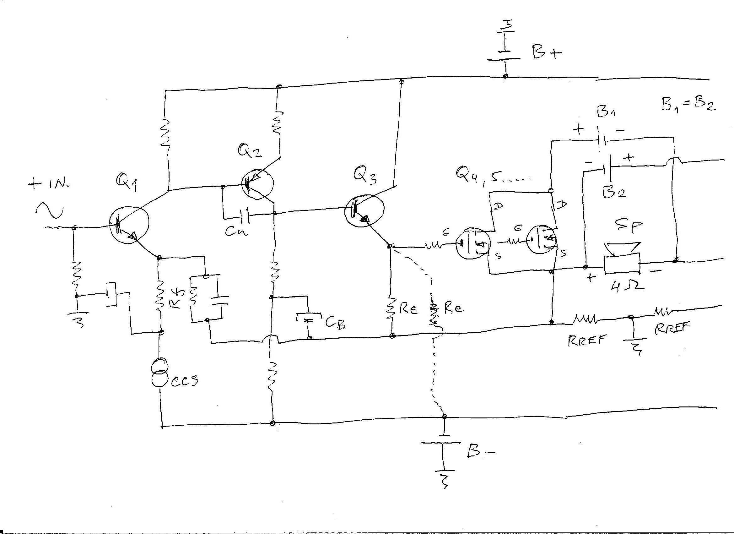

Here is my fast & provisional schematic with inserted follower (Q3) which allow to drive multiple output power LatFets , only half of the Amp is showed , but you have to find where lower side of follower emitter res. ( Re) is best rail point to connect , on the speaker rail , on the B- rail ,or even on the ground rail .
( BTW I like that generic simple VSSA Circlotron design with only two output power N type LatFets .since I deal with 16ohm (load)speaker )

I can't run your simulation right now but I think it will work in principle. I'd suggest checking all DC operating points with no signal to be sure they're where they belong.
Also, V2-V3 can be 24V or less, and the PNPs can be small signal devices idling at 5-10 mA. These changes are optional but may reduce build cost somewhat.

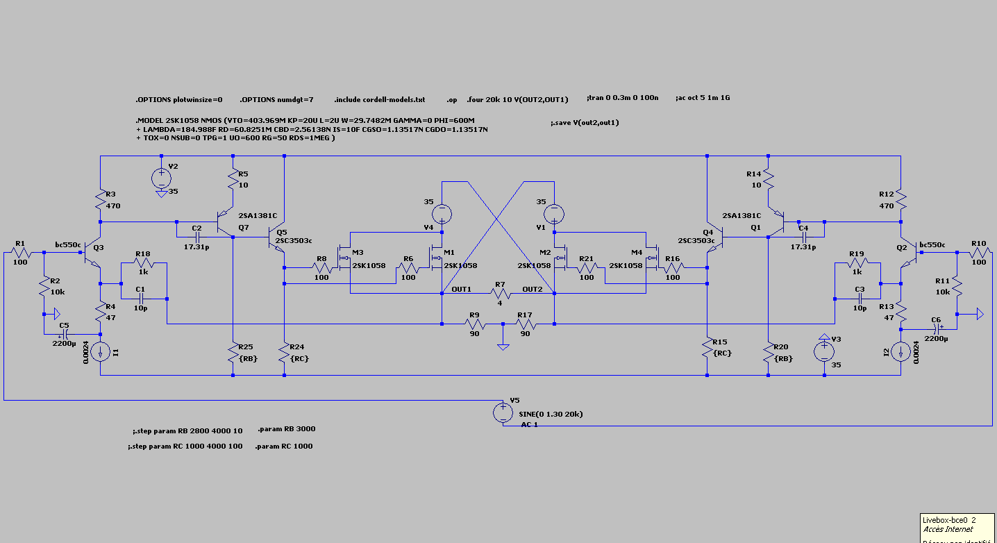

Well, I may have to take back what I said above about asymmetry. I just simmed a version of your circuit with differential feedback and it worked pretty darn well even with a single-ended input...

You should probably add bias adjustment in your circuit. Like pot in series with RBs or somewhere else...

It's basically the circuit UltimateX86 first presented, but with differential feedback applied as described in post #5. There is one other difference, which is that the output stage uses two HEXFETs biased as shown in the Thorens TEM3200 conceptual schematic that you see out on the web.
I first saw this bias arrangement in a BJT circlotron design that appeared in No.8 1984 of RadioHobby, a Russian magazine. It was essentially a lower-power version of the Sumo Nine, with the important difference that the bias current is regulated by a constant current source rather than resistors. This allows for the possibility of temperature compensation, and with that, for the use of either BJTs or high-gm MOSFETs as output devices.
However, this arrangement is not so good for use with lateral MOSFETs in the output, because it limits their drive voltage to twice the bias voltage, which is not nearly enough for full output current. It would probably work well with power JFETs, though.

Thanks. I suppose that it is the 560 ohms resistor that represents the pot.... Is the additional transistor (Q3) used to share the power with follower transistor?
Fab
I think some followers is must but just in case if you want to drive multiple pairs of power output LatFets .
