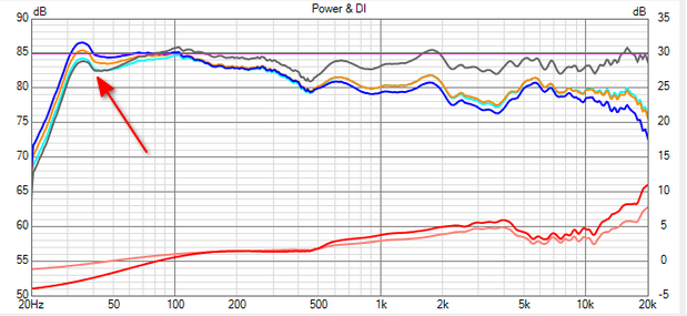

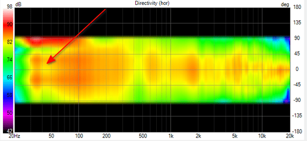

In the merge tool.
Here's an example of bad merge. It's not expected to see higher amplitude off-axis at low frequency for a monopole speaker:
Additionally, this error will show that power response is higher amplitude than on-axis response at low frequency, another red flag:
With "force to gradient" the issue is corrected:

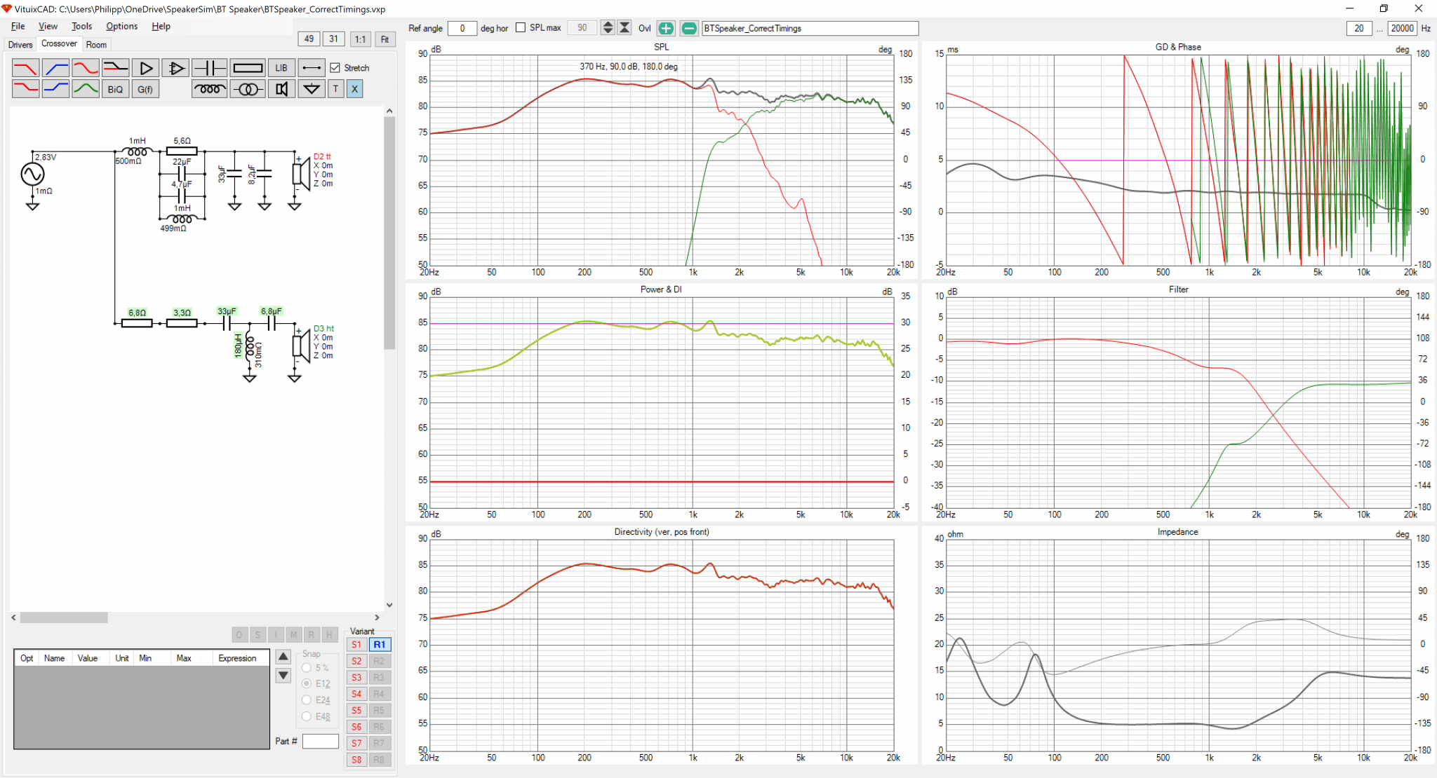

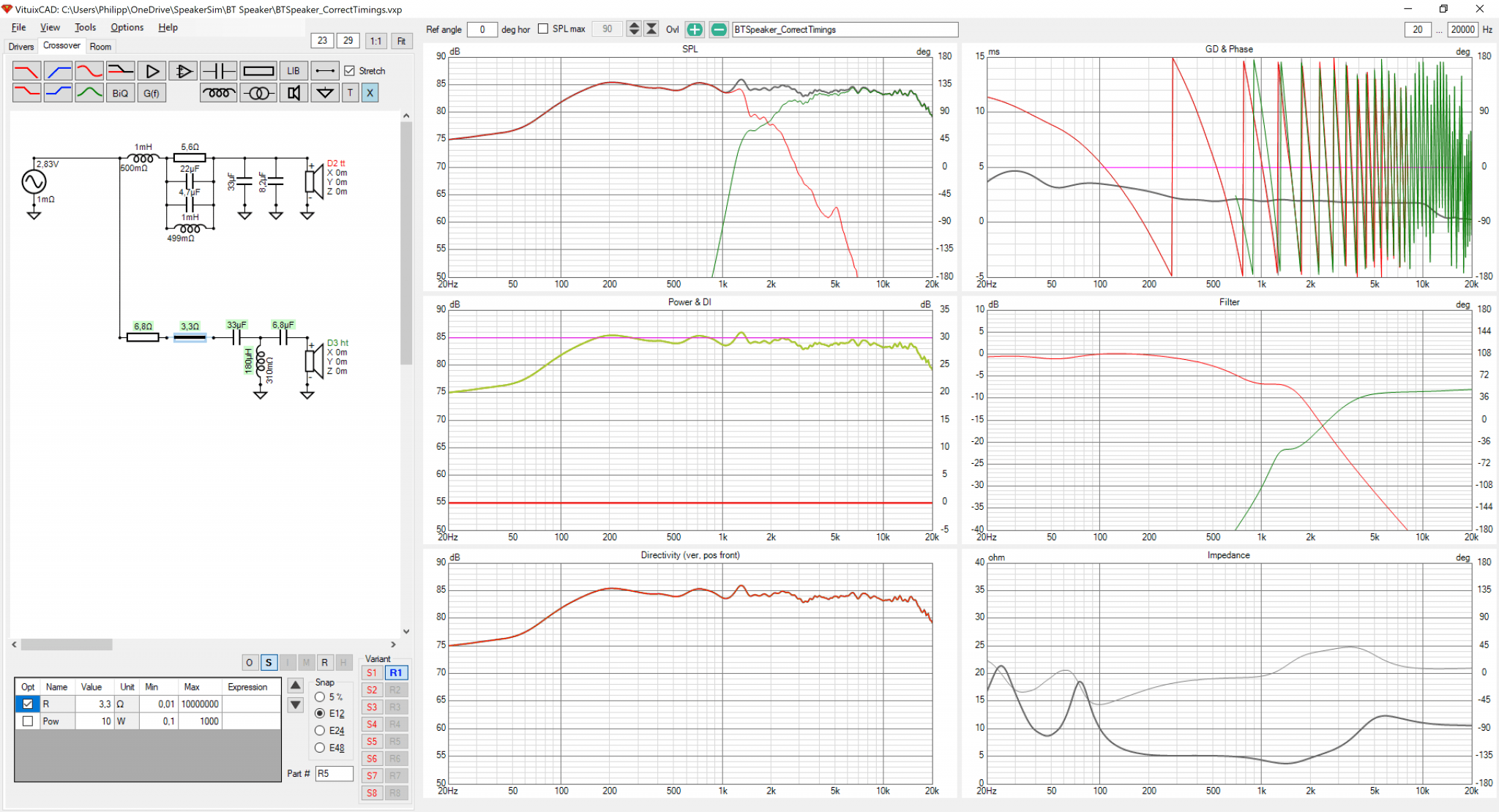

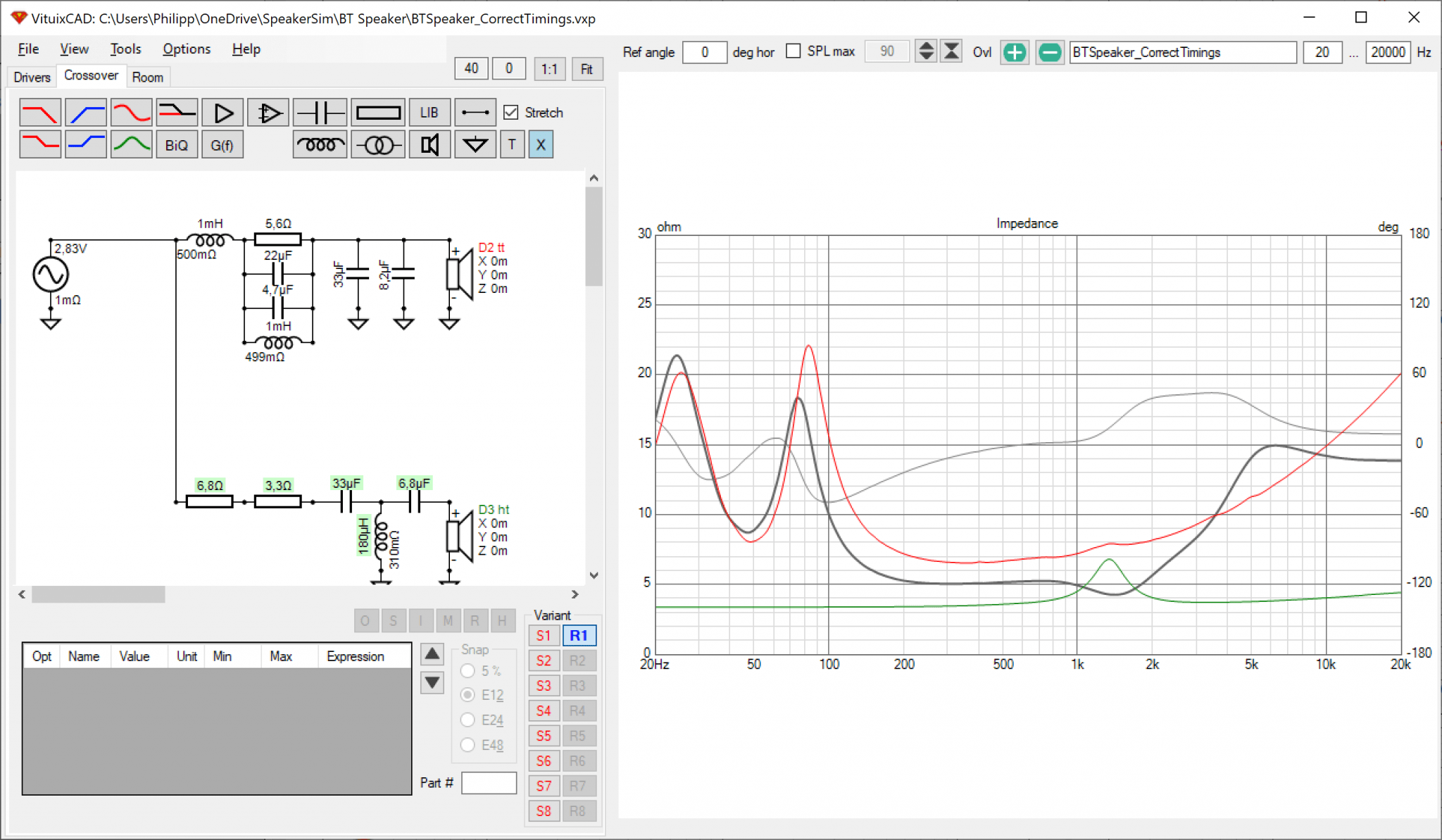

Hi everyone!
This is my first post, but im using VituixCAD since a while now to design my own loadspeakers.
So far, it has been very successful and I have to say im very impressed by the tool and what it can do. Thank you so much!
Until now, I've had a very good match between simulation and actual measurements with many speakers (once the crossover was built). But recently I had a weird issue which I need some help understanding.
In my recent 2 way speaker build, the tweeter level of the simulation is far off the real measured tweeter level (about 3dB offset) and I'm wondering why this might be.
First, here is what I did:
I am using a calibrated Sonarworks XREF 20 and a loopback timing reference for correct timing offsets.
When measuring the finished Xover for my latest speaker, the impedance curve matched the simulation perfectly, however, the FR was off. The tweeter was running about 3 db too hot! This was also very audible in my listening tests, the speaker was bright! The microphone was positioned the same way as for the raw driver measurements (between tweeter and woofer at around 70cm).
I adjusted the resistors of the xovers until the FR matched the simulation. I realized that I needed about 3-4 ohms more of resistance in front of the tweeter to match the FR, which is quite a lot! I also double checked the resistance of the tweeter circuit with a simple multimeter. I measured 10.3 ohms which matches the 6.8+3.3 ohm resistors almost perfectly.
So now I am wondering how to explain this offset. Does anyone have an idea what went wrong? Did I miss something?
Here are some screenshots, showing the issue. Please ignore the redundant parts of the crossover (had to improvise a bit because I lacked some parts 😀). Note that these only contain on axis data without nearfield measurements:
As you can see in the last screenshot, when shorting the 3.3 ohm resistor the FR matches almost perfectly, however, the impedance of the speaker changes a lot in the tweeter region as well. Strangely, I do not see this in the impedance measurement (Matches the original simulation perfectly).
Simulation of on axis FR:
Measured on axis FR with same xover:
Same simulation, but without the 3.3 ohm resistor:
Kind Regards,
Philipp
- Build enclosure and mount the drivers
- Measure impedance of each driver
- Compare impedance measurement with manifacturer data - should be plausible
- Measure (on and off axis) gated frequency response of the drivers in the far field (microphone at fixed position)
- Import frequency responses and impedance into VituixCAD
- Remove scaling and mounting position offsets in Vituix (as Timing offset is already included in the measurements)
- Design Xover in Vituix
- Build Xover
- Measure Impedance and compare to VituixCAD simulation
- Measure FR of Xover (as close as possible to original measurement positions)
Kind Regards,
Philipp

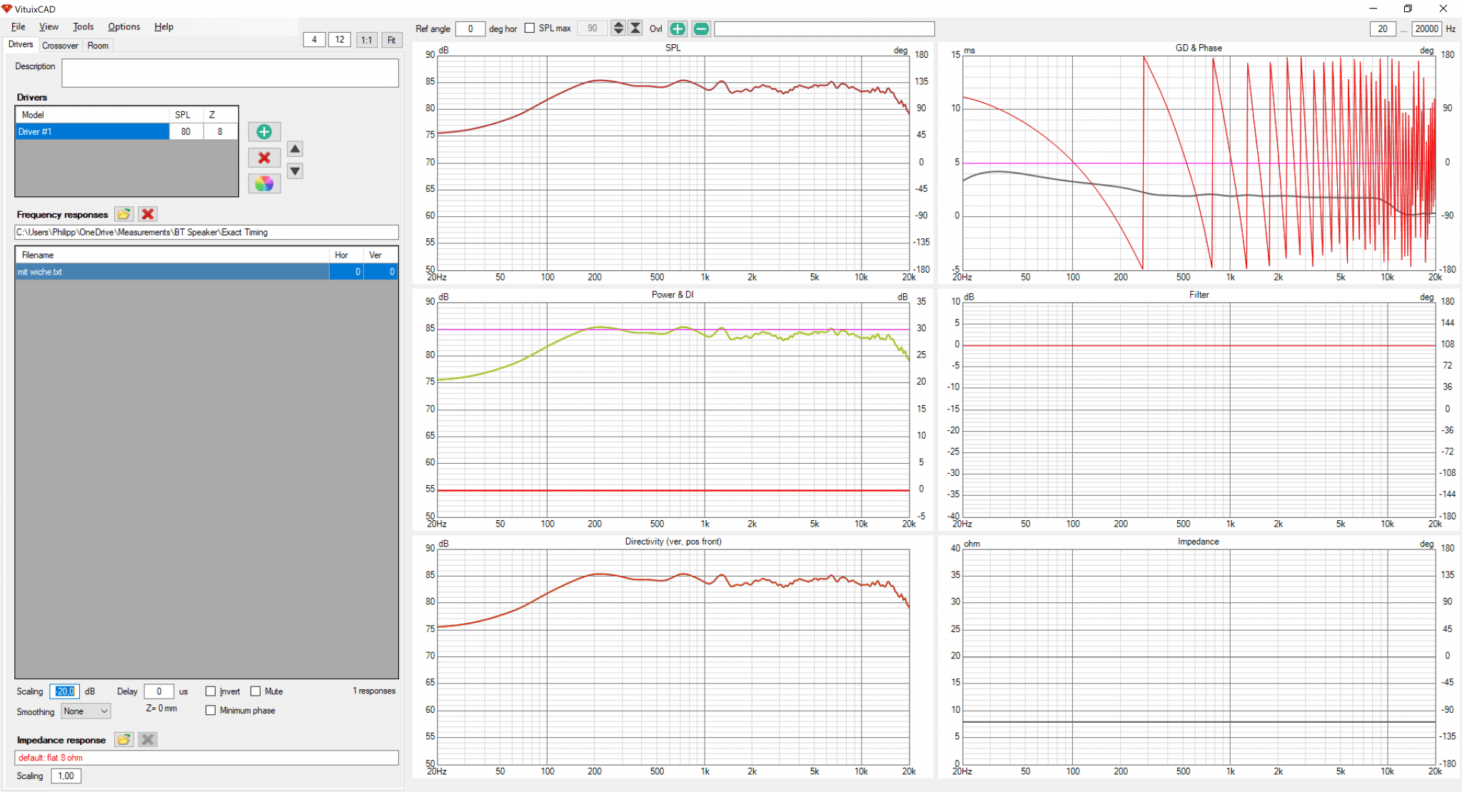

For some reason I cant edit my original post, but here are the measured raw impedences of the drivers and the simulated total impedance of the XO.
Unfortunately I didnt save the impedance of the real XO, but it matched perfectly (+- 0.2 ohm maybe), while the tweeter is 3db too loud.
The values for tweeter and woofer seem reasonable to me.
Tweeter: Dayton Audio ND25FW-4 1"
Woofer: Dayton Audio RS150P-8A 6"

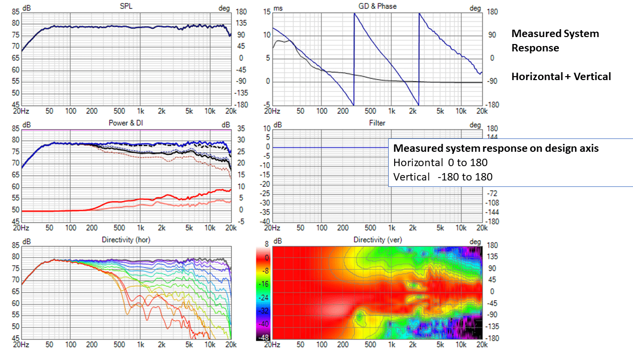

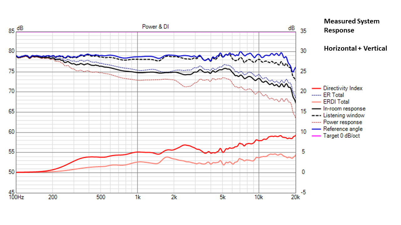

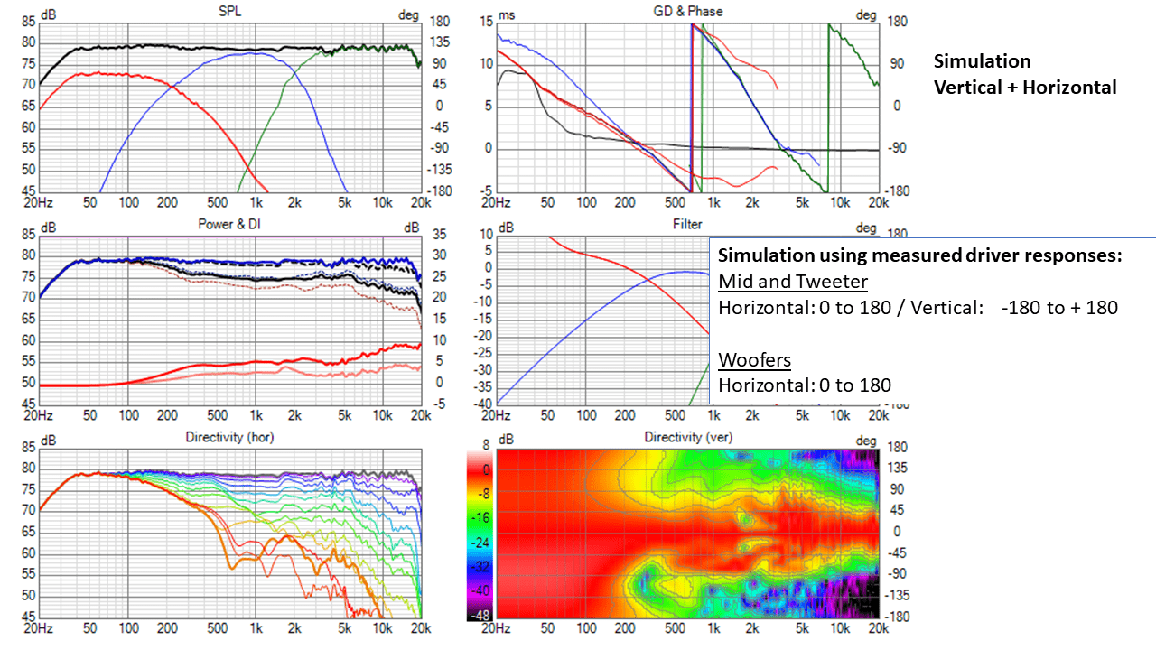

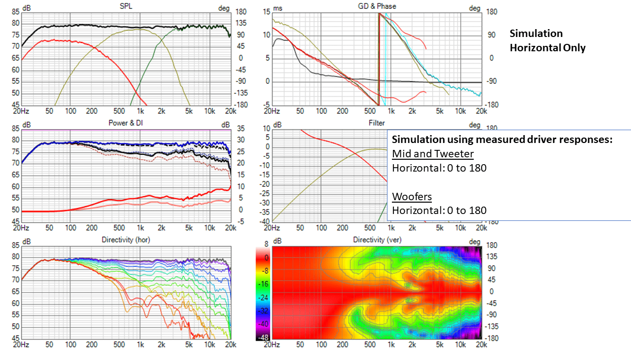

Joined 2003

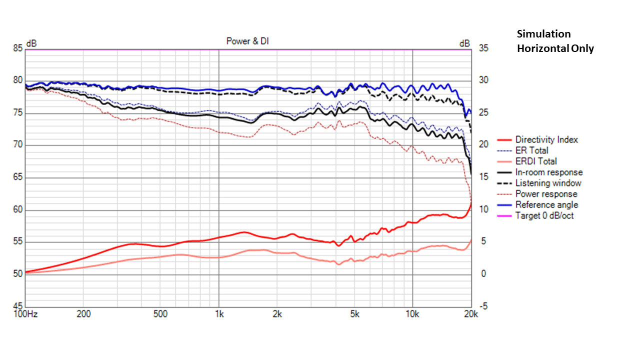

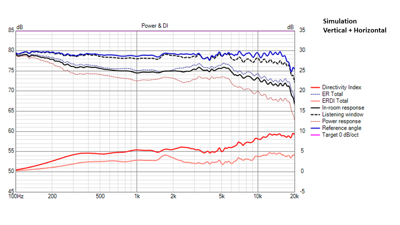

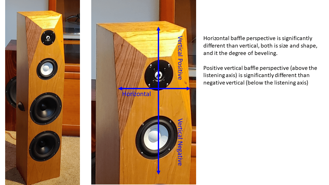

Apart from many red flags in the measurement process (suggest reading through VituixCAD measurement guide), for your specific problem at hand, first check would be to simple re-measure woofer and tweeter on-axis and compare the amplitude against your design data, to ensure that you haven't bumped the amp volume or measurement level between measurements. Another check would be to confirm scaling values in driver tab for each driver are not adjusted, not shown in your screenshots.
In the past, I have measured the horizontal and vertical polar responses of smaller two-way mid-tweeter systems, and I have achieved a near perfect match between simulation and measured system response. This included power response, DI, ER, etc. In order to get this level of agreement between simulation and system measurements, I found I need to measure both vertical and horizontal polars, both at the driver level and at the system level. For these systems, I cross to a large sealed woofer box in the 160 – 200 Hz range, so there has never been a need to capture polar response or directivity of the woofer.@hifijim For the speaker you’ve shown, you may be able to get away without vertical measurements at all, since all the drivers are round and located middle of a symmetrical baffle. Assuming you’ve already gathered data for that speaker, have you compared the Power & DI chart with full data set vs just loading horizontal measurements?
When I started this project, I assumed I needed to proceed in the same way. The shape of the baffle and bevels around the tweeter and midrange led me to believe that the vertical polar response might be significantly different than the horizontal. From the horizontal perspective, the baffle is very narrow. From the vertical perspective, it is a very tall baffle. It is also highly non-symmetric in the vertical direction, meaning that positive vertical angles have a significantly different baffle perspective than negative vertical angles.
However, I did not anticipate how difficult it would be to make vertical polar measurements of an 88 lb speaker. The rotating table shown in post #4239 was the second attempt after the first rotating jig failed to work. It was a lot of added complexity to the measurement phase of the project. So @DcibeL has a very valid question as to whether or not this extra work actually adds value.
After looking at all the results of the completed system, I conclude that having the vertical polar measurements made a small difference. If I had simply used the horizontal polar responses, I would have ended up with the same DSP filters, or so close to the same as to be negligible. Final tuning is done by listening in any case, so I think I would have ended up with exactly the same final product.
Neither of the two simulated responses are an exact match to the measured response, unlike my previous projects which were all smaller 2-ways. I have a theory about that. When the speaker was positioned horizontally on the table for vertical polar measurements, it rotates through a circle that is almost 8 feet in diameter. When the speaker was rotated to -90 degree position, the bottom of the speaker was only about 6 inches from the microphone at that point, so this was not really a valid far-field measurement. In addition, I am certain there was some diffraction caused by the table. Both of these factors are unavoidable given the size and weight of the speaker, but I think they explain why the simulations differ from the measured system response.
j.
edit: I am not sure why my attachments did not post in the correct order... should be slide1, slide2, slide3... etc.
I would be very interessted in improving my measurement process! 🙂 Would you mind explaining which red flags you mean specifically?! I've read through the REW + Vituix Tutorial and thought to match it quite well.
Note that I intentionally left out many steps (e.g. NF measurements and baffle step correction) because I figured they are irrelevant for the tweeter level issue.
Regarding your suggestions: I already did that today. In fact, the data from the screenshots was from todays measurements. I took the driver and total XO measurement in the same conditions, same day, literally just re-soldered them on the XO. 😀
Here is what I checked already:
- Double checked loaded mic & soundcard calibration in REW
- Check against Umik1 FR - Same result
- Use a different Amp for the final FR measurement (Class D) - same result
- Raw measured Impedance response of the tweeter vs manifacturer spec --> matched very closely. Im also using a calibrated impedance measurement (using REW calibration) to remove slight additional resistance from bad soldering and cables. I think that even if there is a small error here it cant explain the large offset, as impedance would have to be far off (approx factor 2) to explain 3 db offset.
- Impedance scaling in VituixCAD set to 1.0
- Frequency response scaling/offsets in vituix for all drivers set to 0.
- 0 offsets for all drivers in vituix
- Measure actual resistor values with multimeter --> seems ok.
I'm wondering if there is a way I could have messed up the real XO which alters the tweeter FR without actually being visible in the Impedance Measurement.

Oh, maybe this is a misunderstanding, but this is the same speaker and tweeter. I just compared simulation with actual measurement.
I am aware of large manifacturing tolerances (especially with tweeters), but those cant be at fault here 😀

@hifijim Just some supplemental information, wording about the vertical axis is included in VituixCAD measurement guide:This suggestion was based on past information provided by Kimmo, where the difference in overall power & DI chart is not greatly affected by the difference in diffraction response of the vertical plane, so there may not be much value in measuring vertical plane if the drivers are round and normal rectangular baffle, esp symmetrical layout.
Main thing to keep in mind for comparing measurement of final speaker to simulation in VituixCAD, is if your measurement of final speaker is at 1m, change listening distance in VituixCAD to 1m for comparison. For big speakers this difference between measurement distance and actual listening distance can be quite significant. Just remember to change back to normal listening distance 2-3m when complete.
Measurement of vertical plane can be skipped if the driver and possible wave guide/horn are circular i.e. directivity in vertical plane is equal to horizontal plane. Skipping of vertical plane could cause small hump (<1 dB) to power response at diffraction peak frequency if baffle height is much longer than width. In that case sound balancing should be weighted by on-axial response around diffraction peak frequency (wave length = baffle width).
