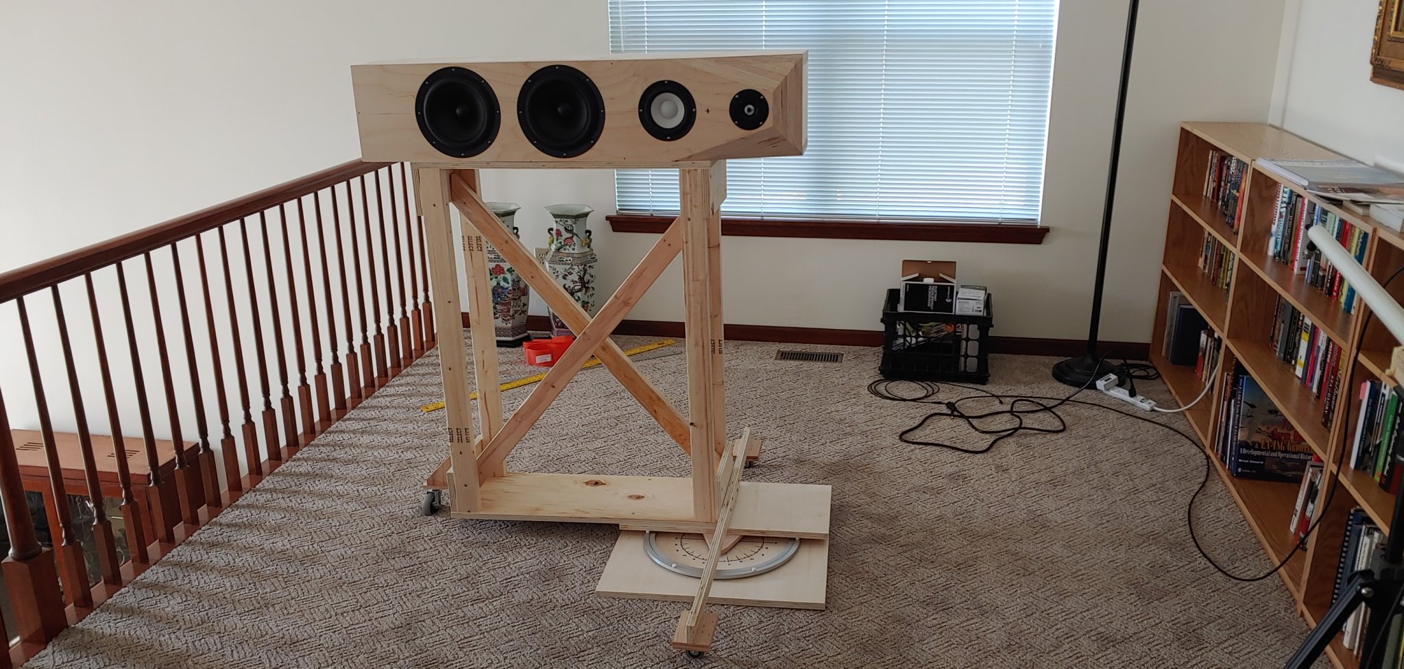

I am building an automated turn table for polar measurements. Is there any way to compensate for the fact that the axis of rotation is center of gravity instead of center of the front baffle?
I hope you just mean centre of the cabinet, which won’t be the centre of gravity, it’ll be front heavy 😉
I would focus efforts on building the turntable in a way that allows you to use the front of the baffle as the pivot point, rather than trying to fix measurement data that doesn’t use this pivot point.
I always position the speaker so that the axis of rotation aligns with the front baffle, specifically the center of the tweeter. This means the center of gravity is NOT over the center of rotation, and it can be challenging to get good measurements without the speaker falling off of the turntable. VituixCad may be able to take off-axis rotation into account, but I have never tried it.
When measuring the vertical response of a large speaker, it is sometimes necessary to suspend or support the speaker as it rotates.
Reactions: AllenB and Mazza
@hifijim For the speaker you’ve shown, you may be able to get away without vertical measurements at all, since all the drivers are round and located middle of a symmetrical baffle. Assuming you’ve already gathered data for that speaker, have you compared the Power & DI chart with full data set vs just loading horizontal measurements?
For measurement centre of rotation, of course you can compensate each measurement with delay for the location measured vs where it should have been, but it gets tedious/complicated with increased chance of error, as well the windowing of each measurement can get to be a fair bit off due to physical distance of speaker to mic at various angles. I would just avoid this scenario if at all possible, it’s “asking for trouble”.
