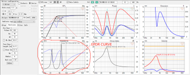

Hello @kimmosto and All,
Is it possible to add an EPDR curve to the impedance window in the enclosure function to make the job easier。
