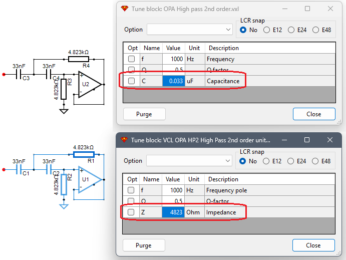

Thanks a lot Kimmosto, it answered my second question. But can you help with my first question? There seem to be two types of active xo blocks in the library, ones which have VLC Unity Gain in their names and ones which don't.See User manual -> How to start ... -> Tip 4
https://kimmosaunisto.net/Software/VituixCAD/VituixCAD_help_20.html#How_to_start_with_VituixCAD
I trusted you can see the difference. It's the same connection, but with different user parameter: C or R.But can you help with my first question?
VCL lib is not done by me so there may be some others with close the same functions.
https://kimmosaunisto.net/Software/VituixCAD/VCLLabs_opamp_filter_blocks.pdf

Yes, I saw that it's just a different set of values, therefore I was confused by the name. The VCL ones said "unity gain", so I thought that the non-VCL one would not be unity-gain. But when I changed the Q or frequency, I did not see any change of gain, therefore I got confused.I trusted you can see the difference. It's the same connection, but with different user parameter: C or R.
My limited reading of active filters is that there is Sallen-Key topology and unity-gain, and while Sallen-Key is more flexible in the range of values one can use, it's not unity gain. That's where my questions and doubts came when I saw this other library labelled "unity gain".

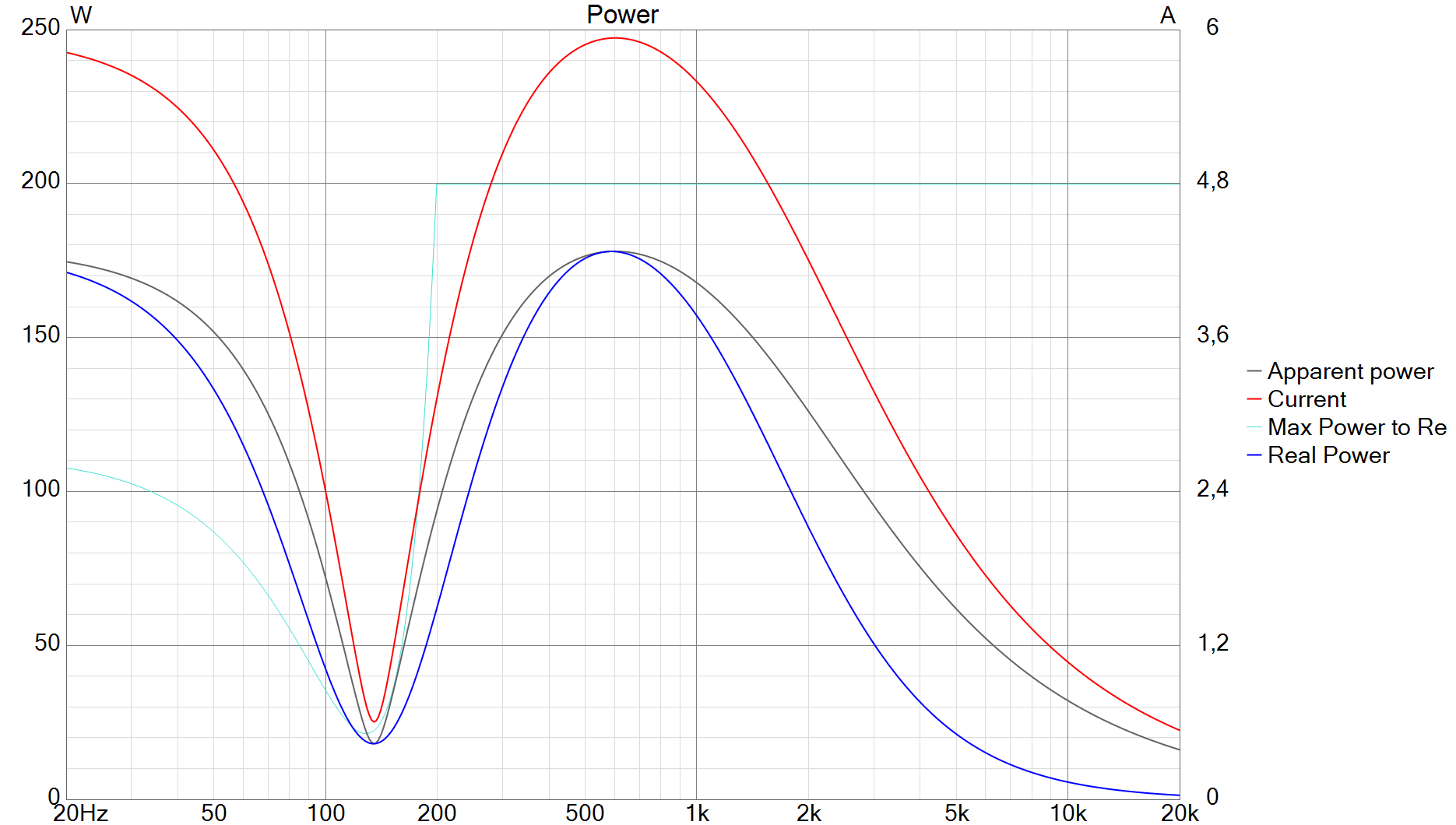

Hello Kimmosto,
may I suggest a feature that I'm missing in your great software?

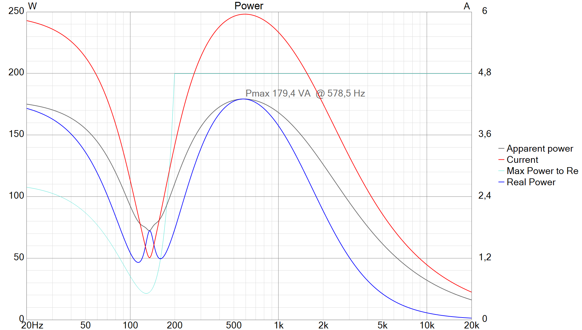

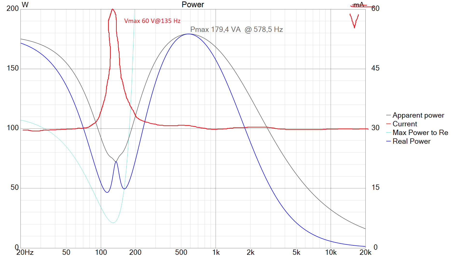

Would you be able to include a voltage curve in the power window of the enclosure tool? Maybe as a switch between current and voltage. when I'm trying to match a driver and enclosure to a given amp I often apply peaking, LT, HP and LP filters and I end up having to calculate the resulting voltage that my amp would need to supply by multiplying the input voltage with the filter gain. A voltage curve in the power window would speed this process up a lot.
Here's a simple example:
Let's say my amp is capable to deliver 40 V above 4 Ω.
Woofer in sealed box, input Voltage: 30V, no filters
same box, but with a 6dB peaking Filter at 135 Hz
now the resulting voltage is 60V at 135 Hz, which my amp can't handle. Unfortunately I can't easily see that, unless i divide power by current or multiply input Voltage with the filter gain.
A Curve like this would help a lot
I'd be really happy, if you could add that feature. Thanks a lot for your effort and your dedication to this great software.

^Gain curve does not give voltage directly but it's a bit easier with supply voltage than Power chart.
Anyway, I can investigate how to show V in some chart.

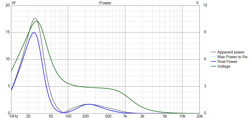

Coming in a week... Includes supply voltage U and active filter stages, but not passive components.
2.0.124.0 (2025-05-07)
Enclosure- Added passive parallel filter branch Cp+Lp+Rp to Filter tab.
- Added 'Track Fb and Qtc' checkbox for Linkwitz-Transform. Copies Fb and Qtc of closed or IB to fo and Qo to help setting up L-T.
- Added optional voltage trace to Power chart. 'Show voltage' command in context menu replaces current trace with voltage.
