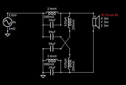

How would I connect this correctly?Passive 2nd order all-pass library block added to setup of rev 2.0.3.11
Joined 2003
On the surface this may look like a mess for impedance, but it tends to "pass through" the driver for the most part so place this before the driver and continue your cross, while keeping your eyes on the prize.. in other words the wanted response and phase.
Thanks! Maybe I'll use that in a later project again. For this project I'd need ~30mH inductances. 😀

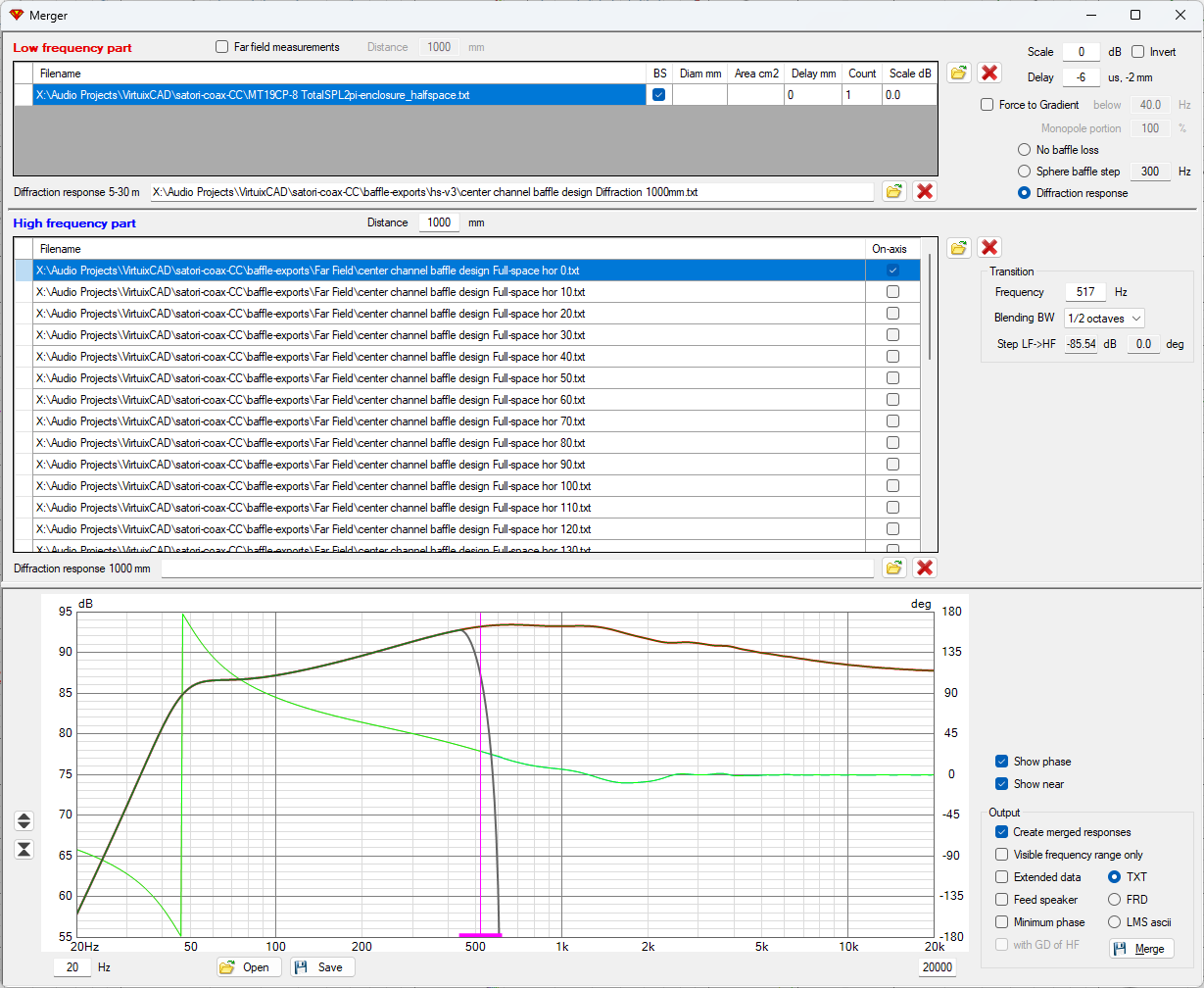

Thanks for your response. Life has been busy so I'm just coming back to this.Did you merge the measurements correctly, eventually also adjusting the level in the merger tool? Could you show a screenshot of merger window with your midwoofer?
Here's what my merge window looks like.
I've been following the "simulating without measurement" PDF, which was what guided me to this point. It advises:
"You should see good agreement around 200-400Hz. Select the transition frequency at the lower end of where the frequency response overlaps. Save the merged resulting response set."
Tonight I tried merging things around 4khz (well past the crossover point at about 2khz), and it looks more like I would expect. Not sure if I might be missing something since I'm merging things so much higher?
Hi, you have 85db LF -> HF step, this information is visible right side of the high frequency part. So you have to use the Scale on the nearfield data to make this step ~0db. Also, add cone area on the nearfield data row, or at least refer to manual what it is for as it relates to this gain matching. This seems to be something you are missing here.

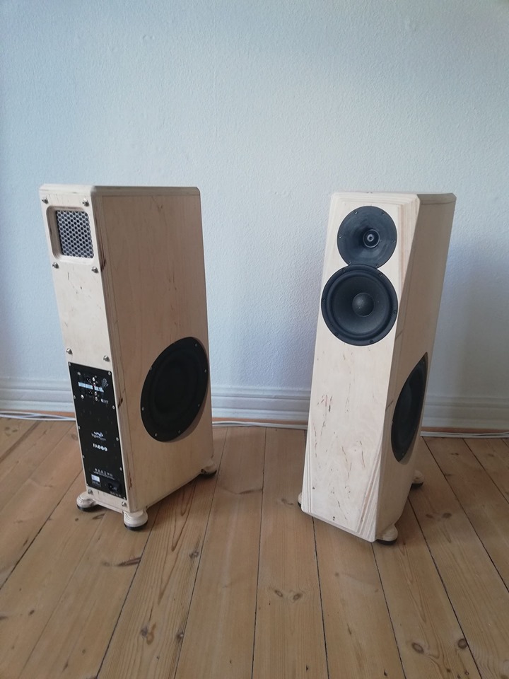

Hey guys!
I have build these speakers 5 years ago. Its currently a "2 way speaker with build in subwoofers" as I'm crossing at 80 hz to the 10". There are TWO active 10" in each speaker - one on each side mounted back to back. The two woofers share the same volume. They are driven by a set of Hypex FA253's.
They sound great, especially the 20-100-ish Hz range/punch and rumble. Im very happy with that part. However, I belive I could do the integration of the tweeter and midwoofer better today. maybe also improving on the integration between the woofers and midrange.

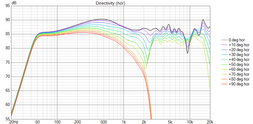

I started using VCAD more since they were build and I think I am starting to get the hang of it. Therefore I was planning to redo all measurments of this speaker and get it simulated properly in VCAD. However, all other speakers i used VCAD for have crossovers in the 600+Hz range. So the crossover between the woofers and midrange in this speaker is challenging me.. add to that the dual side mounted configuration.
I am so locky that I can use a small anechoic chamber for the new measruements. The room is 2.4 x 4.6 x 2.0 m w/l/h (free space there are additional 3m of absorbtion all the way around that). No idea how deep in frequency this will let me go, but exited to see that. I use a Focusrite Scarlett 2i2 4th gen with loop back and REW for the measurements.
I have read the manual of VCAD from start to end as well as the REW specific help document (That one many times xD). However, Im still in doubt of how exactly to do the mesurments of especially my sidemounted woofers properly. From what I have read this is my best guess so far:
