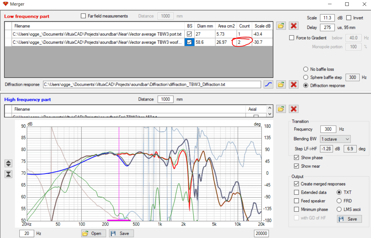

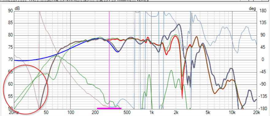

I have a question regarding the merger tool. I have two woofers wired in series in a bass reflex enclosure with one port. I have measured near field responses of one of the woofers and the port with the drivers connected in series. The far field responses I have measured with one of the woofers connected only (the other disconnected). Should I enter count as 2 for the woofer near field response or should I keep it as 1? Read somewhere back in the thread that it should be 1 for this case but that does not make sense to me
EDIT: Maybe the most intuitive is to have count of 0.5 for the port (since it is shared for two drivers) but I guess the end result is the same

2 woofers, enter count of 2. count, diameter, distance all are just to pre-determine required amount of attenuation required between near and far field responses, but only works if output level, mic preamp gain is not changed between near and far field measurements. As always, use your eyes as your guide and adjust levels accordingly in the chart. In your chart, far field data has significant reflection information from 300-800Hz range, I would re-consider far field measurement and window selection before proceeding. Near field and level scaling looks okay, port output looks a couple dB too low.

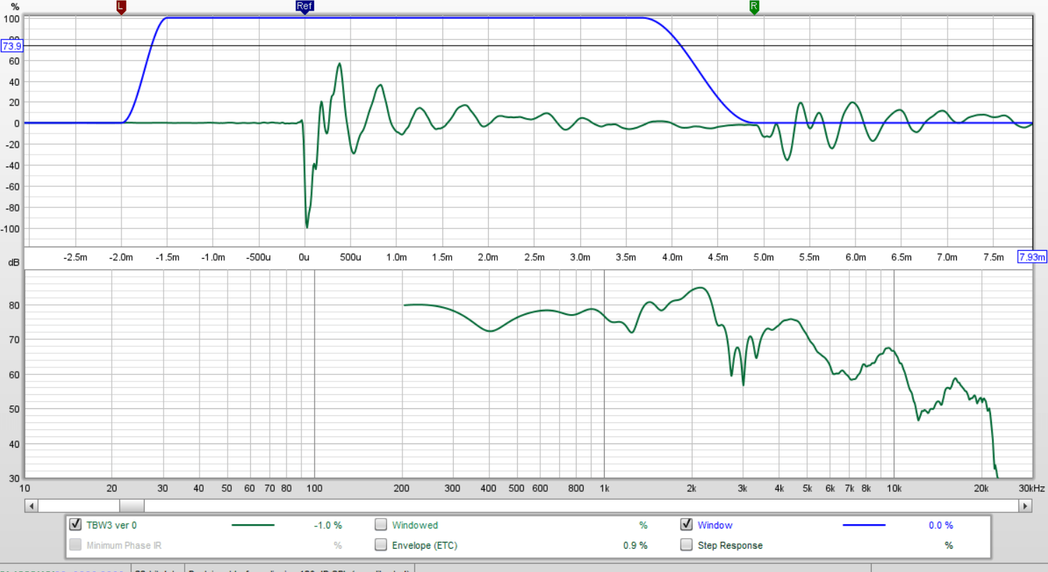

Thanks, not sure what I can do with the port output level. All nearfield measurements where taken at the same output level, port diameter is correct and driver area according to spec sheet.

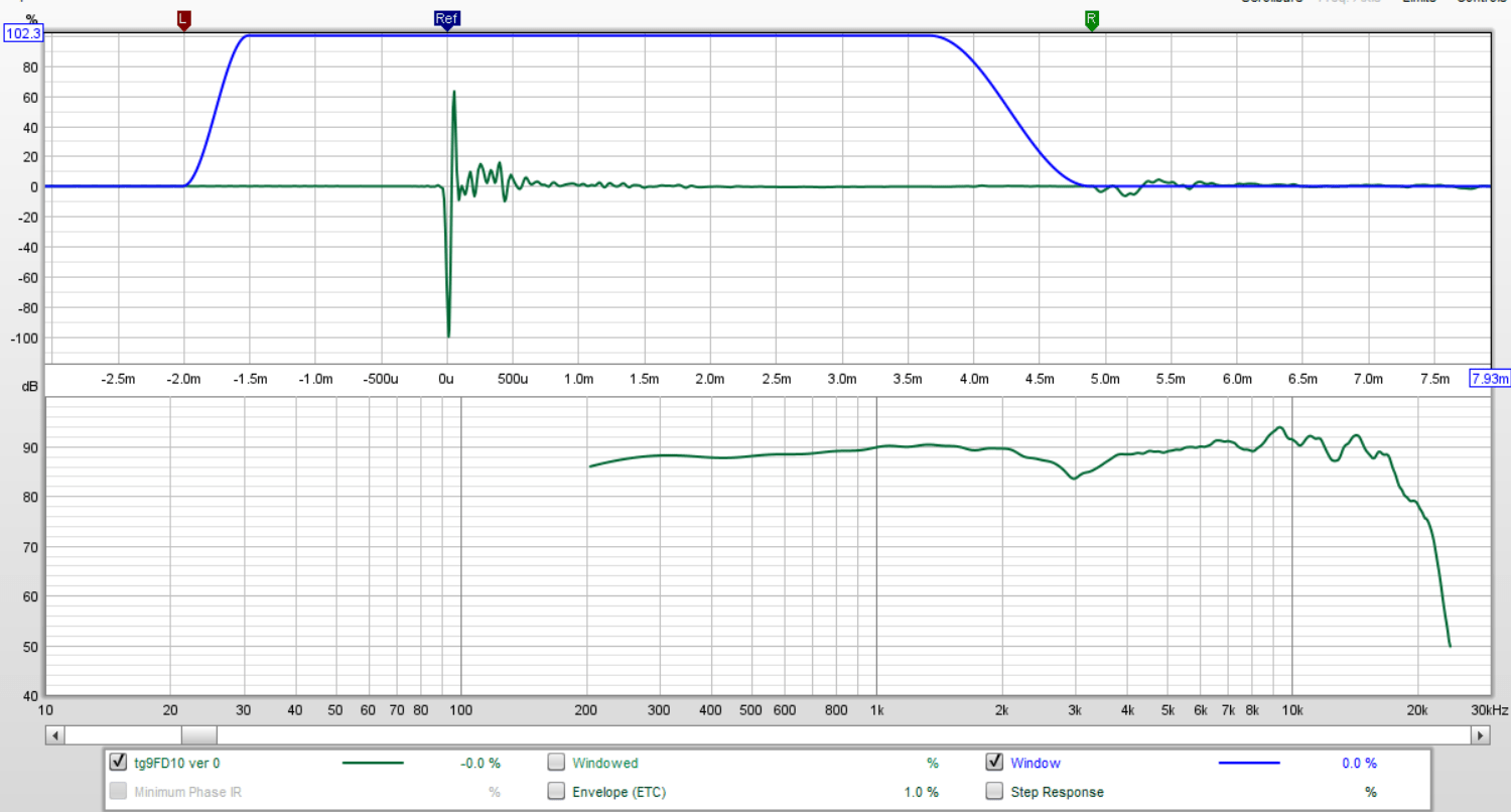

I have 4.9 ms of reflection free time, driver is a 3" subwoofer which seems to have some resonance issues here and there

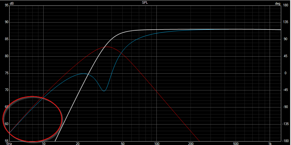

you can adjust it manually / visually. Reason I say it's a little low is circled in red here:Thanks, not sure what I can do with the port output level. All nearfield measurements where taken at the same output level, port diameter is correct and driver area according to spec sheet.
Neafield woofer and port response should converge as frequency approaches 0Hz. It can be tough visually if you decrease min frequency on chart <20Hz because will run into lack of signal an noise floor, but simulation response gives perfect example of what to expect:
Resonant issue is not present in nearfield response, suggesting far field reflection problem.I have 4.9 ms of reflection free time, driver is a 3" subwoofer which seems to have some resonance issues here and there
Thanks, I'll align the tails the woofer/port output.

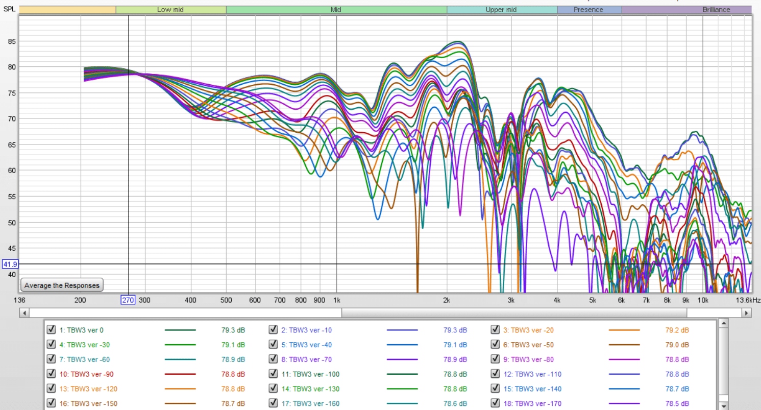

Not sure about the cause for the smooth near field measurement and the peaks and dips in the far field, this is only seen on the woofer and not on the full range driver (same measurement setup). This is the impulse for the woofer (ignore wrong polarity):
The 400 Hz dip disappears of axis:
Exact same measurement setup was used for the full range driver which looks clean:

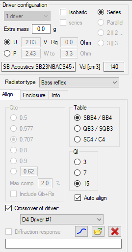

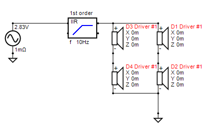

I am simulating an enclosure and have a clarification to ask.
The crossover is used as shown in the diagram below.

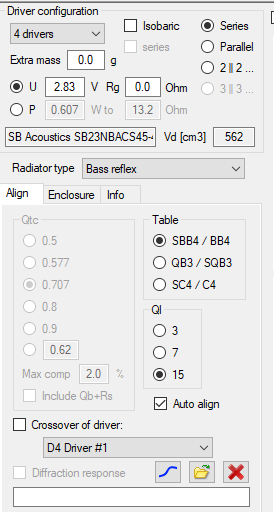

When I don't use the "Crossover of driver" option I am able to select the "Driver Configuration" Option and add more drivers but if I select the "Crossover of driver" option than the "Driver Configuration" Option grays-out and cannot select more drivers anymore.
My question is if I add 4 drivers in crossover schematic does the App takes it as 4 drivers already added in the simulation and does not want to repeat it in the enclosure design section?
If there is some confusion in the way I am doing, pls guide the right approach to be made.

Looks that it's my responsibility as an author to answer to difficult puzzles (though I kinda promised to stay away from diyaudio).My question is if I add 4 drivers in crossover schematic does the App takes it as 4 drivers already added in the simulation and does not want to repeat it in the enclosure design section?
Transfer function (including generator's output voltage) of ONE driver instance in XO network in the main program can be transferred to Enclosure tool. Therefore Enclosure tool prevents you to simulate more than one driver at a time when 'Crossover of driver:' is checked and driver instance is selected in Align tab. This limit does not prevent you evaluating how much you can load (power, excursion, air velocity, ...) individual driver, what volume is needed for one driver and what resonance frequency is okay with reflex system. This approach works also with passive and active filters where individual drivers in shared box volume have different components or active transfer function.
After load & excursion evaluation is ready, you can scale the system for as many drivers you like by unchecking 'Crossover...' and multiplying volume with number of drivers, increasing port area keeping Helmholz resonance constant and driver connection compatible with XO in the main program.

Hi Kimmosto, thanks for breaking your vow to answer my question.
Can I do the following?
1. Simulate transfer function with one or more driver.
2. In the XO network add required drivers and see the final results.
I reason I ask is XO Impedance, Resistance and Cross-over frequencies will get altered if I don't add multiple drivers in the final simulation.

Purpose of "Crossover of driver:" link is to TEST how much driver+enclosure system can handle voltage with certain transfer function such as Linkwitz Transform without exceeding Xmax or Pmax. Nothing else. So please do not try to DESIGN speaker so that you play with XO in the main program and driver+enclosure system in Enclosure tool at the same time so that transfer function in driver terminals and impedance response are linked between the tools. Follow recommended design procedure which can be found in user manual.Can I do the following?
