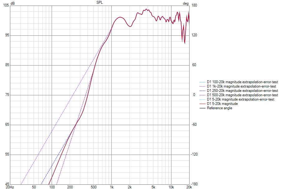

Quick test, I took some compression driver measurement I had. It is 5-20kHz sweep and then copied it and just deleted data and made a comparison.
Not sure if the graph is readable, but at least in this case data up to ~250Hz could be truncated without any meaningful change in response. As you see there is some wiggle around ~300-400Hz in the measurement for some reason, not a steady slope, so truncating data there or above the slope would make some error compared to full bandwidth measurement. This doesn't mean my measurement is error free either, so extrapolated response is probably within same error margin as long as truncation is somewhere on the more or less steady natural high pass slope, below drivers' main resonance.
The graph shows that error of extrapolation would be below where the measurement data starts. If this is sufficiently far away from crossover I'd say there is not much of a difference. But, as stated earlier one might as well measure from 5Hz up than rely on extrapolation.

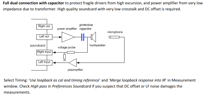

Phase response and directivity should be evaluated too when deciding starting frequency. I would use high-passed stimulus with true ribbon tweeters. They are actually fragile and impedance drops very close to 0 Ohms at LF which can be difficult for power amp. Other tweeters can be measured from 5Hz to 41kHz with reduced voltage.
Joined 2003
To be honest I've yet to use a capacitor for measuring a tweeter, but I don't use delicate ribbons. Most tweeters are 90dB+ sensitive, so measuring in-room at say 85dB is well under 1W. For extra protection or piece of mind there is this measurement configuration:VCAD manual for measurement in REW, instructions for Far field measurements;
Range: 5…41000 Hz (full range to avoid extrapolation of response files in VituixCAD)
Does this apply to tweeter as well? Worried about damaging the tweeter with a 5hz signal, so I have measured tweeter with a 500-41000 sweep.
Will this affect any aspect of simulation in VCAD, and if so why?

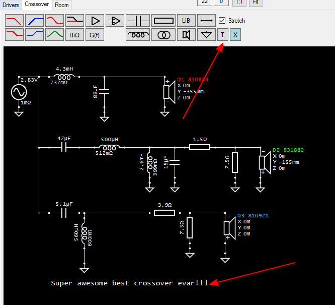

A wish for future update of Vituixcad; It would be really nice to be able to add a short description to crossover variants. I initially thought the overlay text box could be used for this, but quickly found out that this was not the case.
When I enter a text in the box as shown and switch to variation 2 and then back again to 1,
the text reverts to default.
Joined 2003
The box you are trying to modify is the overlay name suffix...it's for naming overlays, not the crossover variant.
You can put text right on the crossover schematic.
I feel a bit stupid now, I have never noticed that text function! You come to the rescue once again Dcibel, thank you 🙂The box you are trying to modify is the overlay name suffix...it's for naming overlays, not the crossover variant.

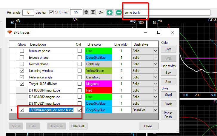

BUT, the text box still doesn't seem to save the text even when I add an overlay with the + button.. Maybe I have misunderstood this one as well 🤔
Not a problem as I don't need to save overlays for the moment, but interesting regardless.
Joined 2003
Overlay name suffix does what it says on the tin, it sets the suffix to be applied to newly created overlays. So I enter in some bunk, then create an overlay, and it's name has some bunk at the end. These names are useful when exporting images with legends.

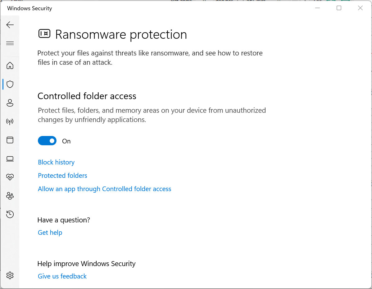

I faced the following error message when installing VituixCAD on a Windows 11 machine:
"An error occurred while trying to create a file in the destination directory: The system cannot find the file specified."
It turned out the problem appears due to "Controlled Folders" security setting in Windows 11. Should you face the error above, open Virus & Thread Protection > Virus & threat protection settings > Manage settings > Manage controlled folder access. Disable the Controlled folder access during installation of the VituixCAD.
I also have Win 11. That setting has probably been Off since the installation because everything has been really smooth. \Users\Public\Documents if free for all users so protection does not look sensible. Whole idea is lost if that folder is locked for single user only or sub-folder creation is prevented.Disable the Controlled folder access during installation of the VituixCAD
