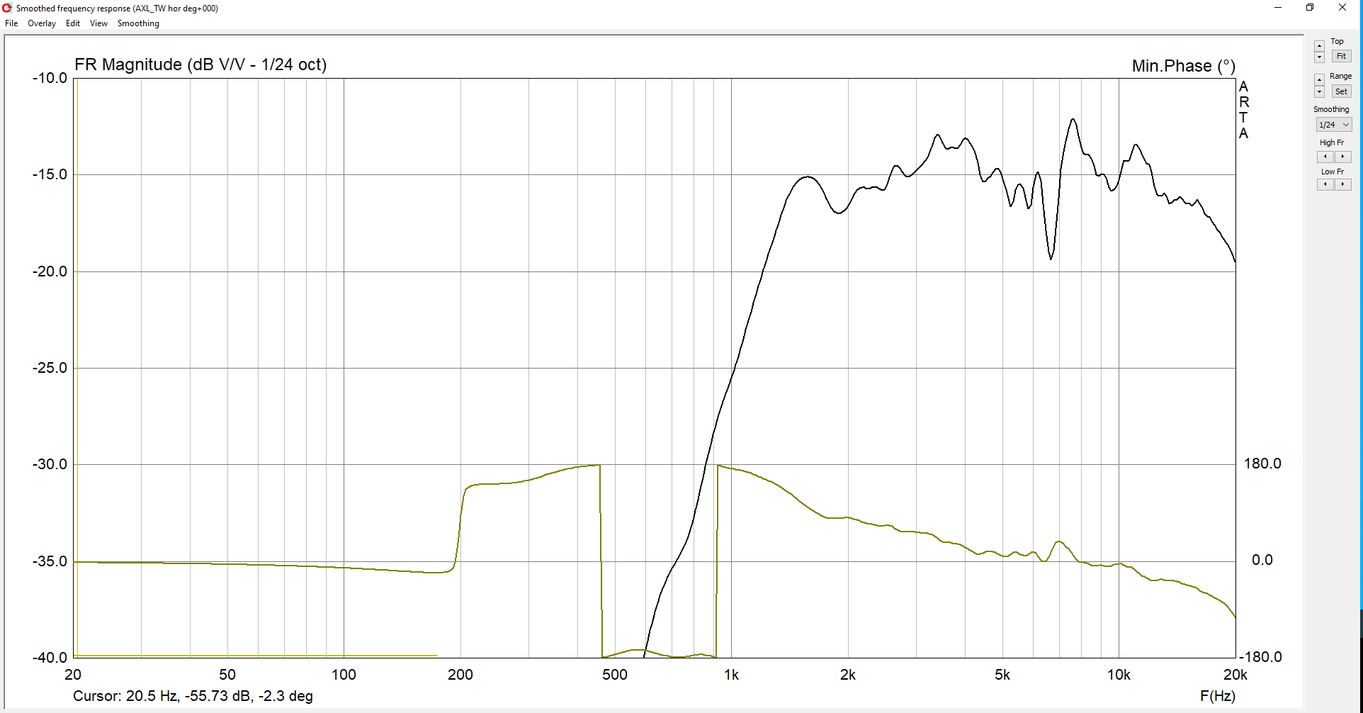

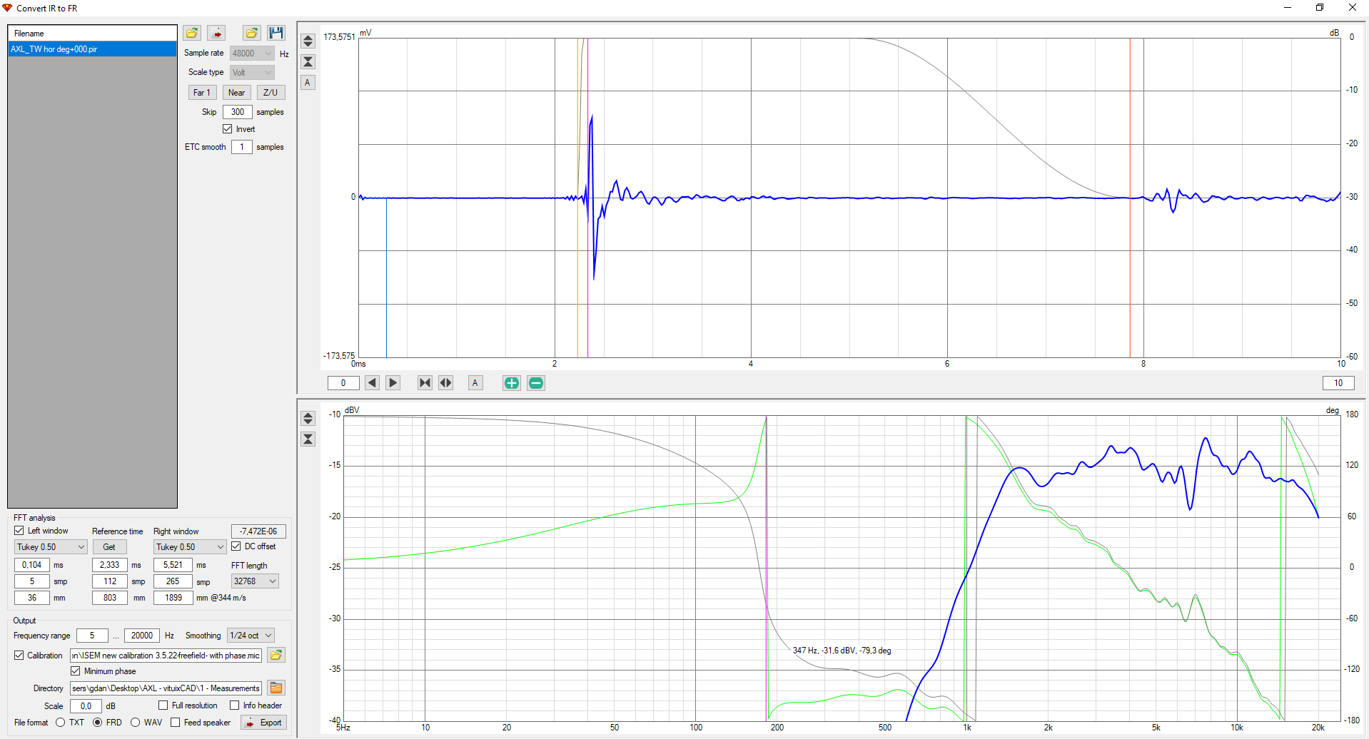

I made a comparison of the minimum pahase calculation between ARTA and vituixCAD.
The differences in minimum phase are very big as shown in the attached screenshots, although the magnitudes are the same.
Is there something I could do to make them similar?

Frequency response is not the same between the two images, at 1kHz response in VituixCAD is -23dB, ARTA -25.5dB. Make sure exact same window length and type is used between the two software for equal response result, for example ARTA doesn't have an option for left window. Other issue is that the software has to make assumption of response slope beyond measurement range for min phase calculation, so there can be differences there as well. You can use the min phase option in VituixCAD calculator tool to manually define the HF and LF slopes until phase matches ARTA perfectly.

The window length is the same in both cases.
The magnitude response is very close to both cases for f>1.5 kHz.
The question is about the minimum phase. Why is so different?
For example in ARTA the phase is around 0 deg between 5kHz and 10 kHz.
In vituixCAD is from -45 deg at 5kHz to -105 deg at 10 kHz.
Not much changes in Phase when you choose different windows length and type.
The high tail can be problematic. You can (if possible for your set up) sample at 96 KHz to see what the tweeter is actually doing beyond 20 KHz. Other people (myself included) just use 12 dB/octave as a safe compromise. Of course if you're using a dual channel measurement rig you don't need (or even want) to use minimum phase. The only time I use minimum phase is during preliminary investigations based on manufacturer's data. Even then you have to guess at the drivers' acoustic offset, add baffle step, etc.
Reactions: DcibeL
Not much, but you really don't have to make them similar because MP extraction is not valuable...mandatory in any phase while designing loudspeakers. As far as I remember ARTA is using DFT for MP calculation. VCAD calculates with Hilbert integral. The last one is very accurate - usually exact match if slope estimation of unknown LF and HF bands is correct.

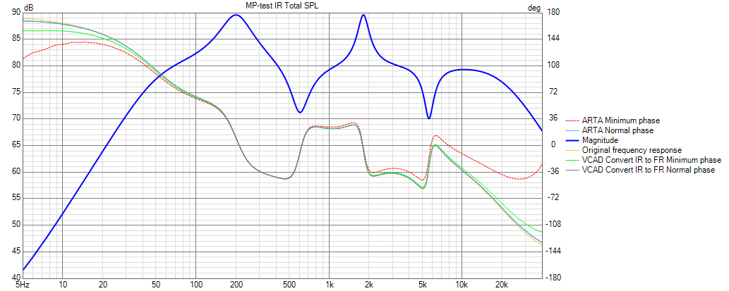

Here is one comparison of four phase responses converted from the same IR with the same parameters. Orange phase is original - before conversion from FR to IR.
Reactions: witwald and DcibeL
^Yes, certainly. Minimum phase calculation is based on guessing and assumptions and measured phase is less damaged than magnitude due to time window. Measurement instructions say nothing about MP for measurement data itself which should be quite clear statement about importance.
