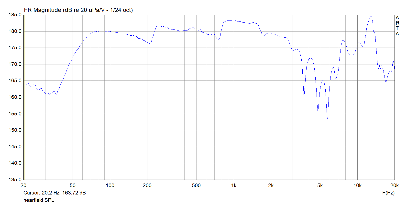

  • The nearfield SPL I'm getting has these steps -- where are they coming from? The published curve has no such steps.

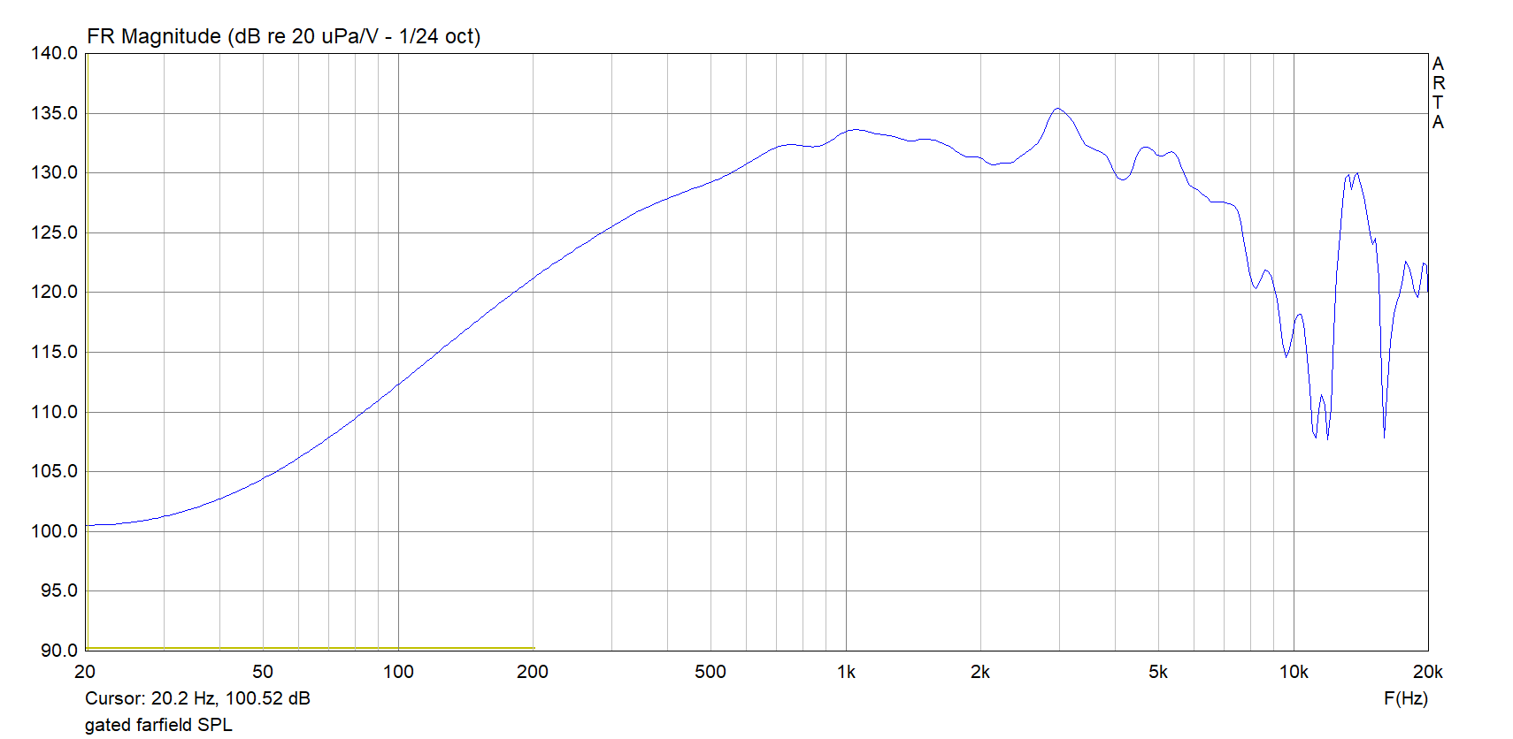

Basically, even after I enter the driver diameter in the Merger tool, I'm seeing a big level difference between the nearfield and gated farfield SPL levels. What am I doing wrong? Is there any chance you can try doing the merge with my data files and see if you get a more sane curve?
This is what I'm getting as gated farfield and as nearfield, from the two PIR files. See the steps in the nearfield file SPL, at 250 and 800Hz. What is causing this? They don't seem to be there in the published spec of the FF225WK.

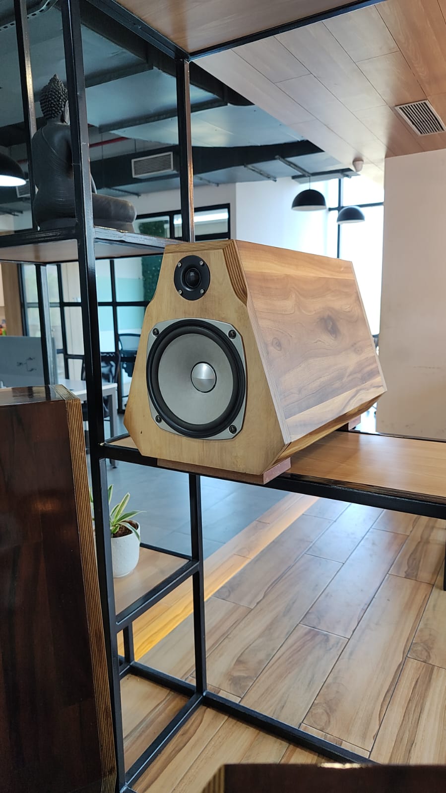

What is the cabinet? Did you put damping material in it? Response is typical for an empty box, you are measuring cabinet reflections.
Mic cal is required for final response. Near field is problematic due to cabinet interaction, so overlap is not really obvious.

  • You've asked about the cabinet. Photo attached. 😀 The inside is lined fully with 2" deep acoustic foam, used for treating recording studio walls, etc.

Will take fresh measurements and try again. Let's see how it goes. But the bumps in the nearfield SPL are getting me quite foxed, quite apart from the rest of the problems.

If it hasn’t been made clear enough, add damping material to the cabinet, you will see the change immediately in nearfield measurement. Just a guess that your cabinet depth internally is about 16”?

You can expect the amplitude adjustment required between near and far field measurement to be signficant. I would not focus too much on it, just adjust amplitude scaling accordingly during merge process. With adequate measurement overlap it is easy.
Yes. In fact, I never bother with trying to make an area (Sd) adjustment to match NF to FF measurements. At a test voltage of 1 V I generally expect the FF measurements to be in the range of 80 dB, and the NF to be anywhere from 95 to 110 dB. During the Merger process I just scale the NF down to match the FF at the merge frequency.
