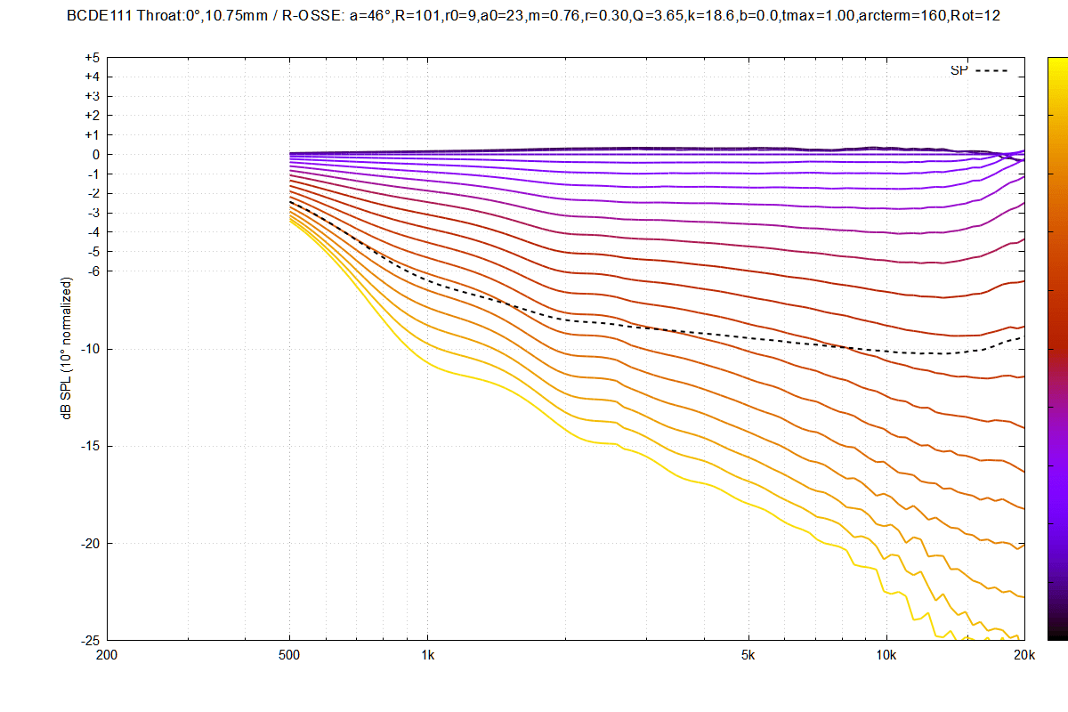

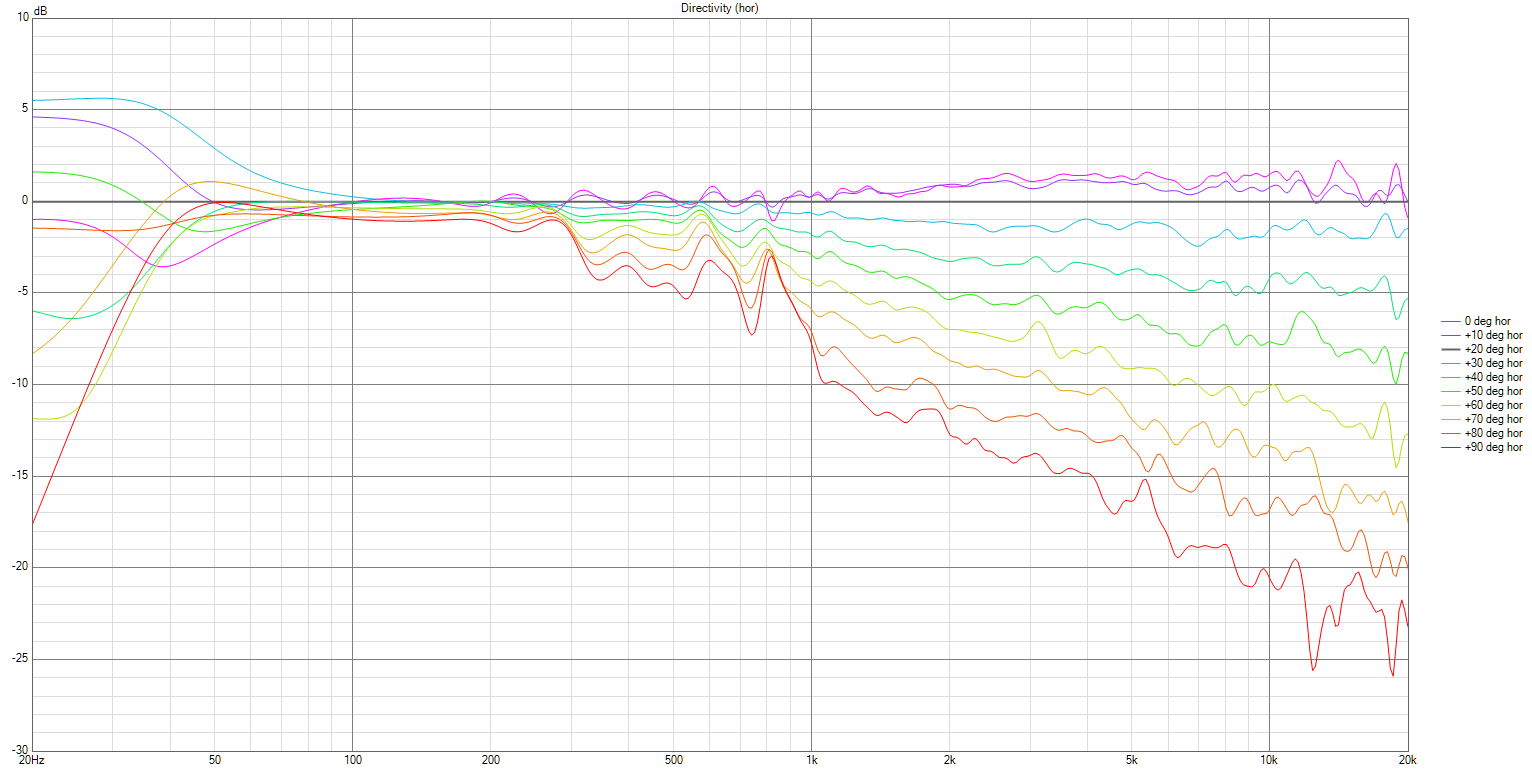

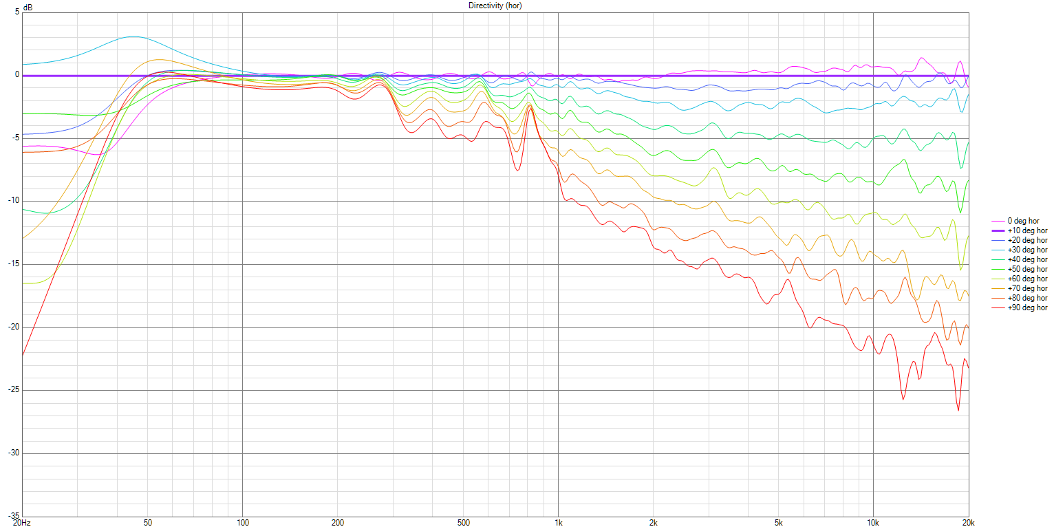

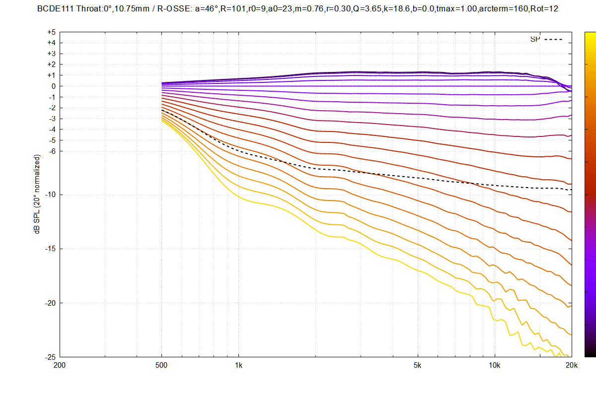

I'm learning VituixCAD while learning how to do crossovers. I posted a thread for the crossover in the Multiway forum and included the process I followed to generate a transfer file function equalization file.
It's on a speaker that includes an ATH waveguide. In the simulations, if I normalize to 10 degrees my 20/25 degree angles are consistent with 10 between 2kHz and 10kHz. Intent is home theater with side by side seating, toed in so listeners are at 10 and 20 degrees off-axis.
Is there a way to generate a transfer file equalized at 10 degrees rather than on-axis? Or should I EQ on-axis flat for the sake of the crossover and then EQ 10 degrees flat after the crossover is implemented.
Wait, maybe I can just rename the measurement files. Decrement every angle by ten in the file name so that my 10 degree measurement is listed as 0 degrees. So now the question is whether or not I should do it or if it would ruin the crossover.

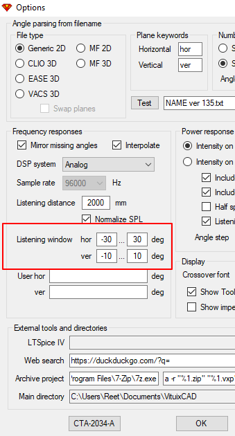

Joined 2003

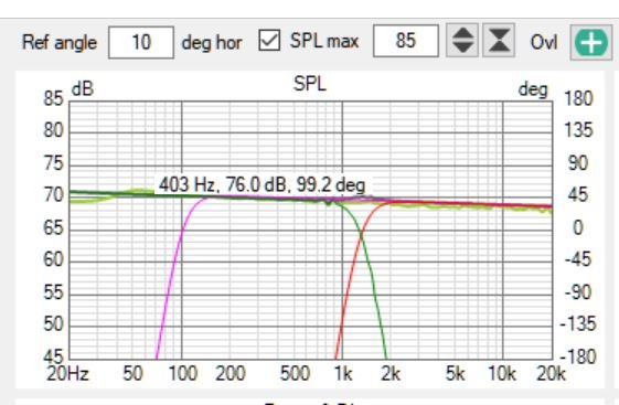

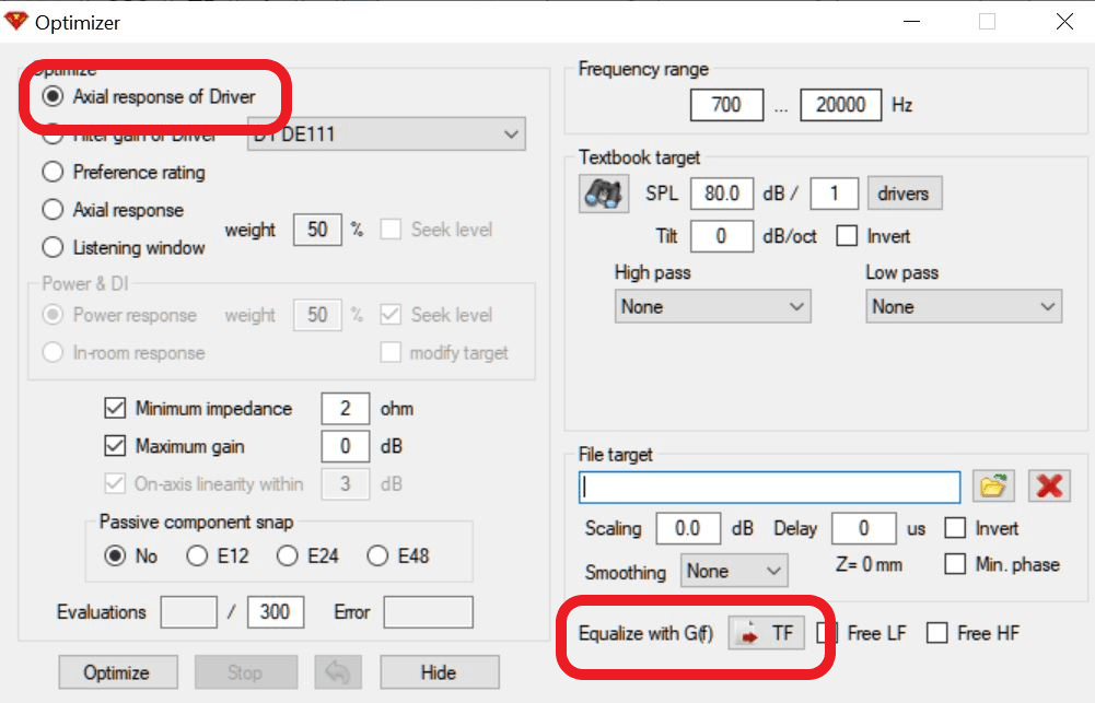

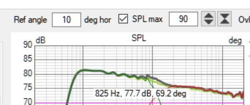

Thanks for explaining how and why you optimize for Listening Window. I think the Help file explains how to Optimize for a specific angle (if I read the Help file correctly).
"Axial response of selected driver can be adjusted automatically to the target in SPL graph by selecting 'Axial response of Driver'. Select driver from list box on the right and then 'Axial response of Driver'. Create target curve, specify frequency range and select filter parameters/component values to be optimized from Parameters grid in Crossover tab. Driver's target magnitude is visible in SPL graph and target phase in GD & Phase graph. Start solver with Optimize button."
I understood this to mean you choose the reference angle located above the SPL graph. Then the Optimizer will optimize for that angle when the Axial response of Driver is selected.

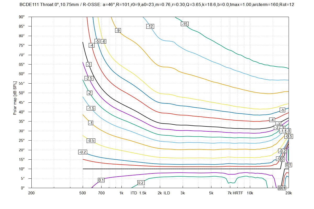

VituixCAD and my ATH horn simulation look like they match now.
10 Degrees
20 Degrees
10 Degrees
20 Degrees
