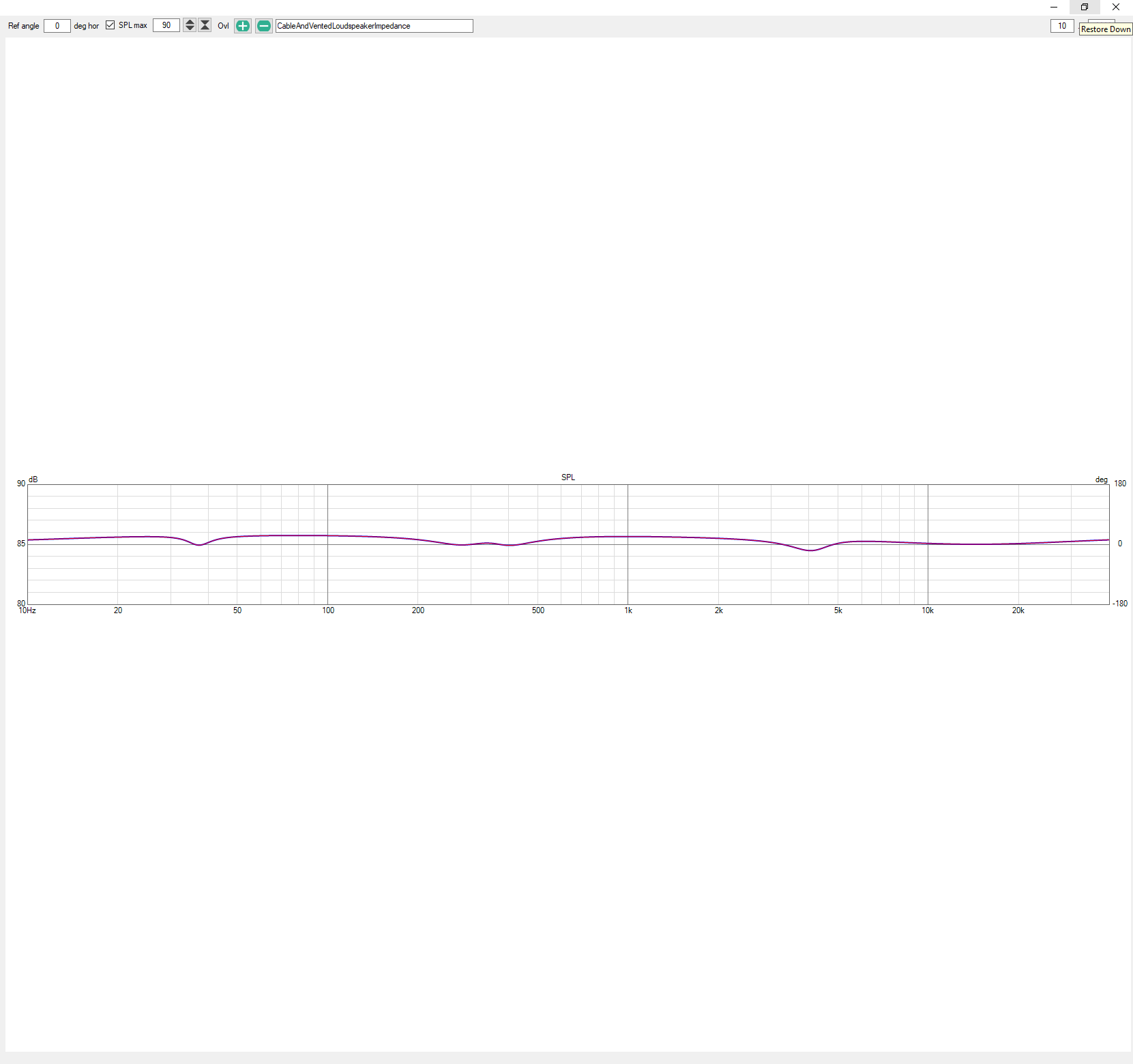

Is there any way in VituixCAD that I can adjust the vertical scale to cover a smaller range, such as one from 84dB to 86dB?
Calculator tool has much larger span range so you can export SPL or filter response and load it to Calculator to visualize insignificant variations. Main program can show ca. 0.01 dB/px resolution as zoomed in so you really don't need narrower than 10 dB span.
Reactions: 1 users
Thank you for the tip; it worked very well. :)
Although the variations were small, they were of a significant enough magnitude to warrant closer scrutiny. In any case, while performing a parameter sensitivity analysis using VituixCAD's circuit modeling capabilities, increasing the source impedance by a factor of four made the frequency response variations much more significant.
I'm not sure what you are referring to above. The following is what I see when I zoom in on just the frequency response plot. Is that to be expected? The plotted graph certainly doesn't fit the available window size.

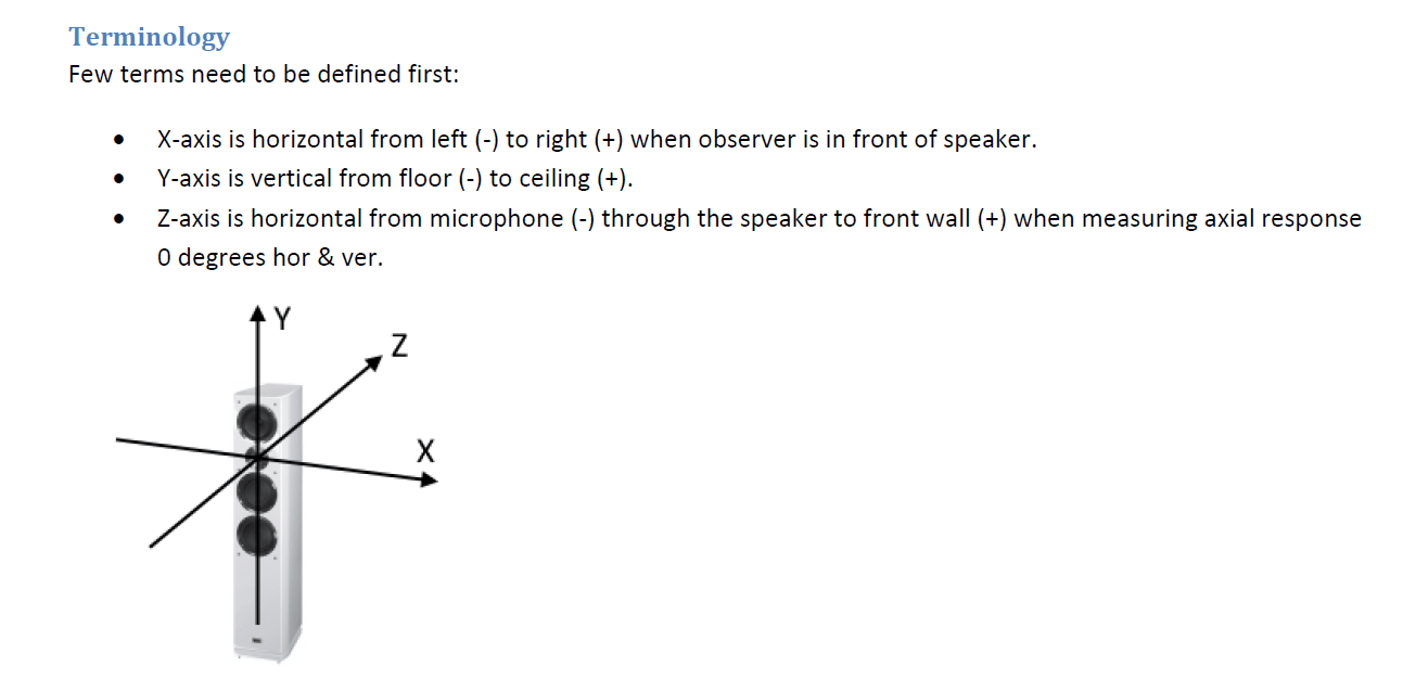

Let's start by assuming that I am not using actual measured driver responses... for instance, maybe I traced the responses, or perhaps I am using idealized piston simulation. If a driver is behind the baffle (further away), account for this with the z dimension. positive is further away.
If I am using actual measured responses, and I have taken the measurements in accordance with the VituixCad procedure, the true path length to each driver is already accounted for in the measurement, so there is no need to adjust the Z dimension.
If I am simulating an active system and each driver has its own amp and DSP channel, I can apply a time delay to one or more drivers. When simulating a system such as this, I need to apply a time delay as part of the VituixCad simulation so that reality and simulation are in agreement.

Thanks Jim. I'm fully aware of the measured vs. derived phase implications.
The VituixCAD manual says "positive or negative" - but doesn't say whether positive is away from or toward the mic (independent of which driver we are talking about, flat baffle, derived or measured phase etc...). In Speakerworkshop - negative Z is away from the mic
Adjusting Z is required as soon as we move away from measured phase. Such is the case when we are making our own quasi-anechoic responses for a full range simulation (or 3 / 4+ way where it is a must when splicing measurements). This is even more important with USB mics where an exact impulse cannot be determined due to USB timing volatility (and an XLR / dual channel setup is preferred).
So am I correct in assuming positive Z is away from mic?
yes, positive z is further from the mic.
I was a little confused because you asked about driver delay, which to me means time delay. The software allows us to simulate a time delay and/or a geometric z distance independent of each other.
So I was not sure I understood your question... sorry for stating the obvious regarding phase
Reactions: 1 user

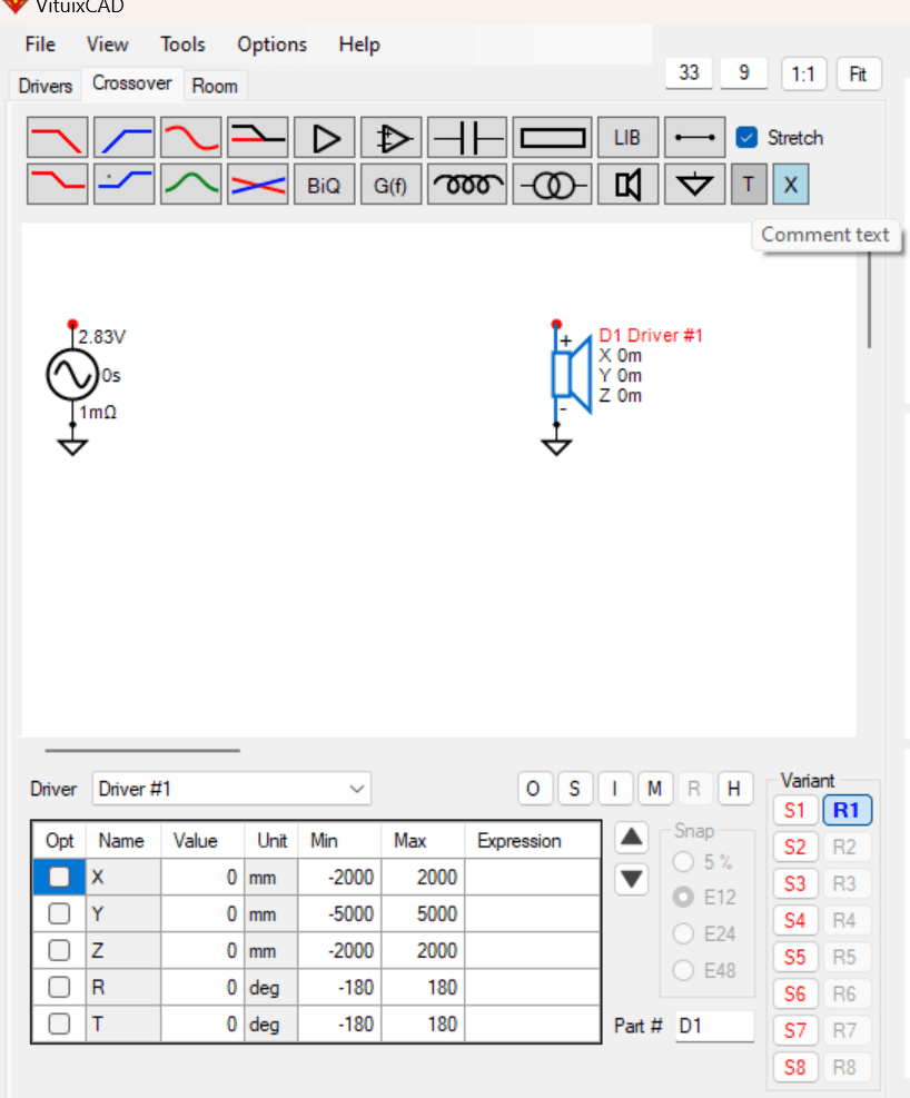

Yes, there is a difference. Delay in driver tab is meant for fixing incorrect phase in the frequency response files, it simply adds or subtracts delay to the phase of the driver response, nothing more. Best option to use for people with USB mics, entering value determined from Aux -> Time align.
Z dimension in crossover accounts for physical position of driver, so SPL vs distance to mic is considered, as well as angular interpolation if X and Y dimensions are entered.
In either case, Z axis polarity is as the picture Jim posted above.
Reactions: 1 user

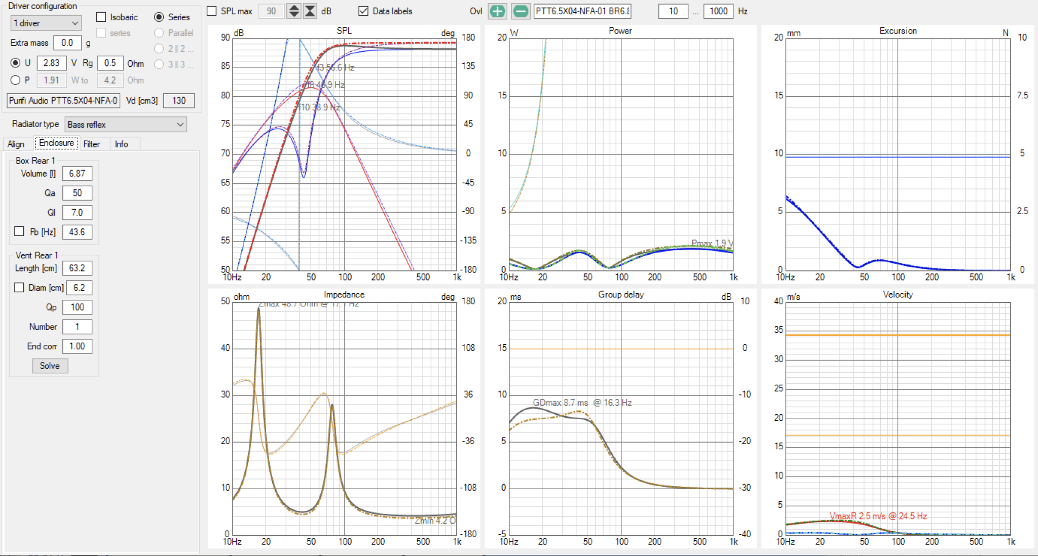

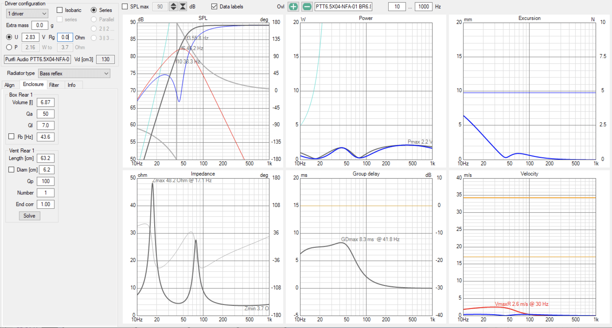

With gratitude for this set of tools and what I've learned so far from using them, I have a question on the effect of Rg on application of standard alignments.
Here's an example with Rg = 0 (direct connection to low output impedance amp, short cable). This is QB3 alignment for the selected driver.
In reality, I'm anticipating a passive crossover with some pretty big inductors, so I allow 0.5 ohms and set Rg accordingly. I have auto-align checked and have verified that the traces are re-drawn.
With Rg > 0, volume and port tuning don't change, and accordingly there's a bit of a peak in the response just above the rolloff point. Some other tools (Unibox, Jeff Bagby's woofer box designer) compute modified driver parameters and then apply the Theile alignments.
I'm sure there's a reason for this choice in Vituix CAD. I'm interested in the recommended workflow when anticipating a passive crossover.
Thanks!

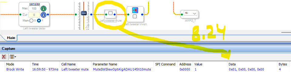

I am wondering whether there is a best or recommended way of transferring IIR filters to SigmaStudio?
So far, I have found that I can
  1. Select General as the DSP type and set the sample rate
  2. Create a General 2nd order filter in SigmaStudio with the required number of biquads
  3. In VCAD, in Copy Biquad Coefficients, select only value as decimal
  4. In SigmaStudio, right-click on the filter and choose Copy biquad coefficients
But the VCAD changelog, at 2.0.85.1:
Code:
Main, Copy biquad coefficients
* Byte order of buffer:unmute as 8.24 hex reversed to be compatible with SigmaStudio.
implies that there's something I'm missing.
Thanks for any tips!

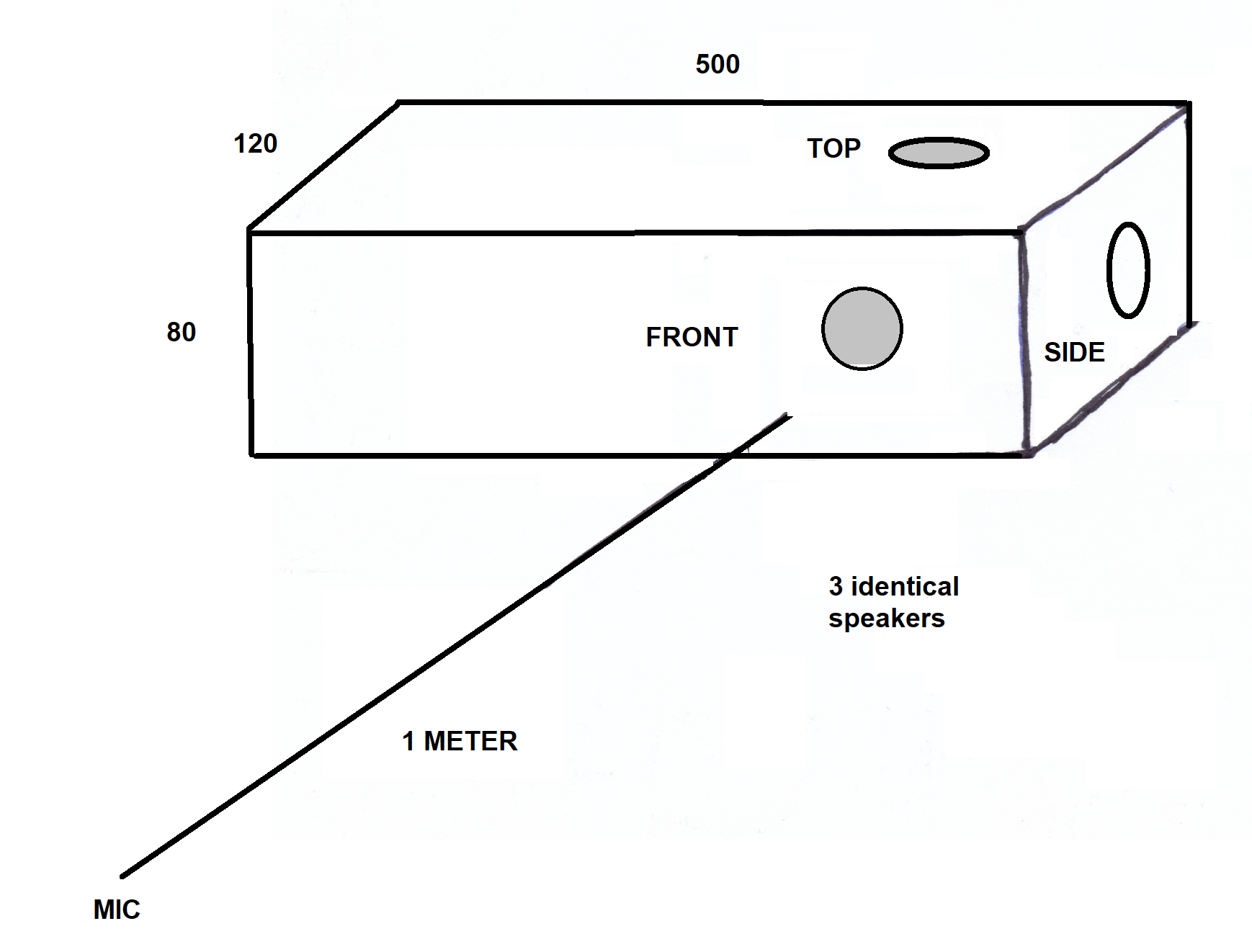

I want to simulate in vituixCAD the loudspeaker shown in the picture.
I have measured the Far field polar response of all the 3 drivers playing simultaneously at 1 meter .
I have also measured the near field response of each driver.
My question is how to make the Merging of Far field and Near field responses.
Should I use all three Near field responses with the BS active only for the Front driver?
For the diffraction should I use only the diffraction that is calculated for the front side?
Any other suggestion?
