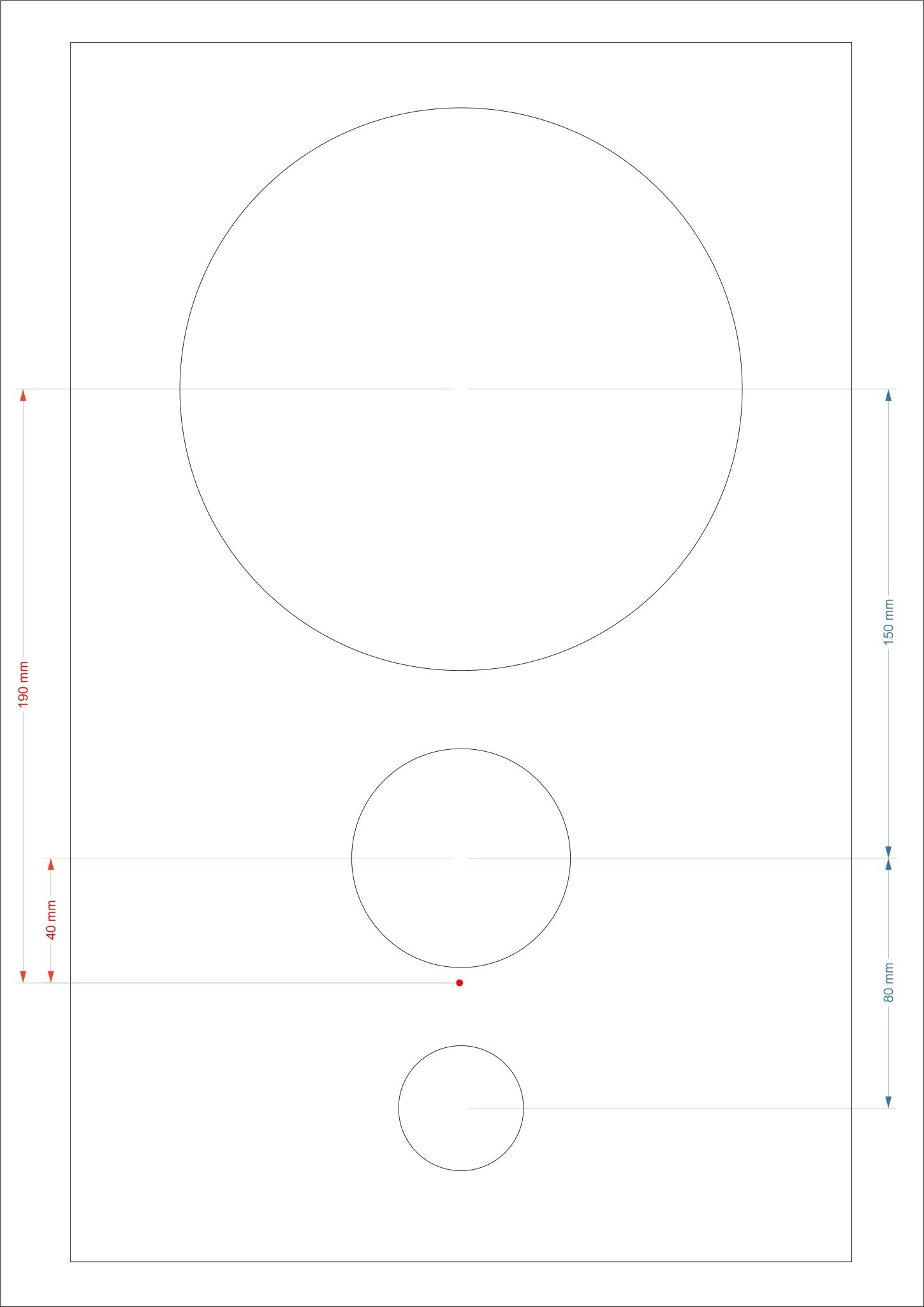

I have the position of the speakers on the front panel as shown in the picture. when measuring the tweeter and midrange I pointed the microphone at the center between the tweeter and midrange (red dot). the woofer I measured on its own axis. common sense tells me that I should set the woofer offset on the Y axis at 190mm, and zero offset for the tweeter and midrange.
Is this correct?
This depends on what/how you measured. Measurement instructions says that you should measure (with time-locked dual channel method) at least whole horizontal plane 0-180 deg of all drivers. In that case you MUST specify individual Y for all drivers that program could simulate lobing/directivity in vertical plane.I have the position of the speakers on the front panel as shown in the picture. when measuring the tweeter and midrange I pointed the microphone at the center between the tweeter and midrange (red dot). the woofer I measured on its own axis. common sense tells me that I should set the woofer offset on the Y axis at 190mm, and zero offset for the tweeter and midrange.
Is this correct?
But if you measured both horizontal plane 0-180 deg and vertical plane 0-359 deg with common mic origin of M and T, you can specify Y=0 mm for both because measured phase responses include timing difference between the drivers (to all measured angles in vertical plane).
Measuring on-axis only (without off-axis) is not recommended because directivity/power/in-room features cannot be simulated, verified and controlled with crossover simulator. In that case both M and T could have Y=0 mm.
Read measurement and design instructions and follow them.

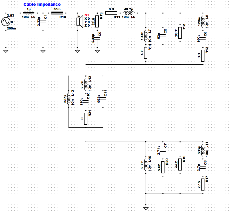

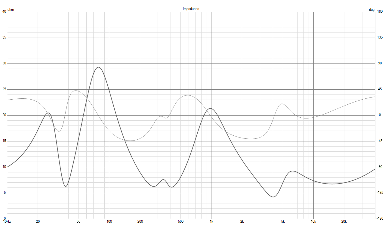

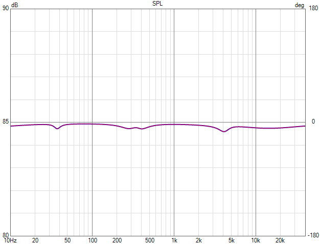

I am trying to model the effects of both amplifier source resistance and cable impedance on SPL response using a simulated two-way loudspeaker system impedance characteristic. The circuit I am using is shown below.
The results produced by the circuit are shown below, using a scale that ranges from 80dB to 90dB, with the nominal reference level being 85dB. This seems to be the minimum range that I can set.
Is there any way in VituixCAD that I can adjust the vertical scale to cover a smaller range, such as one from 84dB to 86dB?
Being able to do that would allow me to see the SPL variation much more clearly. Presently, the SPL variation is being plotted in a quite compressed manner, which is less than ideal.
The "driver" is being used like a voltmeter, as the driver's Z value has been set to 10000 ohms. That way it will not affect the operation of the circuit. It's not expected to work the way a normal speaker does. In this application, I am interested in the change in voltage at the loudspeaker terminals based on whatever source impedance is set in the voltage source when driving the simulated loudspeaker impedance load, which looks like:
