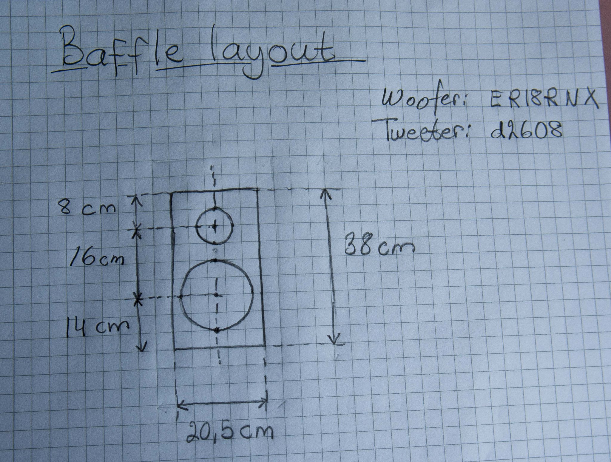

Anyway..... I'm building a two-way speaker and I'm trying to simulate the speaker's behavior with Vituixcad. The problem is that I'm not sure how to specify the placement of the individual speaker elements on the baffle.
All frequency measurements are made 1m in front of the baffle, at the height of the center points of the speaker elements. On my baffle (20.5 cm x 38 cm) both elements are centrally located. The center point of the woofer (SEAS ER18RNX) is 16 cm below the center point of the tweeter (Scan Speak d2608) (image attached below).
I assume that the acoustic center of the tweeter is in the same plane as the baffle, and that the acoustic center of the woofer is 22mm behind the baffle. In the 'Driver Layout' window I have set (x,y,z)= (0,0,0) for the tweeter and (0,160,22) for the woffer. Is this correct?

Hi Oidua,
If you followed the measurement guide for VituixCAD, you will have measured your drivers using dual channel, or at least semi-dual measurement. This means that the acoustic delay between drivers is inherently captured in your measurement data, provided the distance from mic to baffle remains constant and the window start reference time remains constant when processing the measurements. For this reason, there is no need to make any assumptions of acoustic centre, and the driver coordinates entered into the crossover should be physical offsets only.
You will find in the options a setting for listening distance. This is the distance used for simulation, recommended to keep at 2m+. Coordinates are entered relative to 0,0,0, so 2m listening distance places the simulation at (0,0,-2000). Most people will use the tweeter as the listening height, so the tweeter is entered as 0,0,0 and other drivers coordinates are entered relative to the tweeter. However, some may want to use the midrange as listening height or some point inbetween midrange and tweeter, the choice is at your discretion. You’ll find with your small bookshelf that at 2m distance it won’t change the result much if you use tweeter axis or woofer axis as the listening axis since the relative difference in driver distance and angle will be small.
In your case, using the tweeter as the design axis, the tweeter is (0,0,0) and the woofer is (0,-160,0).

Thanks a lot DcibeL, that's exactly what I needed to know.
I thought it was a bit strange that the coordinates of the woofer would be (0, 160, 0), but in the 'Driver layout' window, it seems that this places the woofer below the tweeter? I might have to take a look at that again.

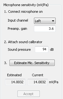

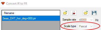

Hi there! Can someone maybe help understand what I am doing wrong when I get a consistent difference in SPL of 9 dB between Arta and Vituixcad when using the IR Converter tool?
I'm using Arta for the Impulse Response measurements in Dual Channel mode. My mic. is calibrated (both frequency response as SPL) and in Arta I measure at 96 KHz SR with 256k sequence length and at -12 dB (which corresponds to 2,00V in my case). Sound pressure units in Arta are set at 20 uPa/2,83V.
Please note that I tried measuring at -9dB as well (so exactly 2,83V) but that does not solve anything.
Off course I can scale the levels in Vituixcad in the drivers menu (or when converting from IR) by 9 dB but I would like to understand what's going on. Besides that I am not a big fan of manual corrections in a workflow as it tends to lead to (human) error.
The use of pascal or volts for the PIR output in ARTA is dependent on the selection of "microphone used" in the ARTA audio devices setup. I just did a quick test with ARTA and VituixCAD, with "mic enabled" and sound pressure units is ARTA set to "dB re 20 uPa/V", the SPL result is the same. The error appears to be in your selection of SPL referencing 20uPA/2.83V in ARTA. A scaling difference of 2.83V/V = 9.0357 dB.
Reactions: JanRSmit
^^What 2.83 V? Section "1.5 Calibration and Frequency Response Compensation" does not contain anything about "2.83". PIR files know nothing about voltage sensitivity i.e. voltage in driver terminals during measurement.
PIR files contain samples of impulse response as voltage values, and common scaling factor called "devicesens". Scaling factor is V/V for voltage measurements, and V/Pa for SPL measurements with microphone which require checking of "Microphone used on" before measurement.
See section "4.6.1 PIR file format" in user manual:
float devicesens; // V/V (for voltage measurement), V/Pa ( for mic input)
VituixCAD divides each sample value by devicesens value, and final dBSPL value is 20log10(p/20uPa) i.e. pressure in dB compared to 0 dBSPL. So you should set up ARTA so that VituixCAD gives the same pressure with SPL calibrator - if that is really important.
Yes. But I'm using 2.83V because this option gives me accurate SPL results on chart. Maybe I have entered incorrect value of "Preamp. gain" during microphone calibration, but I had to enter this value to mach catalogue mic sensitivity value 14 mV given by microphone producer. I've found it by asking and maybe it was wrong? I'll check other "Preamp. gain" values if it gives me proper SPL values with "db re 20 uPa/V" chart units in ARTA.

Thanks for your fast reply Mr. Saunisto. I hate to be the one to ask the dumb questions but can you tell me which binary code is being used in Arta PIR files? When I decode the files using obvious binary formats then all I get is rubish. I would just like to understand what is in the files and try and find out why we have a consistent 9 dB difference, if we are doing something wrong then we can correct it. The mic is Class 1 calibrated so it must be something else. Besides that Arta is showing correct SPL @ 2,83V.
Catalogue mic sensitivity is irrelevant. Preamp. gain is not included in PIR file so it must be 1. Gain of soundcard input should be included in mic sensitivity in order to deliver correct sensitivity value to PIR file. This happens automatically when sensitivity is measured with microphone calibrator and 'Estimate Mic. Sensitivity' button, and accepted with Accept button.
