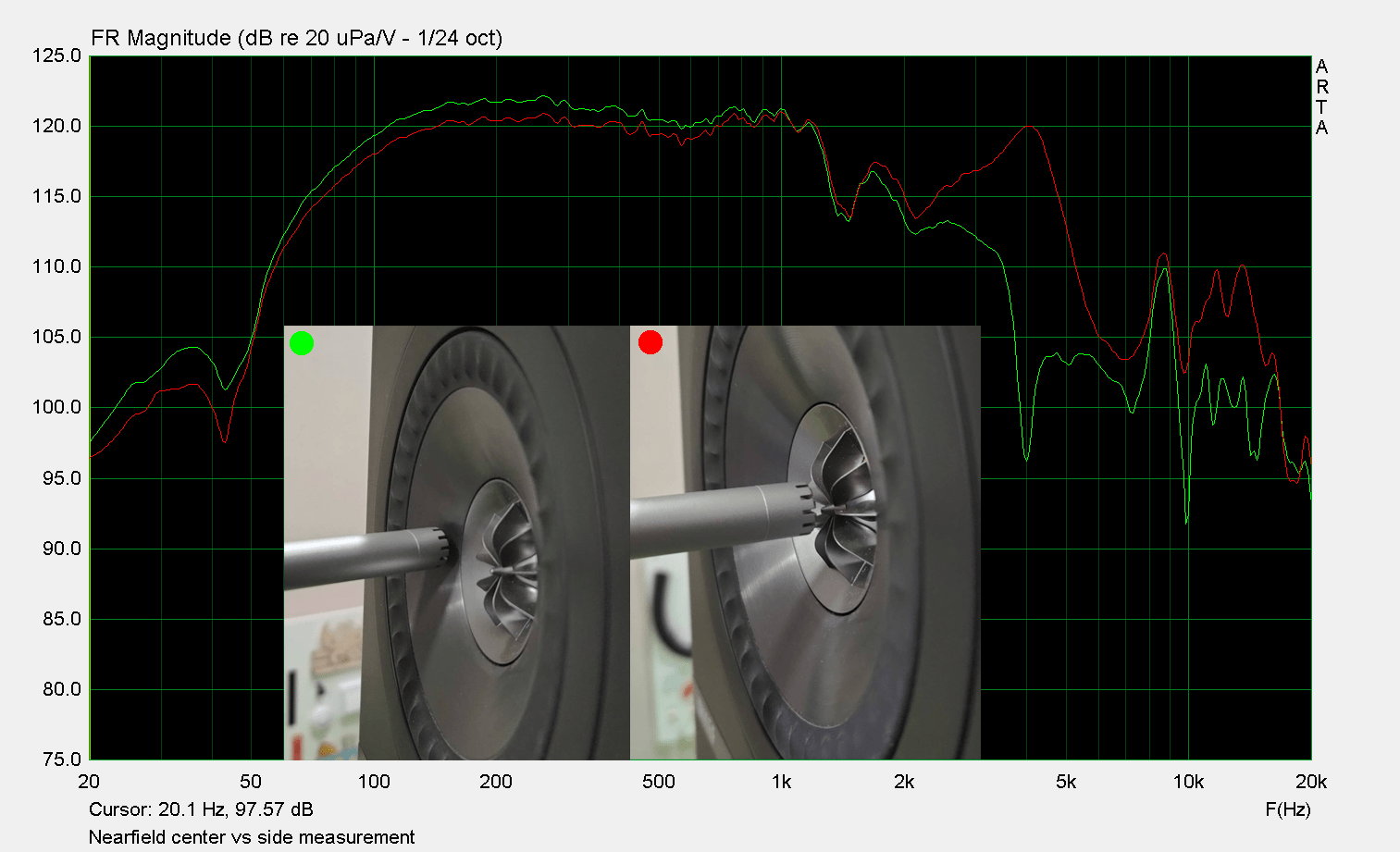

I have a question to forum users. Have you ever made nearfield measurement in coaxial speaker? Where should I put mic? In center of speaker, 5mm apart from tweeter? Or maybe on one of the sides, in the middle of the midwoofer membrane, 5mm apart?
I have two drivers from KEF Q100 speakers an will try to use in my DIY construction.
^As center as possible if tweeter is small, but for example PA coaxials have small horn so mic can be located close to inner edge of mid cone.
It all depends what one is looking for?
Nearfield measurements are mostly just done to get a sense of either the "resonances" in the cabinet (standing waves etc), or to get a good sense of the lower frequency part of the speaker. Often those internal cabinet issues are big enough to not see the "obstruction" of the horn assembly.
Sometimes it can give an idea of some cone resonances as well.
So my answer would be, do both. I would just never give one and only answer to such question.
But as can be seen @mecedo measurements, the difference isn't to big, expect for 2kHz an upward.
Which was to be expected anyway.
So in other words, what are you are trying to measure and see with nearfield measurements @mecedo ?
That is a much more important question, than just flying by general rules of thumb and ideas and just following those without really understanding why.
