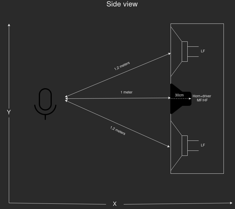

I'm a bit new with VituixCAD and I could figure out two things. So, maybe somebody here could help me.
1) When I'm measuring a speaker from a 1m distance then at the height of a tweeter of 80 cm. Then, should I measure the low frequency driver from the same height and the distance to it will be a bit further (~1,2m) or should I lower the microphone and measure from the height where the height is also 1 meter?
2) How can I add the depth of a horn to the distance of the measurement (1m)?
Measurements are done with REW.
Attached is an illustrative drawing, side view.

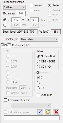

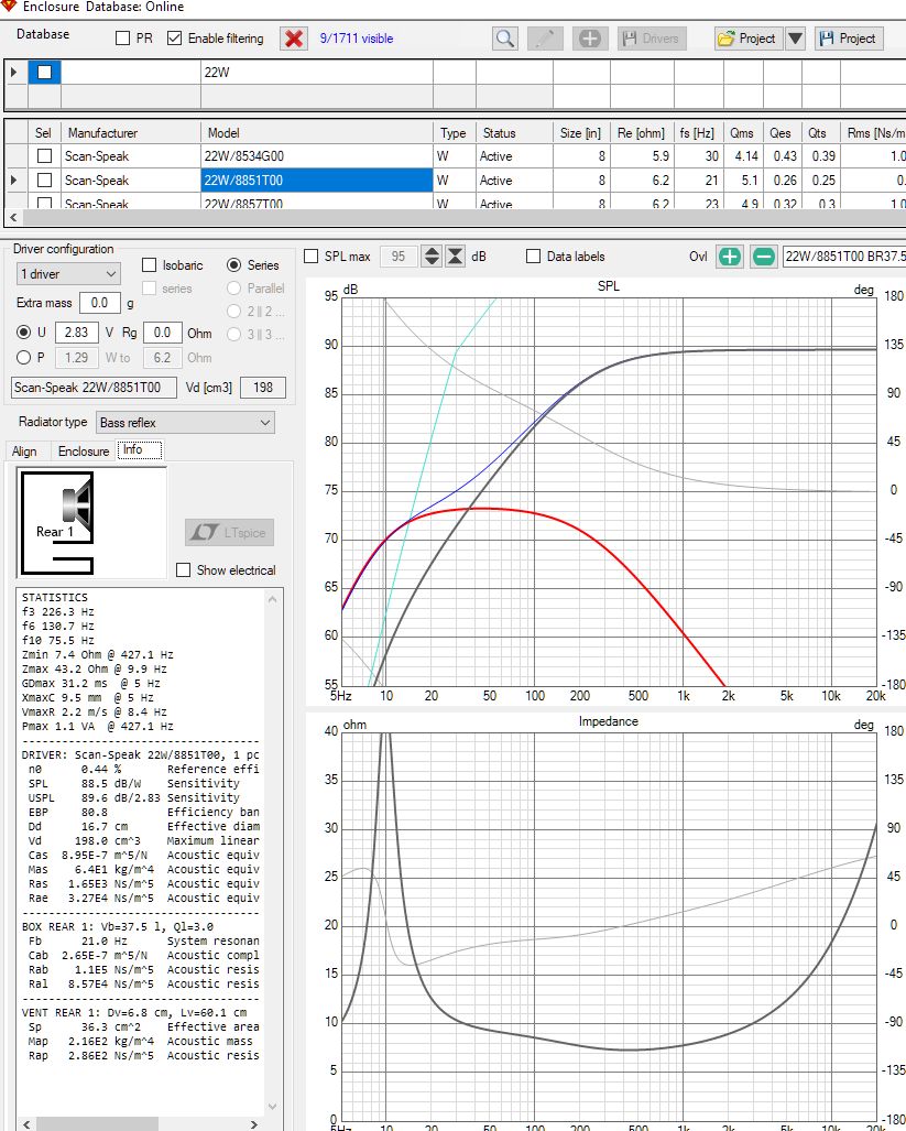

Has something broken/changed with the enclosure tool?
Running 2.0.88.8 -- looking at the 22W 8851T Revelator in bass reflex, the tool is showing F3 = 226hz?
This seems way off, and setting the same driver to a closed box gives F3 = 138hz?
Could someone check if the results are different using an earlier version?
Edit I had 2.0.85.7 on my desktop - it shows F3 = 40hz. I think there's a bug in the new version.
Joined 2003
I never adjusted it - or did I? not sure - this is the default it comes out with, but on 2.0.85.7 the Qa is set to 100 by default.Change Qa from 0.26 to a more reasonable number.
1) It is recommended to measure all drivers on their axis. Then VituixCAD is able to calculate the frequency response from any distance. If the geometrical positions of the drivers are also specified in VituixCAD, the vertical radiation pattern can also be simulated, provided that the drivers are rotationally symmetrical.Hi
It is also possible to measure all drivers from one height (e.g. from the height of the tweeter). In this case the predictions of VituixCAD are only valid for the measuring distance. The error for other distances will probably be smaller, the smaller the vertical dimension of the box is.
2) If you have measured with timing reference (two-channel), you should not do anything, because the information about the different positions of the sound sources on the Z-axis must remain in the measurement. To make corrections is not the task of the user who feeds the simulation program, but of the crossover of the speaker to be developed.2) How can I add the depth of a horn to the distance of the measurement (1m)?

Initial value is set when version 2.0 is installed first time ever, but after that it's on you. Program saves the last value in user settings. User and loading enclosure project can modify the field.I never adjusted it - or did I? not sure - this is the default it comes out with, but on 2.0.85.7 the Qa is set to 100 by default.
OK thanks, I was going nuts. Is there a way to reset such things?Initial value is set when version 2.0 is installed first time ever, but after that it's on you. Program saves the last value in user settings. User and loading enclosure project can modify the field.
By deleting user settings files of all VCAD 2 versions, but that it harsh method for a small and quite visible mistake. Few years ago I also considered setting Qa=100 when user clicks Align closed or Auto align is checked and driver changed, but that would prevent fast comparing drivers with the same Qa<100. Program line is still there as a comment. Some user(s) will complain if I activate that feature. I think it's best to look parameters more carefully.Is there a way to reset such things?
We can test with the next revision that all six Q-parameters are 100.0 when Enclosure opens. Values are still saved to user settings but they are not read to UI on start-up. This enables comparing different drivers, radiator types and alignments without automatic/forced change in Qa and Qp.
Table alignments play with Ql so that will change when alignment options are clicked. All Q-values are saved to and read from enclosure project files of course. Is this okay?
