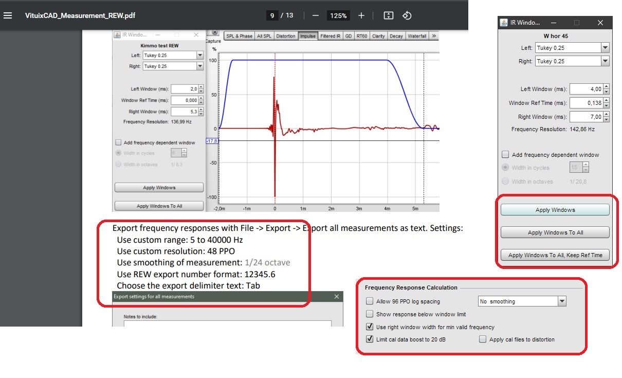

Follow the instructions in the measurement guide. Page 9 of the measurement guide for REW details windowing settings for export of data. Following this instruction you will achieve success. There are a few things to note, but will mostly be done automatically if you simply follow all the settings outlined in the document. The window reference time should be at or near the peak of the impulse, and must remain in the same location for all measurements, for all drivers.

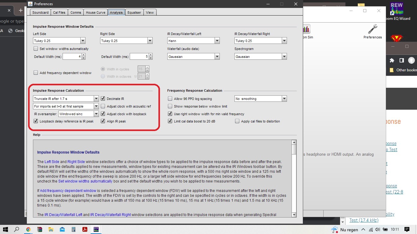

Now there is an option for IR windows to save and keep reference time.
In the manual export use custom resolution 48 PPO ; and 1/24 smoothing should be selected.
There is now an option for 96 PPO and select smoothing.

DO NOT move the reference time. If you set it at 3.25ms for the tweeter, you will set it at 3.25ms for the woofer, and the 0.1ms of delay will be captured in the frequency response file. You can think of a movement in window reference time in the same way as physically moving the mic with regards to phase.
There are only a few simple rules to follow to ensure accurate phase/delay is captured in your measurements:
  • mic distance to speaker baffle must stay the same for all measurements
  • window reference time must be the same for all measurements
If you are following the instructions, you will set the timing offset equal to the physical mic distance when taking the measurements. "timing offset" mentioned on page 4. By doing so, the window reference time can simply remain at zero when you process the files (page 9).

Instructions will have you use the "apply windows to all" button. This is crucial to force all measurements to use the same reference time. Smoothing settings are mostly inconsequential, like I said you can smooth the measurements on the fly in the driver tab of VituixCAD. Feel free to export using different settings and compare the results.

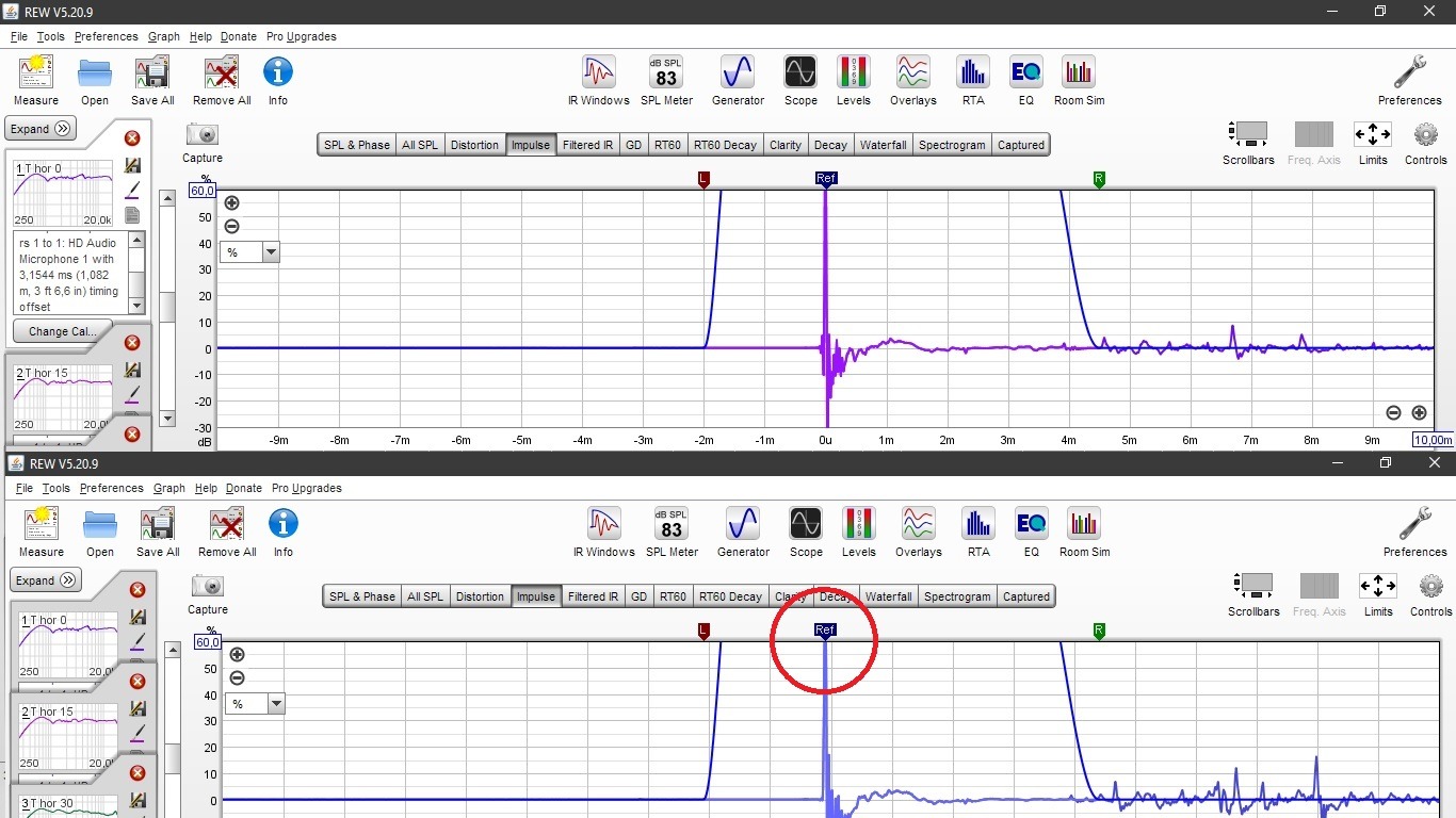

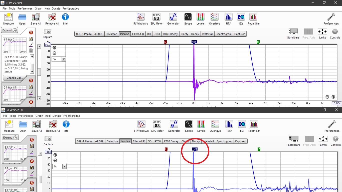

Just to absolutely sure I'm doing the right thing.
Below a picture of the impuls meting from my tweeter at 0 degrees (top) and 45 degrees (bottom).
As you notice the REF marker is at the peak of the impuls for both measurements.
After adjusting the IR window the REF marker is moved to position 0ms for the 45 degree measurement, same as it was originally for the 0 degrees measurement.
After this the files can be exported to VITUIXCad.

Starting to feel like a broken record 😉. Follow what it says on page 9 of the guide. Your windowing looks fine, just open the IR windowing settings, hit "apply windows to all", then export.

It looks like the impulse is occuring before T=0 position. If you are applying a timing offset to the measurement process, I would suggest the offset is a bit too long. It's not a big problem, but you may find the phase response to look a bit odd, since it will be showing a negative phase rotation.
