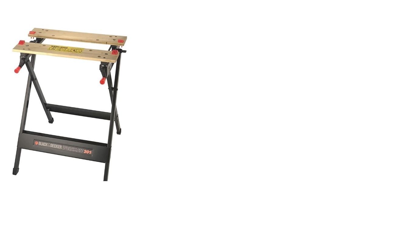

My speaker (40cmx100 and 15cm deep) stands on a workbench. Clamped so it doesn't fall off being so narrow and tall. (it's the only thing I have on hand of sufficient height)
I need to turn the workbench for the different angles. Turning it and keeping the rotating centre even isn't that easy.
This question the outcome of my measurements and hence the double and triple checking.
So now it's time to make a proper turntable.

A few cases of stacked empties is all you need for that speaker 😉. Or some scrap wood or construction lumber can make a simple stand. With the work bench, attach a stick to it that runs down to the floor so you can point it at the polar map that you taped there and keep the point of rotation in check for each measurement.I understand I'm a pain in the a.... . Doing things for the first time isn't all that easy. It takes some experience to find a proper work method.

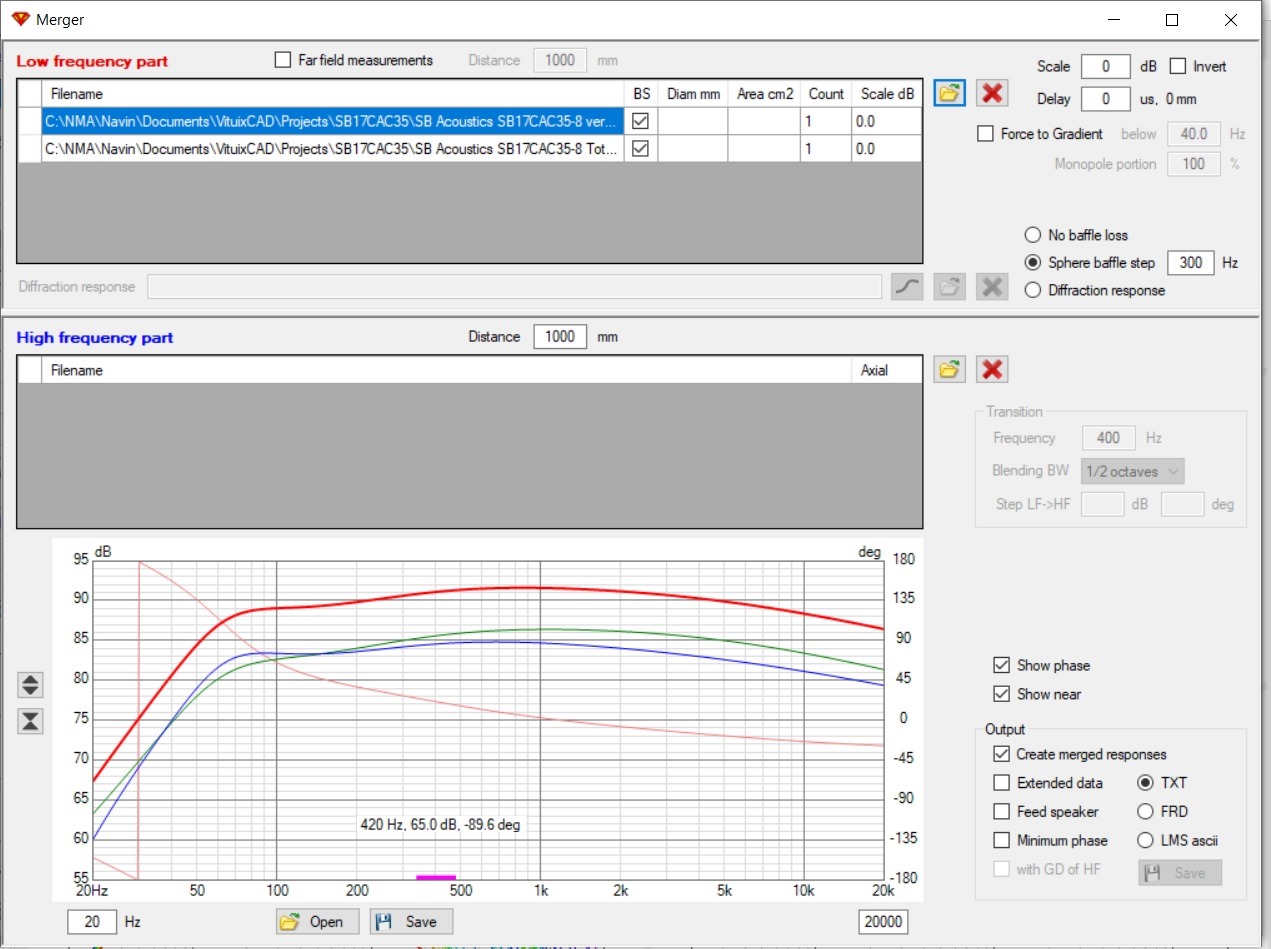

I am using VituixCAD's enclosure tool.
When I choose a driver from the database (in my case, SB Acoustics's SB17CAC35-8 see link), I get a set of parameters that match the published specifications on SB Acoustic's website. So far, all is good. https://sbacoustics.com/product/6in-sb17cac35-8/#tab-specs
When I use Step 2 of the attached instructions in post #3844 (see link) "Simulation Without Measurements" and try and Calculate the T/S using the traced Impedance Curve, I get slightly different driver specifications than those published by SB Acoustics or in the original database. https://www.diyaudio.com/community/threads/vituixcad.307910/page-193
For example, Published Fs is 28Hz, and Traced Fs is 30Hz. Qms 4.46 vs 4.01, Cms 2.13 vs 1.82, Vas 42L vs 36L, etc. Hence there is some difference in the enclosure response. Which set of parameters should I use? Thanks.
I used the merger tool to compare the SPL response. The blue curve uses the traced data, and the green curve uses the published data. I know the differences are minor, but I just wanted to know if this was normal.
Joined 2003
You should use the real measured parameters for your drivers once you have them in hand. You will read a clear disclaimer on page 1 of my document that its intent is to aid in learning of the tools available in VituixCAD, it’s not proposed to design any real speaker using traced data. The intent of the extra steps in extracting T/S from the traced impedance is to obtain a more accurate inductance model than the single Le value provided in most manufacturer specs. It also allows you to familiarize yourself with the software for calculating T/S before you build a jig and make a real measurement.

Can you direct me to "my document"?You should use the real measured parameters for your drivers once you have them in hand. You will read a clear disclaimer on page 1 of my document that its intent is to aid in learning of the tools available in VituixCAD, it’s not proposed to design any real speaker using traced data. The intent of the extra steps in extracting T/S from the traced impedance is to obtain a more accurate inductance model than the single Le value provided in most manufacturer specs. It also allows you to familiarize yourself with the software for calculating T/S before you build a jig and make a real measurement.
