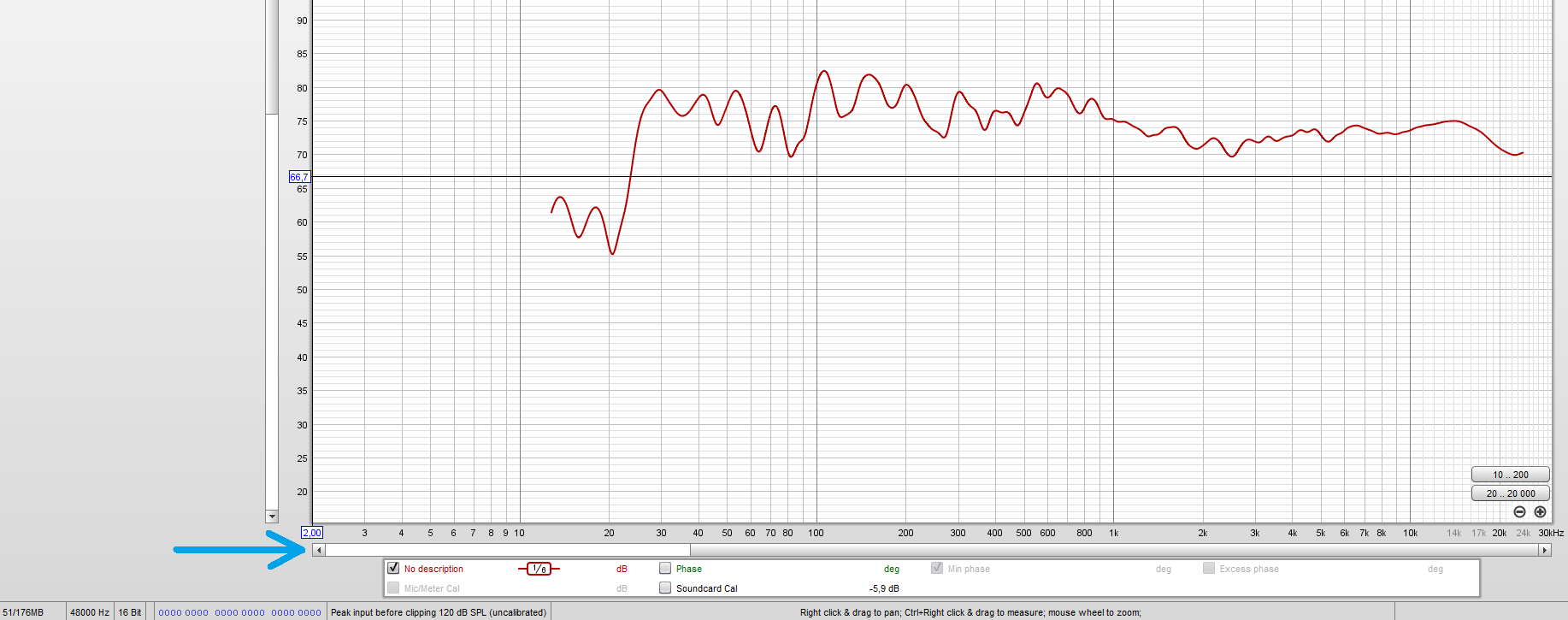

The Y-axis in the SPL window is scaled and shifted with the mouse. But I was talking about the X axis. The frequency axis. On the possibility of scaling the frequency axis.

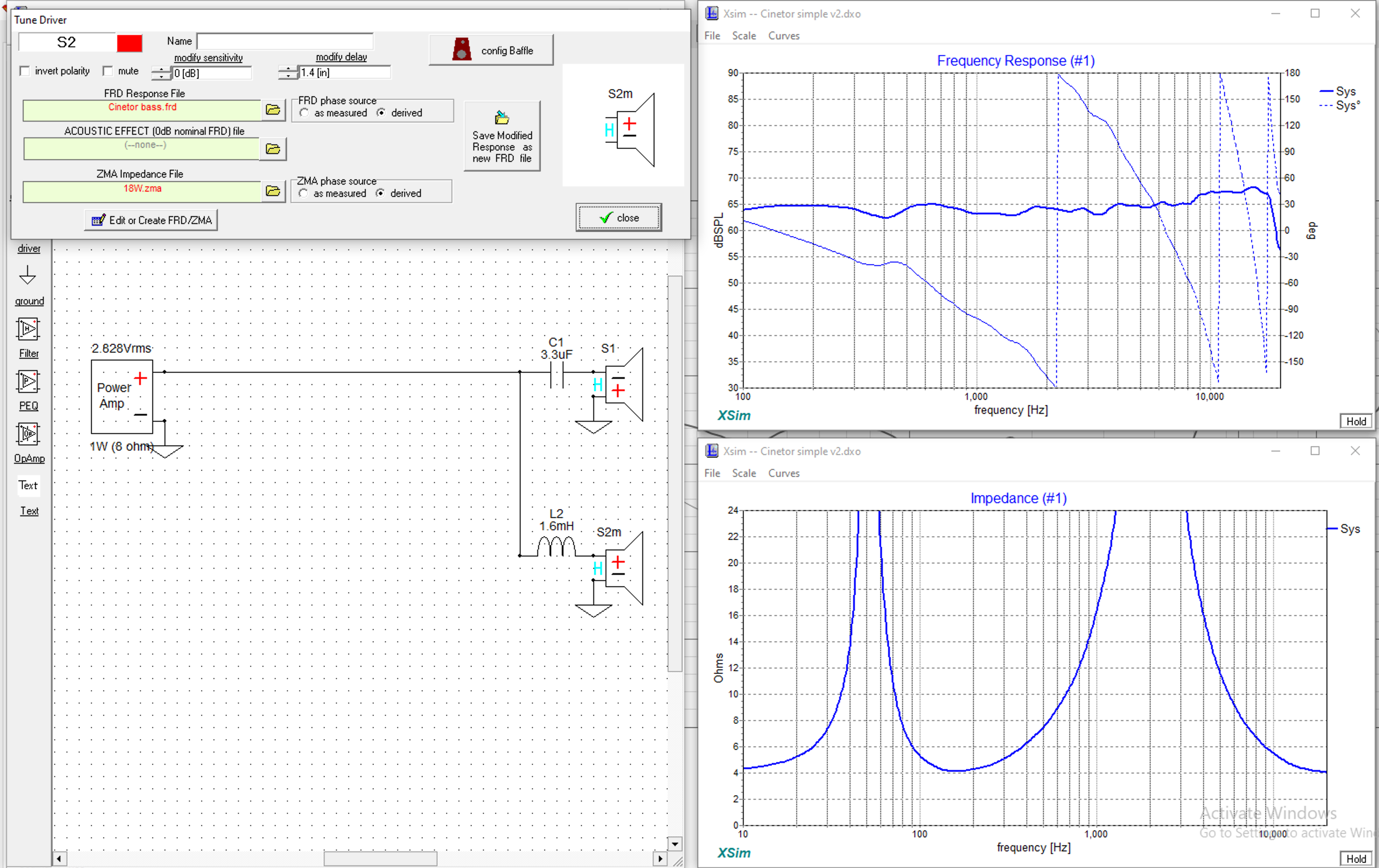

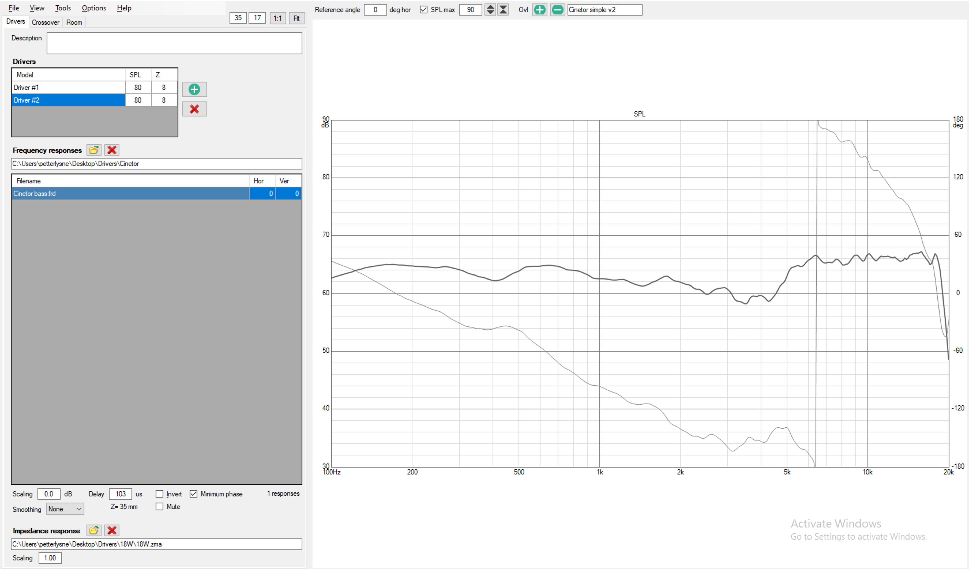

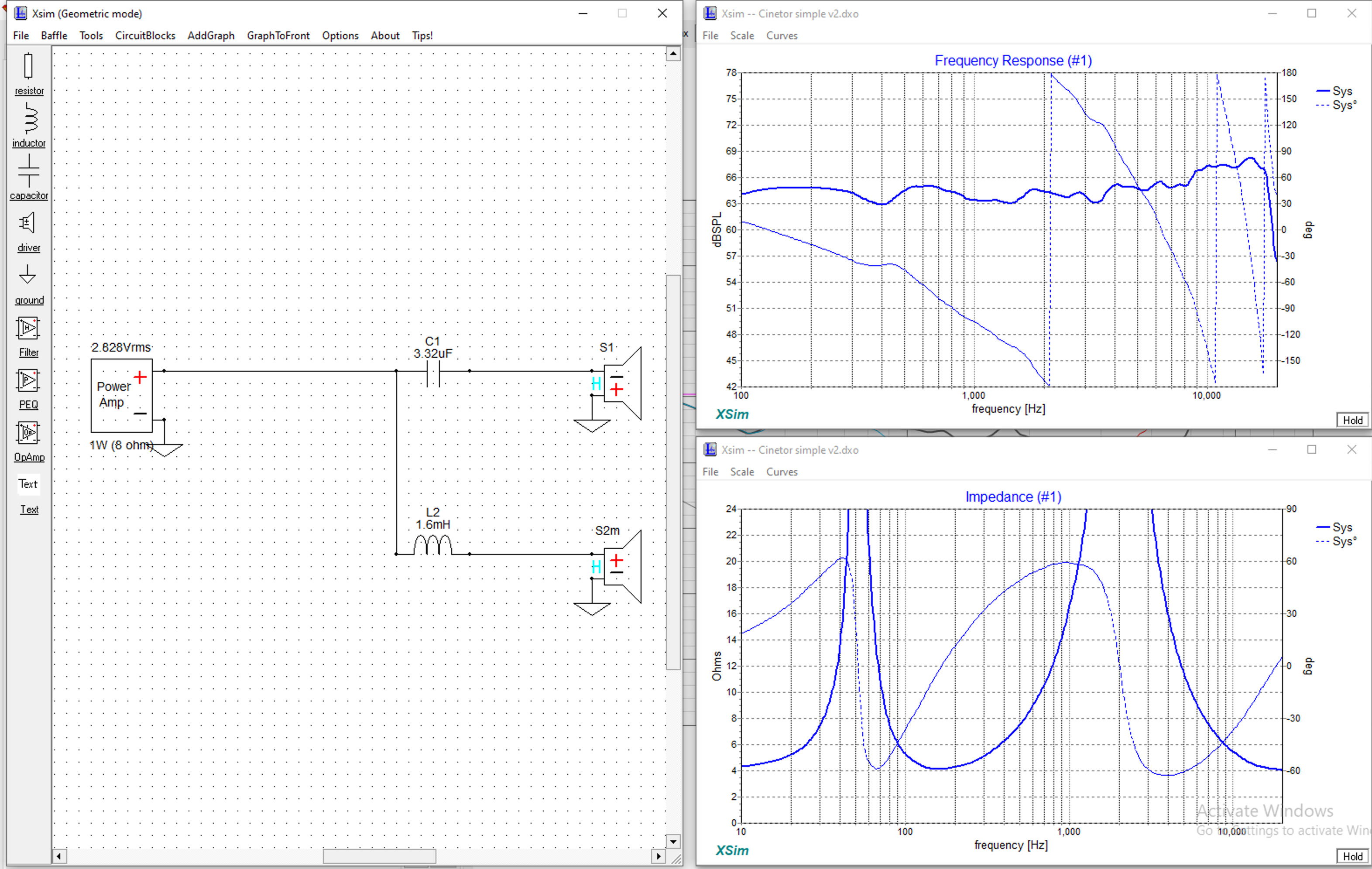

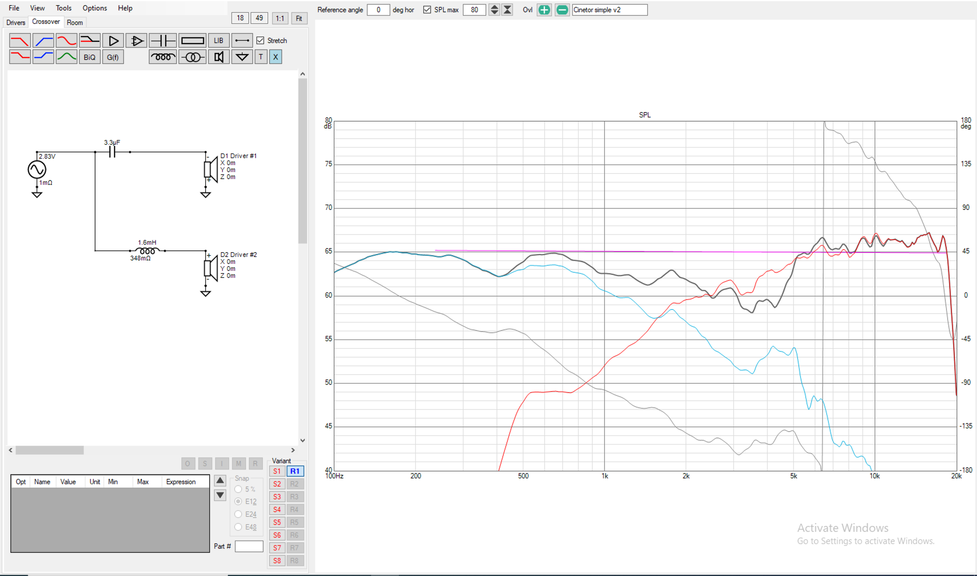

Thanks for the excellent software!
I've just started using the new minimum phase feature, which I reckon is the same as deriving phase from frequency response with Hilbert transform? (as you can do in XSim)
But I get vastly different results in VituixCAD compared to XSim for some reason. One would expect some differences since you define tails manually in XSim (and automatically in VituixCAD it seems?), but not this large of a discrepancy:

Is this coaxial speaker? If not enter driver location.
My guess is that you've inverted both measurement data in Drivers tab and driver instance in XO so polarities are the same.
That was my first hunch as well, but nope. Only inverted in driver instance in XO. Woofer delay is set to the same 1.4 inches in XSim and 35 mm in VituixCAD:
