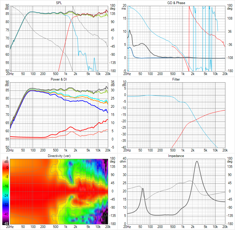

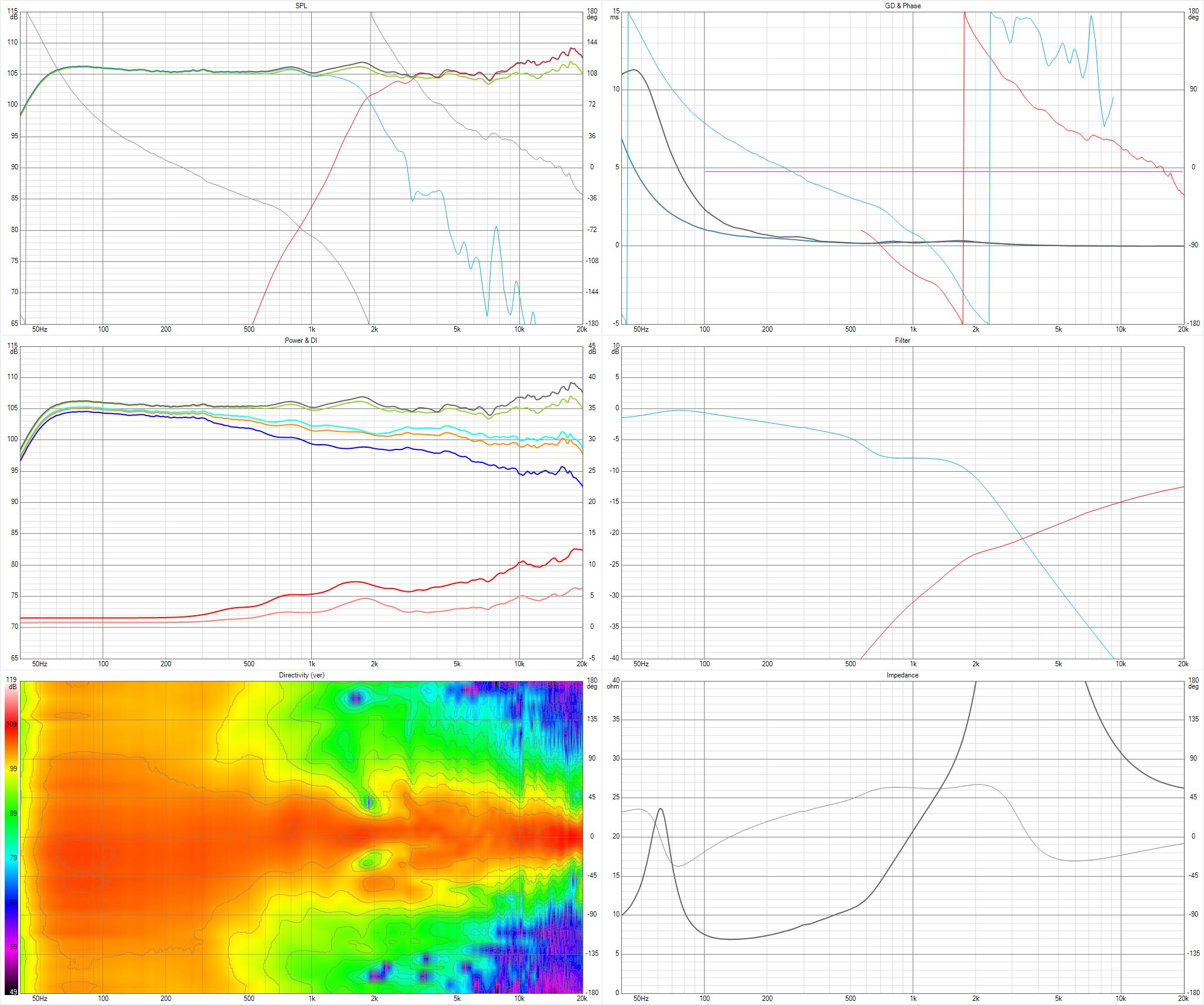

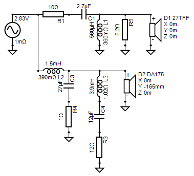

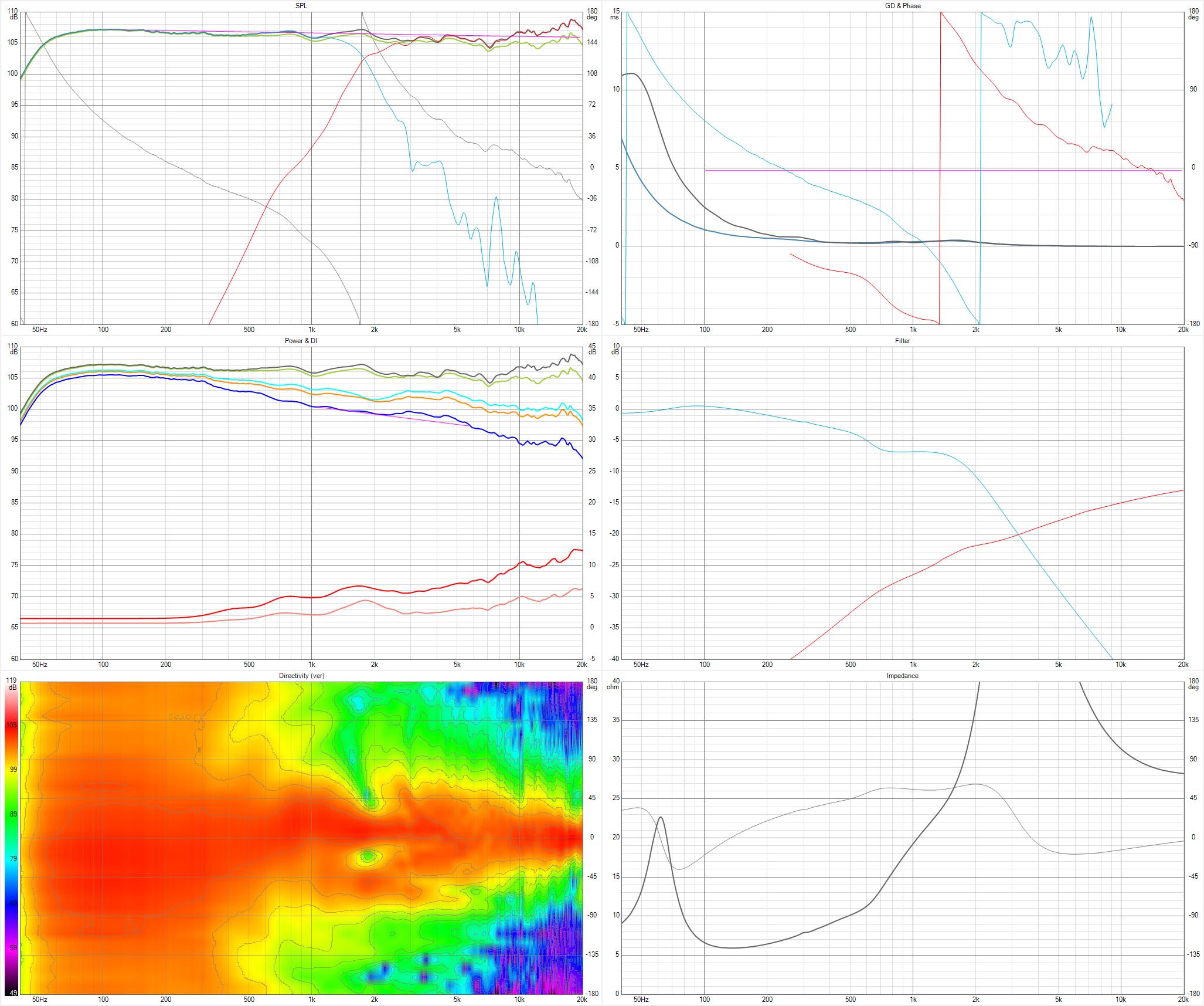

I about tired of this project and just want to put it to bed so I can move onto the next learning project, how does this version look?
Have you reprocessed measurement data or what has happened? 2.5+ mH coil looks way too big. Should be 1.5 - 1.8 mH with measurement data I have. One more thing is that 1st order electrical HP for tweeter does not offer help for combination of power response and phase match. Problem is that phase difference above XO frequency increases power above XO maintaining minor S-curve in ER, in-room and power.
My version was something like this. Few more components and minor S-curves exist, but phase match and steeped slope providing lower load at LF for tweeter.

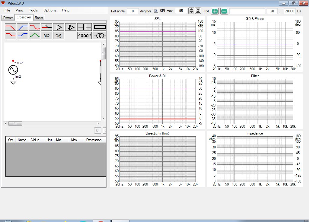

Sorry Just updated latest version 2.0.65.0 and noticed that the 6 display windows on the right take almost 2 thirds of screen and cannot access some functions on left xover screen.. See jpg attached. Is it normal?

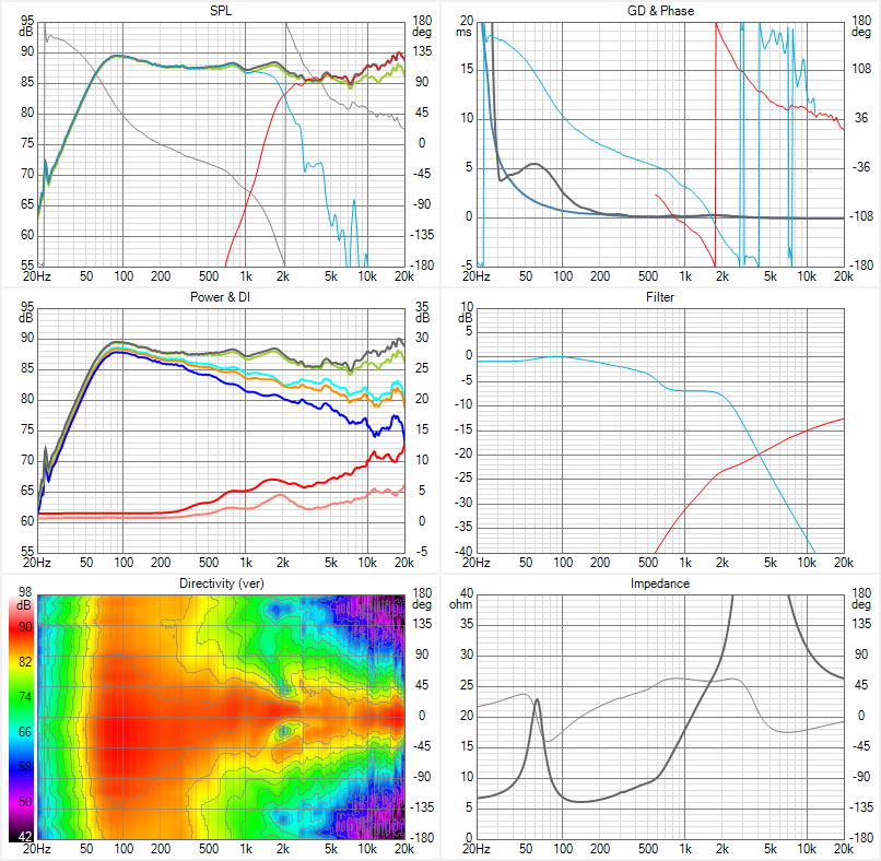

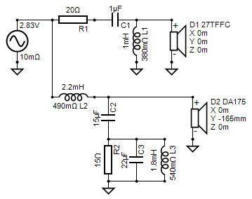

I did redo the data when I switched to the 27TFFC tweeter.
(yes it is 20g main woofer inductor).
Ok. Your connection produces really good balance at high mid...low treble.
Here is my tuning with 2.2 mH/1.4 mm wire. Much "heavier" than 20g makes a bit more balanced low mid and less bump to bass.
