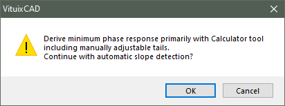

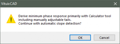

The latest build informs when mp is checked in Drivers tab:

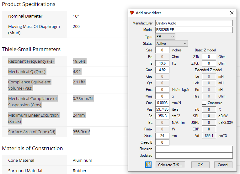

^Done. Problem with PRs only due to few missing parameters. Hopefully nothing else won't damage because this required shortening maximum length of value + unit.
Someone could also inform North American retailers such as Parts Express that driver manufacturers (including Dayton) use SI units. Not any moose's heads.

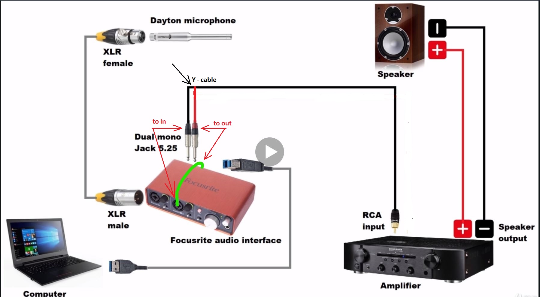

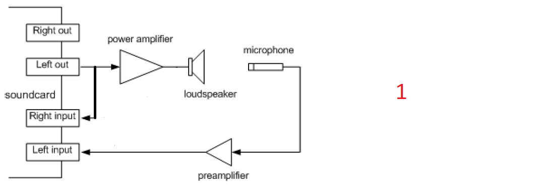

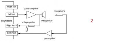

Hi. Just received the mic. And have some confusion.
Can you tell me which way to connect it correctly with the interface, please?
Do I need to loop one channel according to the schematic?
